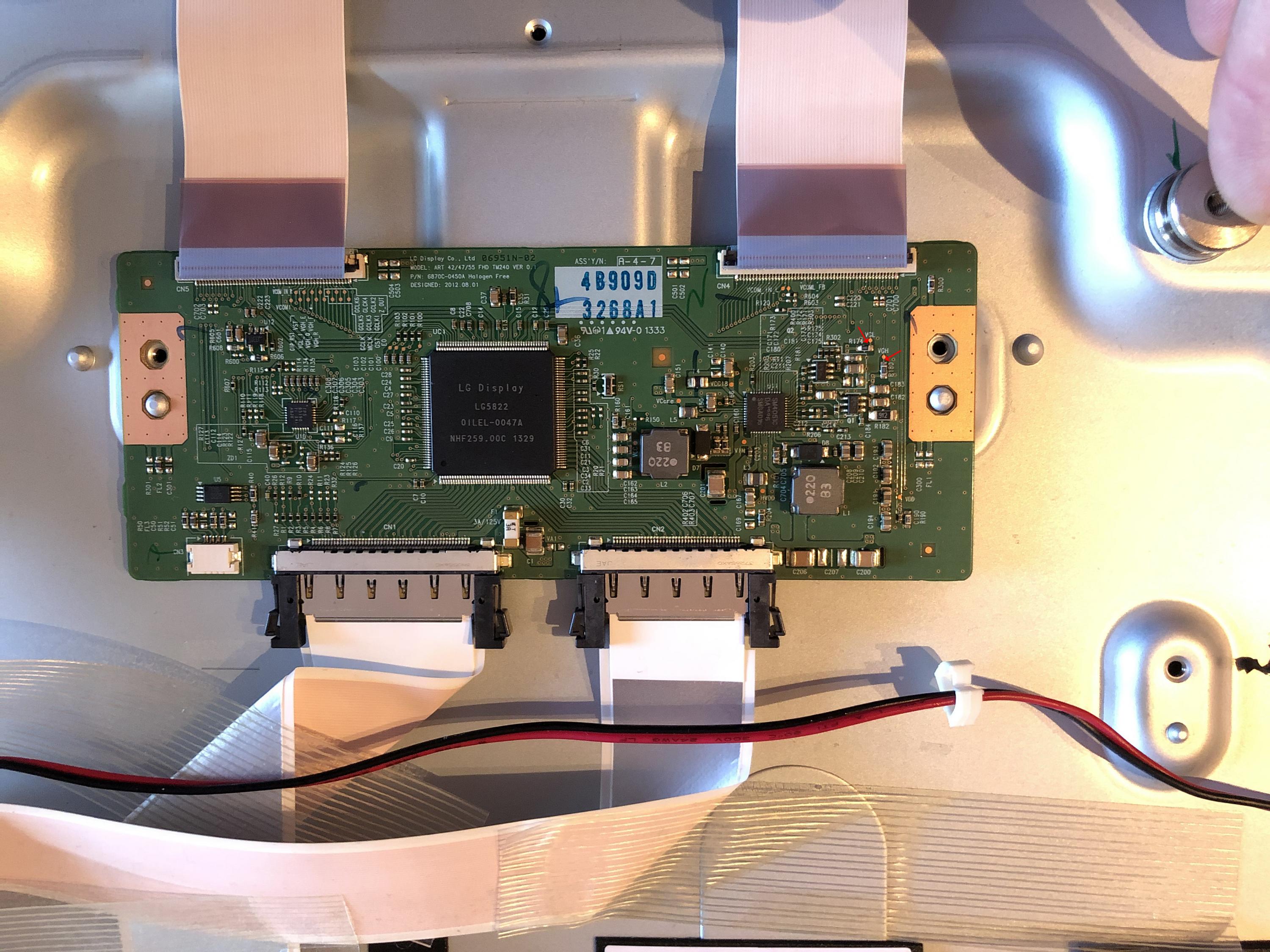

          Re: Philips 42PFL6198k/2 sound ok, no picture
          I have only 7~7,5V on both side of F1 fuse on t-con. If i disconnect left or right flat on t-con which goes on long board at the bottom, nothing happend, only backlight on whole screen is on.

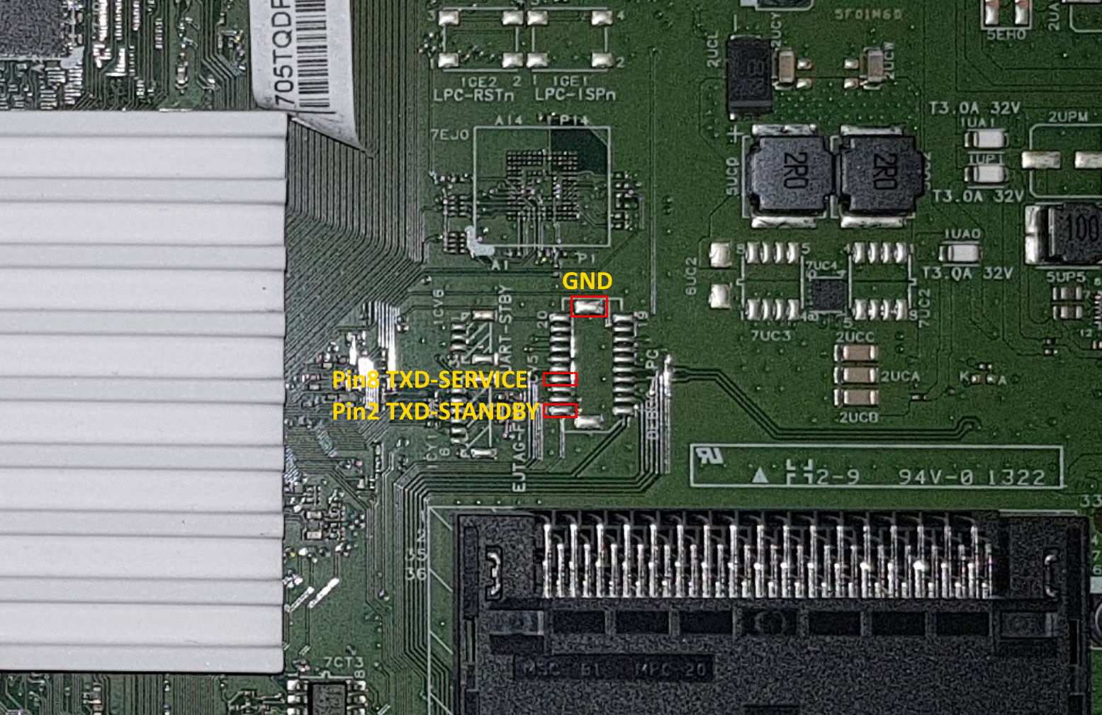

                If you are academically curious Domix, you can use a 3.3V USB-to-TTL adapter and listen to the output from both the 8051 standby microcontroller, and from the main processor.
                This board has the serial ports available, it's all well documented in the service manual for this chassis.
                You can find the pins on the debug-port 1CV5, which in the case in this picture is unpopulated so it's actually easier to solder bodge wires to the pads:
                Pin 2 TXD-STANDBY outputs at 57600 BPS.
                Pin 8 TXD-SERVICE outputs at 115200 BPS.
                Connect your TTL-adapter to the pins before plugging in power to the TV, and enable the "log to file" function in your terminal program (you can use Putty if you don't have anything better), because there is a huge amount of data coming out of the main processor.
                Scan for error messages and warnings in the output.
                This output will show any issues that the standby POST and the Linux system can identify, at the very least you can warn the owner about them.
                The number of lines with mention of "fixable bit-flip" is the number of bit errors in the NAND-chip.

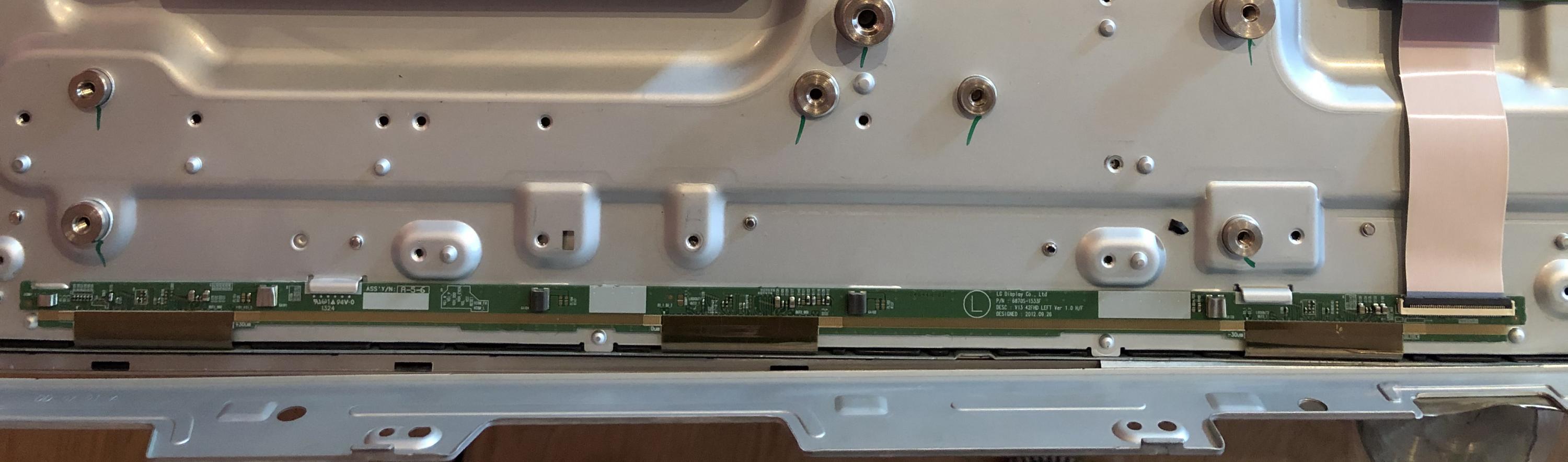

                  I dont have TTL adapter :/
                  I do measurments again, i have 12V on that F1 fuse on t-con. Bedore i forget to te gnd. Now i have 12V with ref to GND when TV is turned on
                  I unplug the 2 ribbons that lead to the panel one by one and picture doesnt appears on a half screen with the TV on.
                  Here is a oic of left panel board
                    Disconnect the ribbons that lead to the screen. Turn on the TV. Look on the T-con VGH (VONE) and VGL (VOFFE) and measure.

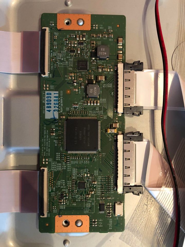

                      I measured at disconnected ribbon when tv is on and i get, here on picture are marked red where i measure
                      VGH : 18,4
                      VGL : -4,99
                        You can say that the T-con is good. Connect the two ribbons one by one and see if the voltages (one or both) disappear. There are other points of measurement. Measure if they are all and disappear when you connect the ribbons.
                          When both ribbons are disconnected values are
                          VGL: -4,95
                          VGH: 18,4
                          1 ribonn cable connected
                          VGL: -4,98
                          VGH: 19,6
                          2 ribbons connected
                          VGL: -4,98
                          VGH: 19,6
