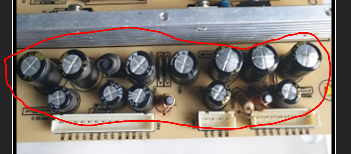

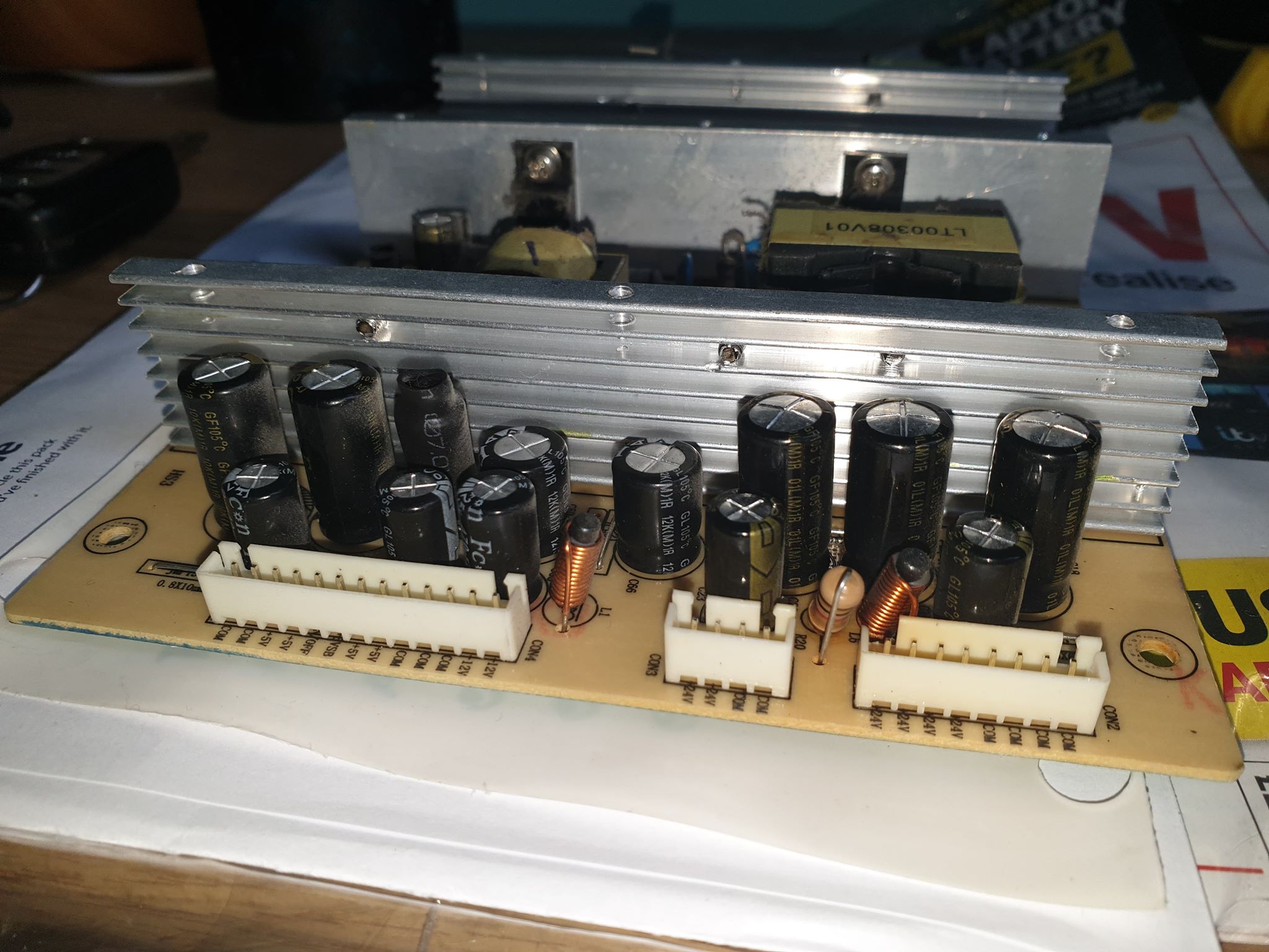

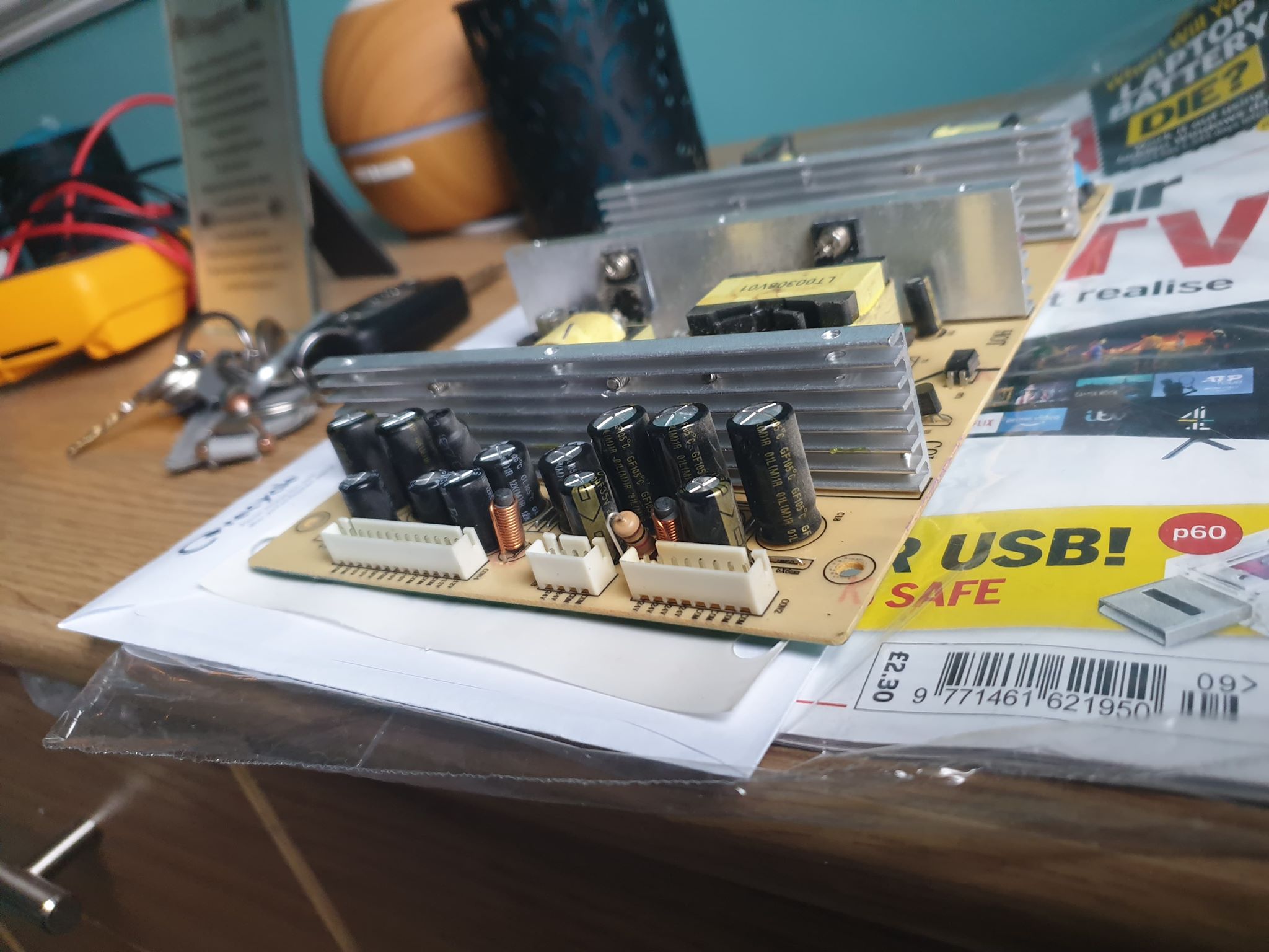

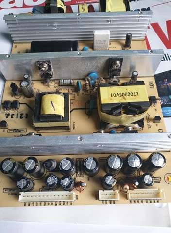

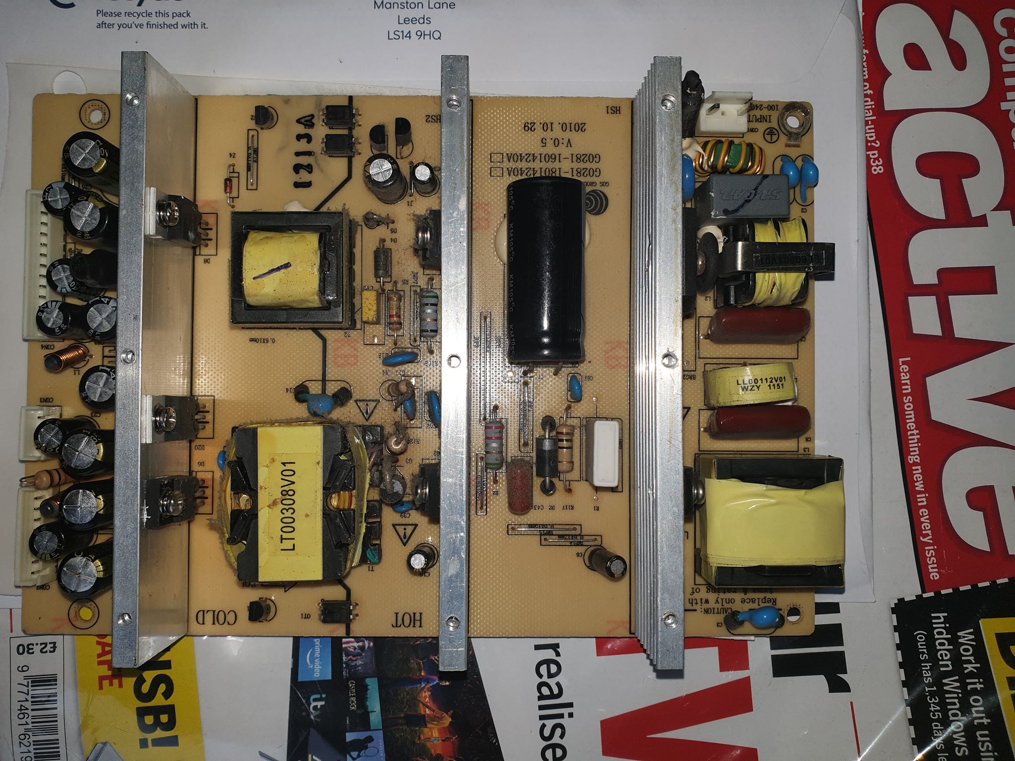

    Can anyone tell me if those bulgy caps on thee 24v rail are responsible for a screen?, and if possible a schematic for the power supply G0281-18014240A or G0281-16014240A.

      They need to be replaced so I would go ahead and replace then see what problem remains. Match the values ie capacitance, voltage reating and temp for each.

        G0281-16014240A Schematic .

            The faulty capacitors are not regulating (smoothing) the 24V DC supply which is then highly likely to be affecting the proper running of the backlight inverter board. Capacitors are relatively cheap to replace.
            What is the part number of the inverter board as printed on it.

                  The odds are pretty good that it's only the caps, replace all the ones in that area, many would replace all the electro caps on the board, simple recap.

                      Well I changed the caps not all just the ones in the pic, the tv came on as normal no flickering, I thought great. So I zipped up the back panel, plugged in all the cables, went to switch it on again and nothing, only got a red standby led and that's it.
                      Checked for 5vstby spot on 5v, also had 12 and 24v with a red led on that don't make sense.

                            I've taken out this power supply again.
                            There's 5v on the standby so I shorted it to the on/off pin to power up the unit.
                            I now have a healthy 12 and 24v, main cap 383v.
                            I put the unit back in the tv pressed the on button got my 5v, 12v and 24 but the led is still red when It should be blue and nothing on the screen.
