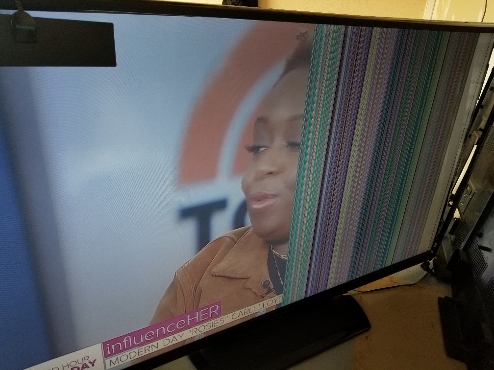

    i have a 70 inch sharp tv. looking for ideas on repair. first i verified the tcom by swapping output cables. no change. then i removed the side driver tabs on the bad side of the screen. no change. what next?

    probably would have been wise to post BEFORE you removed the side tabs. :-( maybe check the components on the bottom edge board for the bad side for shorts or otherwise. Doesn't look good. Double check your cable seating at both ends.

      What was original symptoms, was the display picture the same as it is now before the tab removal?

        same

          maybe. i have had luck fixing these with tab removal before. this time not so lucky.
