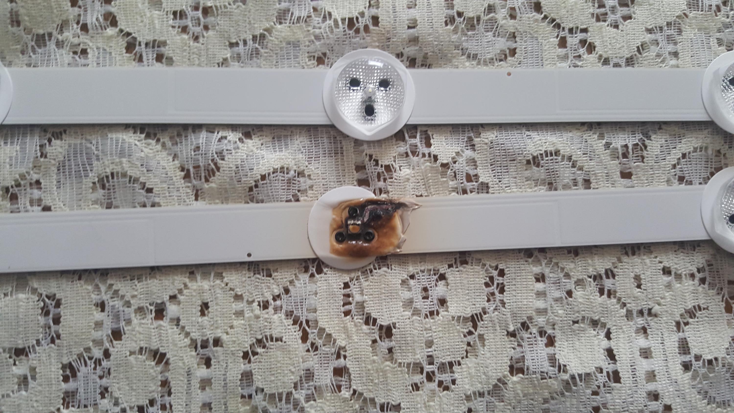

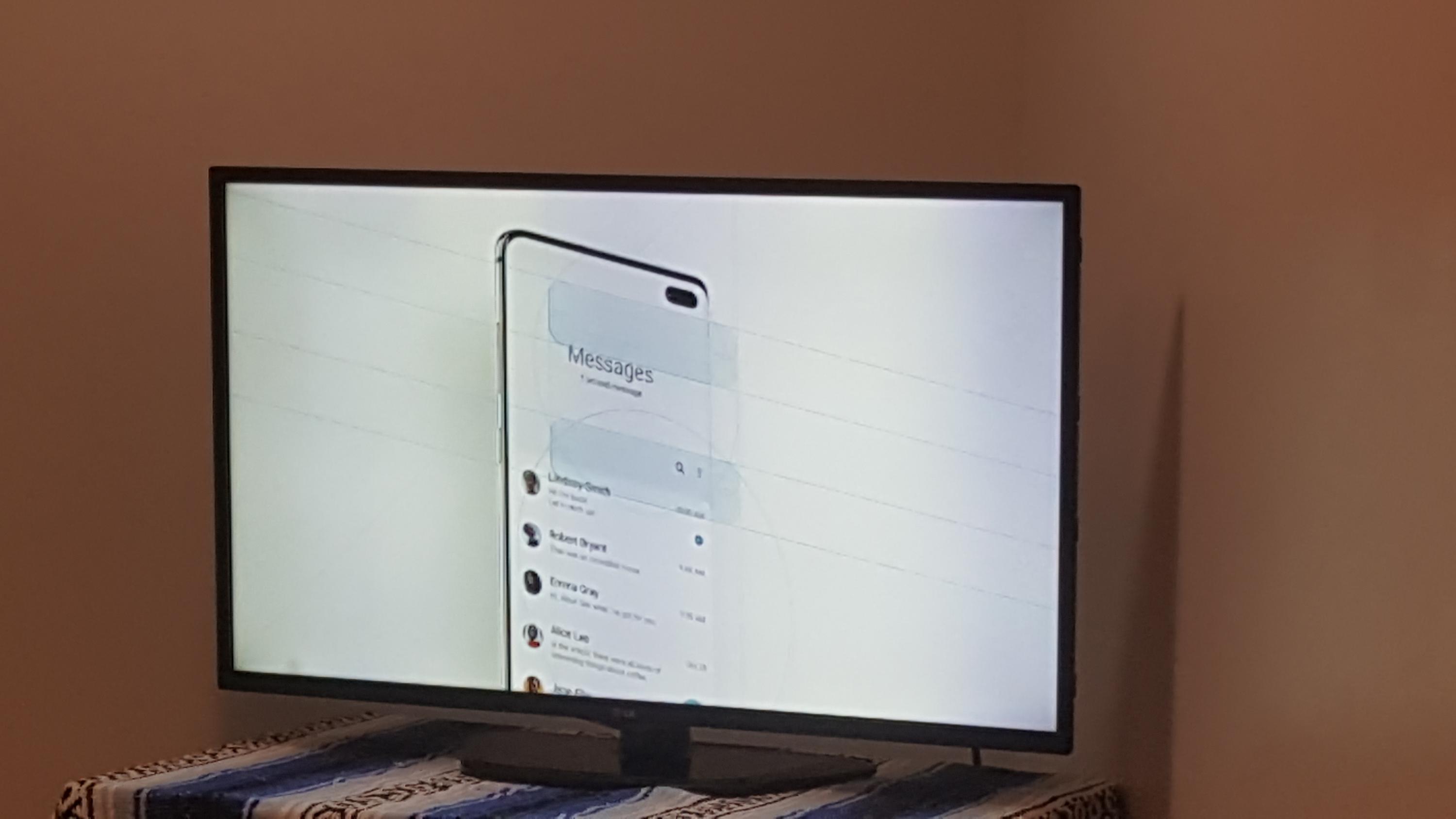

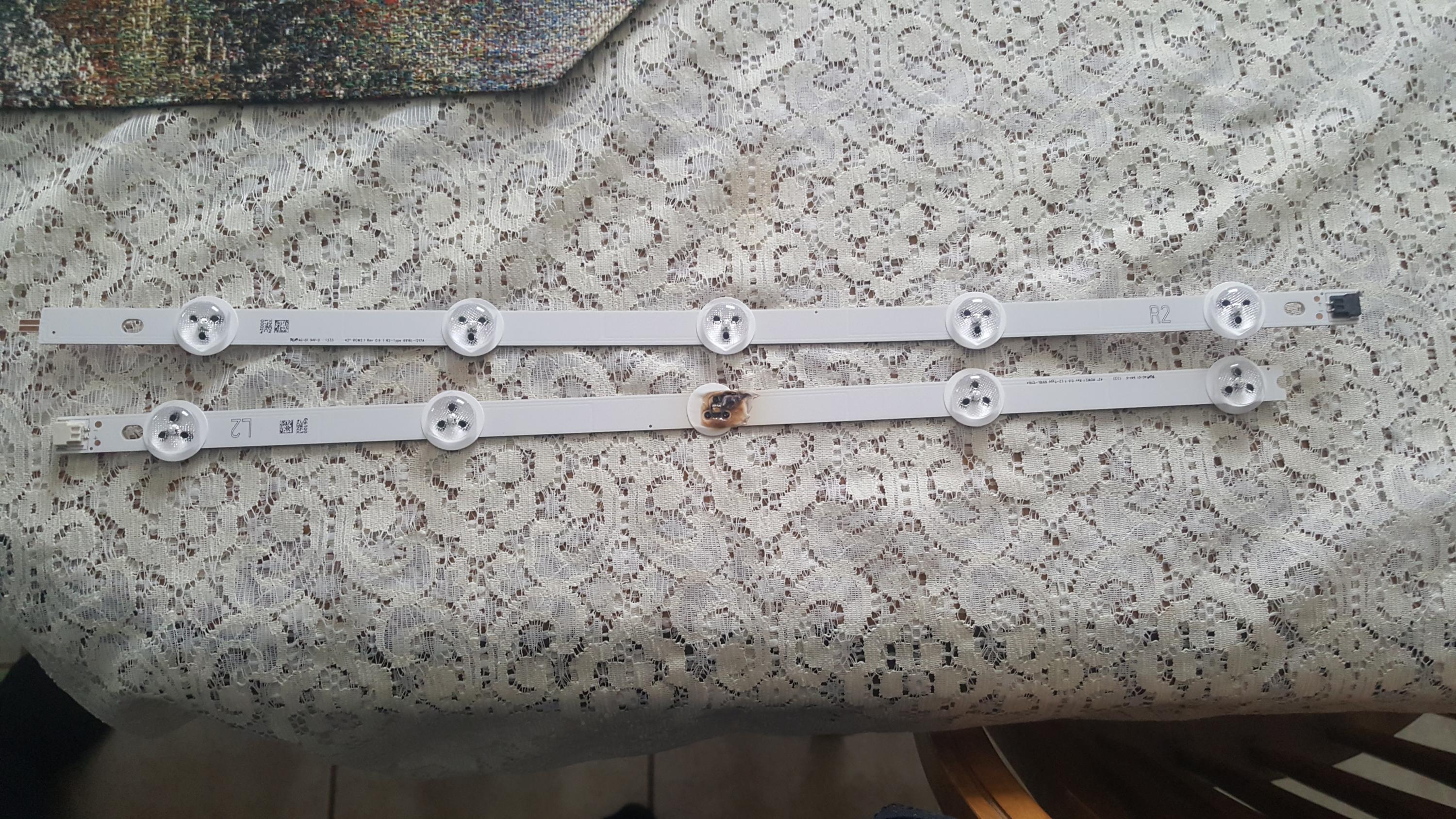

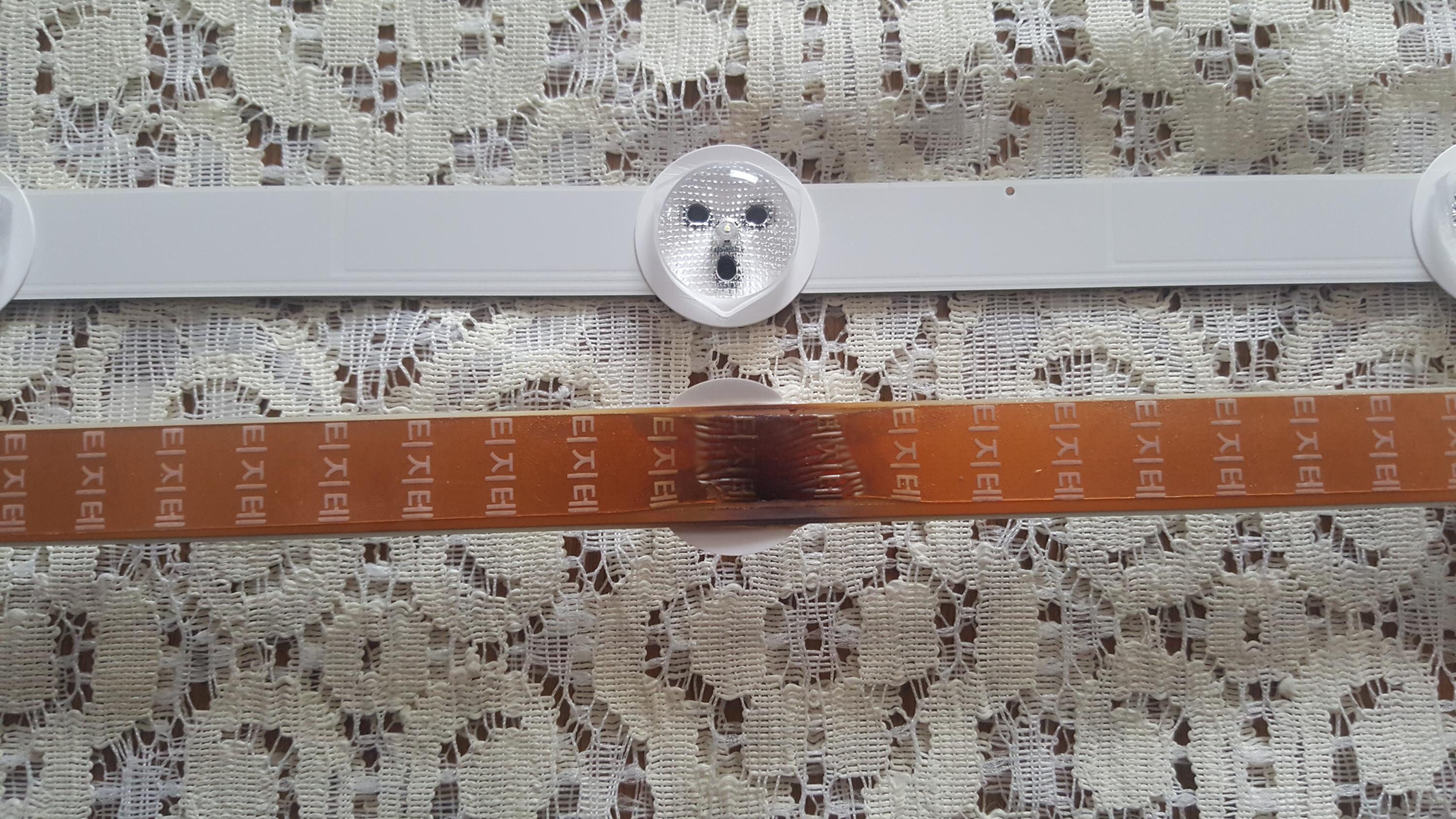

    Hello all, Just replaced all the LED strips in this set, during diagnostics I shorted out the power supply by arcing it against the chassis, so changed that too, the main board was missing one of the HDMI input connectors, so I changed that as well, I know, I know, should have just bought another set, this thing cost me $599 bucks, so I think it was personal. LOL, cost me around 120 for everything Iv'e done so far, But my issue is this. I have two wide strips of a yellow or bright hue going vertically on either side of the center, it's like racing strips if you will, it is so faint I'm not sure i can even get a picture of it to post, I was thinking the obvious t-con board, but could also be the LVDS cable, and other causes you can think of? would a bad panel cause this? when the led went out it literally seemed like it blew up with significant burning on the strip itself as well as the plastic strip cover, it also has burn marks. didn't know they could do that.

    That is minor, I have seen them burn up the white plastic sheet in side the panel. I have also seen a samsung led strip short and shut down the power supply (but the power supply was ok)
    Check the cables between the panel and the t-con and make sure there is not a damaged conductor on the flat cable.
    But in this case I suspect you may have damaged the tab connection to the panel. Either the thin flex cable is bad or the cof ic is bad,

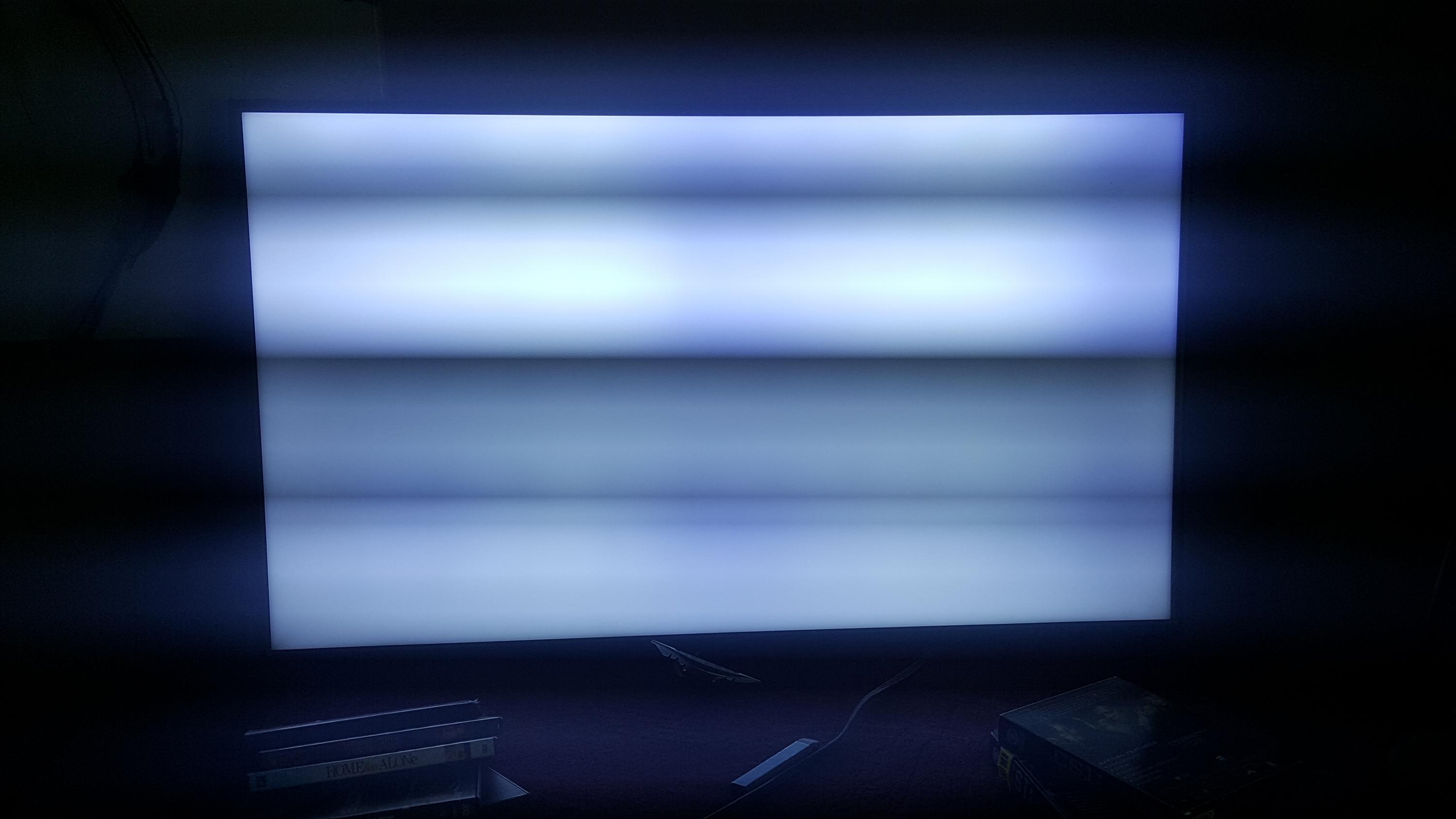

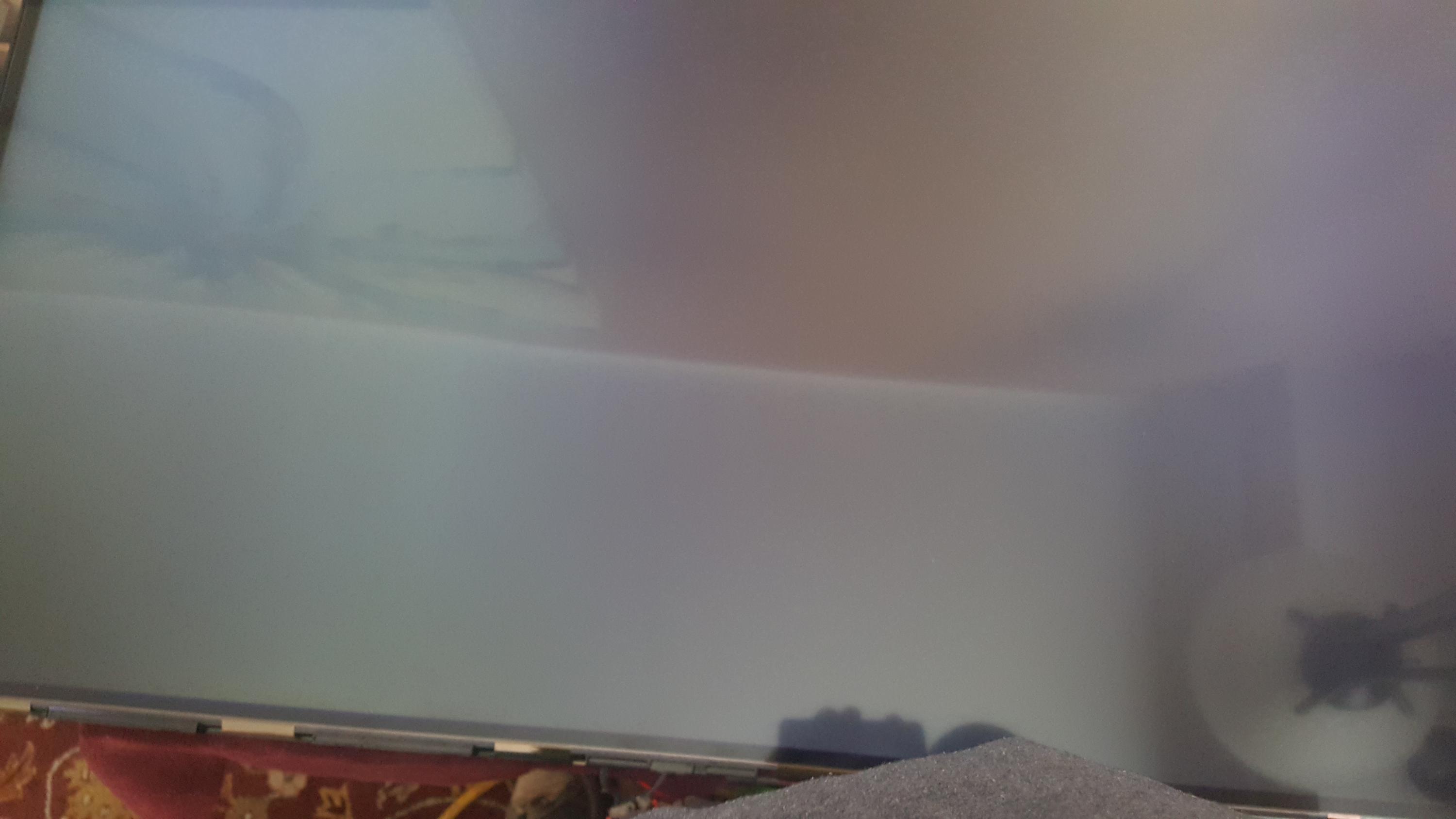

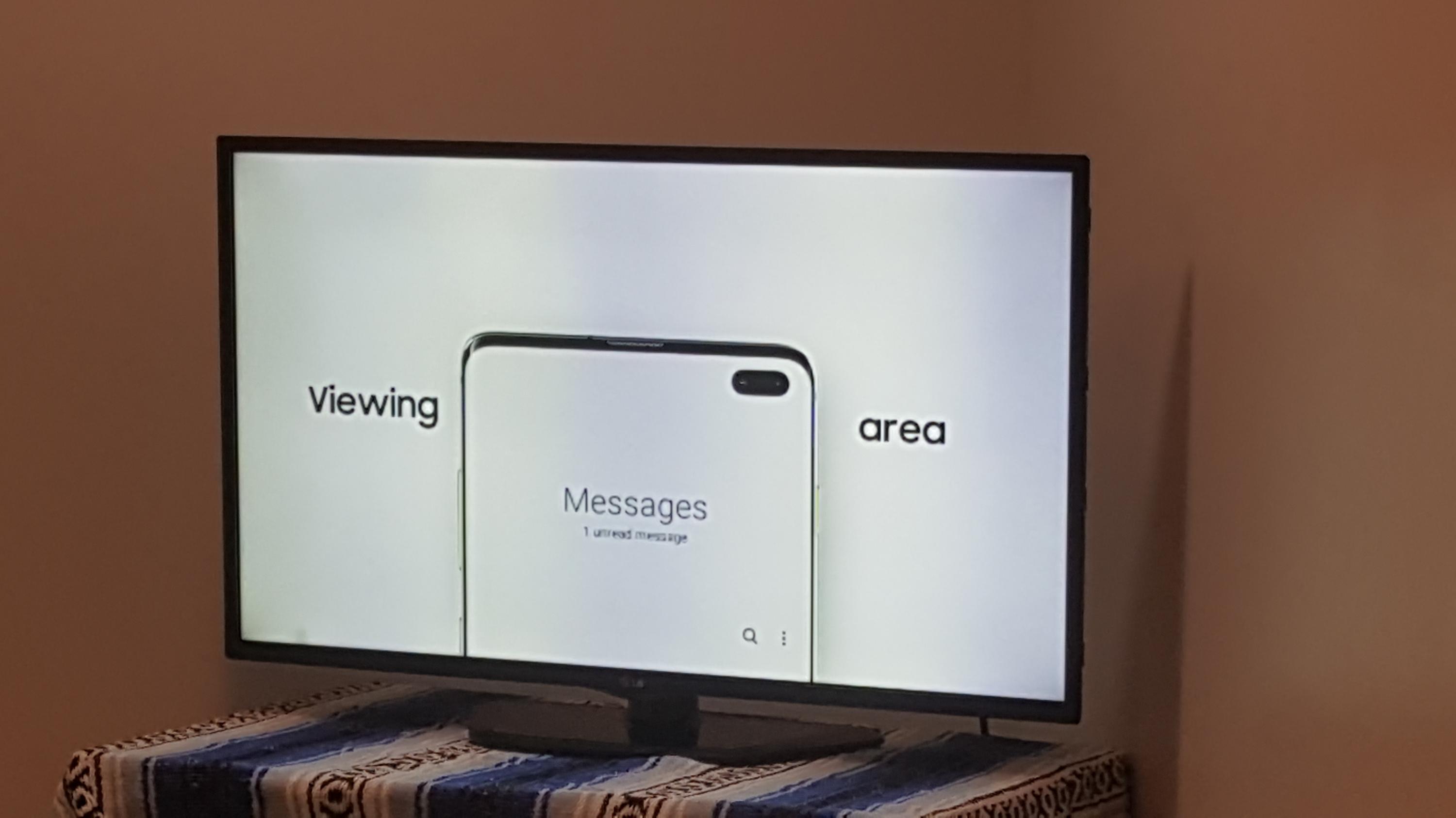

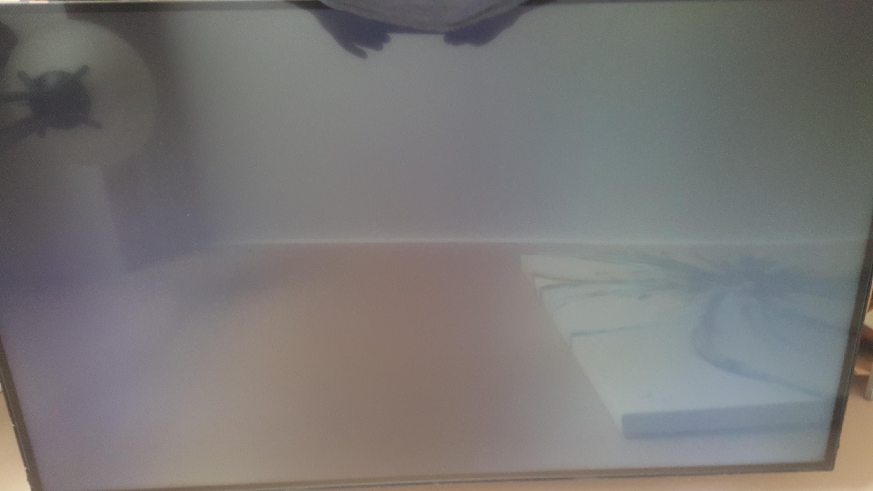

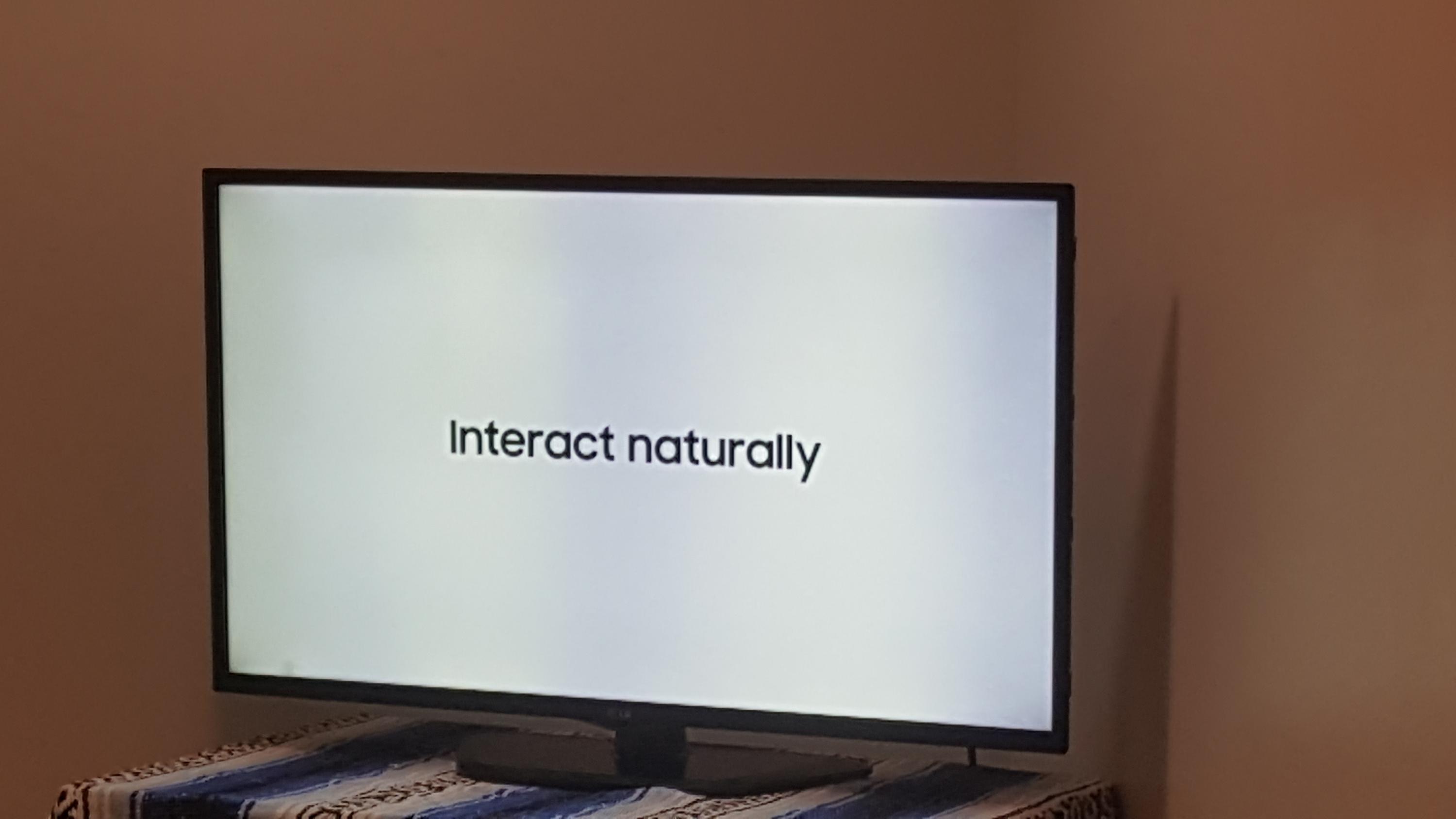

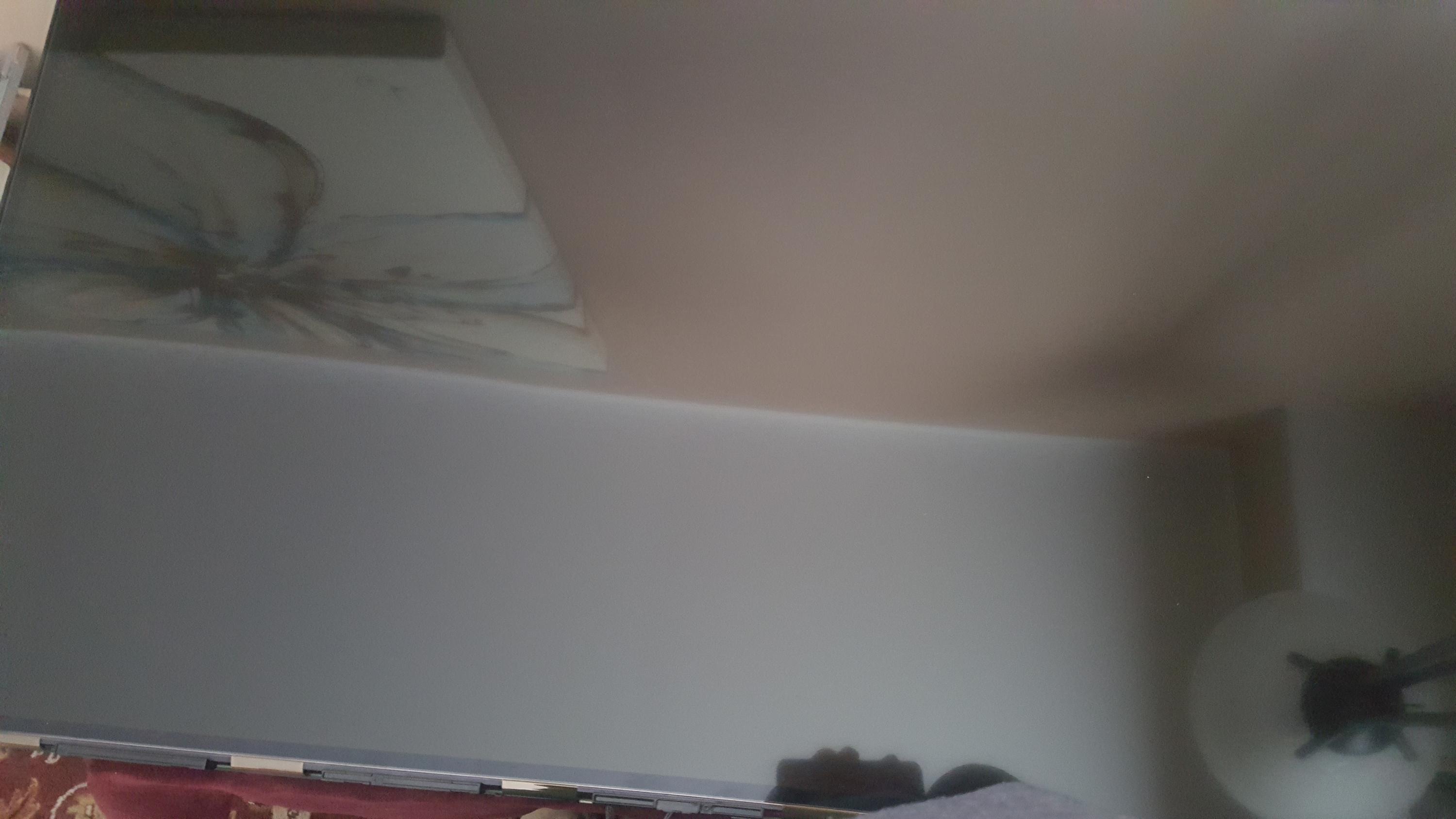

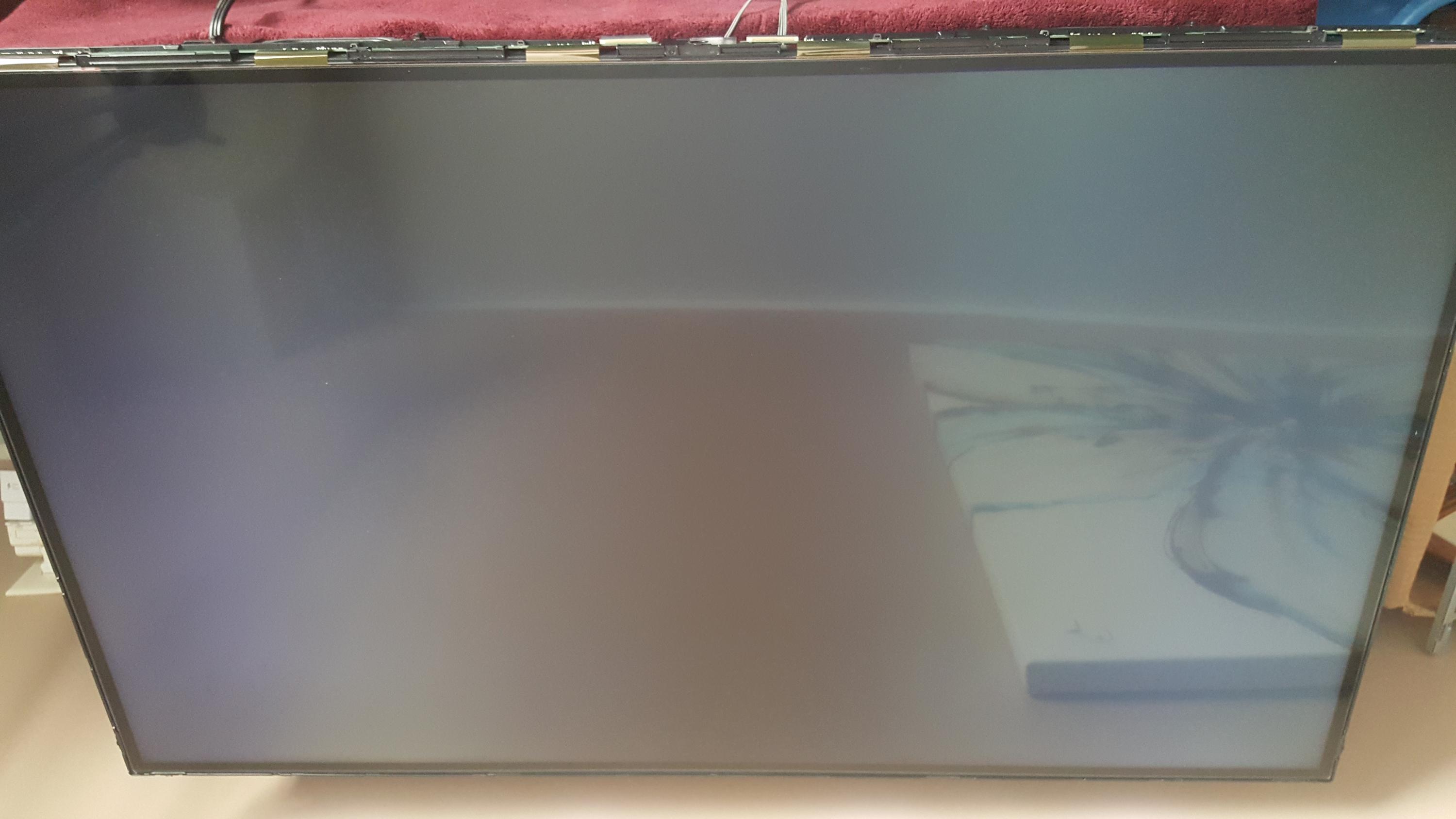

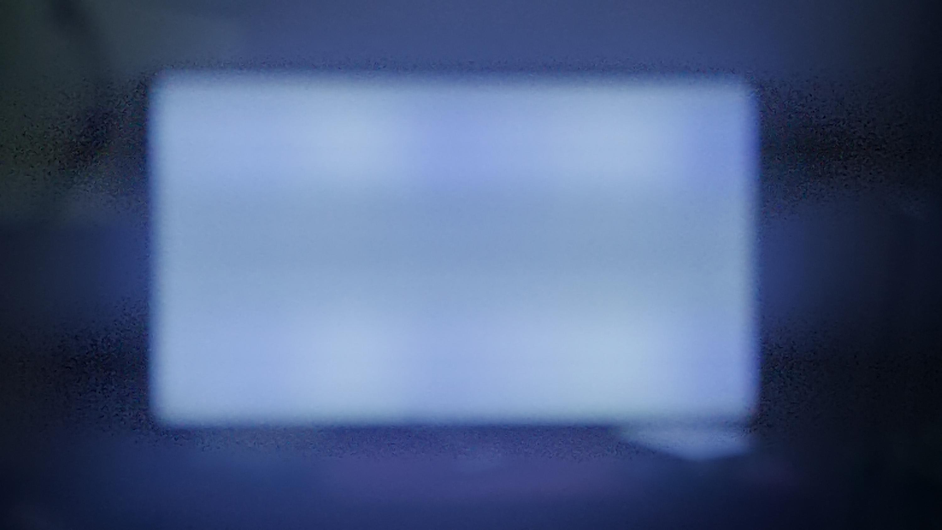

        Re: LG 42LN5700 issue PICS
        managed to get some pictures of it.
          That does'nt look like a tab issue, it looks more like a diffuser issue, Are you sure you installed them back the same way?
          If it was a tab or driver issue, the edges of the bands would be sharply defined.
          Have you tried your original main board to see if it changes anything?

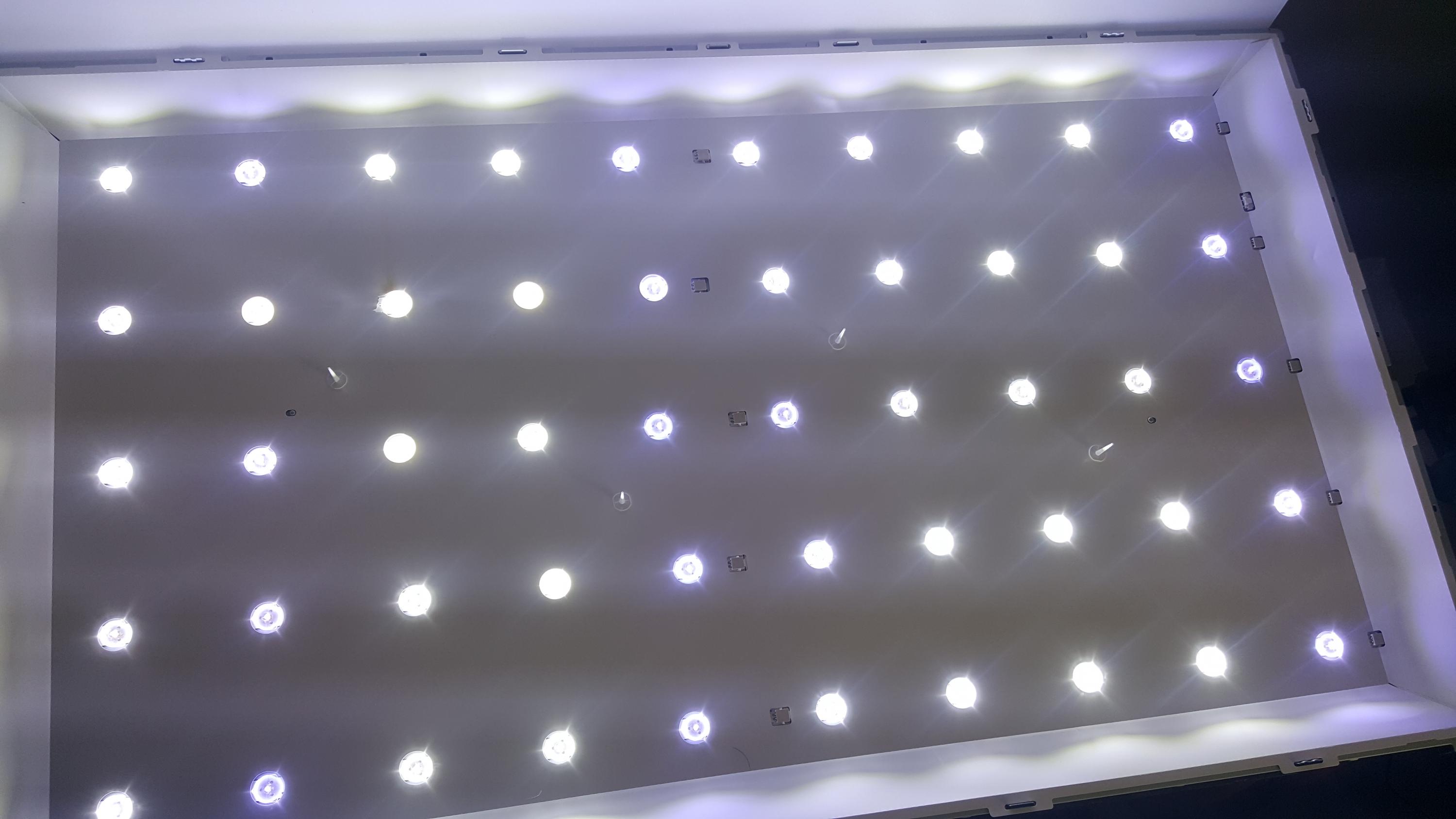

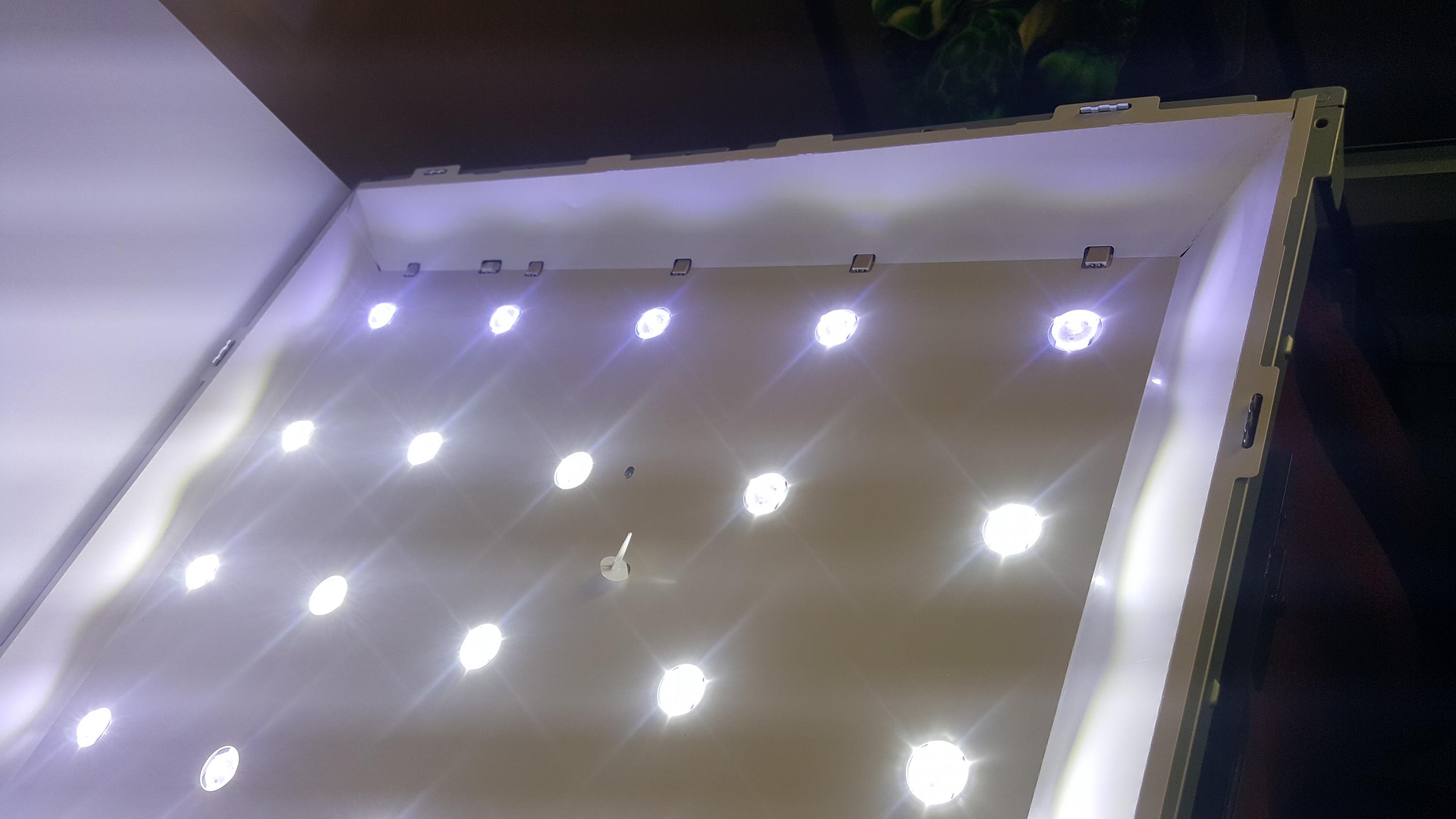

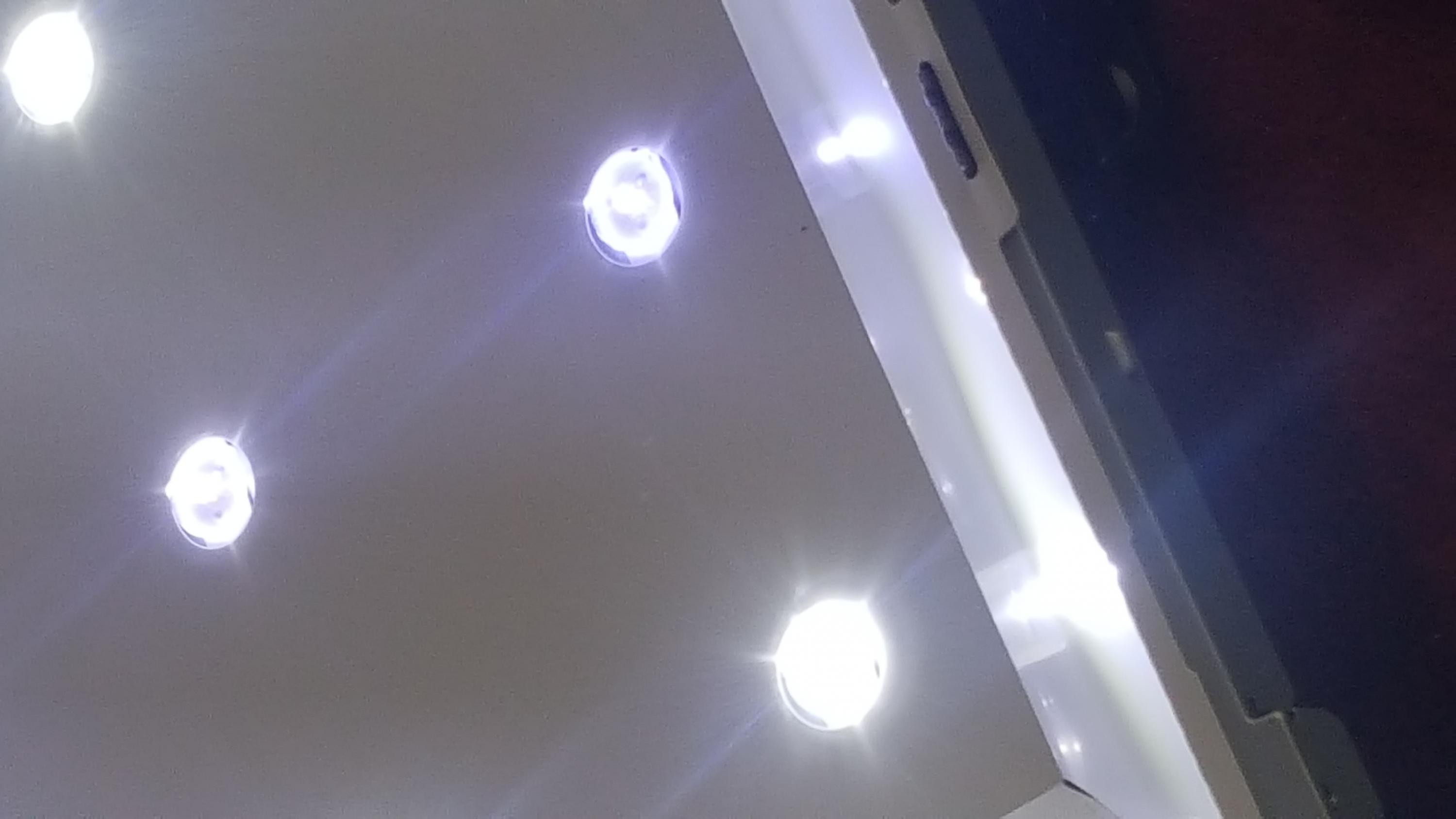

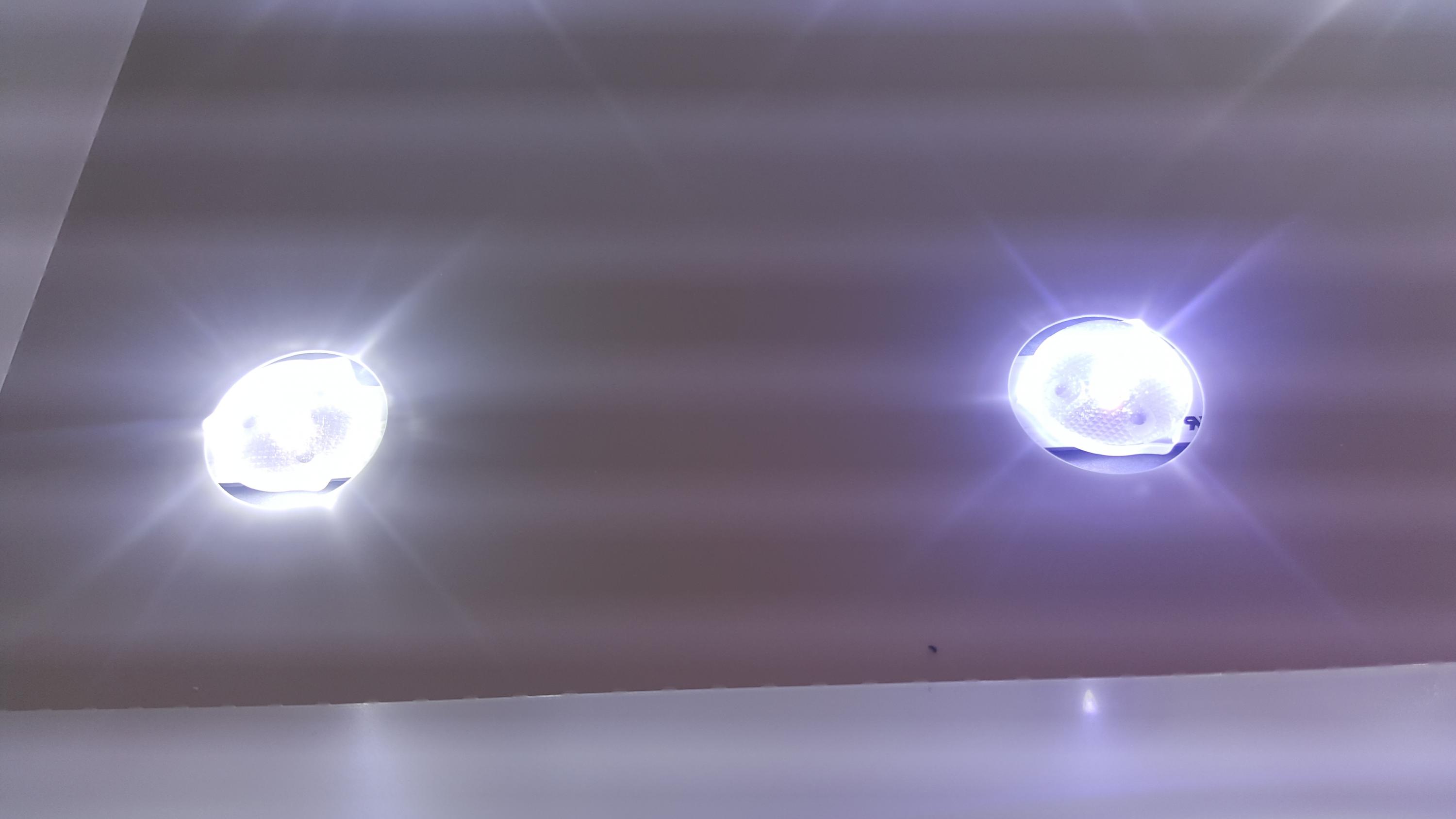

                        Backlights do come on, Bright at first, then not so much but still visible. so here are some pictures with T-Con disconnected, so this points to Diffuser issue? should I take each piece of diffuser out, clean it and reassemble? I'm perplexed now, what else is new though LOL

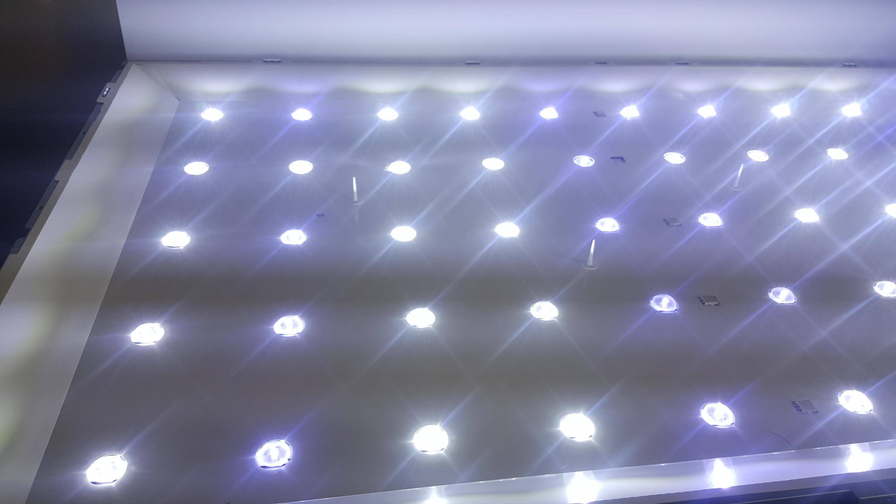

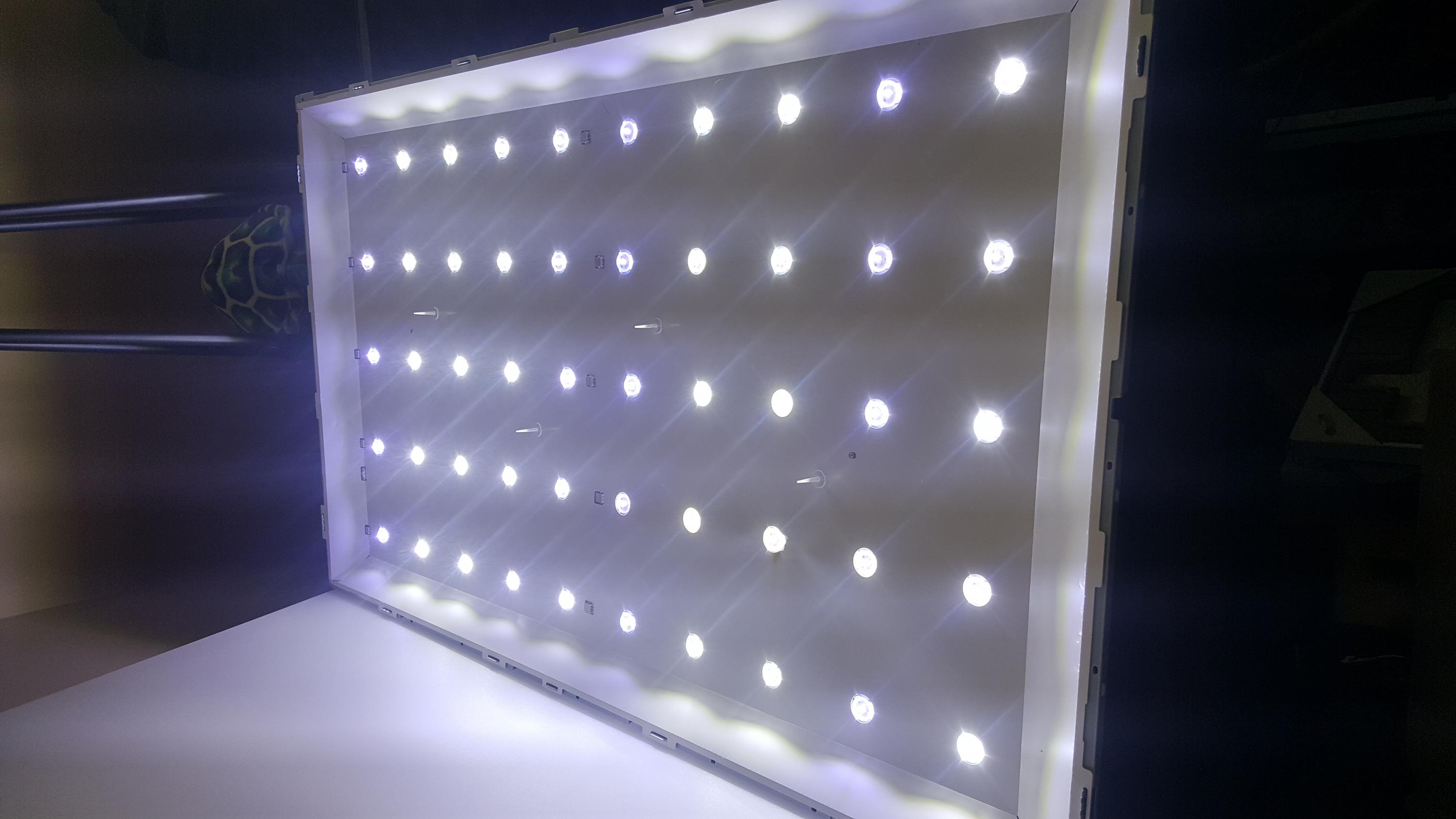

                        • LITEZONER
                          GO BOLTS!
                          • Mar 2010
                          • 223
                          here some pics with panel removed forget the Horizontal flicker, it;s the vertical discoloration I cannot seem to find the cause of.
                            It could be the missing reflective circles. The darker bits are perhaps on the bends on the back metal sheet. The pattern is to even to be anything else.
                              If the bands are still there with the lvds cable disconnected, the fault can't be caused by a video issue, so this eliminates the main, tcon and lcd glass itself. It won't be a cleaning issue and cleaning may cause damage. Make sure the diffusers are in properly. The first one closest to the led's should be the thickest and have the dimples toward the led's.
                              I would remove the thin diffuser sheets and only place the thick sheet over the led's and if you still see the bands, it won't be a diffuser issue.
                              After seeing the latest pictures:
                              It does seem odd that the led intensity has brighter bands like that.
                                Well, not sure if you guys can see these led strips the way I do, there are discolored bands in them, almost a blue color going vertical on the left, right, and center. Very weird, let me know what you think of this
                                  Where did you get the strips? usually when the led's start to show blue they are at the end of their life. even in the pictures I can see a difference in the led intensity from one to another, this should not happen.
                                    Thank you all, so much for new led strips on eBay, getting a refund at least.
