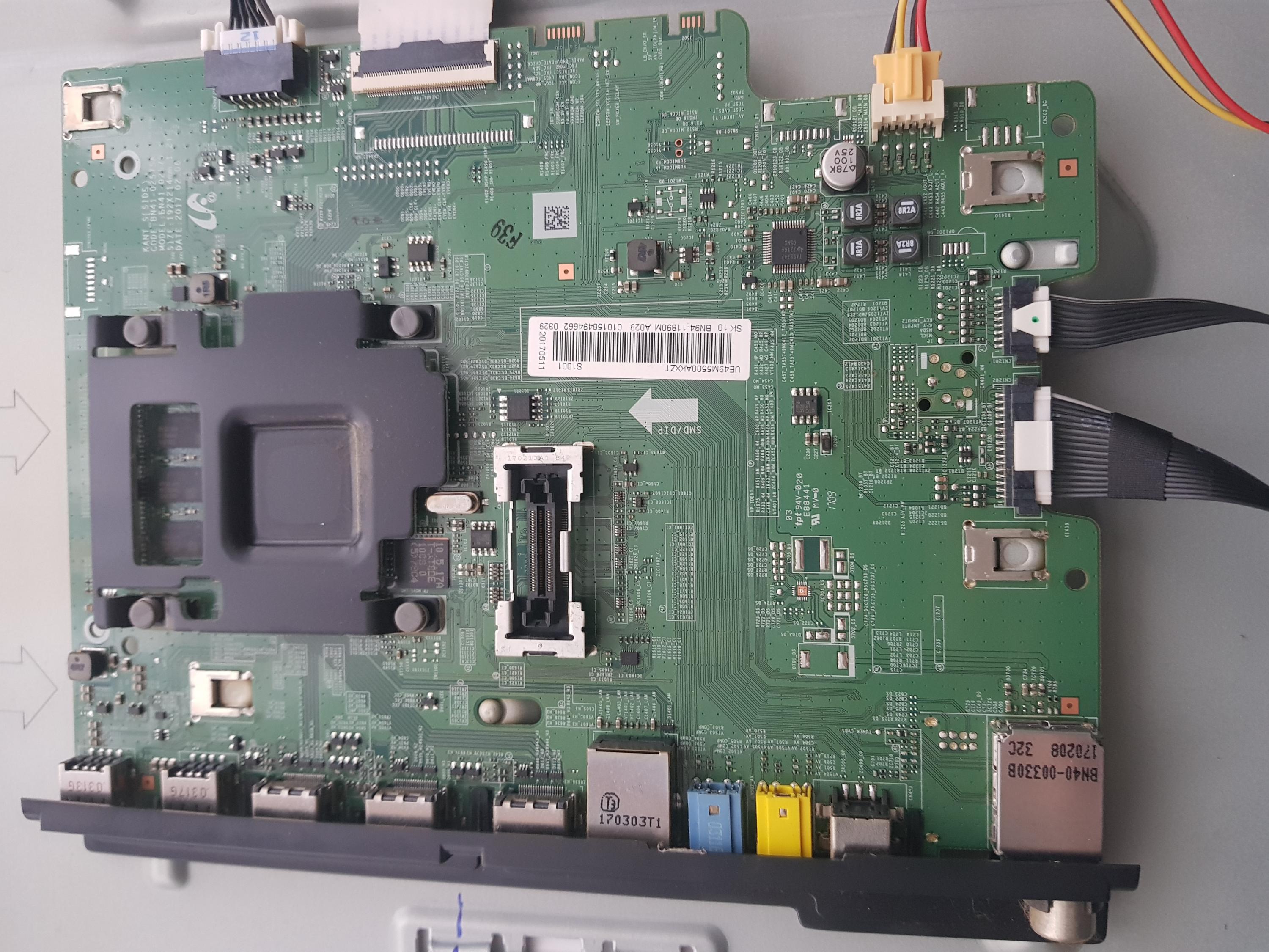

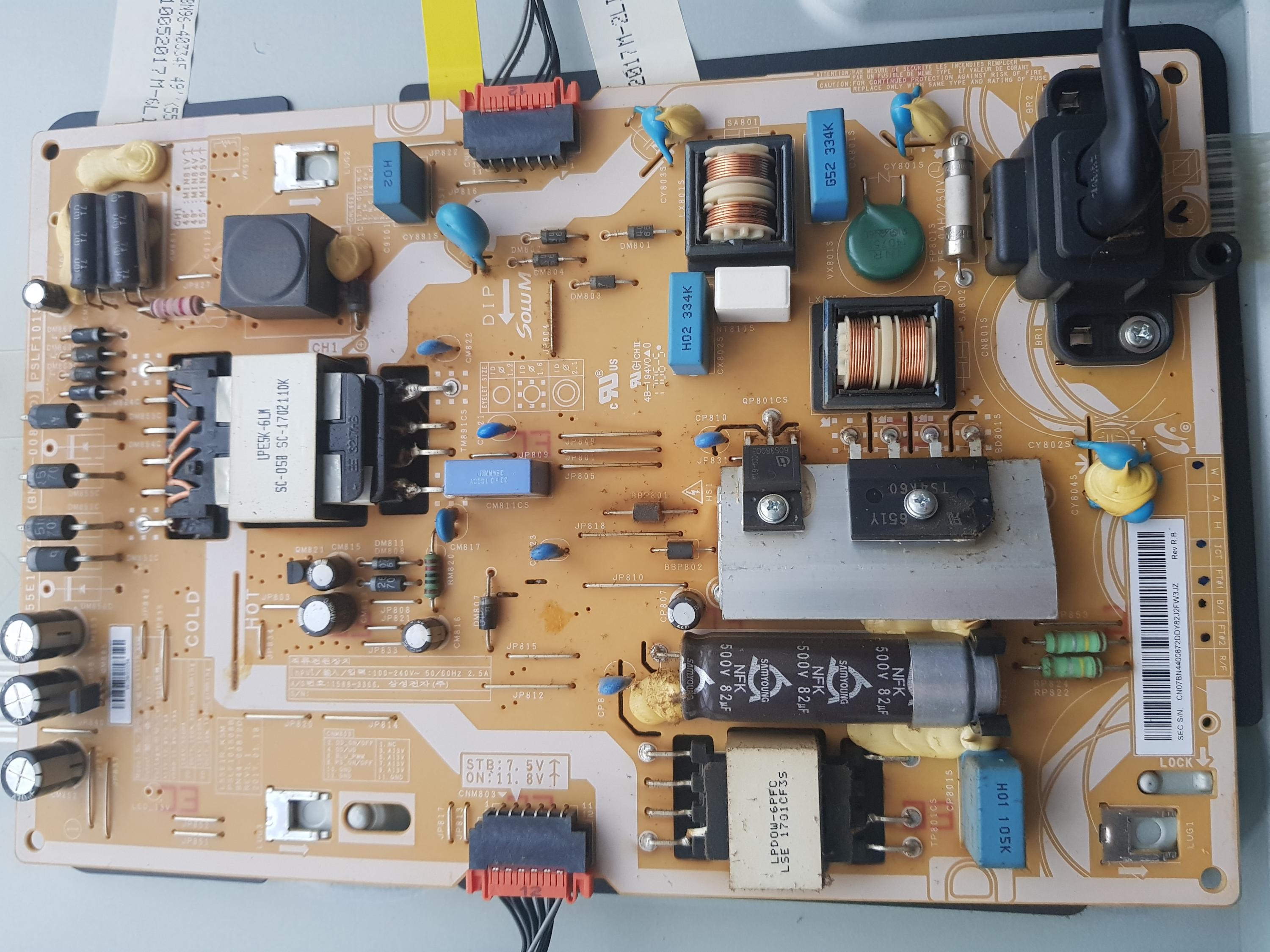

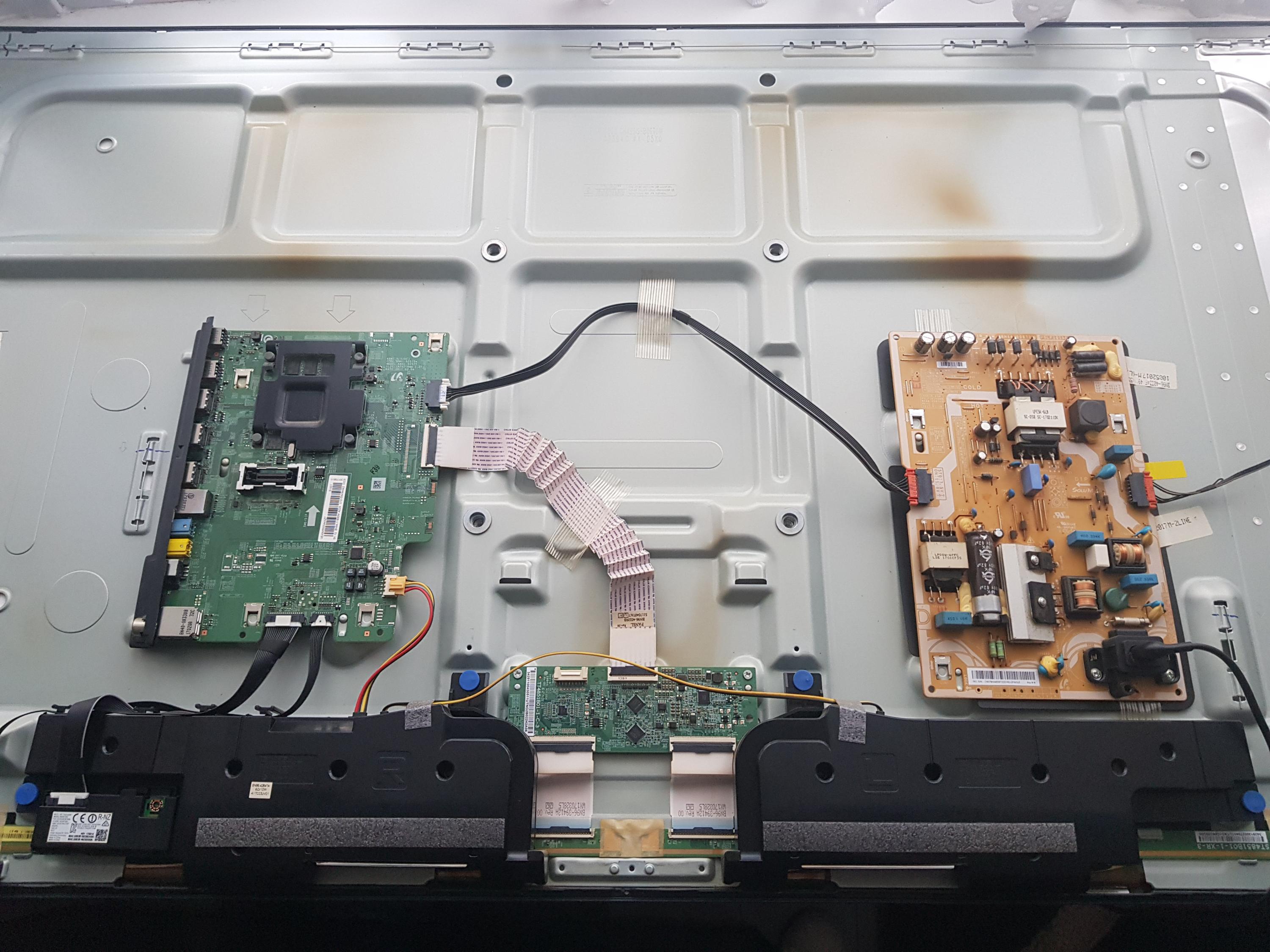

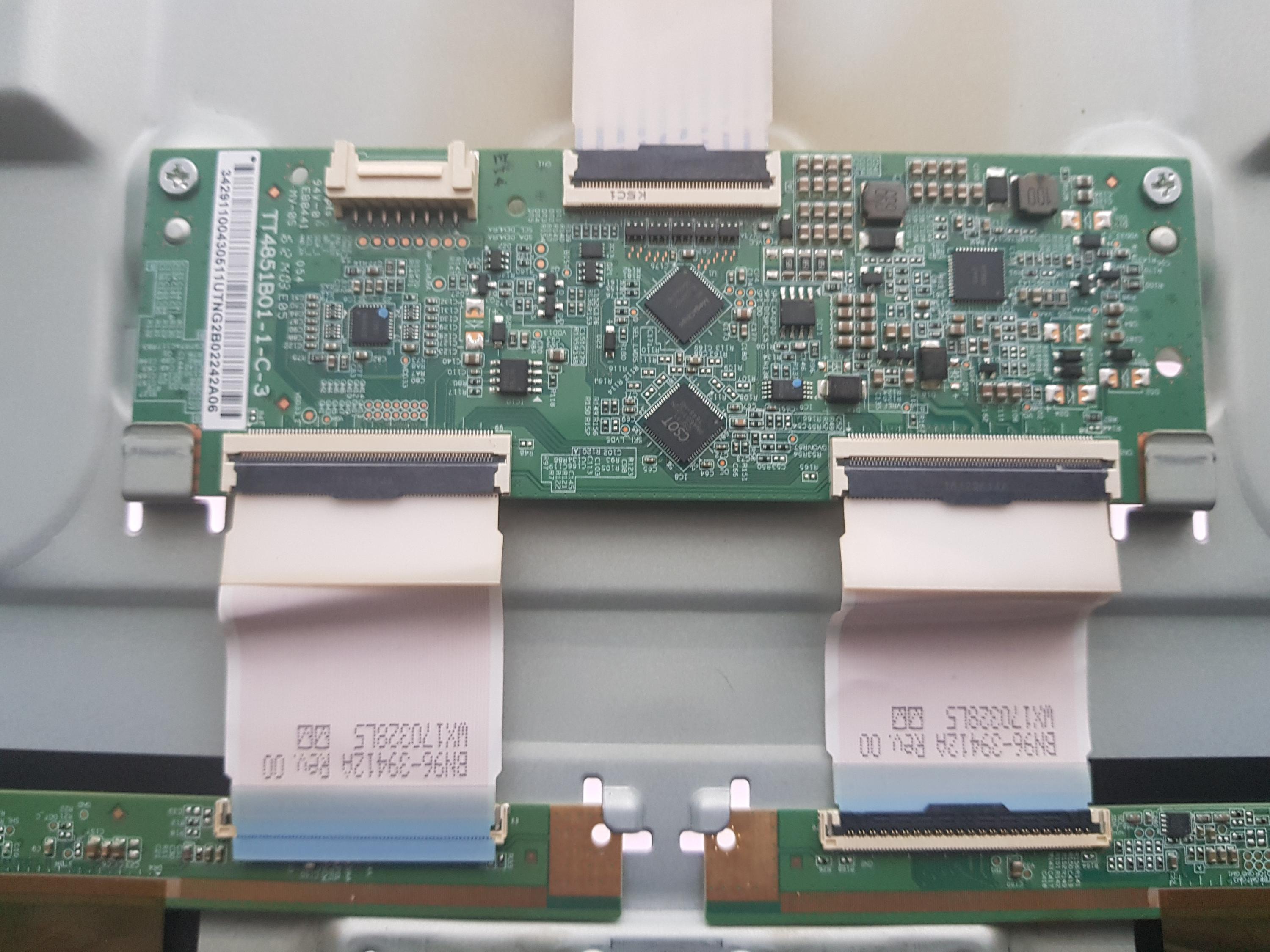

    Hi guys
    Got this samsung today but no picture
    on the screen but backlights are good

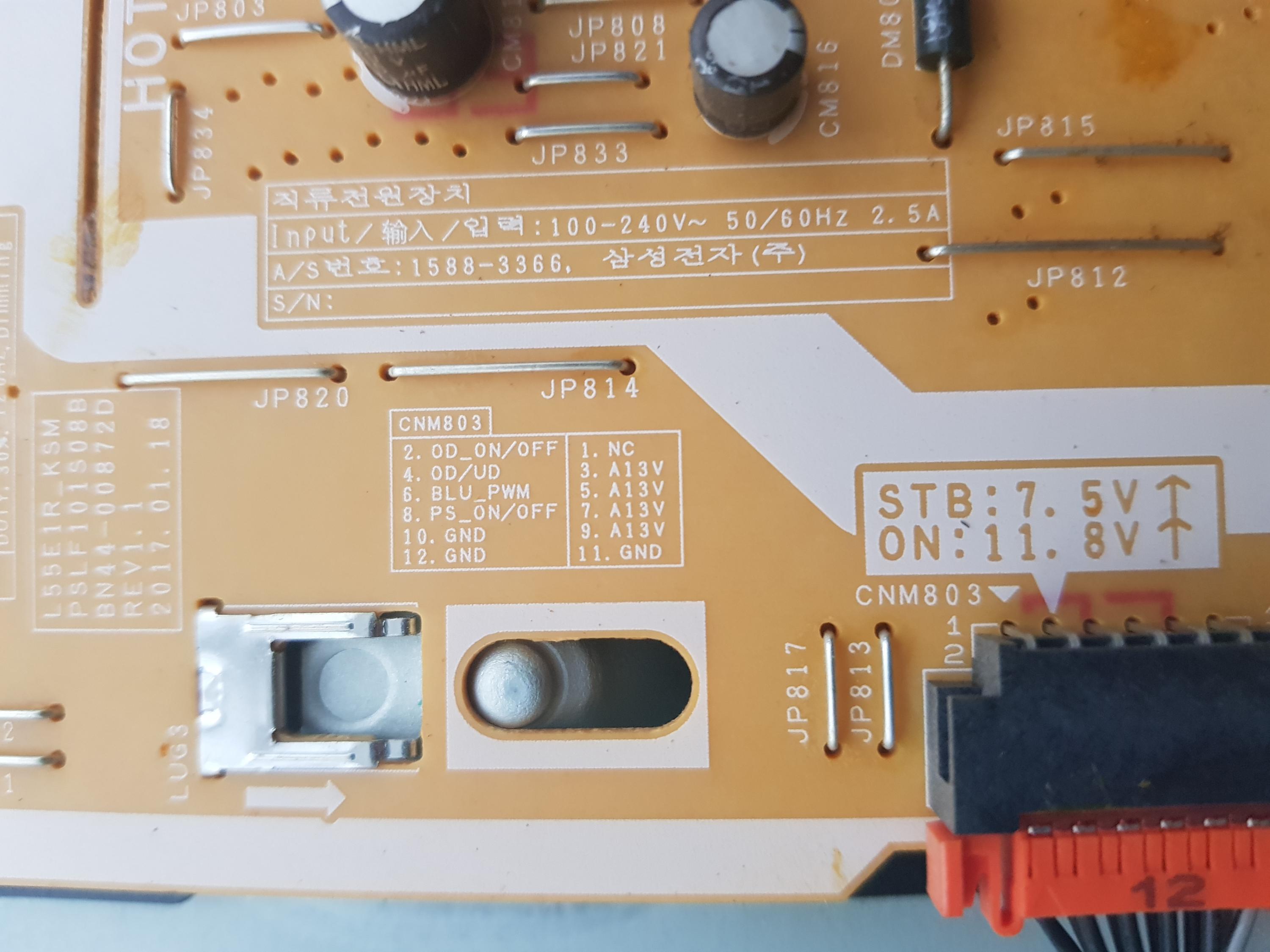

    Tcon fuse has 12v
    Pin 1 Nc 3.26v
    Pin3 13v 12.7v
    Pin5 13v 12.7v
    Pin7 13v 12.7v
    Pin9 13v 12.7v
    Pin 11 and
    Pin 2 of on/off 3.3v
    Pin4 od/us 3.26v
    Pin7 blu_pwm 3.26v
    Pin8 ps_on 3.26v
    Pin 10 gnd
    Pin 12 gnd

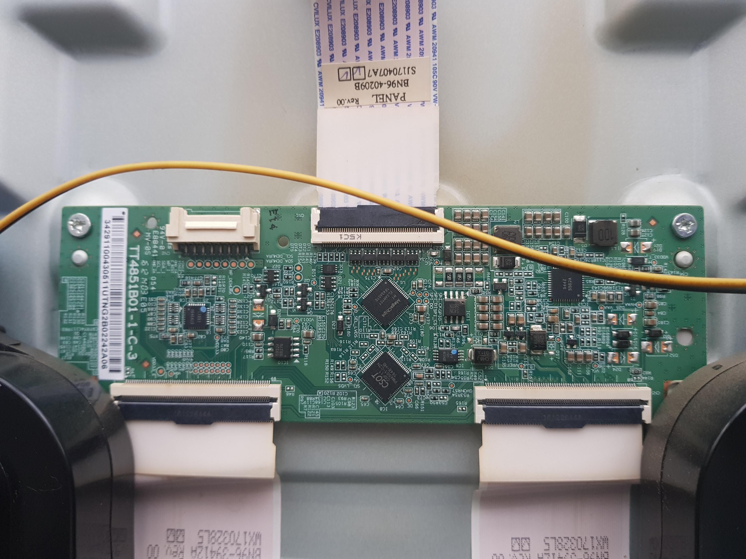

    Re: Ue49m5500 no picture but backlights

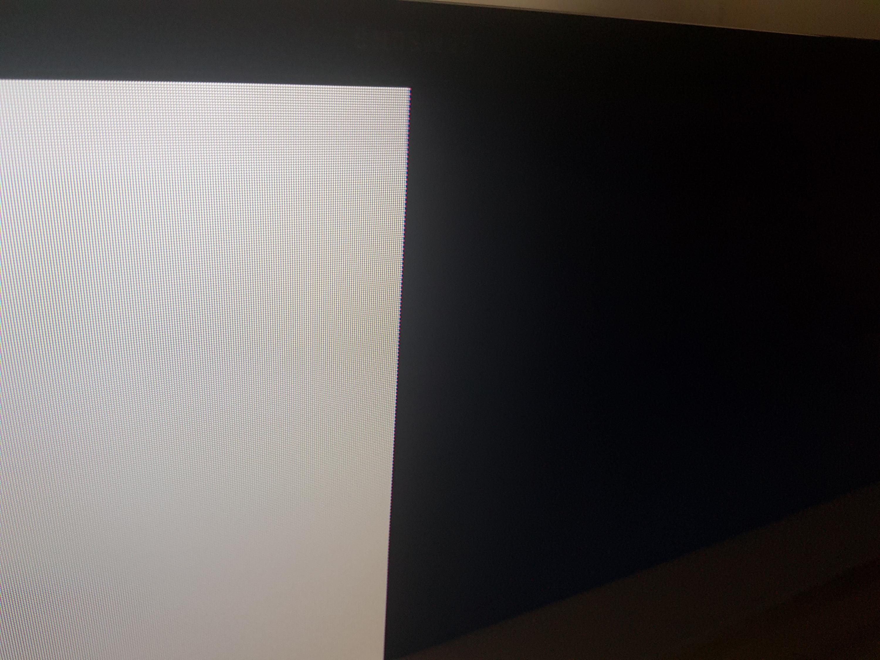

    If I disconnect the left side tcon ribbon I have a white screen
    If I disconnect the right side ribbon I have a blue screen
      You shouldn’t see a blue screen. You can check the LVDS pairs with an oscilloscope, while flicking the menu on and off with the remote. Kinda crude way of testing if the main board works. Other than that, jam a new tcon in, they are usually cheap enough.
        I spoke to the guy his wife used window lean spray to clean the screen then the tv just went off but still with sound and a glow on the screen
        Would this damage the tcon ?
        I'm thinking more cof strips but cant see any damage

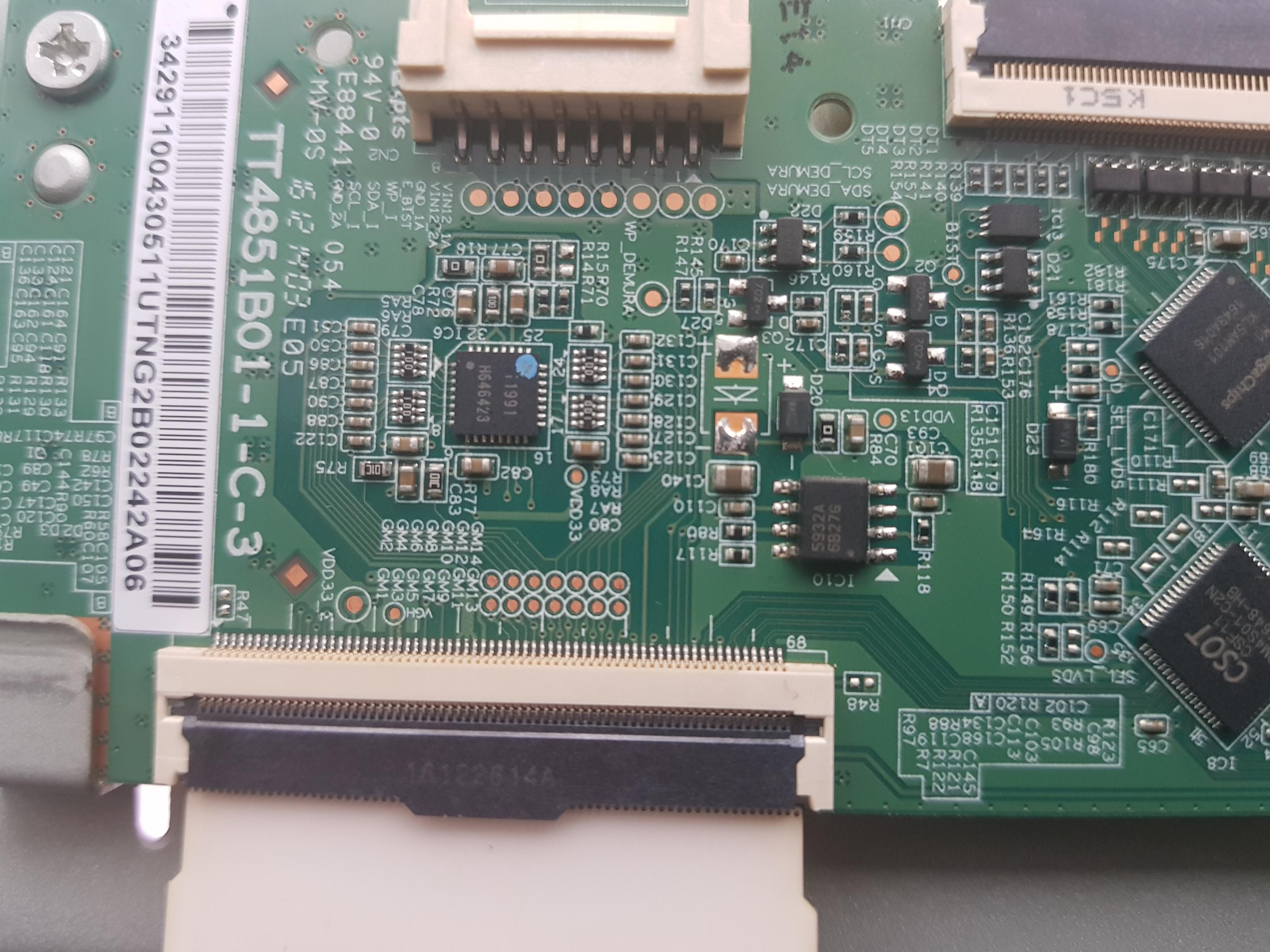

          Both lvds ribbons connected no voltages on the following pins in the picture
          With the left ribbon disconnected voltages are good of the tcon
          • diif
            • Feb 2014
            • 6978
            • England
            If you can't see any liquid damage where the film meets the screen then you might get lucky and find it's a shorted capacitor.
