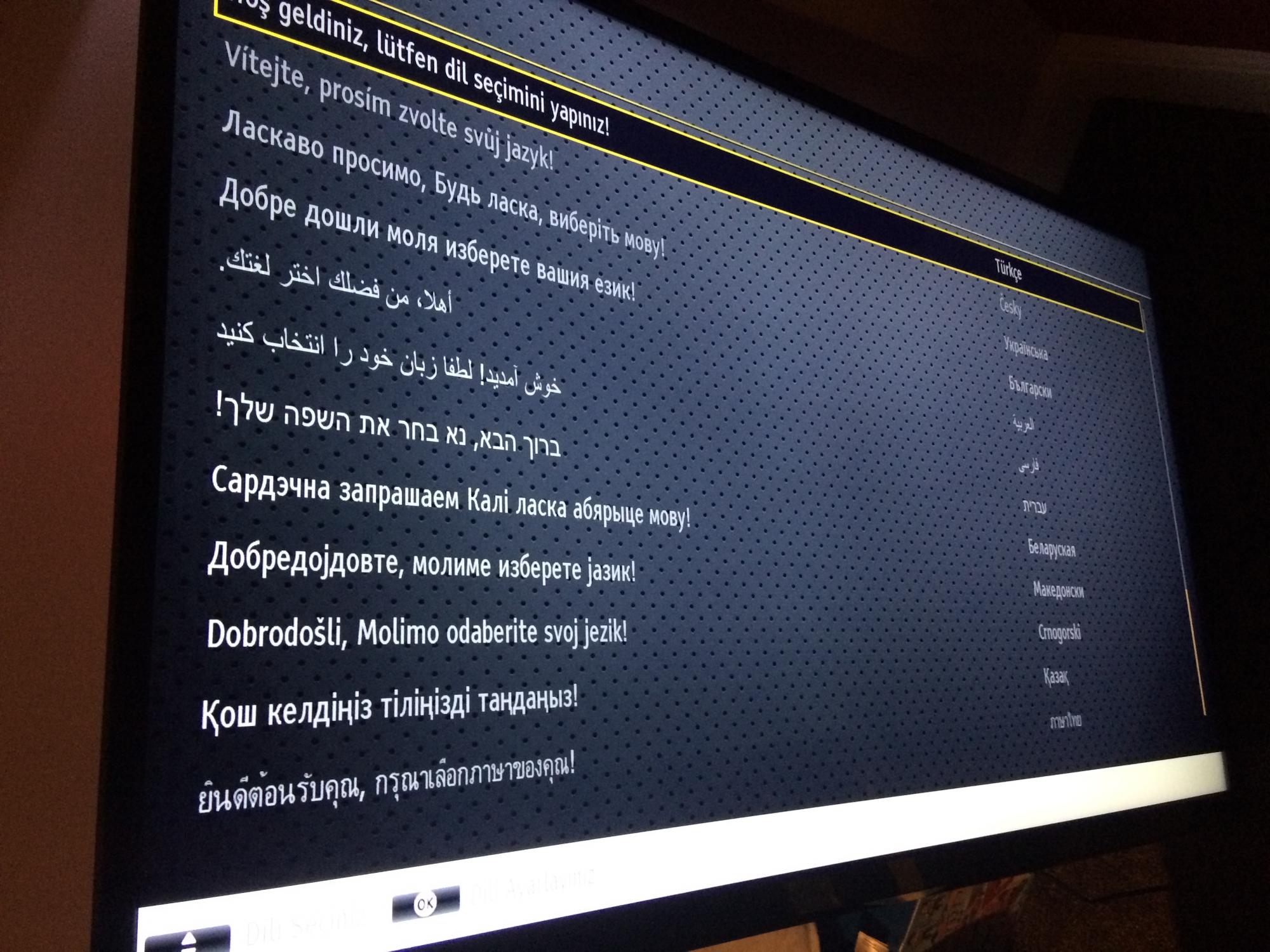

      If the OK key on the remote control is not functional, you cannot update the stick. If the OK key is functional you have a software here But I don't know if it will fit the panel.
      https://files.fm/u/qh8skpyu
      This is a JVC firmware but is behaving the same as the previous Toshiba.
      It upgrades, I get the initial setup screen but the remote control does not work.
      The white band at the bottom of the screen disappears when I push up the jog on the tv but that's it, nothing else seems to happen.

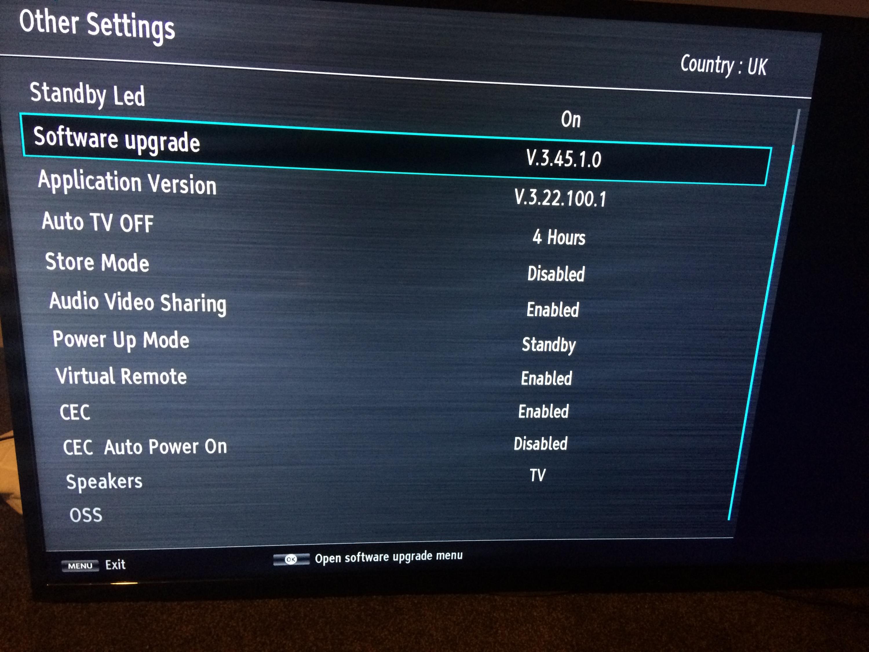

          Re: Tv Digihome 50292UHDDLEDCNTD restarts and blinking standby light
          I've ordered a replacement board from fleaBay and it fixed the tv.
          This is the software installed on it, see attached picture.
          Is there any possibility to copy the firmware from the replacement board onto the original board?
          It's a shame to throw it away just because it hasn't got the right software.

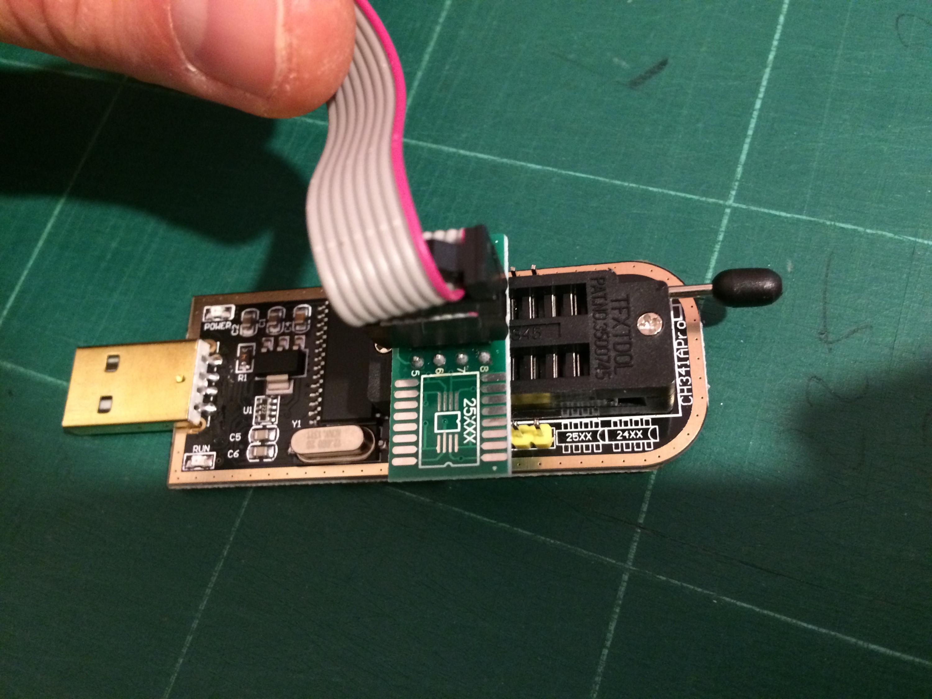

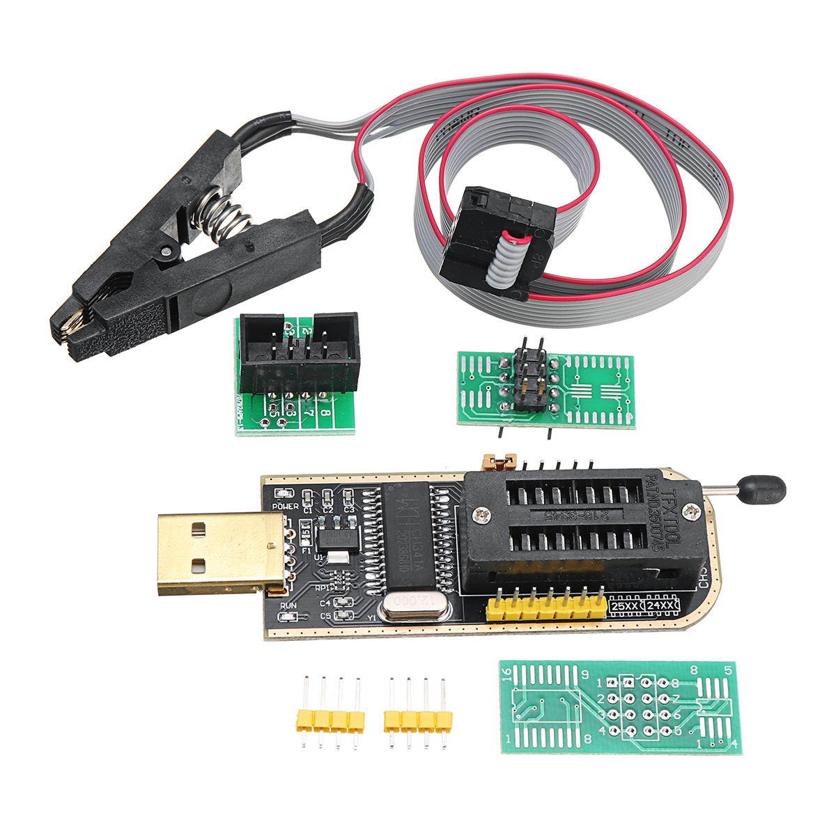

                              To repair the old motherboard you will need something like this (CH341A). It's cheap.
                              • geo86
                                • Feb 2020
                                • 27
                                • United Kingdom
                                #35
                                Do I have to remove the chip from the board or can I program on board?
                                Sorry, never done chip programming before.
                                  It is written directly on the board.

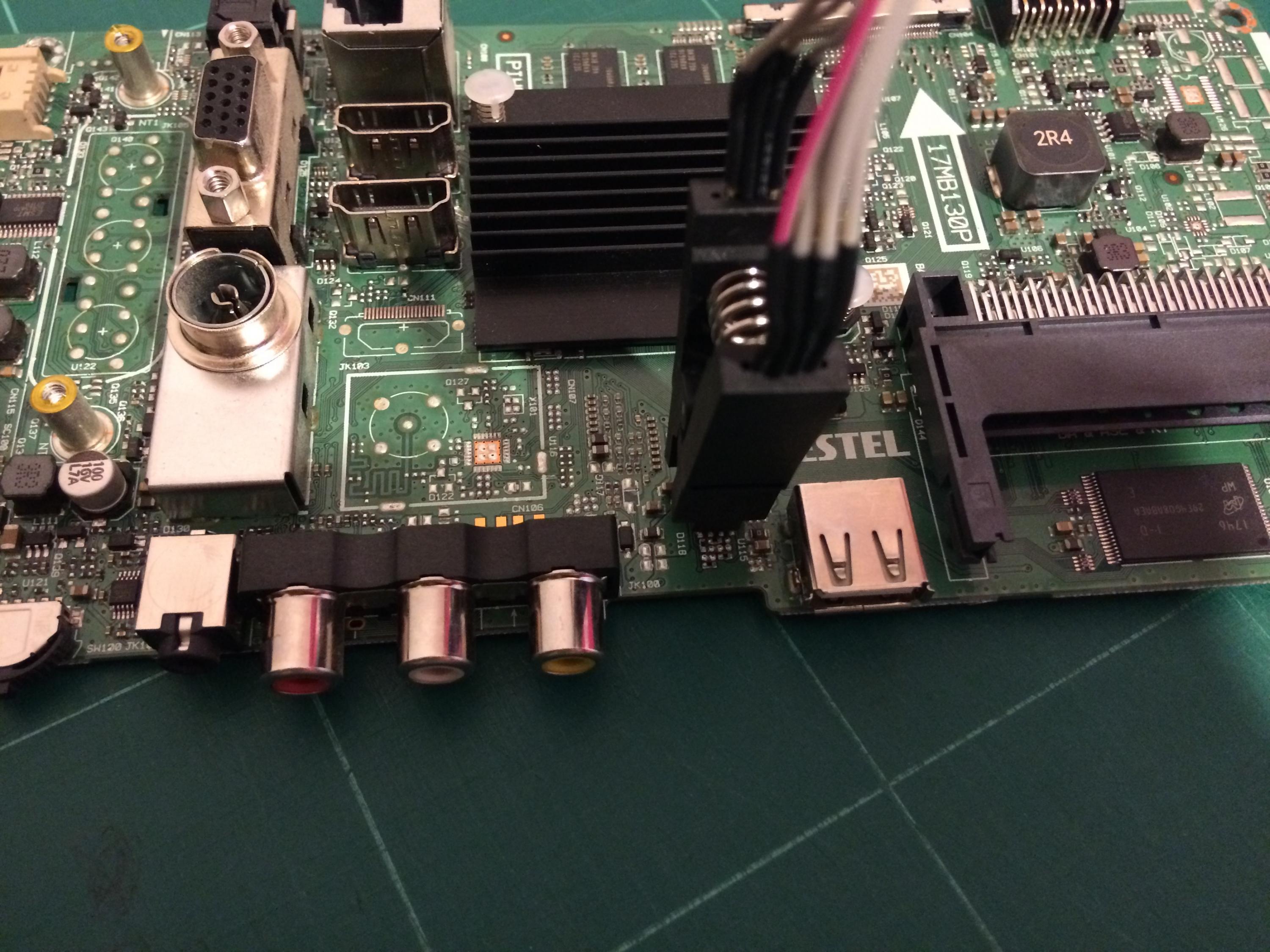

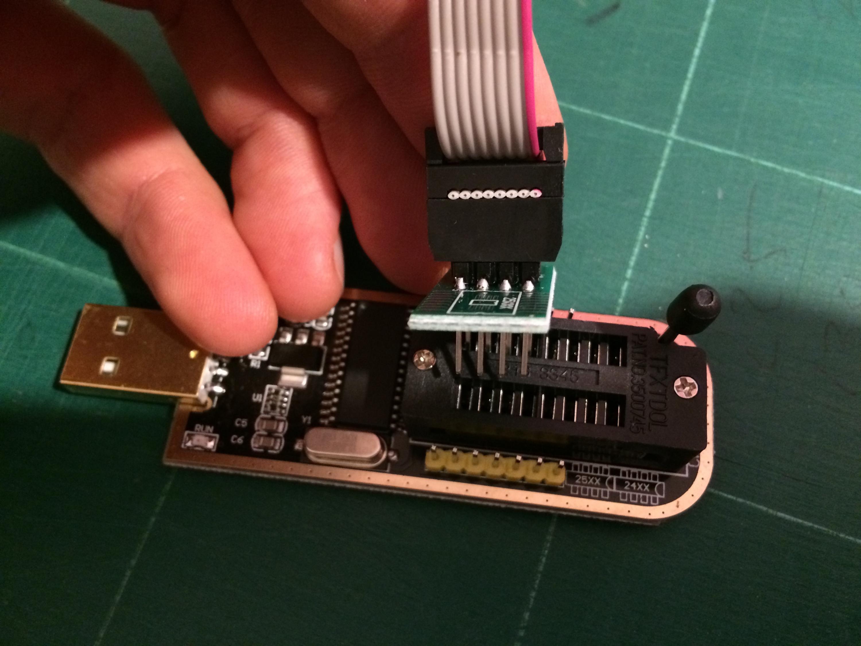

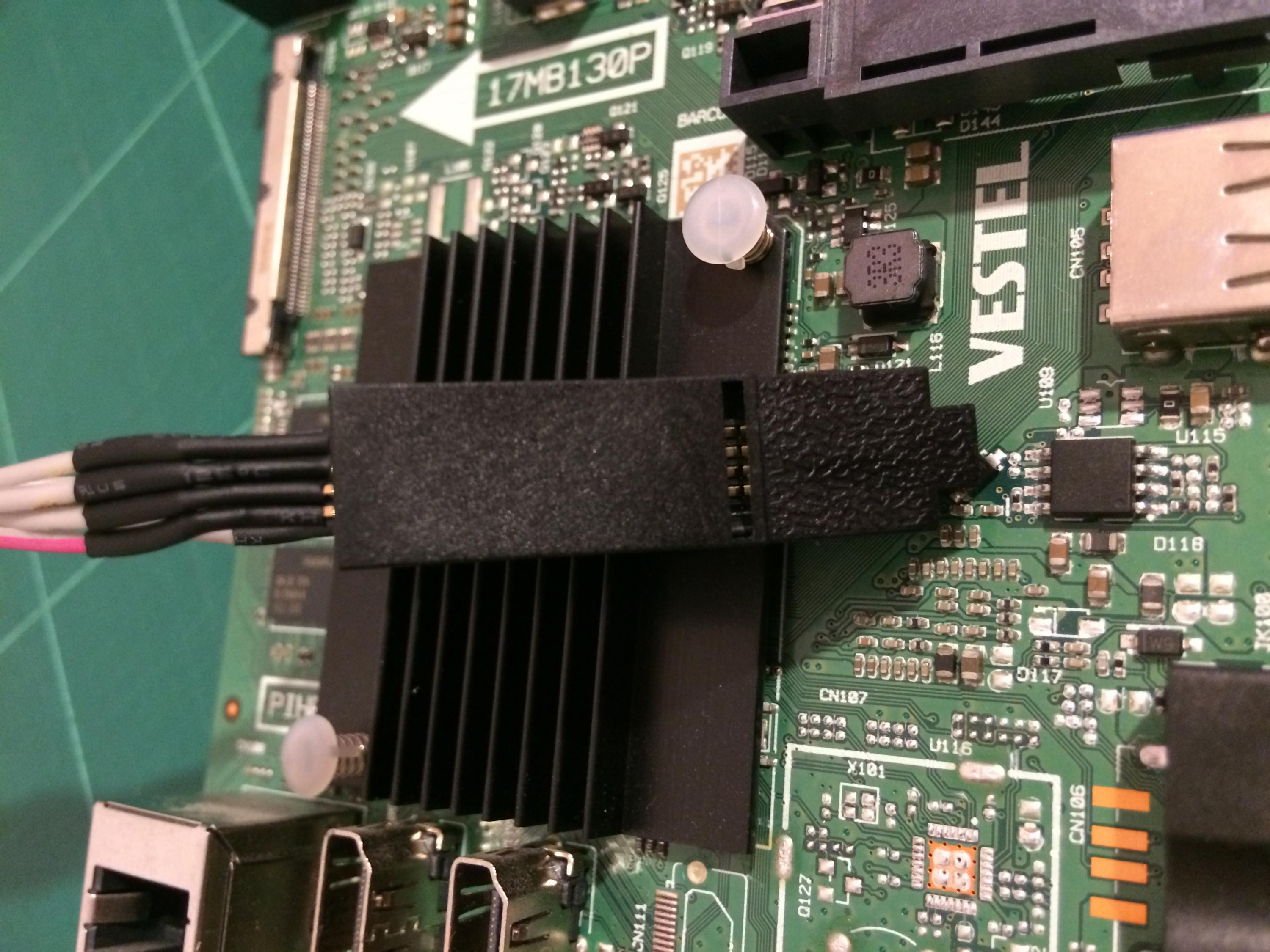

                                    #37
                                    I've received the programmer today and I bumped into another grey area.
                                    When the clip is not connected to the chip, the programmer's status is "Connected" and the red LED light on it is on.
                                    When I connect the clip to the chip, the programmer disconnects and the red LED light goes off. Also, some components next to the USB connector seem to get really hot.
                                    It happens on both bad and good board. It seems to be a shot-circuit or a low resistor that's causing that.
                                    Is any way around without de-soldering the chip? I don't have any tools though.
                                    • R_J
                                      • Jun 2012
                                      • 9624
                                      #38
                                      The problem with those clips is that you are also feeding the (5or3) volts to the whole main board, and the usb port usually can't supply the current. The voltage from the clip is also connected to the cpu, memory, etc. not just the spi/eeprom chip
                                      • geo86
                                        • Feb 2020
                                        • 27
                                        • United Kingdom
                                        #39
                                        Good point, I didn't think that far.
                                        Would it be possible to write the chip while the board is installed and the TV is on? This way it will be powered from TV's PSU but not sure if it's safe to read/write data?
                                        • R_J
                                          • Jun 2012
                                          • 9624
                                          #40
                                          Originally posted by geo86
                                          Good point, I didn’t think that far.
                                          Would it be possible to write the chip while the board is installed and the TV is on? This way it will be powered from TV’s PSU but not sure if it’s safe to read/write data?
                                          I don't think that would work. It would be easier to remove the ic. I have use a zif adaptor for these ic's
