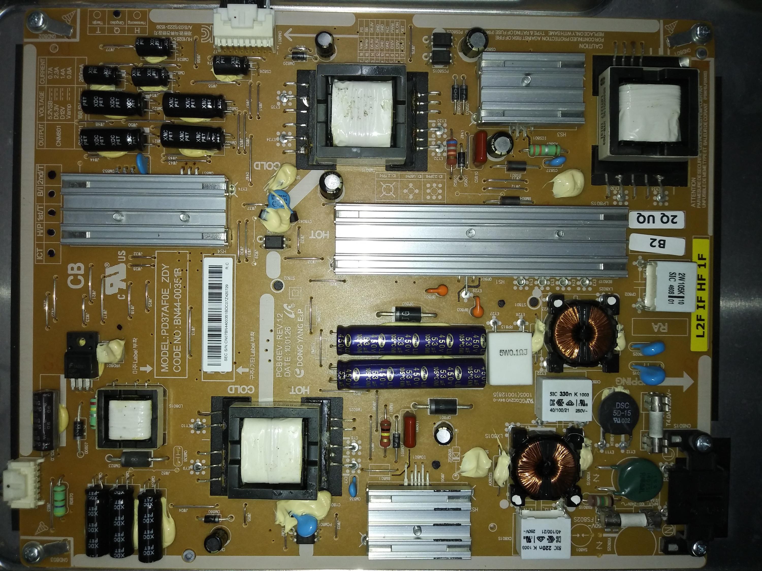

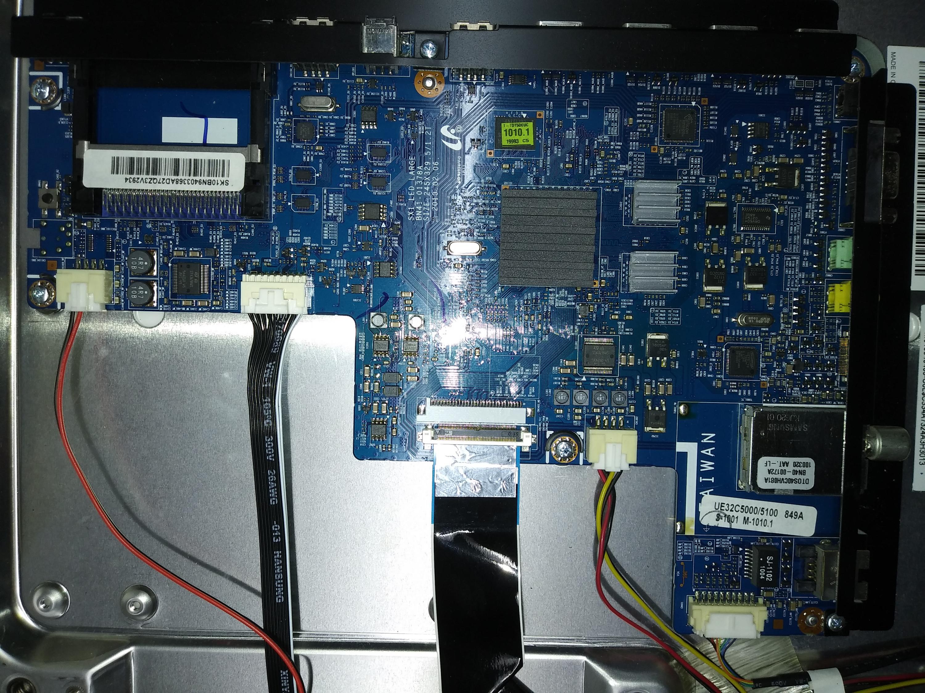

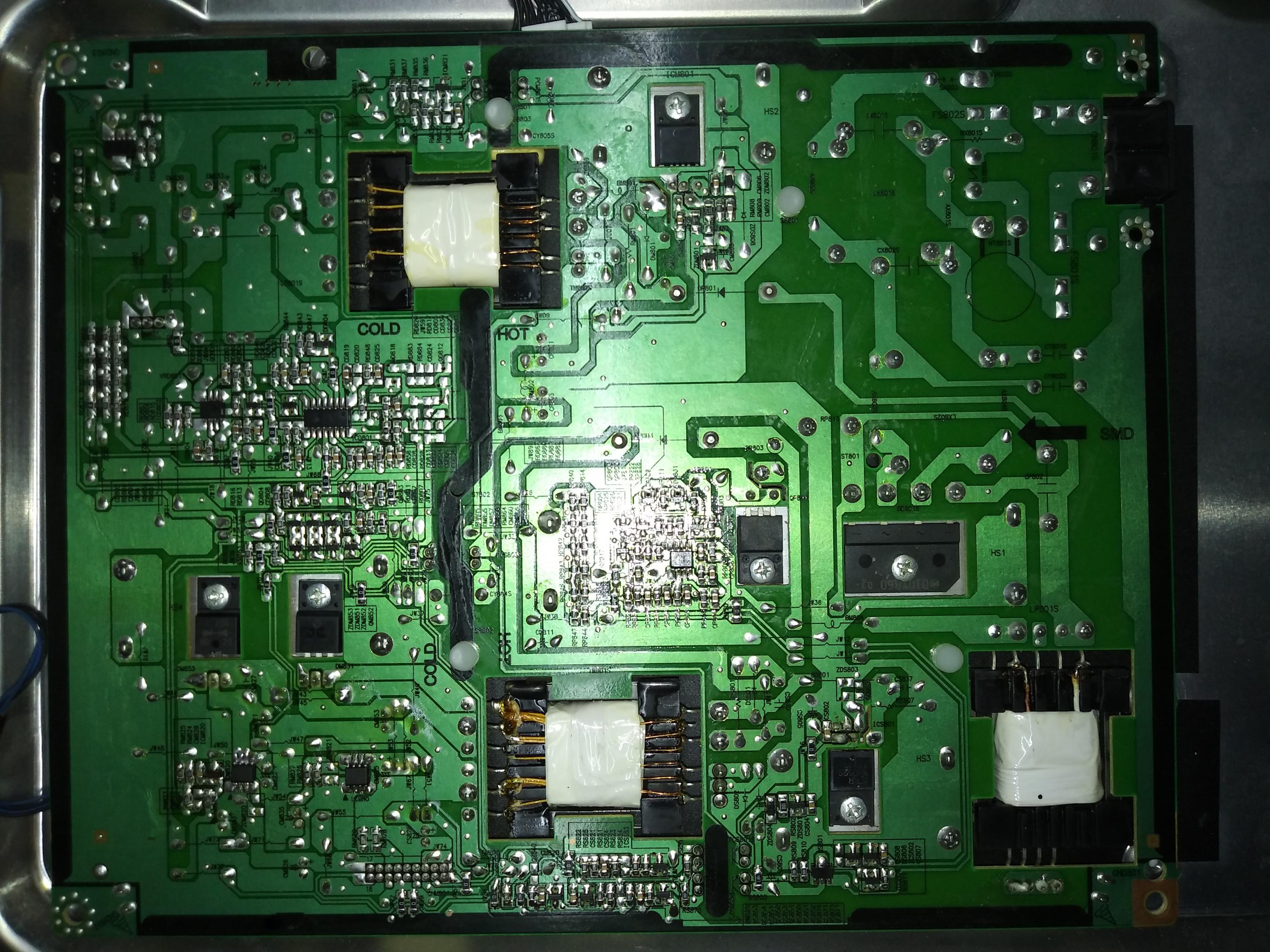

                      Re: Samsung LED LCD UE32C5100 no power no stand-by
                      Here are the boards pictures
                        Looking at the schematic, the pull-up resistor for the PS-ON is not installed so you need to use the 1K resistor on PS-ON and STBY5V to force on the power supply and see what will happen. The BLU has pull-up resistor according according to the schematic.
