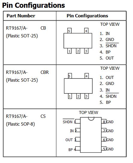

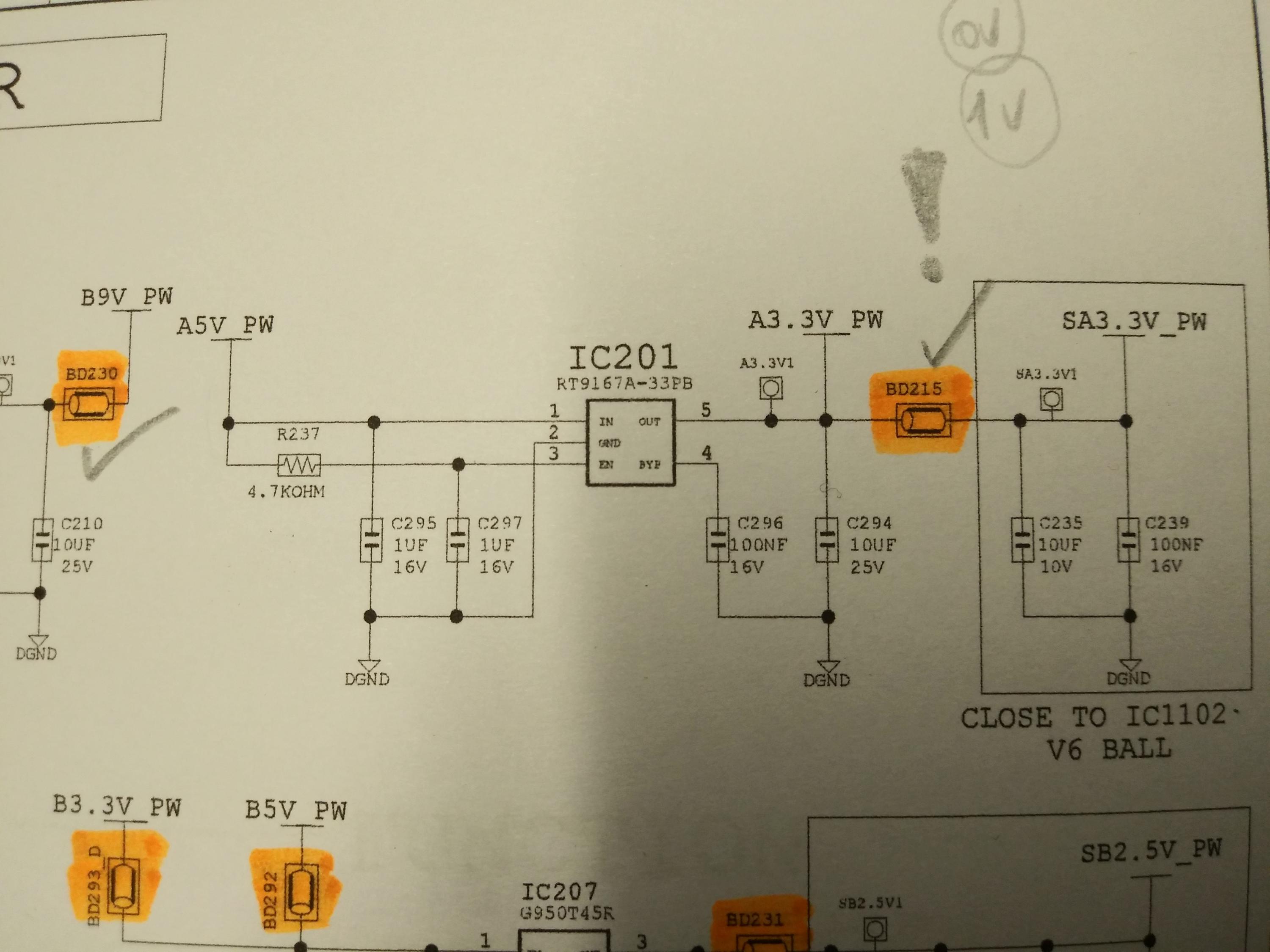

            After searching i found out that my IC201 (9167A-33PB) was receiving the 5V supply but on the output i don't get the 3.3V that supply the logic ICs including the one that controls the stand-by LED.
            When i measure the output pin my multi-meter sows zero and from time to time it gets up to 1V.
            Is there a way to measure if i have a short on the 3.3V line? If i measure in Ohms between the GND and the 3.3V it shows open circuit. (----)
            I don't have this part to replace have to order it... can i use something like resistors do go from 5v to 3.3V and safely see if the set starts?

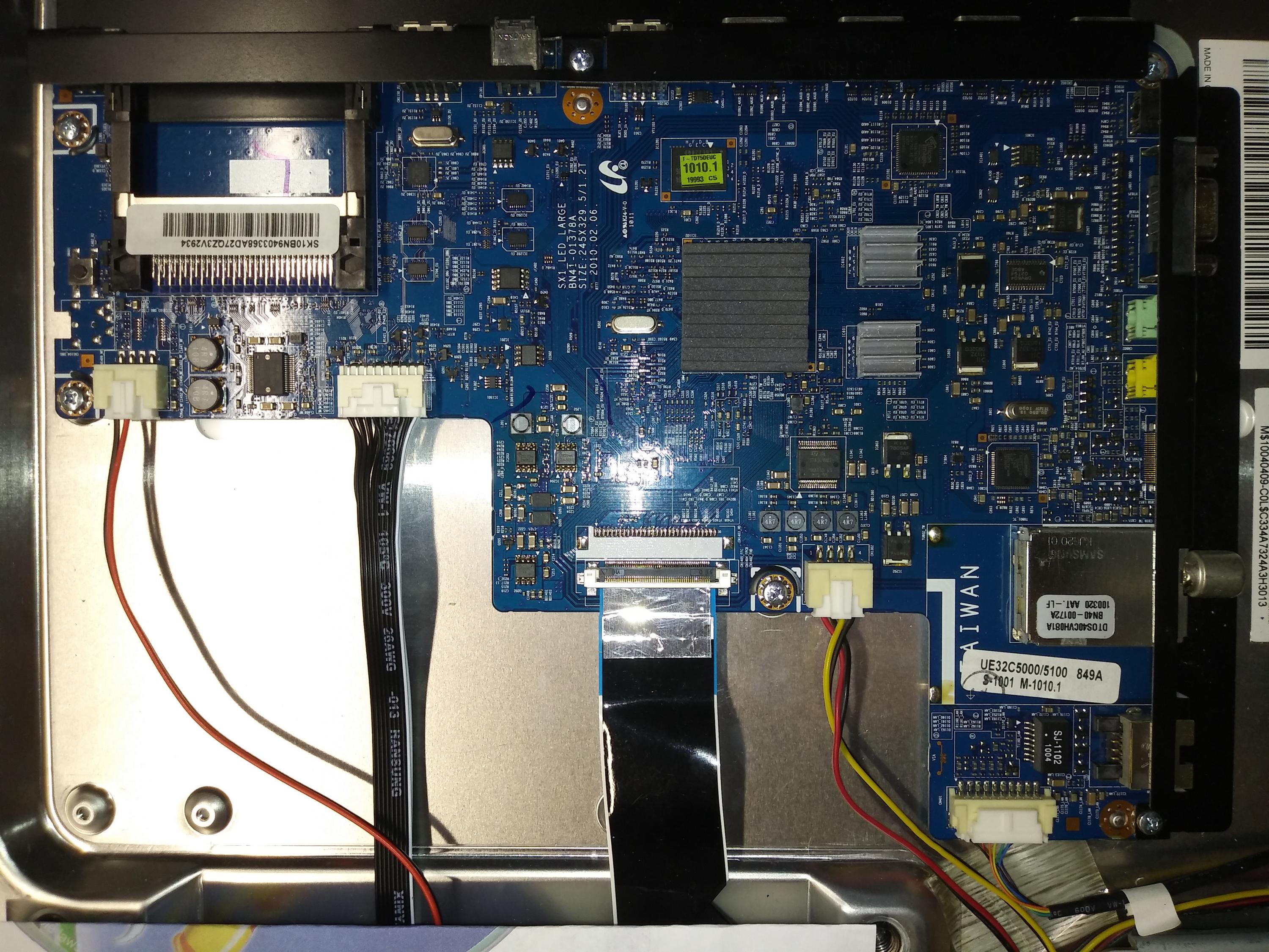

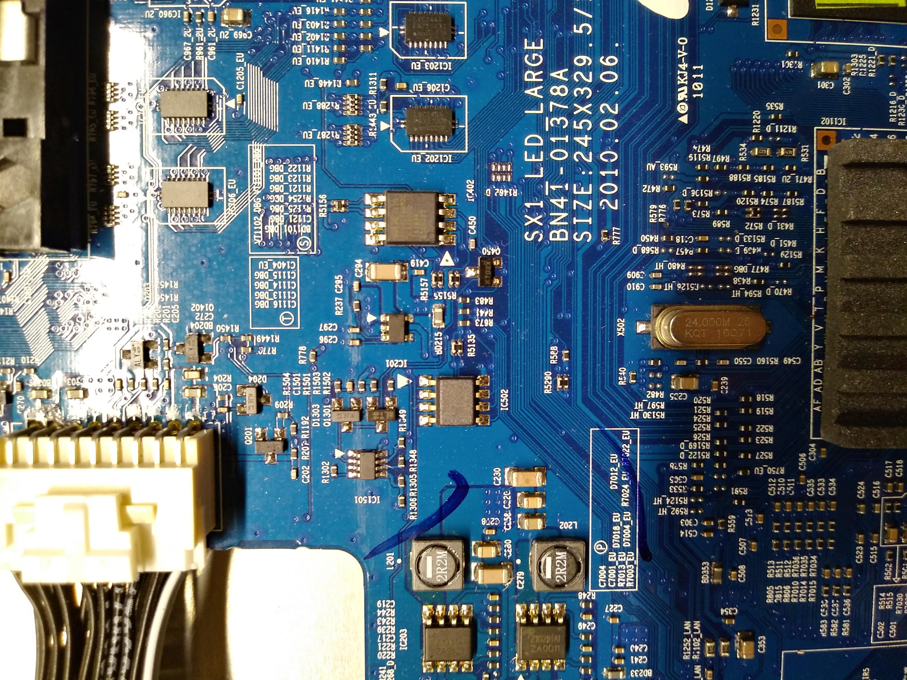

            Uploaded some pictures from the board and IC as well as the schematics page.

              Pin 1 is at 5V and Pin 3 also needs to be connected to at 5V to operate. Output should be 3.3V If not then ......
              Lift one end of BD215 and check the output voltage at pin 5
              If there's no voltage then check C294 is not short circuit and if possible measure it's value.
              Finally, replace IC201.

                The technical doc from the (9167A-33PB) says that the voltage on pin 3 should be maximum 1.6V and not 5V. I have 5V on pin 1 and around 1.4v after the resistor for pin 3.
                But i have no output on pin 5.

                  Re: Samsung LED LCD UE32C5100 no power no stand-by
                  The 1.6V refers to the minimum voltage required to enable the IC.

                    I just measured all the pins and it is like this:
                    Pin 1 - 5,2v
                    Pin 2 - 0v (gnd)
                    Pin 3 - 1,13v
                    Pin 4 - 0v
                    Pin 5 - 0,5v
                    Pin 4 should be high and between pin 3 and the 5v i only have a resistor with 4.7k

                      Just got the set working. Replaced the 4.7k resistor whit one 4.7k across pin 1 and 3 removed the micro one plugged in and got stand by and the set started after power button push. Measured the micro resistor and got me 47k instead of 4.7k
