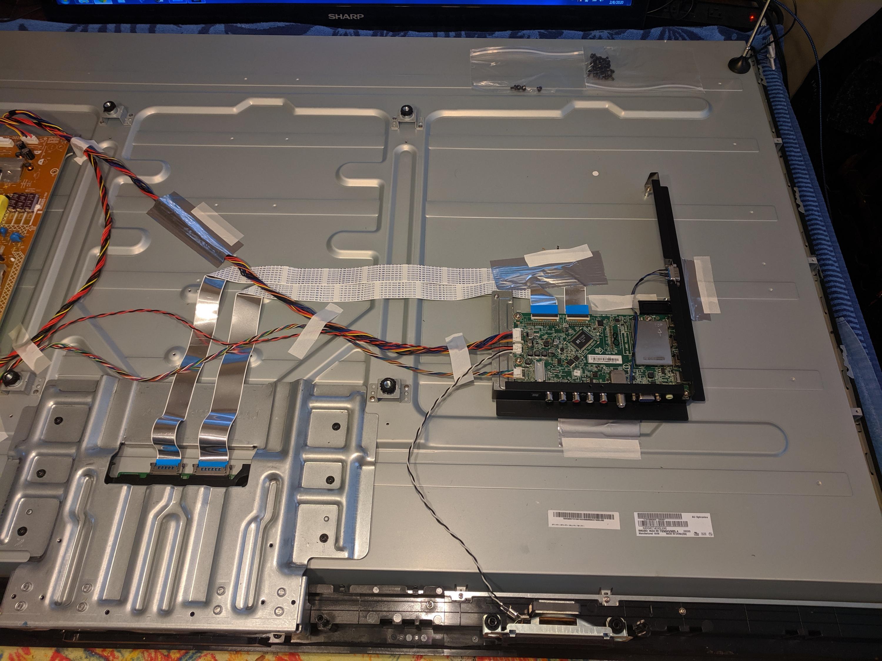

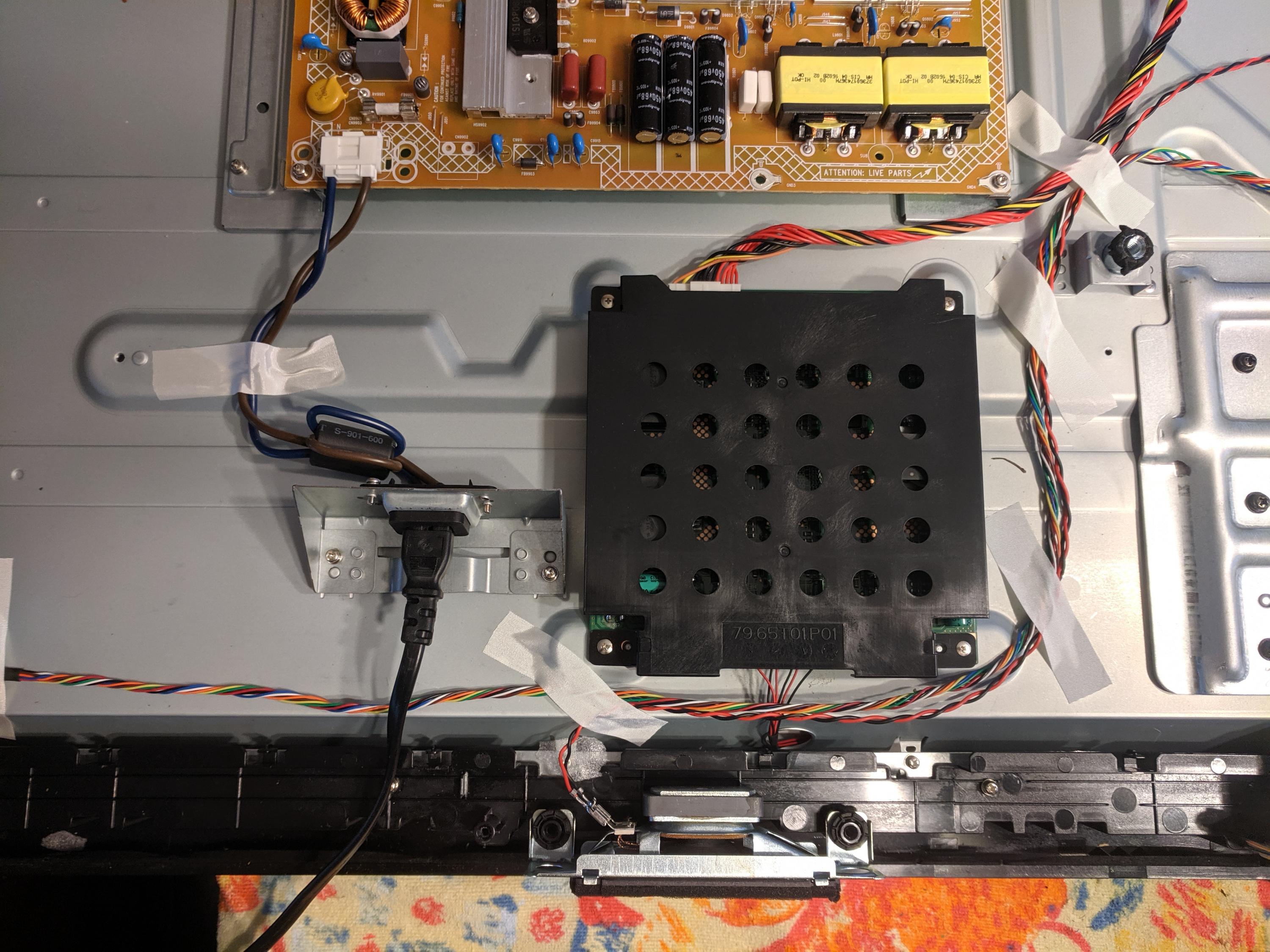

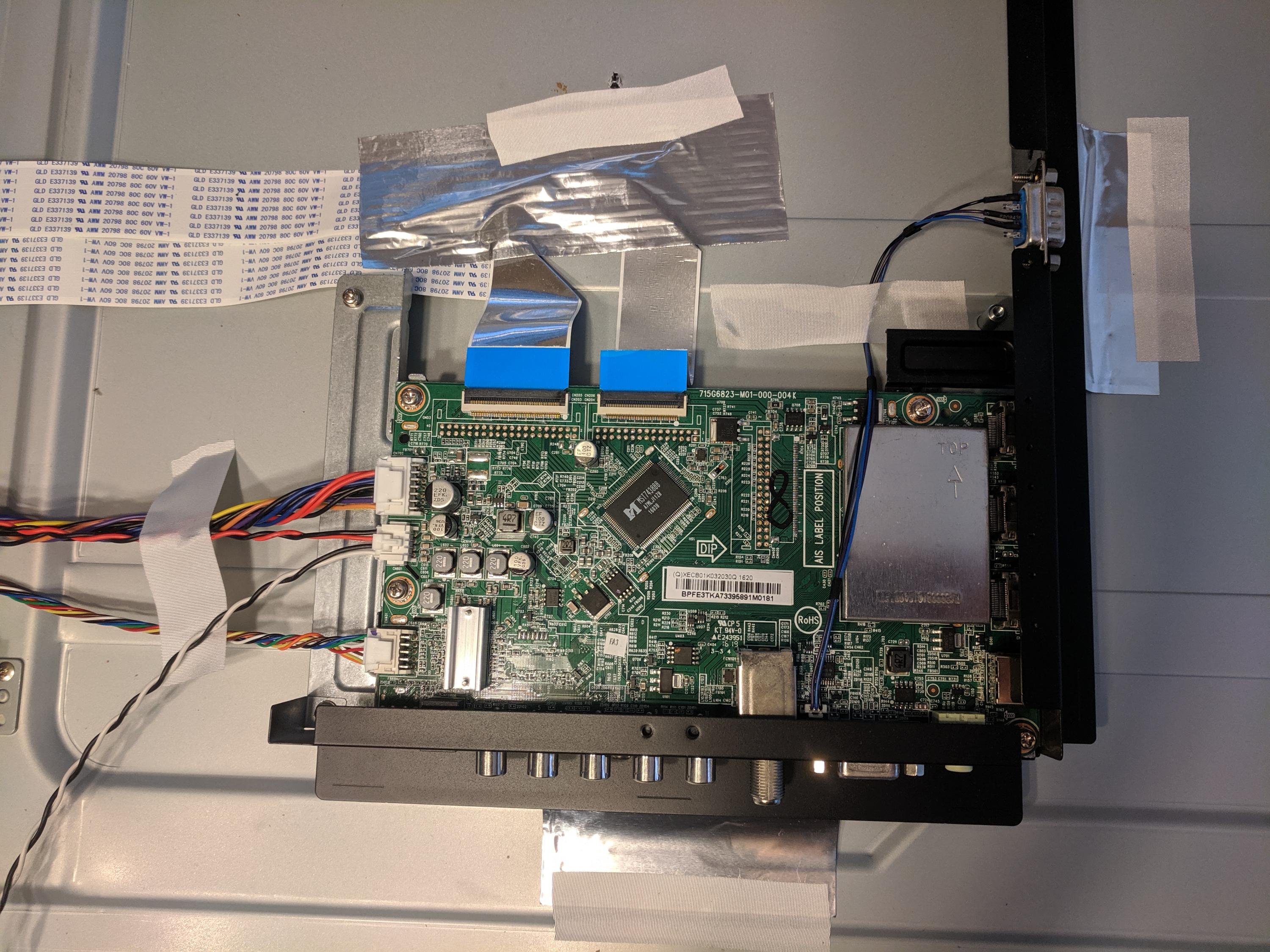

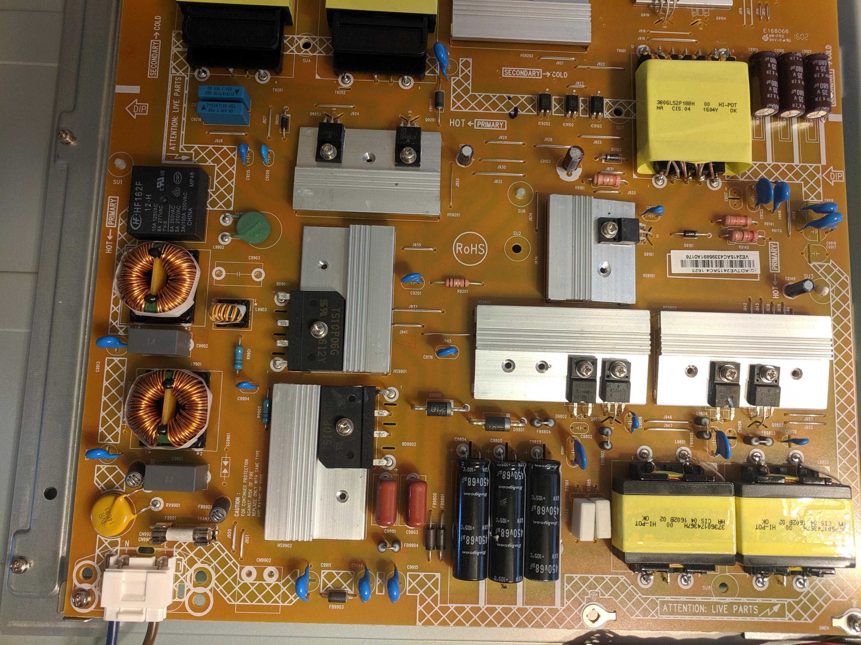

              Re: Dead NEC E655 - Can't find the service manual
              Had to step away from this for a bit, back at it now.
              Any assistance would be greatly appreciated.

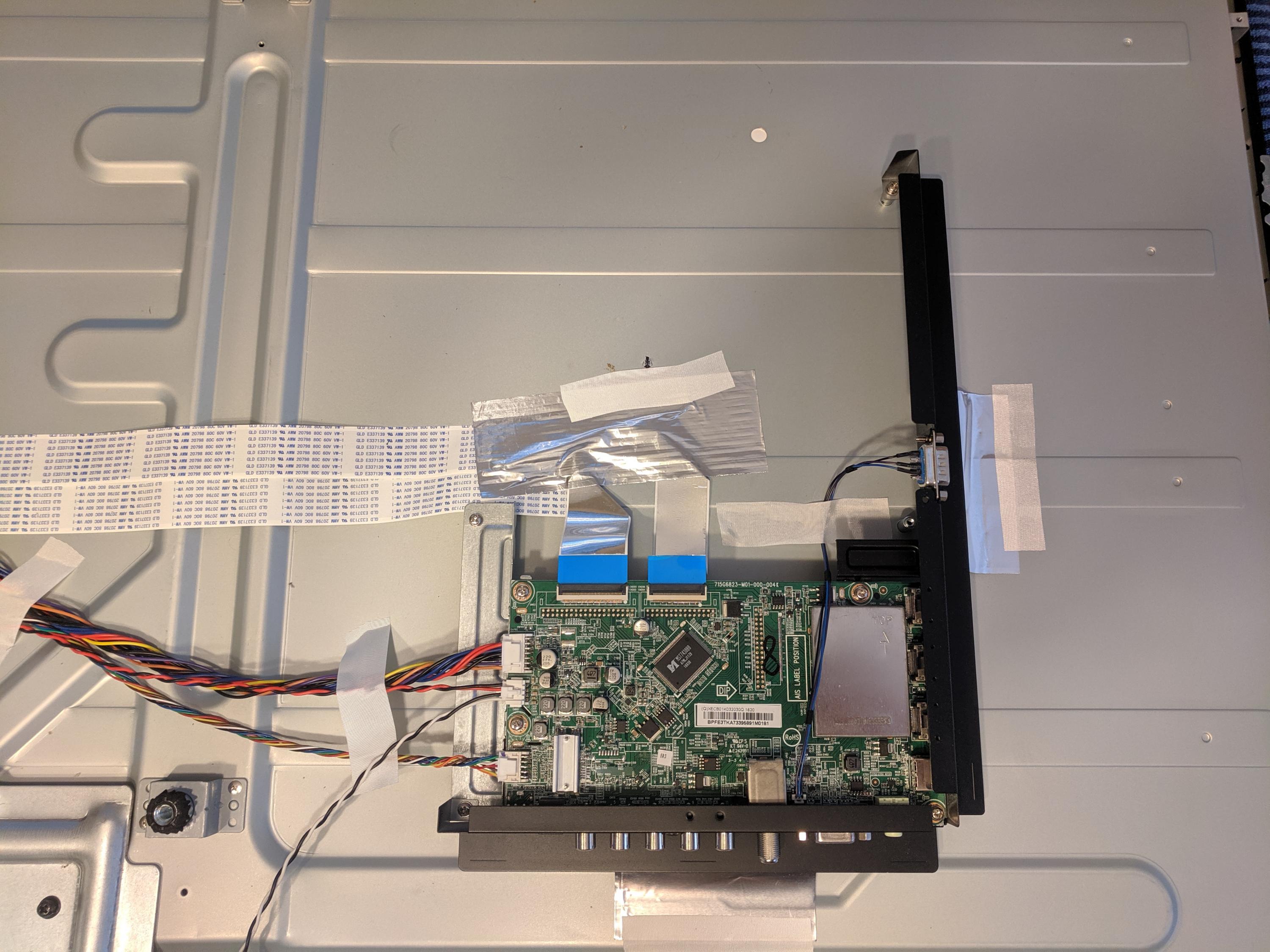

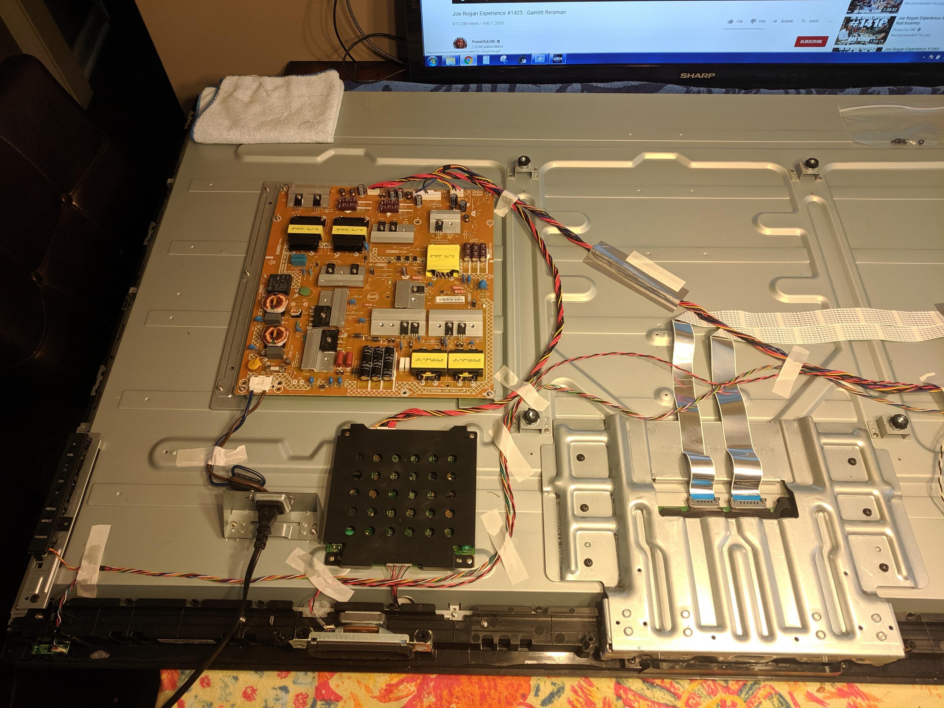

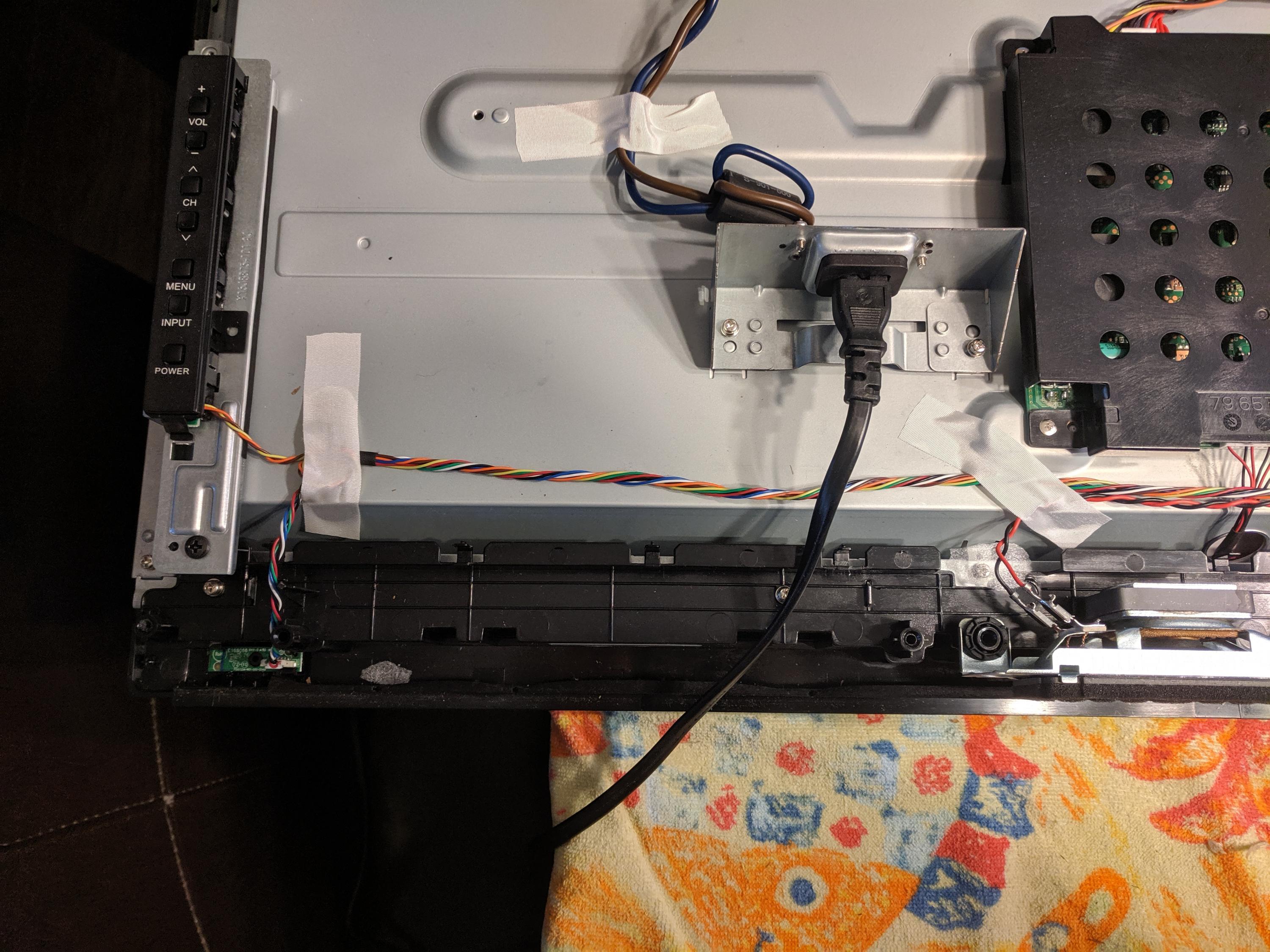

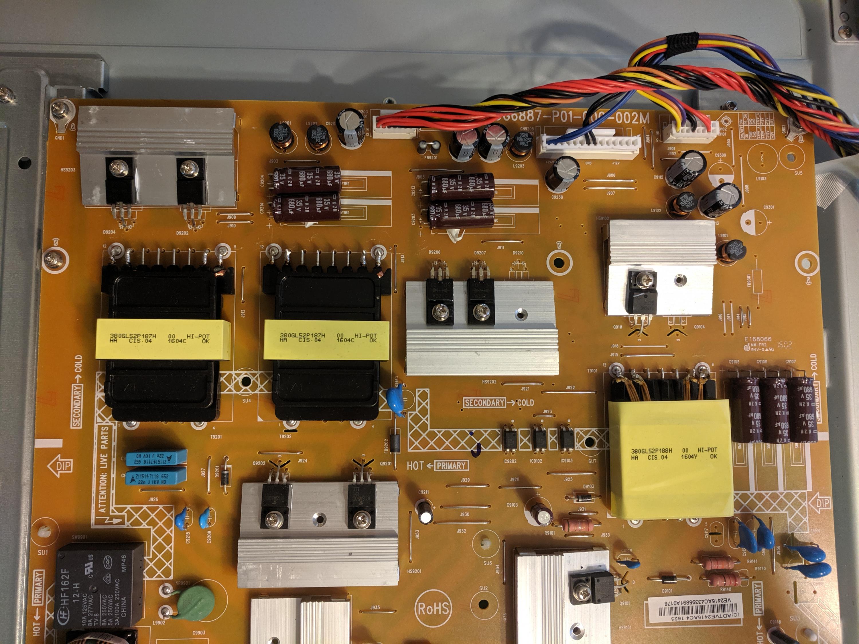

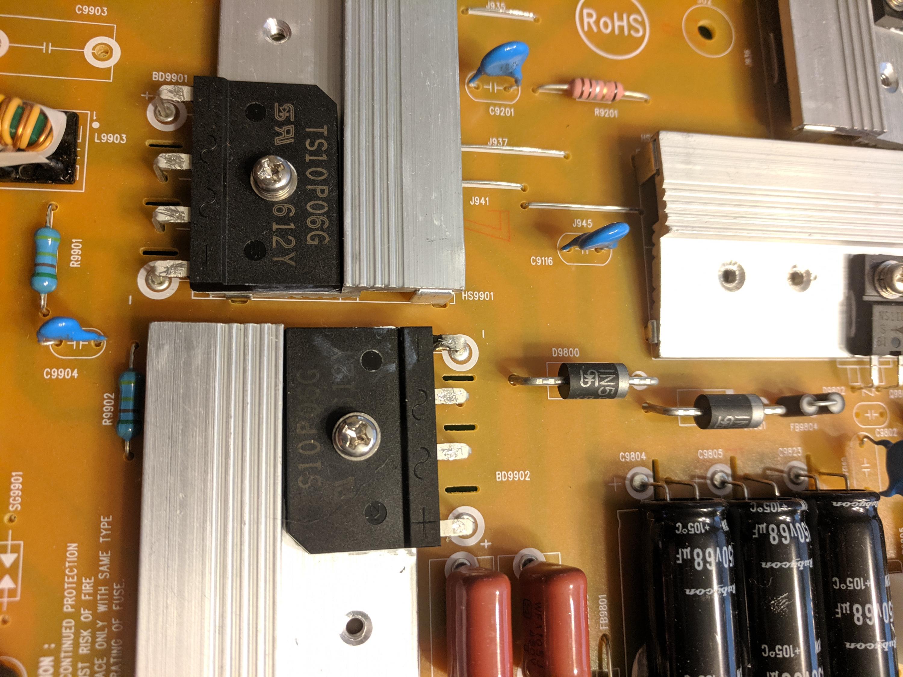

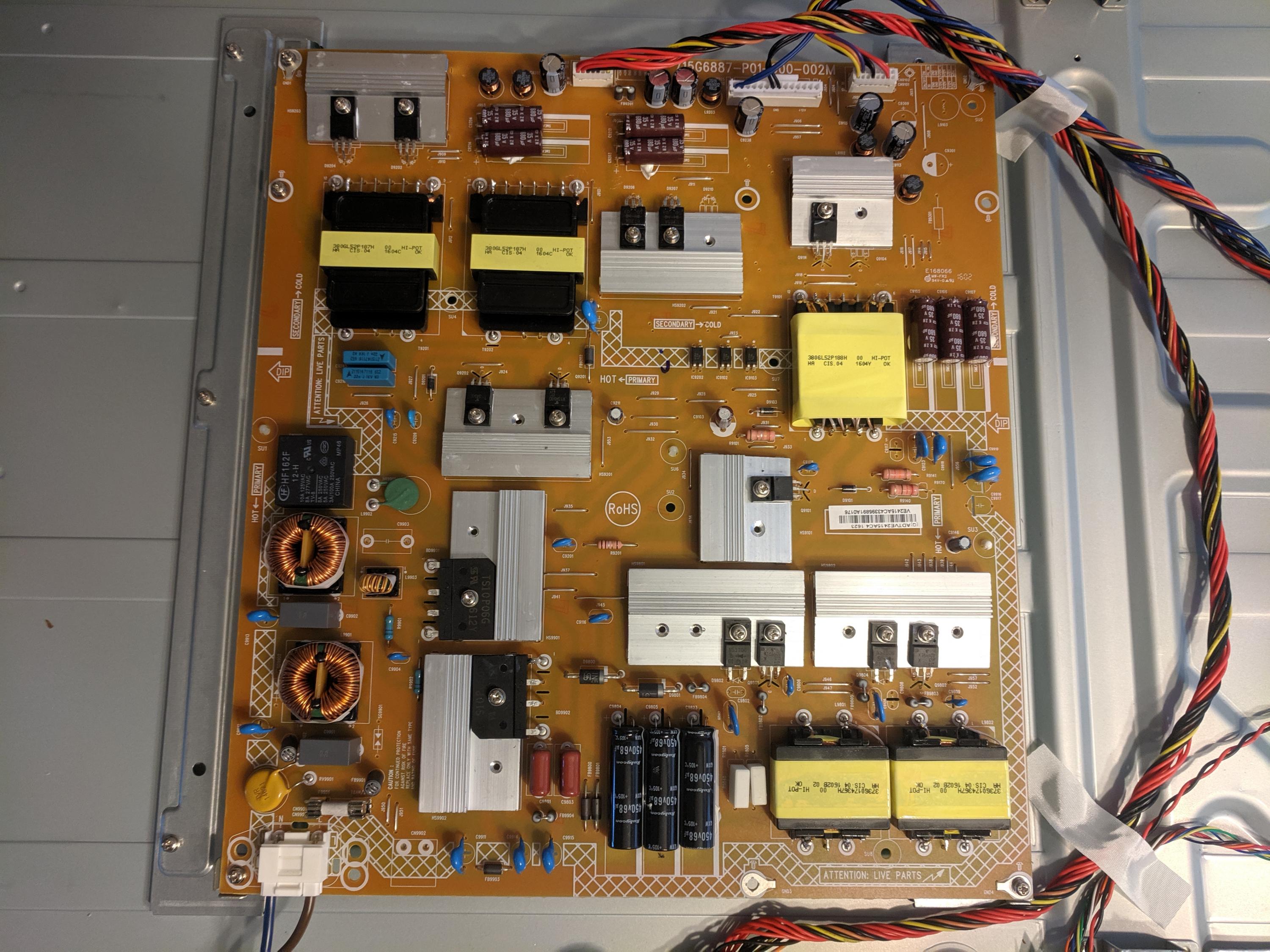

              To recap, this guy is totally dead. No reponse from the buttons and nothing from the status LED.
              https://www.badcaps.net/forum/attach...1&d=1582231278
                Check the voltage on J914/J915, it should be +12 volts. If you don't have this voltage, then check the voltage across C9103, Use J931 (hot ground) and check the cathode of D9103, this should be arouns 10~20vdc
                  Nothing on jumpers 914 and 915.
                  Measuring across C9103, the meter bounces around between about 9-22VDC.
                  J931 to cathode of D9103, the meter bounces around between about 9-22VDC.
                    Are you getting any voltage at all across C9105? Also check the resistance of R9101 to see if it is open, it should read 0.24Ω
                      Nothing across C9105.
                      R9101 measures .7 ohms, in circuit. I didn't remove it from the board to measure.
                          Locate C9109, check the voltage across it. It looks like the ciruit is trying to start, thats why the voltage is jumping on C9103
                          Have a good look at the connections on the transformer, T9101 to make sure there are no poor solder connections.
                          There are two diodes D9104 & D9106, check that they are not shorted, they are on the back of the board near T9101.
                          If the diodes are ok, then I would try replacing C9103 and C9109, it could be they are bad.
