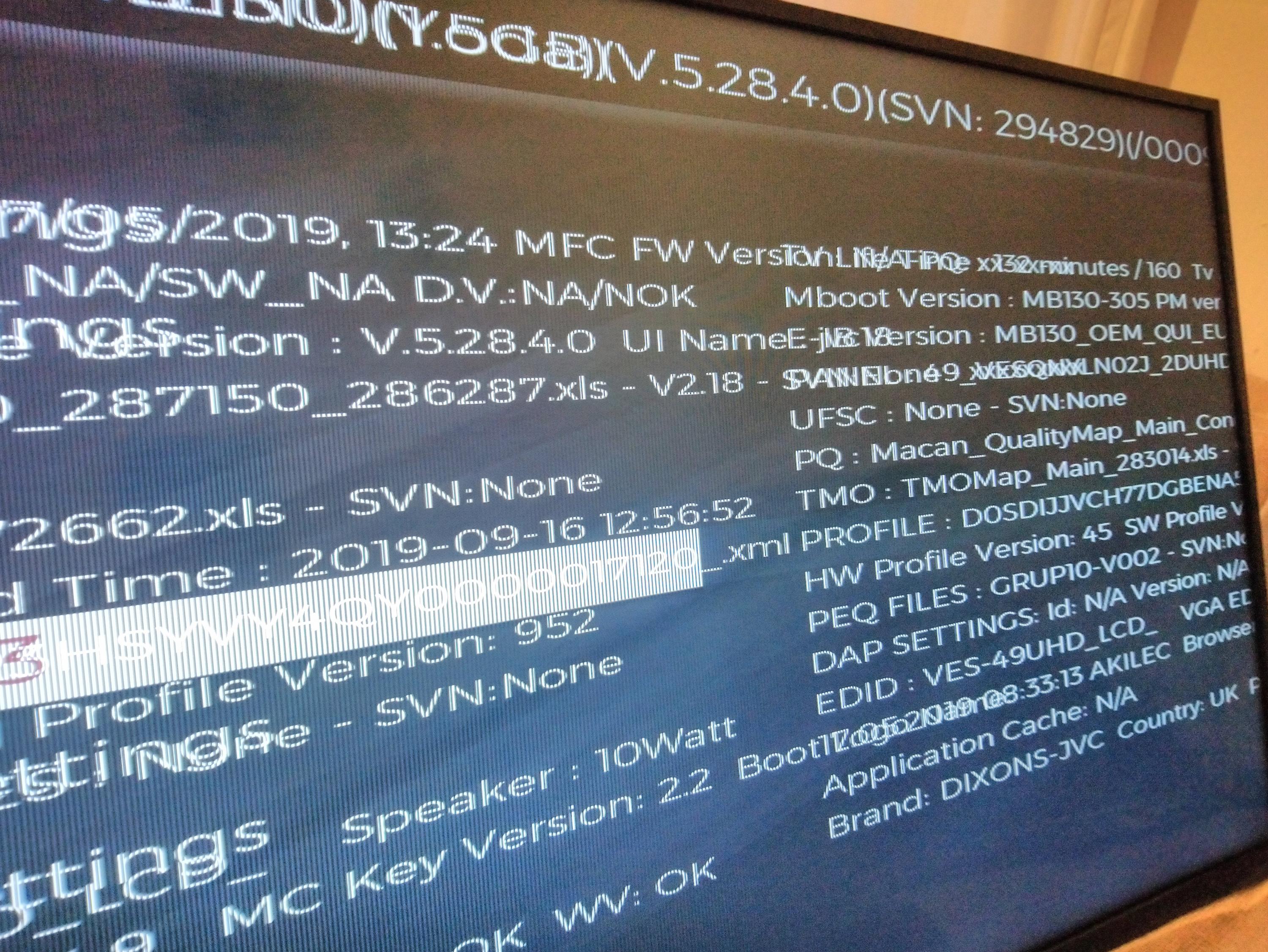

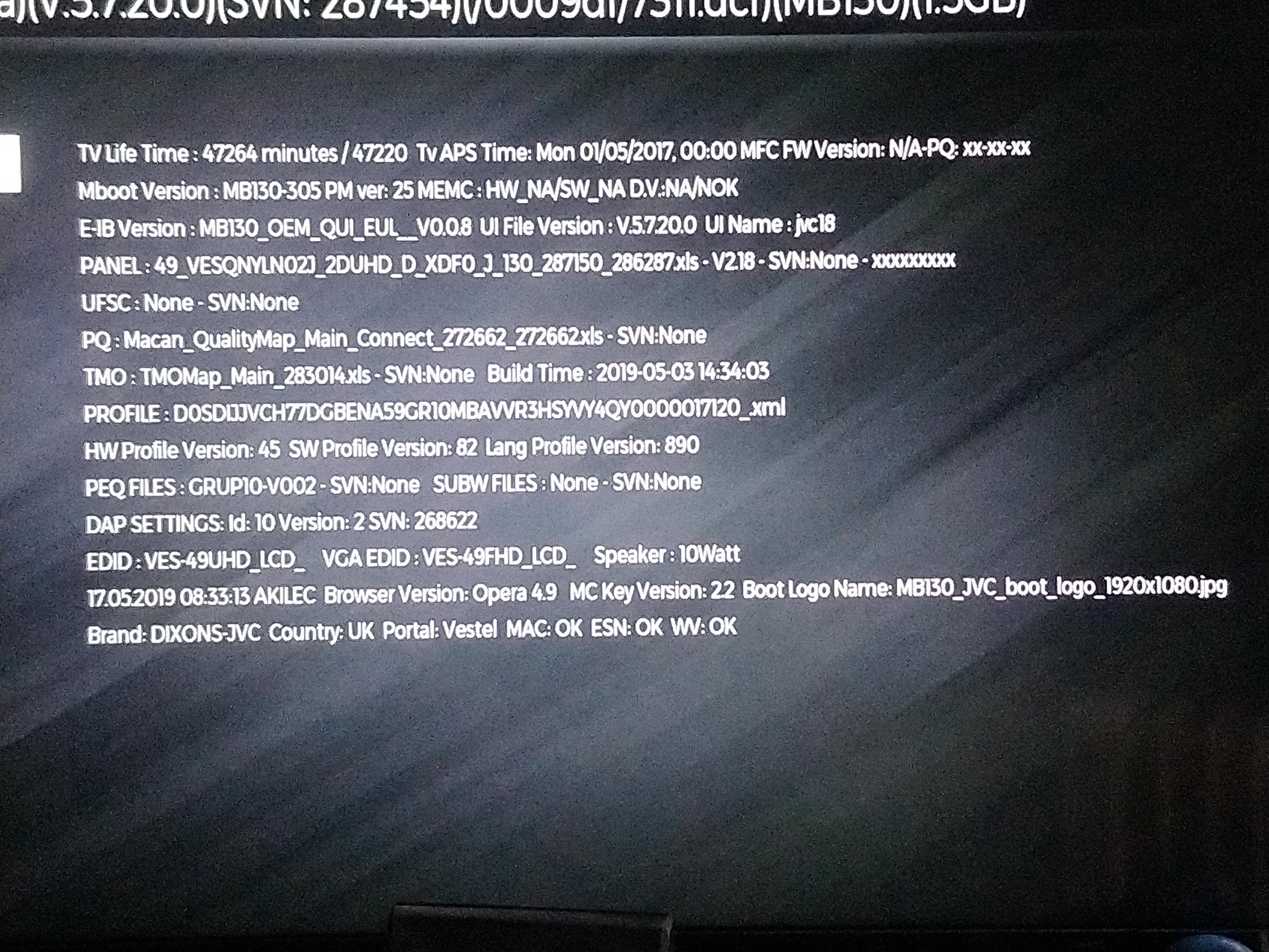

    Please can someone help me?
    I flashed a v3 firmware (17mb130 v3.62.73 https://files.fm/u/vdteeuch) for Vestel 17mb130 and now my TV is stuck in standby mode.
    The correct firmware I need was 17mb130 Full V.5.7.20.0
    I only found out after using translating some Turkish websites that I could not do this. Is there any hope for my TV?
    The mode and serial are:
    LT-49C890(A)
    The software I flashed was: 17MB130 full V3.62.73
    The Software I needed to flash was 17MB130 Full V.5.7.20.0
    Then will not boot after. Only flashing standby light.
    I have all these files backed up but nothing more.
    Is this reparable?

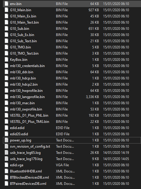

          Re: Recovery Options for JVC LT-49C890 - Vestel 17mb130 Firmware Bricked
          Originally posted by arizanotlari
          Thank you, I tried this file but I get an error when flashing at about %37.
          I am using a different board I purchased now. So I just need to get the TV to recognize my Panel.
          I have the same board but for panel VES 40 UHD. SO some how I need to fix that?
          Can I do it witht he files I show in my uploaded image?
              Originally posted by yokoono
              "Thank you, I tried this file but I get an error when flashing at about %37."
              How did you proceed? When updated with this software does not show the percentage.
              I purchased a new 17mb130 board but the panels do not match :-(
              So now I need to somehow get my panel to display in 492 4k uhd. But it's split the JVC logo, and the menu does not fit on the screen correctly.
              From my files in the image I uploaded and I fix this board? I think I just need the original firmware but I don't have that.
                Unplug the eeprom / flash memories from the old board and reload the new board.
                The soft full update is done with the OK key pressed.
                  I have tools but I am only capable of soldering larger components.
                  This is what it looks like now,
