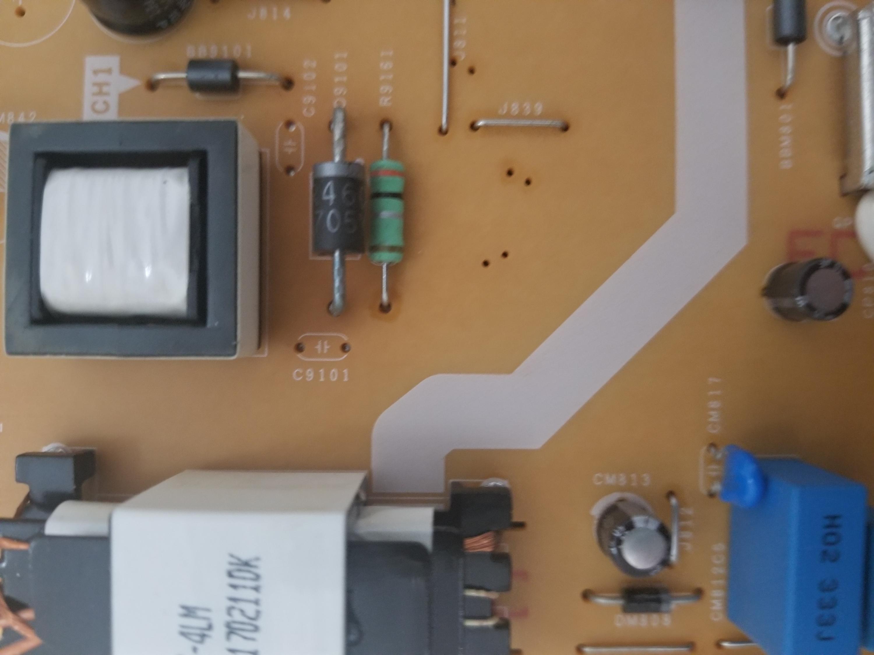

    Re: Samsung UN55J6201AFXZA Powers On+ Image but No Backlights
    You need to check the resistance of R9162 and R9161 (done with power supply disconnected from ac)
    It is hard to tell from the picture but I think R9162 is 27Ω, R9161 is 0.3Ω

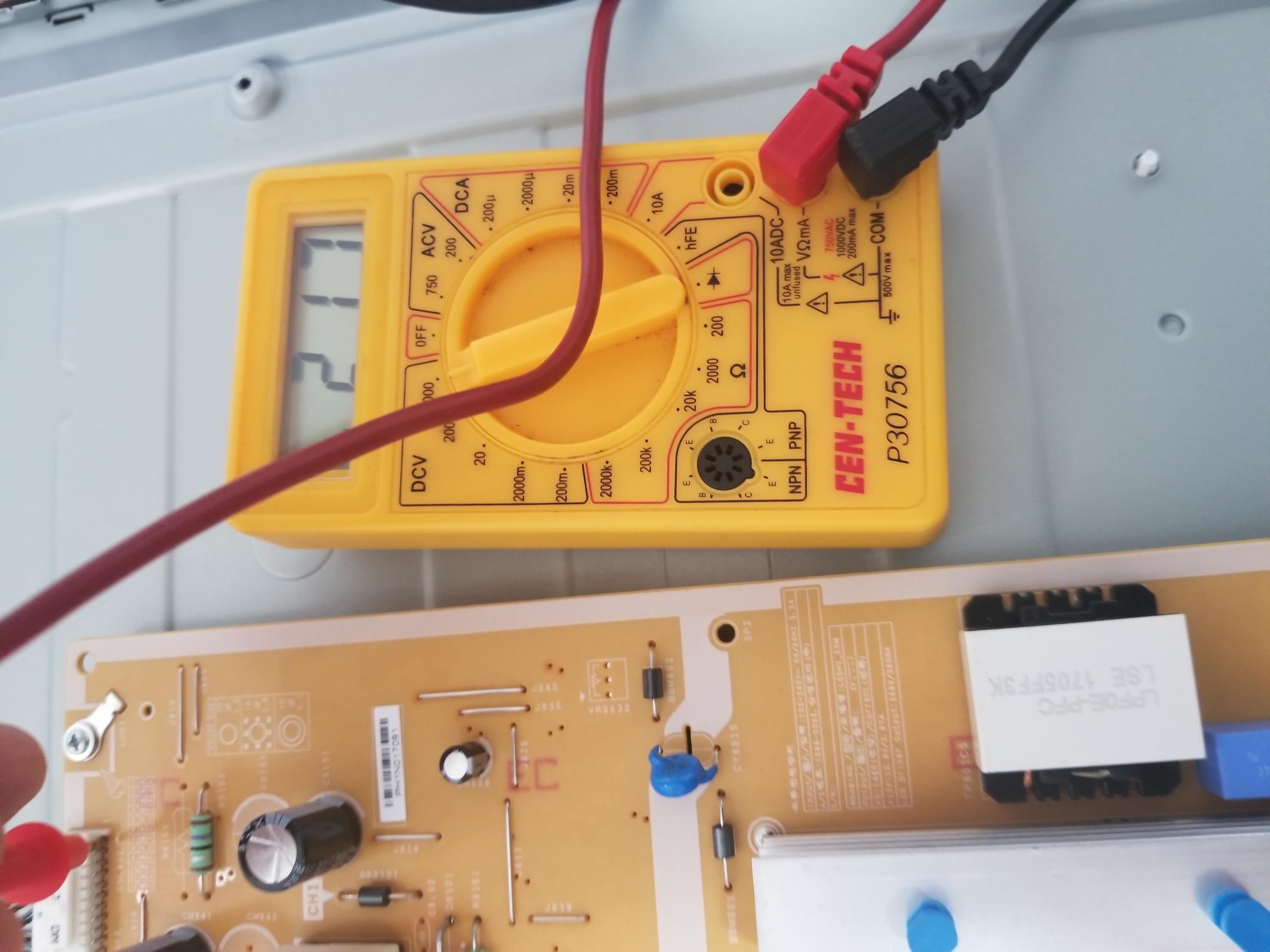

              C9101 if hats what you meant had 217V

                  Have you had a look at the back of the board ? Q9101 is the FET that BOOSTS the raw 217 volts to 268 volts
                  I am gussing that CM888 is the Vcc supply filter cap. for the sop16 driver ic, check the voltage on J840 (ic9101 vcc) should be +13volts

                      D9101 gave me 217V reading
                        The voltage on J840 was 12.75volts
                        And the FET Q9101 gave me a reading of 217v
                          I know you only have 217v on Q9101. Thats because that BOOST circuit is NOT working.
                          Check that D9101 is not shorted using diode test.
                          The drive ic is getting vcc so it could be that the ic is bad, or more likely the ic is in protection.
                          Are you sure the voltage on M1+ NEVER reaches 268 volts. You need to have the meter ON that point when the tv is first pluged in and turned on. If there is any error in the led current or voltage, the ic will shut down the boosted voltage within 1/2 a second and all you will read is the 217v.
                          Also check if you have the backlight ON voltage at the ic itself

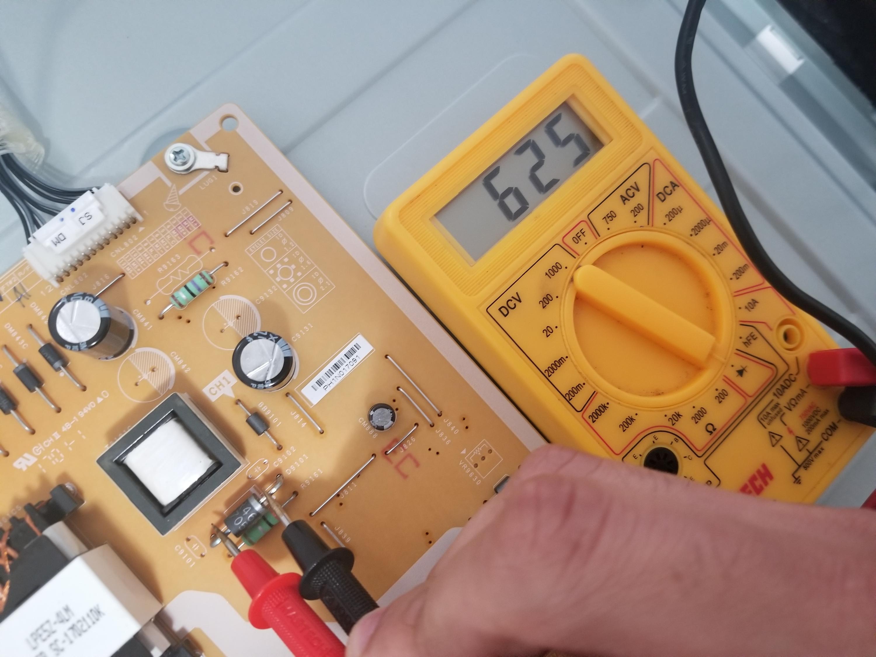

                            #33
                            I included a picture of the diode reading I got.
                            And no M1+ goes up to 217 max, it creeps its way up to 217v its not an instant jump to 217 and never goes above that at any point. Not when its plugged in with negative on chasis and positive on M1+ pin before plugged in. When turned on as well only up to 217.

                              #34
                              Ok so the diode is ok. so the problem seems to be with the led driver/boost circuit, (whatever the ic is) is likely damaged but for now check that Q9101C is not shorted, also check Q9102C to make sure it is not shorted.
