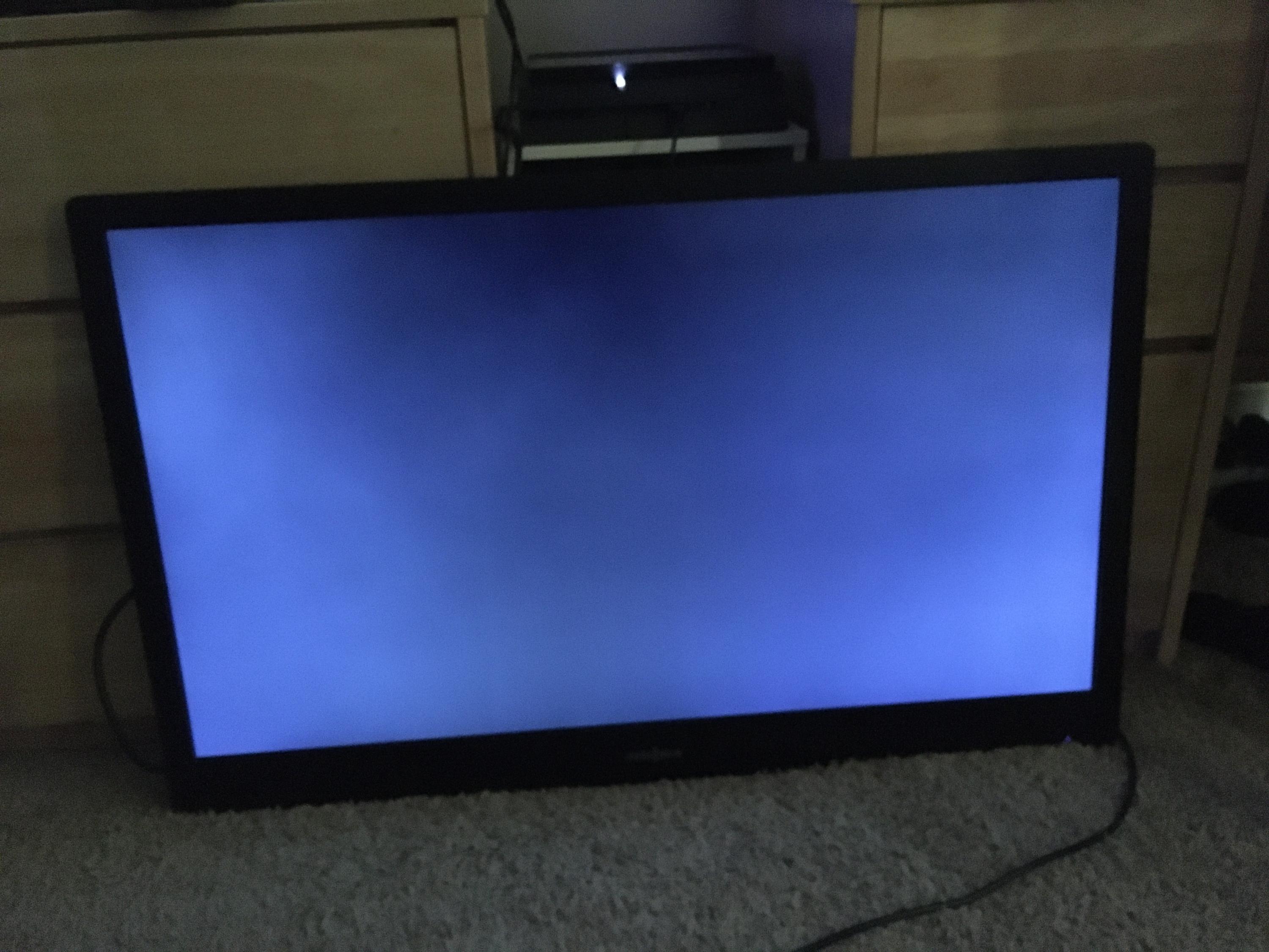

    Hello all,
    Trying to troubleshoot a problem with my Insignia 42" LCD TV, model #: NS-42E760A12 Rev B. When I turn it on, the screen is blue. The menu and input selection does not show on the screen. When I connected a PS4 device, I could hear sound and occasionally got a partial image (got lucky as the last input setting before it "blue screened" was on the HDMI port I used for the PS4). The partial image (when it shows) is on the right side of screen when facing the TV.

    How about using other video sources for other HDMI inputs, do you get the same result?
    Show us the screen shots of what the image looks like.

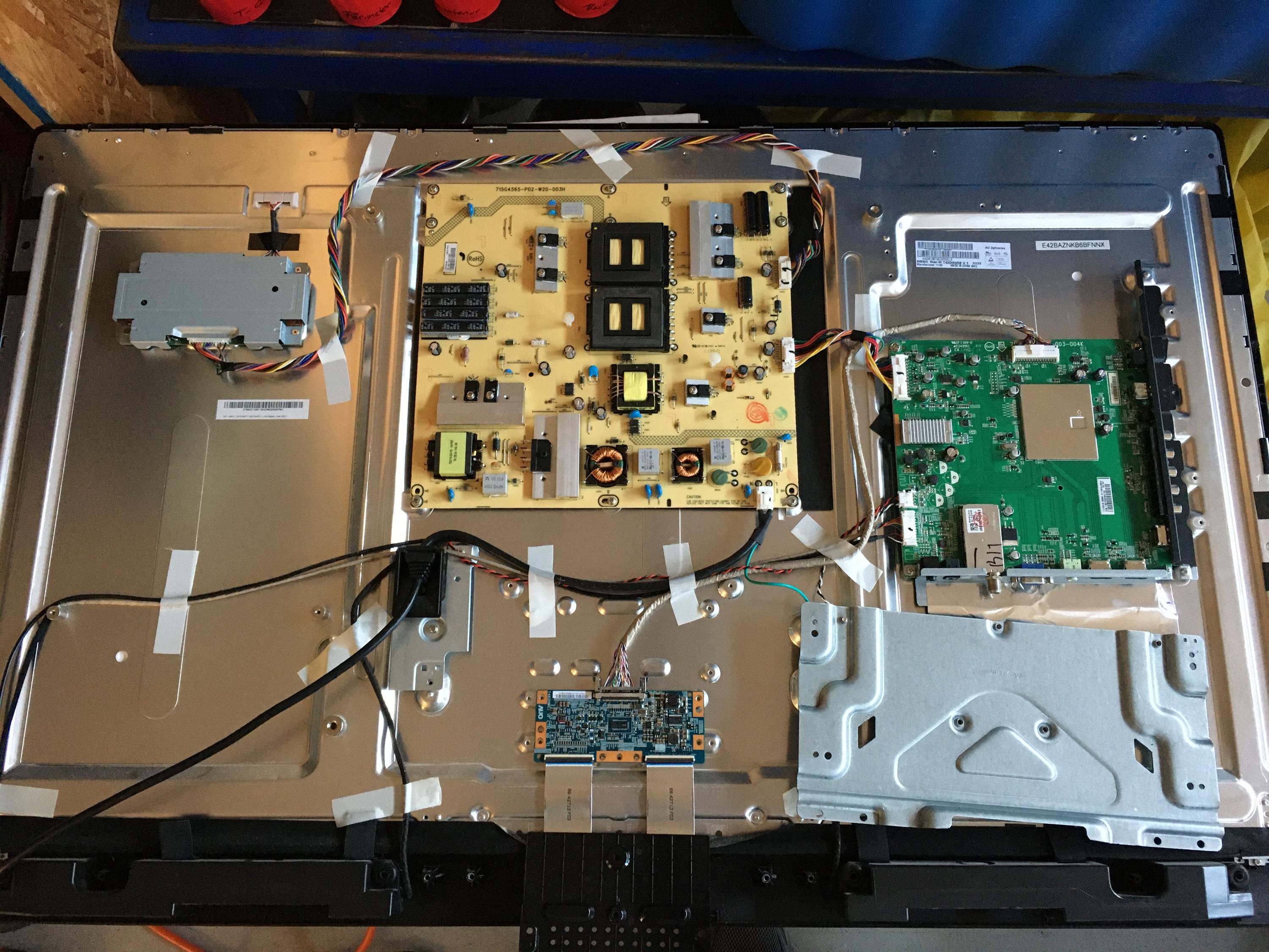

      Thanks for replying. I tried cable TV on HDMI and only got blue screen and sound. No partial image this time. Looked like some minor fluctuation to a lighter blue on the right side but not noticeable in the photo. Attached are photos of the blue screen and a photo of the back of the TV with the cover off.

        Adding more information. I would only be able to fix this at the "board level" (replace the entire board). I don't have the equipment or knowledge to fix at the component level.
          Re: Insignia 42" LCD TV Blue Screen with Sound
          Do you have at least Volt meter to check and see if you do have 12 VDC at both ends for the fuse on the T-CON board with ref to the chassis ground when TV is turned on?
          What do you see on the screen if you only have the ribbon cables between T-CON and the LCD panel connected one at time? Be real careful on these ribbon cables, they can be damaged easily, also make sure to seat them back in place properly.
                Bud, I see 12 VDC on both ends of the fuse on the T-Con board.
                For the ribbon cable test my results follow:
                Looking at the back of the TV, disconnected the left ribbon cable on the T-Con board. Result was the screen was a dark blue with no image (same as the original photo I attached to an earlier comment). When I only disconnected the right ribbon cable, the right half of the screen (when looking at the TV monitor) was normal and had an image! I pressed the menu button and was able to see half the menu screen. When I closed the menu, I saw half of the “No Signal” message. The left side of the monitor was the same dark blue with no image. I plugged both ribbon cables back in and it returned to the same blue screen problem on the entire monitor.

                  You have panel issue, more likely shorted SMD cap/s on the tab bonding board (the boards between LCD panel and the T-CON board).
                  You will have to remove the LCD metal frame to get access to the tab bonding boards so you can start checking the RESISTANCE of the SMD caps on the tab bonding boards.
                  You will also need to know how to do SMD repair works.

                    One example of bad MLCC cap: https://www.youtube.com/watch?v=jLd6QO7Z7m4
                      All, thanks for the help. I couldn't get to the tab bonding boards and would have had to change caps, and I don't have the equipment for that. Hopefully, the sanitation company recycles these items. Will try again with a 55" Sony I have that doesn't work. Hopefully, it will be a board-level replace & fix. We'll see.
