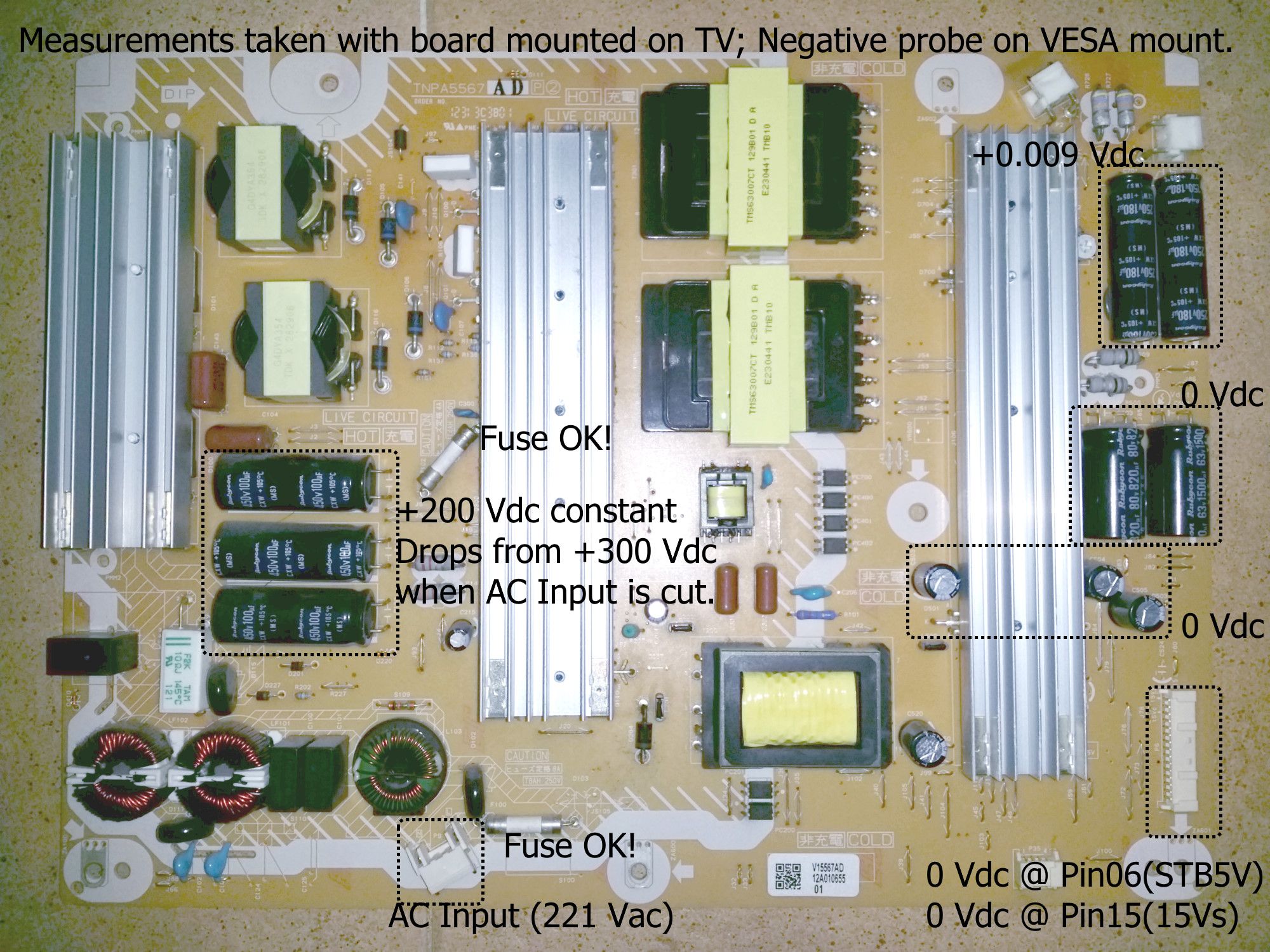

    Hello everyone
    As you can see from my profile, I am a total newbie when it comes to TV troubleshooting or repairs.
    Patient is a Panasonic TH-P50ST50H Plasma TV, which was purchased new back in 2013. This TV runs on 220-240V AC (Hong Kong market).
    I was doing some cable management and cleaning over the Christmas holidays (Merry Christmas everyone), so I decided to disconnect power to TV/STB right at the power bar (surge protected).
    As luck would have it, the TV can no longer turn on when I restore power to everything. TV was running absolutely fine prior. Sigh.
    I truly hope to rescue it as I really like the picture quality, even though it's no GT/VT series.
    I can no longer buy a new plasma, and too poor to afford a new OLED TVs (from Panasonic/Sony) of equivalent quality/size right now.
    Here are the initial findings:
    • Power bar confirmed OK - AC voltage good!
    • Power cord/plug to the TV is OK.
    • Pressing power button on the side of the TV has no effect.
    • Pressing power button on remote has no effect.
    • LED indicator (bottom left front of TV) is completely OFF.
    • No relay click (I recall there is always relay click at power on)
    • No magic smoke or burning stink. No noise.
    At this point, I guess it's dead due to power supply failure?

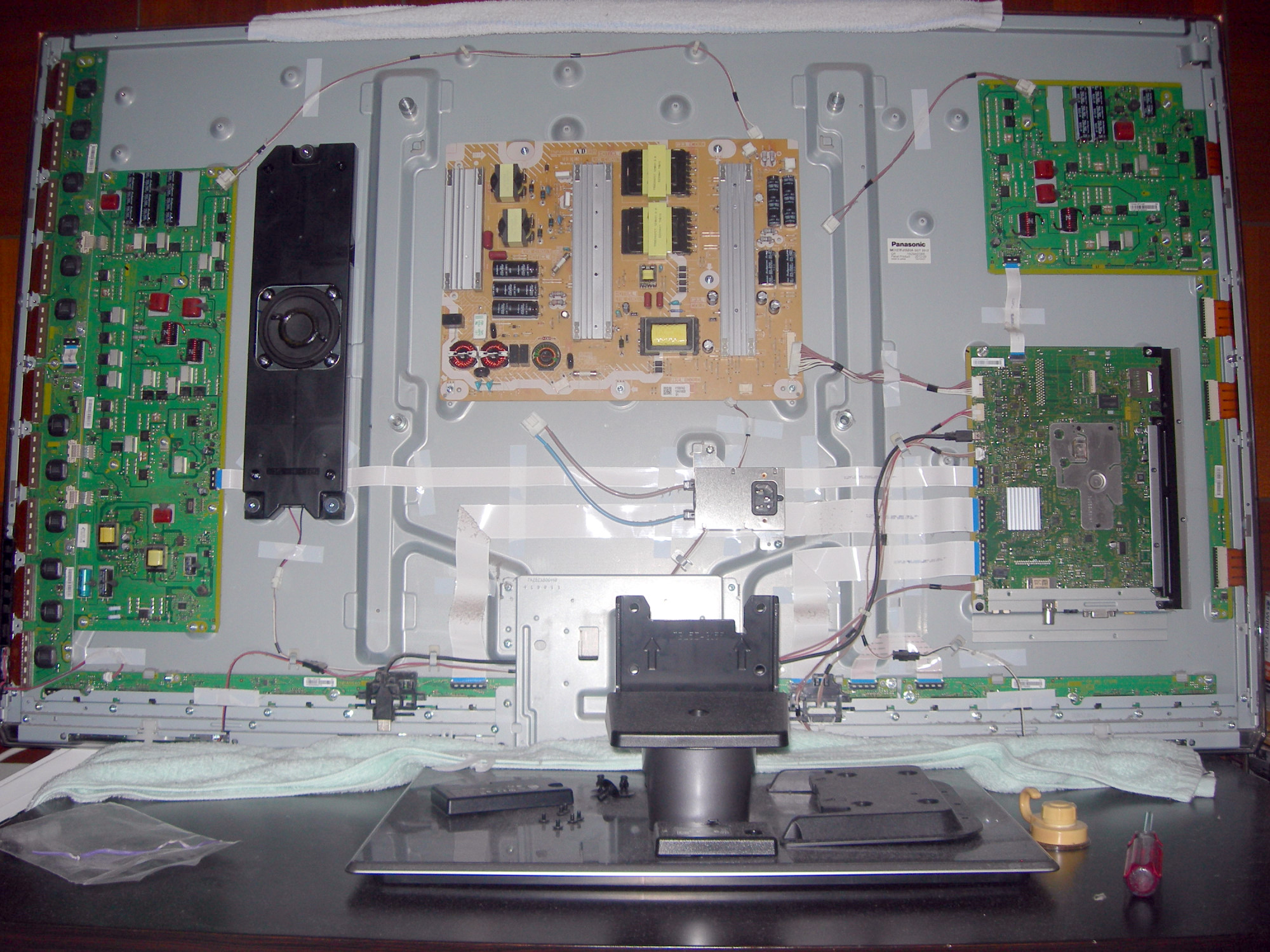

    I have taken off the rear metal cover, then disconnected all connectors off the power supply board (TNPA-5567-AD), to quickly check for any visibly damaged/burned/exploded components or bulged capacitors.
    There is nothing of that sort, fortunately.
    The two fuses, one at the bottom of the center heatink and one next to the set of 3 high-voltage capacitors, are all good, according to my multi-meter.
    What is the proper course of action please?
    Your help is greatly appreciated. Thank you very much!

    Re: Panasonic P50ST50H - No power - HELP please

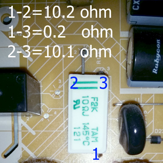

    Check the 145degC thermal fuse/10R resistor to the left of the lower large capacitor. If good, it should measure 10 ohms. If it is open circuit then you won't get any AC supply to the PSU.
    There may be other components failed that caused this is blow, so check for shorts on transistors etc under the heatsinks before replacing it.
        Thanks for your advice. I just checked that white component with a multi-meter. Results are in the attached image.
        I have not removed any of the heatsinks yet. Lets hope the failed component(s) won't be SMD ones...

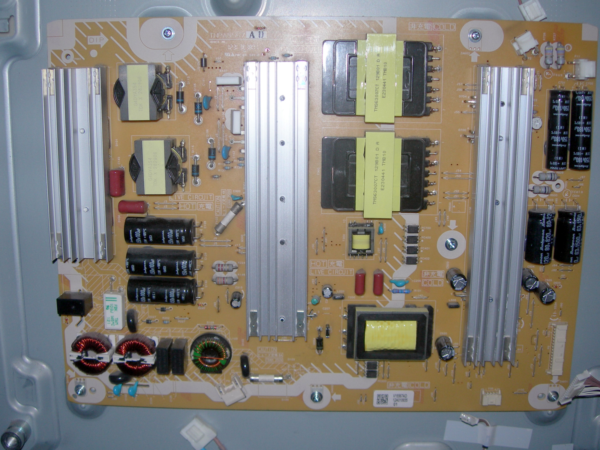

        As an update, since this is "badcaps" forum, I measured the voltage at the positive legs of most of the electrolytic capacitors.
        Just a quick check to see if part of whole power supply works I guess. Results are in the attached image.

          I checked the C13 plug at the end of the power cord that came with the TV. This rules out a damaged cord.
          I then checked the two-pin AC input connector on the power supply board. This connector (mounted at an angle) is downstream from the AC filter module. I see full AC mains voltage on the live and neutral pins.
            You need to get the standby voltage first, with your meter on HOT GROUND (use - of C130) check the voltage on both sides of R224 & R148 (or check on J4) If you have +200 volts on J4. Un plug the power supply and check the resistance of R207 0.3Ω (below the printing HOT LIVE CIRCUIT). If it is open, check for shorted mosfet Q110
              Understood.
              Negative probe of multi-meter clipped to the negative terminal of C130 (bottom one of the 3 high-voltage 450V 100uF capacitors).
              TV plugged into power outlet.
              On R224, both left (towards capacitors) side and right (towards heatsink) side are +311.X to +312.X V DC.
              On R148, left side is approx. +311.3 V DC and right side is approx. +1.88 V DC.
              On J4, reading is approx. +311.5 V DC.

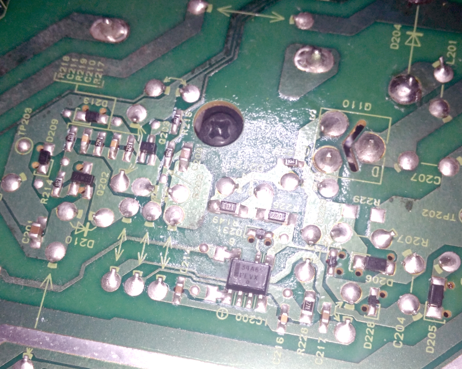

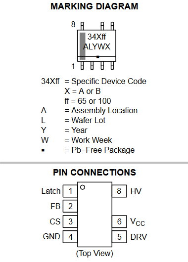

                That voltage on the (right side) of R148 does'nt look right. That should be the HV supply for ic200, and should be around 30~40VDC. Check the value of R148 (3.3k) & R147 (1.0k), I don't know the number on ic200, can you see the number, I think it could be a NCP1234. If that is the ic, check the resistance between pin8 and pin4
                The ic markings could be 34A65, NCP1234AD65R2G (the second line is date code info)
                I suspect that ic200 is defective
                R207 will be ok, it is marked 0.3Ω, and checked 0.5Ω I suspect the 0.2Ω difference is in your meter leads, this is normal but needs to be considered when checking low value resistors. The mosfet is likely ok.

                  I will go and disassemble the P board from the TV and check for you.
                      Wow! Man that's amazing.
                      Indeed, IC200 is a "34A65", as shown in the attached photo (sorry about the flash).
                      Image of NCP1234AD65R2G on Digikey looks identical to what is on the board.

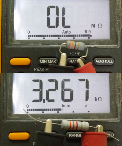

                        Thanks for waiting:
                        R147 = 0.999 kΩ
                        R148 = 24.36 MΩ
                        IC200 (34A65, NCP1234), Pin8(HV) & Pin4(Gnd) = 375.2 kΩ (Positive probe on Pin4, Negative probe on Pin8)
                        IC200 (34A65, NCP1234), Pin8(HV) & Pin4(Gnd) = 24.8X MΩ (Positive probe on Pin8, Negative probe on Pin4)
                        • R_J
                          • Jun 2012
                          • 9549
                          Maybe it is just that R148 went open? I would think if the ic was shorted, the smaller R147 1K would have opened up first. Replace R148 (3.3k/2w) it might be all thats wrong.

                                • BEpsilon
                                  • Dec 2019
                                  • 12
                                  • Hong Kong
                                  I would replace the resistor and see what happens.
                                  3.3k 2W Resistor has been replaced.
                                  As one can see from the attached image, the old resistor has no resistance whatsoever. I wonder if the resistor was damaged due to external factor(s) or preexisting defect.
                                  Now when AC power is provided, but no other boards attached, I can see +4.5 V DC at Pin06(STB5V) of Connector P6.
                                  +4.5 V DC is also on J62 ("5V" printed on the board). There is +15.75 V on J76, which is right next to J62.
                                  With all the other boards back with the P-board, the relay clicks immediately when TV is plugged in.
                                  At this point, with AC power input active, but TV not on, my power meter shows the TV is drawing 0.08 A at the plug (220 V AC).
                                  When I press the On/Off button on the TV, I can hear a relay click again. TV is drawing [only] 0.15 A at the plug.
                                  For a TV that is specified with a nominal power consumption of 420 Watt, that amp reading is not normal obviously.
                                  Unfortunately, the TV still has no picture, not even the Panasonic Smart Viera logo. LED is not lit, so no error code to see.
                                  More problem-solving for the weekend I guess.
                                    OK, I am not sure what happened...

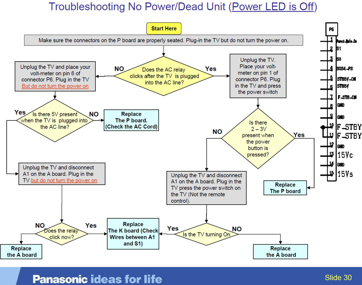

                                    I was following the flow-chart on P.30 of the Troubleshooting Guide (attached).
                                    I disconnected A1 on the A-board as instructed. TV still not on, so it seemed I need to replace the A-board. However, that is now unnecessary.
                                    As I reconnect A1 and everything else just to re-check the whole troubleshooting procedure, I was very surprised to see the front LED in solid red when I switch the TV on. There is still no image or sound.
                                    As I thought the TV might be in standby/sleep, I press the power button on the remote control. Lo and behold, I see "Smart Viera" being displayed on the screen, and then a notification about no antenna signal.
                                    I guess it's safe to conclude that the resistor is the only component required.
