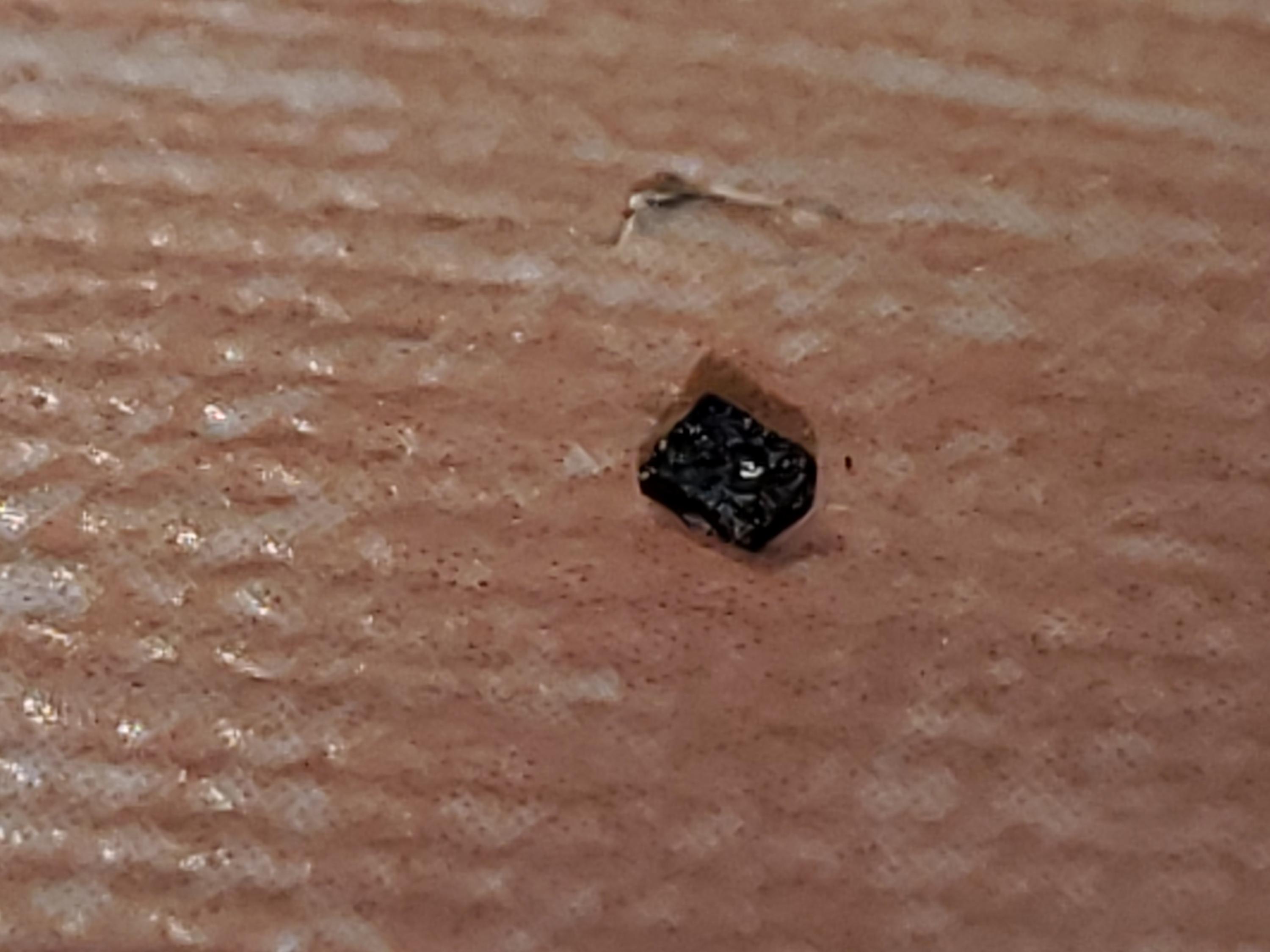

when i turn on, Philliips TV is not on
  • R_J
    replied
    Re: when i turn on, Philliips TV is not on
    Originally posted by Nish
    IC951= 6.60v I use ground of C951A
    I un solder PC901 now I measure that pads. Still same voltage.
    I replace PC902 with 817A optocoupler. Still same voltage.
    How can I check if C955,C954 are shorted. Can I lift one pad of cap?
    Just check C955/954 in circuit.
    Leave a comment:
  • Nish
    replied
    Re: when i turn on, Philliips TV is not on
    Originally posted by R_J
    What are the voltages on IC951? something is wrong in that circuit, that is why there is no regulation happening. Maybe shorted C955,C954? I guess it might be PC901? if you don't have one try exchanging PC902 with PC901.
    IC951= 6.60v I use ground of C951A
    I un solder PC901 now I measure that pads. Still same voltage.
    I replace PC902 with 817A optocoupler. Still same voltage.
    How can I check if C955,C954 are shorted. Can I lift one pad of cap?
    Leave a comment:
  • R_J
    replied
    Re: when i turn on, Philliips TV is not on
    What are the voltages on IC951? something is wrong in that circuit, that is why there is no regulation happening. Maybe shorted C955,C954? I guess it might be PC901? if you don't have one try exchanging PC902 with PC901.
    Leave a comment:
  • Nish
    replied
    Re: when i turn on, Philliips TV is not on
    Originally posted by R_J
    The shunt regulator should be pulling pc901 pin 2 close to ground, When it is working you should have about 2~3 volts on PC901 pin2 and around 4~5 volts on pin 1. with about 1.5 volt difference across pins 1&2 the led would be lit and pin 4 would be closer to 1~2 volts, controlling the ic901
    I replaced new ic951(apl431). But still same voltage
    PC901 pin1 = 6.60v
    PC901 pin2 = 6.60v (use C951A negative for ground)
    Leave a comment:
  • R_J
    replied
    Re: when i turn on, Philliips TV is not on
    The shunt regulator should be pulling pc901 pin 2 close to ground, When it is working you should have about 2~3 volts on PC901 pin2 and around 4~5 volts on pin 1. with about 1.5 volt difference across pins 1&2 the led would be lit and pin 4 would be closer to 1~2 volts, controlling the ic901
    Leave a comment:
  • Nish
    replied
    Re: when i turn on, Philliips TV is not on
    R_J: I have one AP431,can I use it for test?
    Last edited by Nish; 01-29-2020, 11:16 AM.
    Leave a comment:
  • Nish
    replied
    Re: when i turn on, Philliips TV is not on
    Originally posted by R_J
    So you have no feedback to control the primary so it is trying to output more than the 5 volts on the secondary, That's why the ZD951 is getting hot. It is trying to clamp the voltage to 6.2 volts and thats why it gets hot.
    First check that D950,951 &952 are not bad or leaky (they are likely ok)
    Next check R954,R955, if they are ok IC951 could be bad
    What is happening is IC951 is NOT regulating and bringing pin 2 of PC901 low. Check that PC901 pins 1&2 are not shorted. If the optocoupler is ok, I suspect the apl431 regulator is bad. If you don't have one, check an old switching power supply, they almost all use them but it might be a to-92 case but it would work to test.
    PC901 has the same voltage on both pins so the internal led is not turning on, If the led does not turn on, the photo detector (pins 3 & 4) does not conduct, lowering the voltage across zd907. and regulating ic901
    D950 = 0.2 ,951= 0.2 & 952 = is not populate
    R954 =10k ,R955 = 2.976k
    PC901 : when I do continuity test no beep. I checked diode mode pin 1(+) to pin 2(-) = 0.596 and pin 1(-) to pin 2 (+) = 0.608
    Unsolder those two pin and measure diode mode pin 1(+) to pin 2(-) = 0.998 and pin 1(-) to pin 2 (+) = OL
    But when I measure on the pad of PC901 pin 1 and 2 same voltage at diode mode.
    I do not have apl431 regulator now. Once I get new I will update.
    Leave a comment:
  • R_J
    replied
    Re: when i turn on, Philliips TV is not on
    So you have no feedback to control the primary so it is trying to output more than the 5 volts on the secondary, That's why the ZD951 is getting hot. It is trying to clamp the voltage to 6.2 volts and thats why it gets hot.
    First check that D950,951 &952 are not bad or leaky (they are likely ok)
    Next check R954,R955, if they are ok IC951 could be bad
    What is happening is IC951 is NOT regulating and bringing pin 2 of PC901 low. Check that PC901 pins 1&2 are not shorted. If the optocoupler is ok, I suspect the apl431 regulator is bad. If you don't have one, check an old switching power supply, they almost all use them but it might be a to-92 case but it would work to test.
    PC901 has the same voltage on both pins so the internal led is not turning on, If the led does not turn on, the photo detector (pins 3 & 4) does not conduct, lowering the voltage across zd907. and regulating ic901
    Last edited by R_J; 01-28-2020, 04:46 PM.
    Leave a comment:
  • Nish
    replied
    Re: when i turn on, Philliips TV is not on
    Originally posted by R_J
    It may be doing that because of lack of feedback, Check the voltage across ZD907.
    You may also need to check the voltage on pins 1 & 2 of the PC901 (note to use C951A negative for ground)
    ZD907 = -4.96v
    PC901 pin1 = 6.60v
    PC901 pin2 = 6.60v
    ZD951 and C951A are gets hot
    Leave a comment:
  • R_J
    replied
    Re: when i turn on, Philliips TV is not on
    It may be doing that because of lack of feedback, Check the voltage across ZD907.
    You may also need to check the voltage on pins 1 & 2 of the PC901 (note to use C951A negative for ground)
    Leave a comment:
  • Nish
    replied
    Re: when i turn on, Philliips TV is not on
    I have soldered 20v zener diode. Still C912 and C906 are fluctuating. But I have 6.18v at C951A.
    Leave a comment:
  • Nish
    replied
    Re: when i turn on, Philliips TV is not on
    Originally posted by R_J
    So this ZD904 zener WAS bad, Check what voltage you have across C912.
    Also while you are at it, check the voltage across C906
    C951A has ZD951, a 6.2 volt zener across it.
    C912 = 11v to 16v fluctuation
    C906 = 8v to 21v fluctuation
    I will order 20v zener diode
    Leave a comment:
  • will62
    replied
    Re: when i turn on, Philliips TV is not on
    Originally posted by R_J
    But did they actually install this ic in the board and check that it worked properly? Did anyone confirm that the DNP005 operates at 65khz vs 100khz?
    That, I don't know. The one asking about the DNP005, did not come back and say there was a problem. It was a pretty rough translation from Spanish, but understandable. BTW, not recommending that the OP go away from the DNP005, just adding that it may have a max VCC of 25v. As you said, a 20v zener is probably OK.
    Last edited by will62; 01-25-2020, 11:47 PM.
    Leave a comment:
  • R_J
    replied
    Re: when i turn on, Philliips TV is not on
    Originally posted by will62
    On another site, someone was commenting on the high failure rate of the DNP005, and recommended that it be replaced with a ICE3BR0665JZ. That ic has a VCC range of 10.5-25v.
    I doubt they fail any more frequent than any other standby pwm, the infineon icexxx fail often as well.
    But did they actually install this ic in the board and check that it worked properly? Did anyone confirm that the DNP005 operates at 65khz vs 100khz?
    Most of the Infineon icexbrxxx ic's have a max vcc of around 25v thats why I suggested the 20v zener.
    Last edited by R_J; 01-25-2020, 10:15 PM.
    Leave a comment:
  • will62
    replied
    Re: when i turn on, Philliips TV is not on
    On another site, someone was commenting on the high failure rate of the DNP005, and recommended that it be replaced with a ICE3BR0665JZ. That ic has a VCC range of 10.5-25v.
    Leave a comment:
  • R_J
    replied
    Re: when i turn on, Philliips TV is not on
    So this ZD904 zener WAS bad, Check what voltage you have across C912.
    Also while you are at it, check the voltage across C906
    C951A has ZD951, a 6.2 volt zener across it.
    Leave a comment:
  • Nish
    replied
    Re: when i turn on, Philliips TV is not on
    Originally posted by R_J
    I can't make it out but there is likely another number before the "G", try looking at different angles to see if you can see anything else.
    The number on the schematic UDZSTE-17, SHOULD have the voltage after this number (ie: UDZSTE-1722, 22v zener)
    Some of the zeners that I looked at that end in G, like WG are only 10~11 volt which is normally too low a voltage
    When I lift the zener diode and I have 6.4v at C951A
    Leave a comment:
  • R_J
    replied
    Re: when i turn on, Philliips TV is not on
    Originally posted by Nish
    Which one should I buy and try.
    Without a number or voltage rating, it is a guess, Too high a voltage and you will exceed the ic's VCC (which we don't know without a datasheet) and without the full number from the diode its a guess. I would try around a 20 volt zener diode.
    A lot of the infineon ic's (which this is but likely custom) have a max vcc of 22v
    Leave a comment:
  • Nish
    replied
    Re: when i turn on, Philliips TV is not on
    Which one should I buy and try.
    Leave a comment:
  • Nish
    replied
    Re: when i turn on, Philliips TV is not on
    Originally posted by R_J
    I can't make it out but there is likely another number before the "G", try looking at different angles to see if you can see anything else.
    The number on the schematic UDZSTE-17, SHOULD have the voltage after this number (ie: UDZSTE-1722, 22v zener)
    Some of the zeners that I looked at that end in G, like WG are only 10~11 volt which is normally too low a voltage
    I think it's broken. I cannot see any other mark on it.
    Leave a comment:
  • rabsonnjala
    LENOVO IDEAPAD 100 works only on bench power supply
    by rabsonnjala
    Hie I have a Lenovo laptop
    Lenovo Ideapad 100-14IBY AIVP1-AIVP2 LA-C771P rev 1.0
    it's working only on the bench power supply when I put the battery it doesn't power on. when I also use the original charger it doesn't power. the batter Is fully charged, I used another laptop to charge the battery. but when I use a bench power supply it works perfectly
    below are my readings
    with the original charger only
    JBATT1
    PIN1 0.22V
    PIN2 0.22V
    PIN3 0.45V
    PIN4 0.45V
    PIN5 O.43V
    PIN6 0V
    PIN7 GND
    PIN8...
    11-20-2021, 08:32 AM
  • zaurus81
    HP 15-cb028nl (dag75ambad0 rev. d) no charge battery
    by zaurus81
    Hi all, I have a HP 15-cb028nl (dag75ambad0 rev. d) that turns on but does not charge the battery. The laptop arrived with the super I/O (ITE IT8987E BXA) burned. After replacing the EC, it turns on but does not charge the battery. Below are the voltages on the pins of the bq24738h, with and without the battery inserted:
    WITHOUT BATTERY WITH BATTERY
    PIN1 (ACN)= 19.76 V PIN1 (ACN)= 19.76 V
    05-06-2025, 09:48 AM
  • kalilinux25
    Lenovo Thinkpad T410 no power
    by kalilinux25
    DEVICE: Laptop
    Model: lenovo thiinkpad t410
    Board Id: 09A33-3 48.4FZ09.031
    NZM1H-8
    ISSUE: NO POWER
    From the first mosfet 20v is not passing through, pin 4 has 19.5v and the first mosfet is a P-CHANNEL mosfet (SI7121DN) i think the pin 4 should be lower to active the 1st mosfet to allow the 20v to pass to second mosfet ive check all for shorting in the board , i did;nt find in rails, so ive check the schematic and im suspecting that, my Q61 is faulty due to its pin 1 is 0.47ohms? im not pretty sure, hope someone can help me figure out this issue.
    07-13-2025, 07:56 AM
  • DrFalken
    Honor MagicBook X 16 mod. BRN-F56 dead
    by DrFalken
    Good morning!
    A customer just brought in an Honor MagicBook X 16 mod. BRN-F56, motherboard P/N Fermi_MB NB6269A_MB_V4, not working (no power LED, no charging LED, nothing)
    He said he had been using an aftermarket power supply for a while, but noticed that it suddenly stopped charging and when the battery was completely dead the laptop would not turn on, even with the original (working) power supply.
    On the power connector, on the motherboard side, I measure 20V.
    With the thermal imaging camera I found a component labeled 2920J (TSOP5) that, when I supply power, increases...
    01-29-2025, 03:41 AM
  • danro
    Owon HDS2202S oscilloscope
    by danro
    I have this OWON HDS2202S oscilloscope that worked fine until it was used with the wrong probes mounted in the wrong place.
    It is not completely dead, it still fulfills some functions. I opened it and found some damaged components inside. I have identified the rest but I cannot identify this IC. I don't think I can find the diagram, but can someone help me identify this component?
    It seems to be an LDO regulator. I identified it like this:
    Pin1 - Vin
    Pin2 - GND
    Pin3 - ? (connected with pin1)
    Pin4 - ADJ ? (resistive divider between Vout and...
    07-25-2024, 10:46 AM
