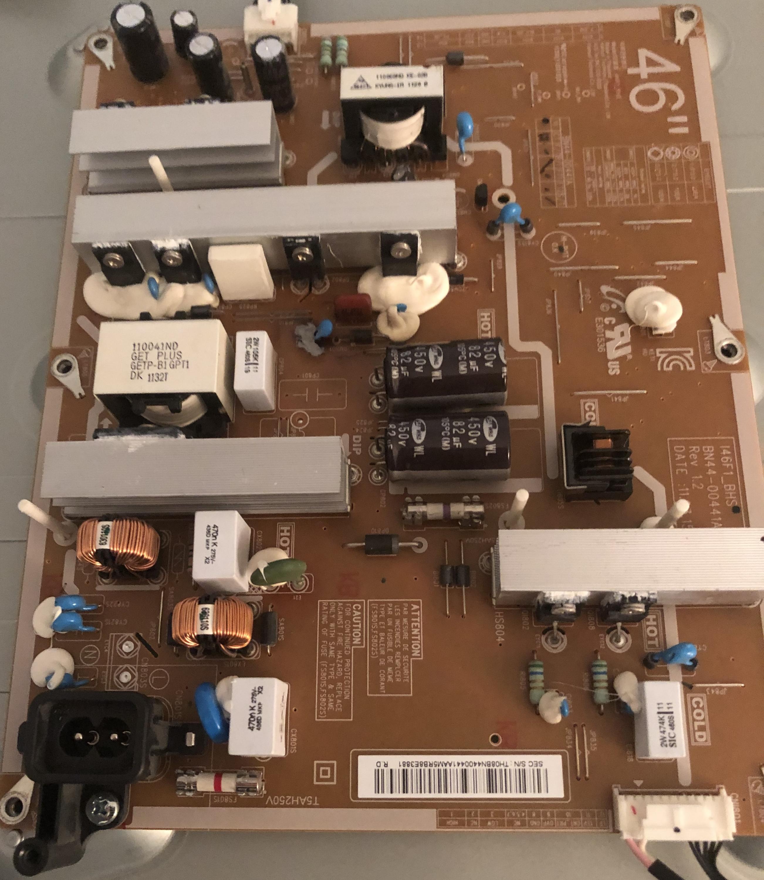

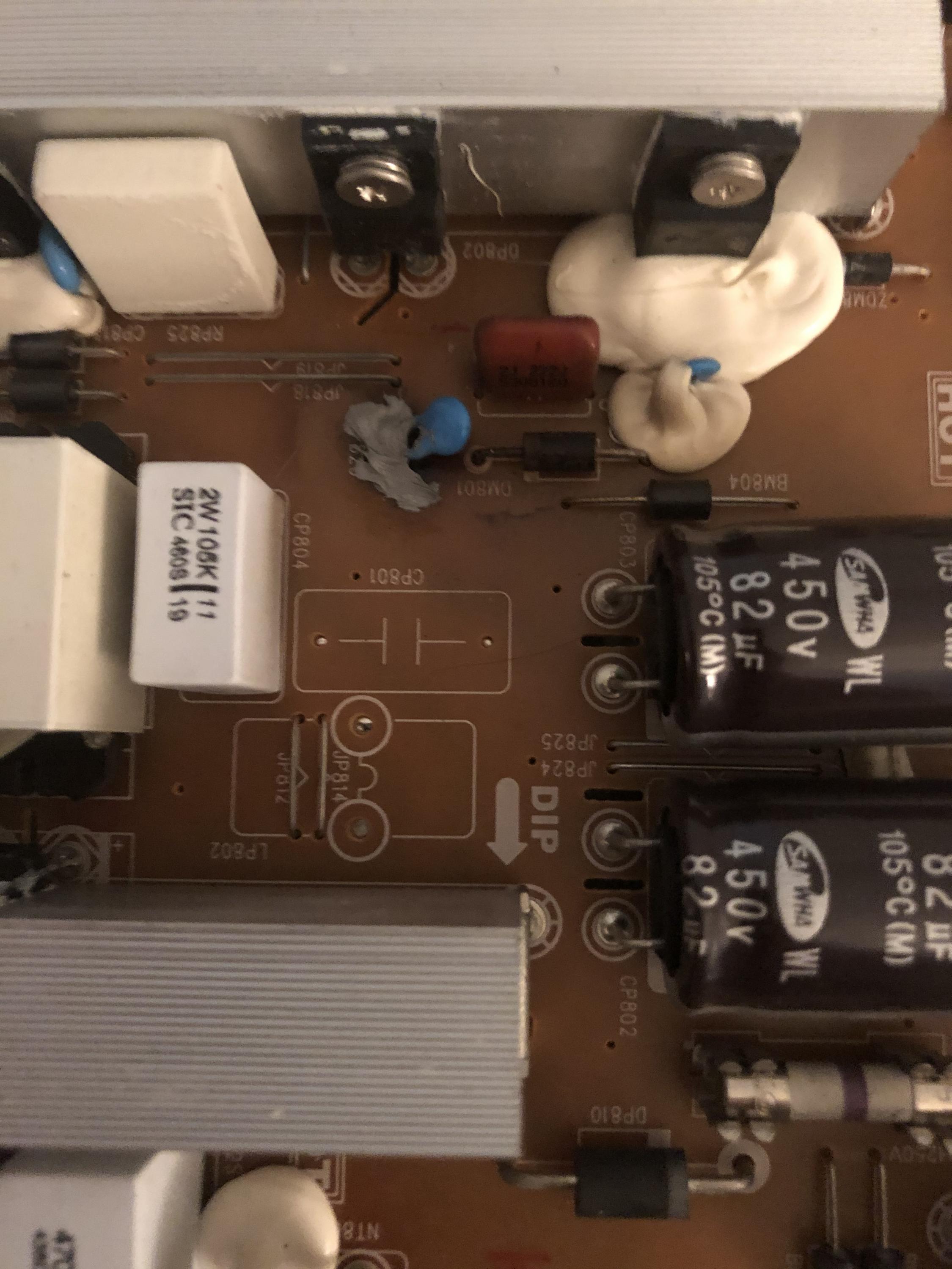

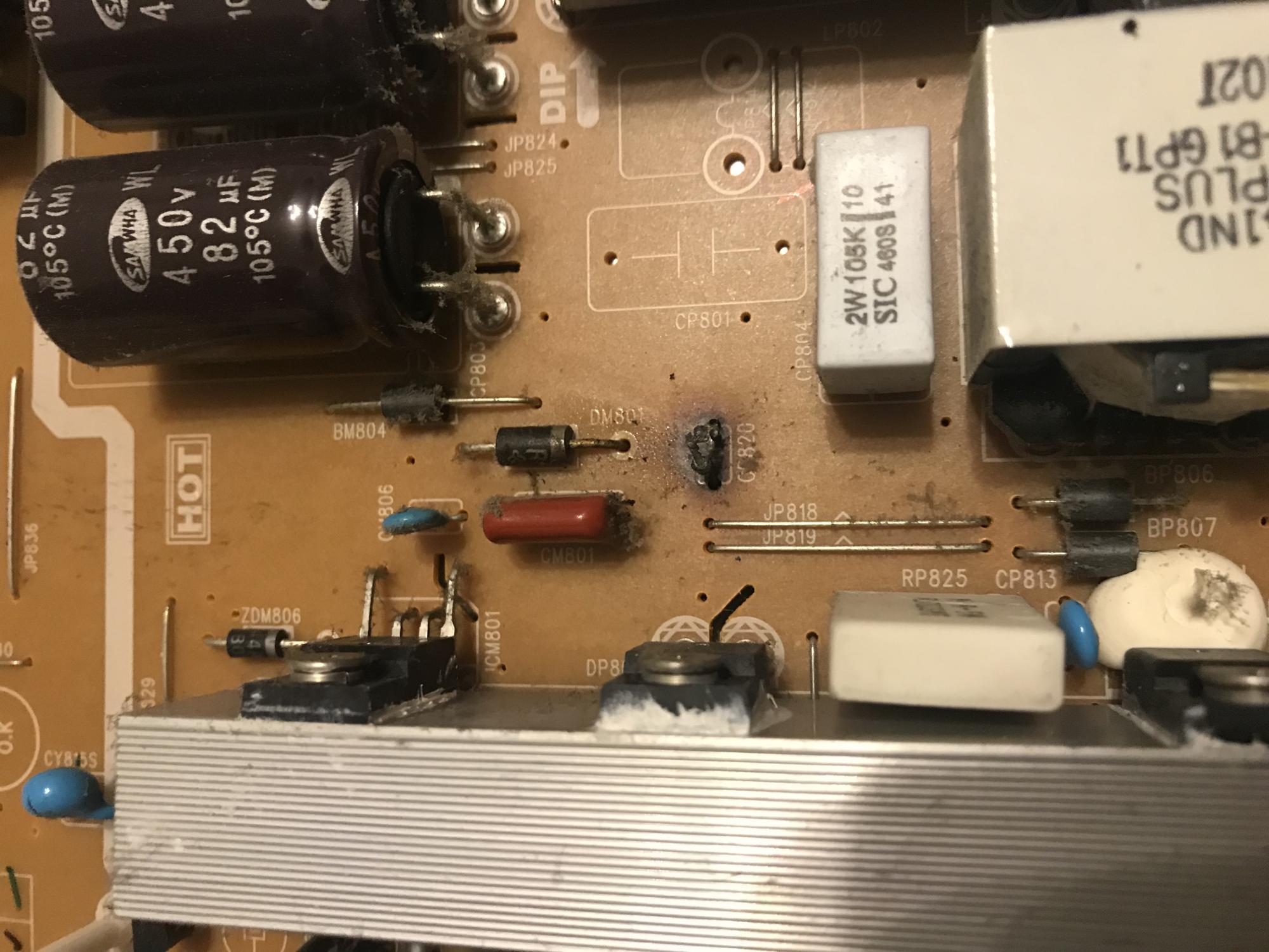

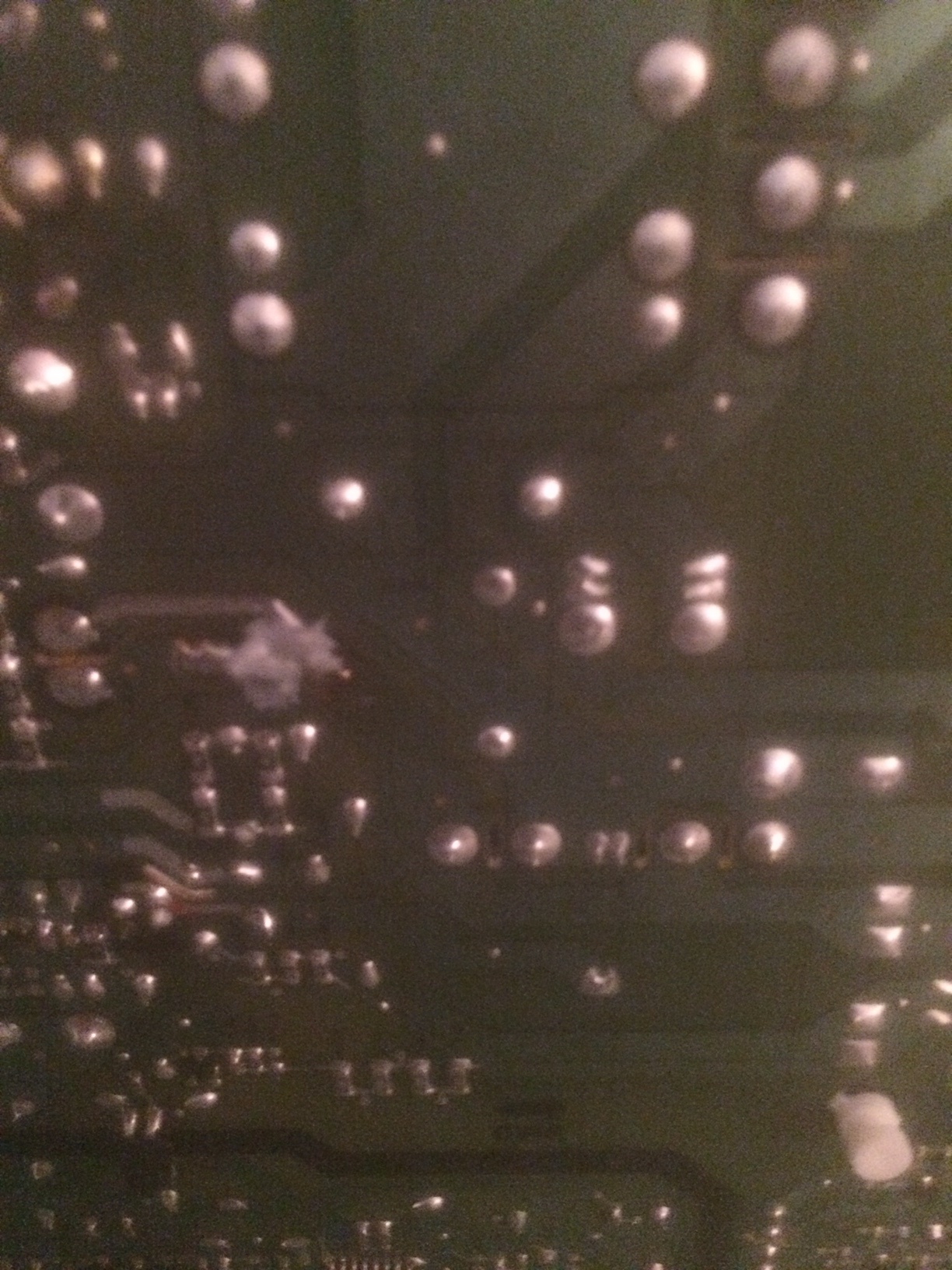

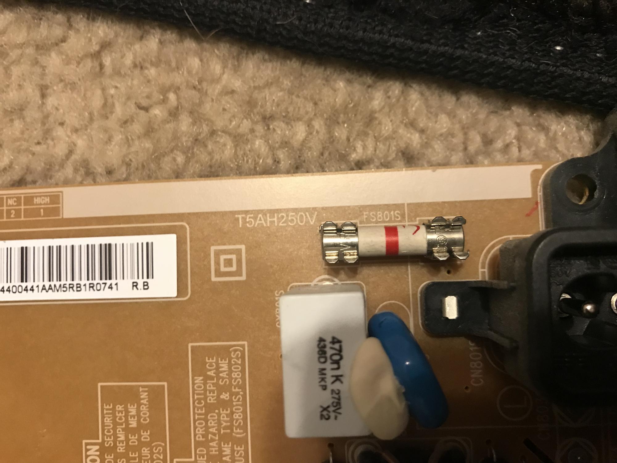

    I picked this up today. The fuse by the power inlet is blow and so is the component CP820, assuming it's a capacitor.
    Would replacing the fuse and cp820 fix it or is there most likely something else blown?

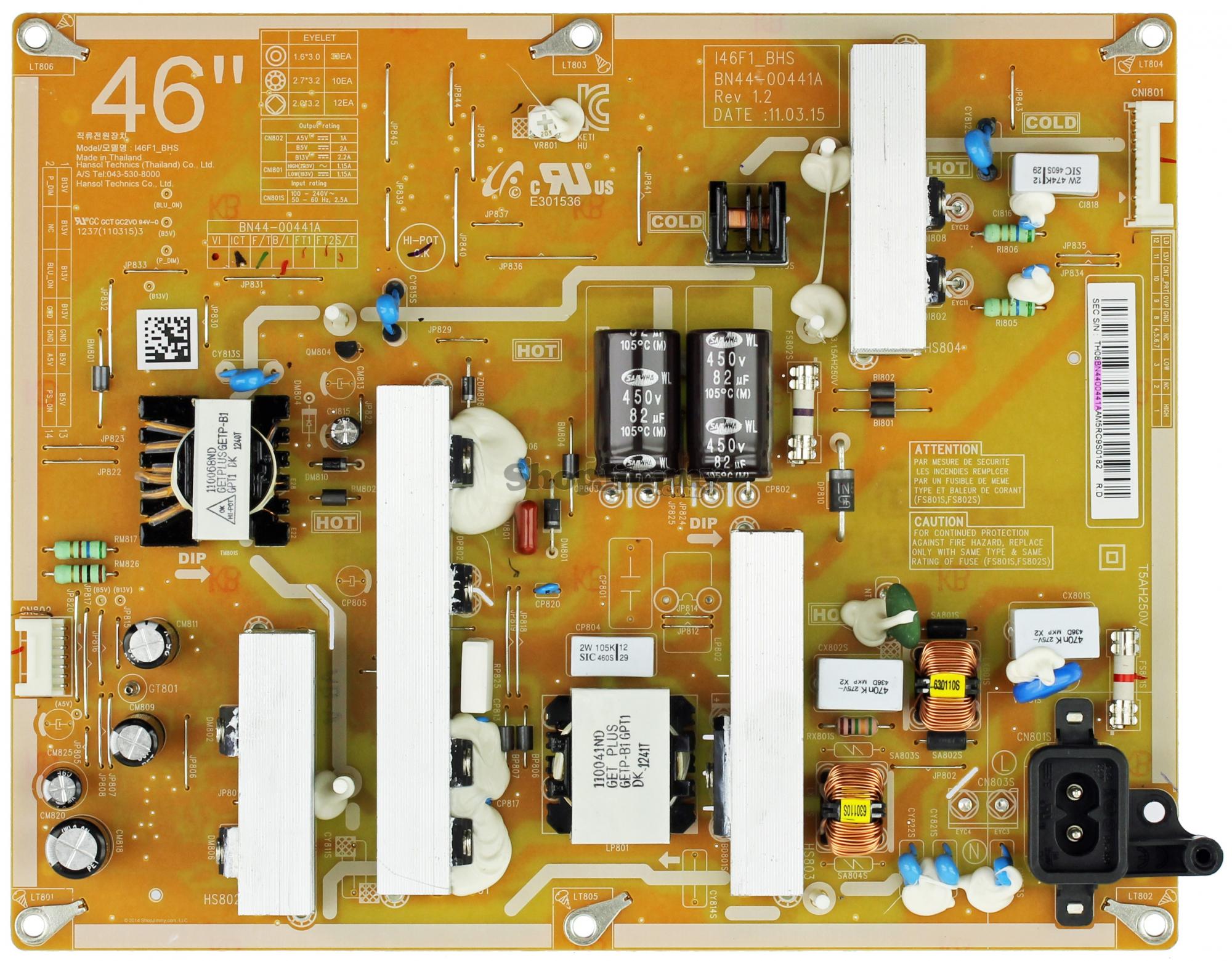

    I will attach a pictures of the actual board and one from shopjimmy.

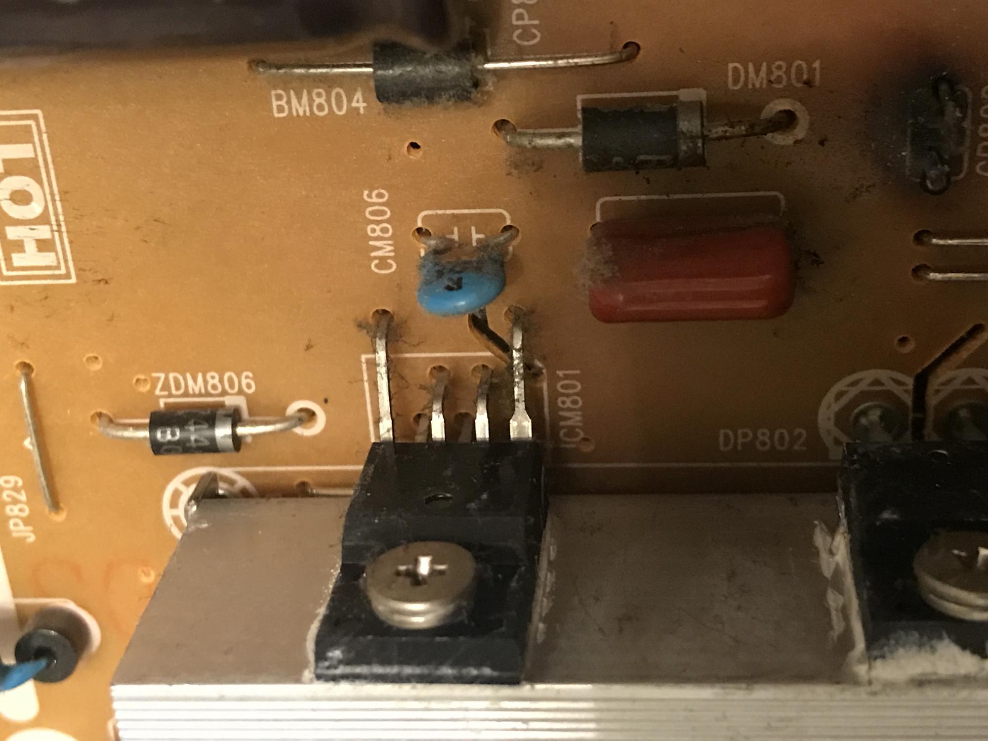

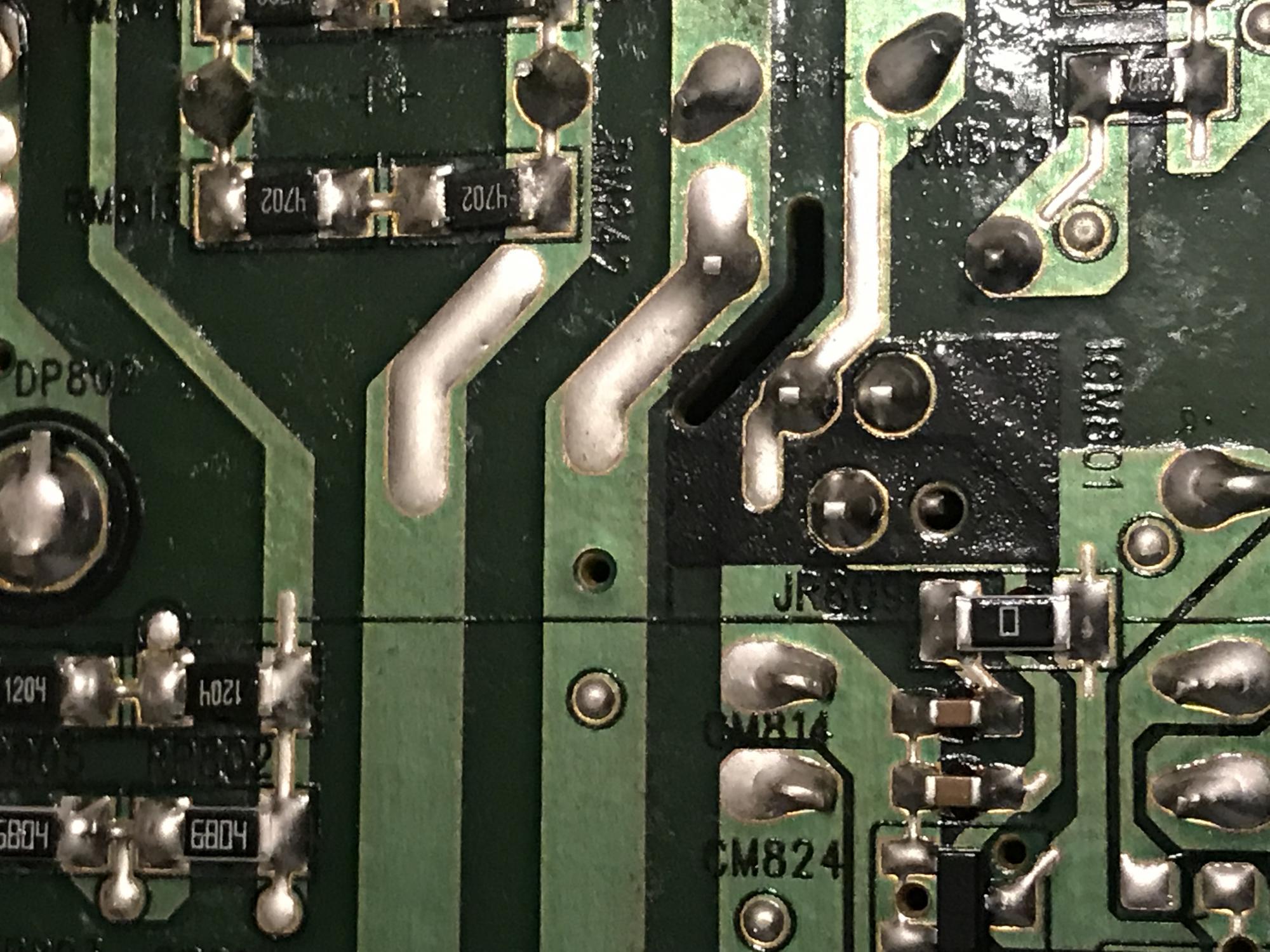

    Also I noticed that on the bottom side of the board, CM801 has one lead not soldered. Is that ok?

      Check DP802 for a short.
        Re: Samsung LN46D550 power board issue
        Excuse my ignorance. How exactly? Off the circuit board? Between the two legs?
        It has a shorter leg between the two soldered ones.
          The burnt up cap is a snubber cap for the DIODE DP802, the cap is connected in parallel with DP802, so to check the DP802 you just use the two solder pads of cap CP820 (Removed) for testing DP802.
          You should also check the resistance reading between the two legs of the main filter cap CP802, it should show low resistance at the beginning then the resistance should rise up as the cap is charged up by the meter, and of course no power to the board, report the result.
            DP802 is shorted then as I get no beep between the solder pads of CP820. I didn’t remove it as all that is left is the two legs sticking up out of the board.
            Resistance on CP802 started at 44M ohms and dropped, if I did it correctly.

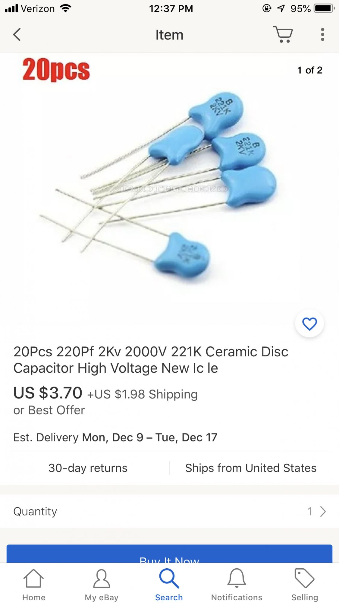

                    How would I find out the value of that snubber cap that blew since there is nothing left of it?
                      220pf 2KV ceramic should be fine.
                        Thanks budm.
                        These are ok?
                          That should be good.
                            Thanks. I had ordered them anyway.
                            Now as the fuse. It’s a
                            T 5A H 250V. I have some T 12A 250V from another set I fixed. I problem shouldn’t use the 12A in place of 5A. Right? Lol

                              I found this thread particularly interesting because my mother-in-law's Samsung LN46D550 was not turning on. So I took the back off and replaced both fuses, which caused the stand-by light to blink 5 times when I turned the set on again. However, when I put the old fuse (with the purple line) back in FS8029, the set wouldn't come on. So I concluded that something on the power board had caused that fuse to blow.
                              After reading several posts on how to determine whether the power board was bad, I disconnected the main board, and found that the set would not turn on, and that no lights were coming out of the screw holes. So I then disconnected the T Con board and found the same thing.
                              I also noticed that the blue capacitor (cp820) on my board was bent over, and that the capacitor's legs, both above and below the board, were sloppily embedded in what I thought was a grey epoxy-like material. So I suspected that that capacitor was the problem, just as cp820 appears to have been in the OP's board.
