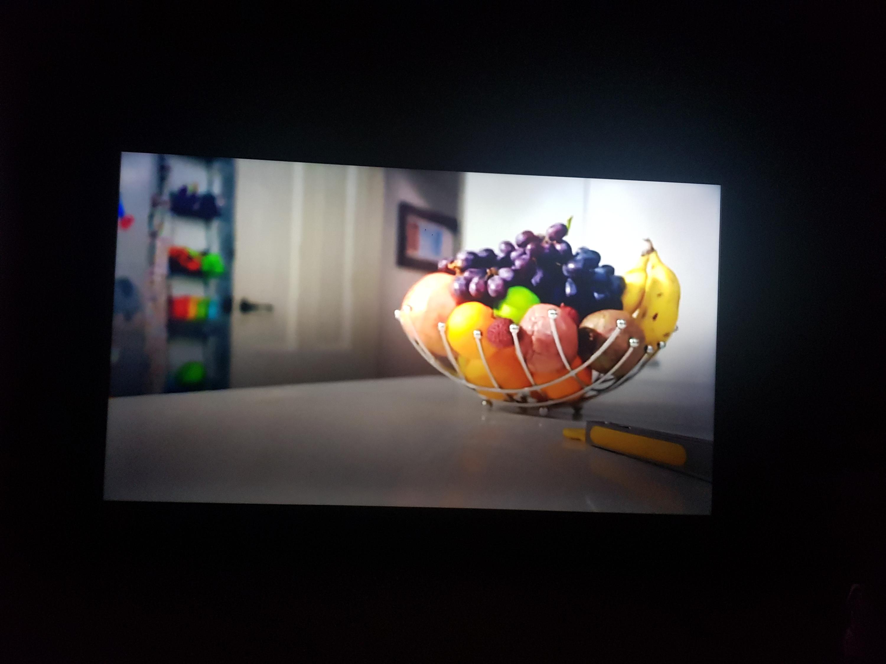

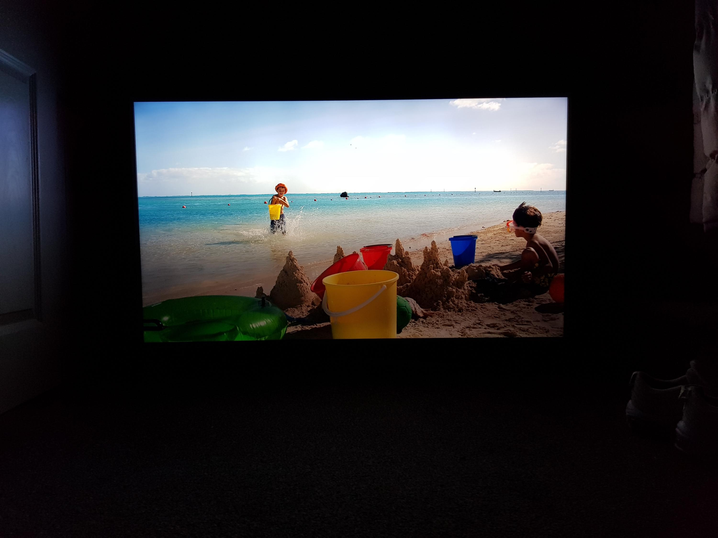

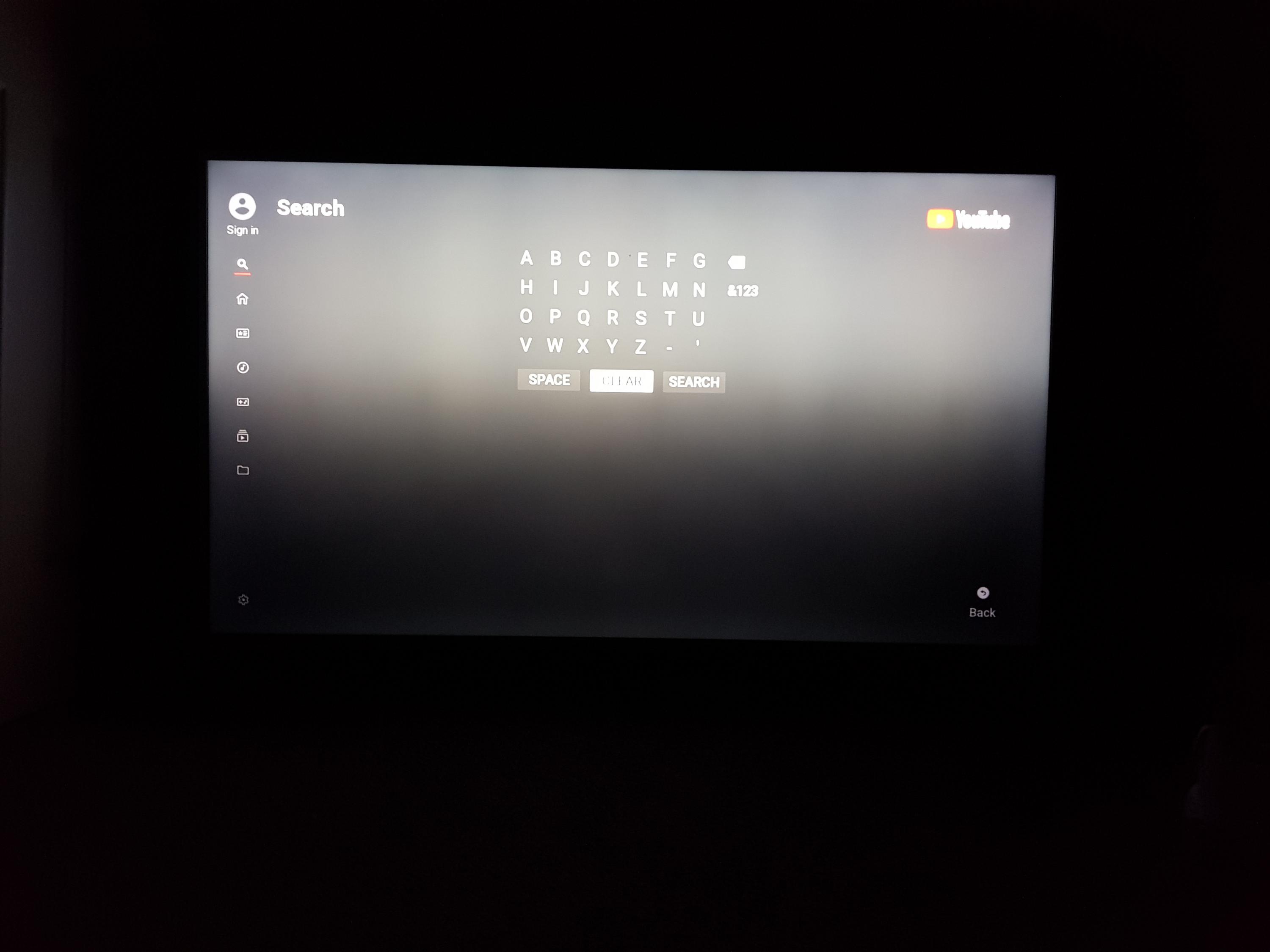

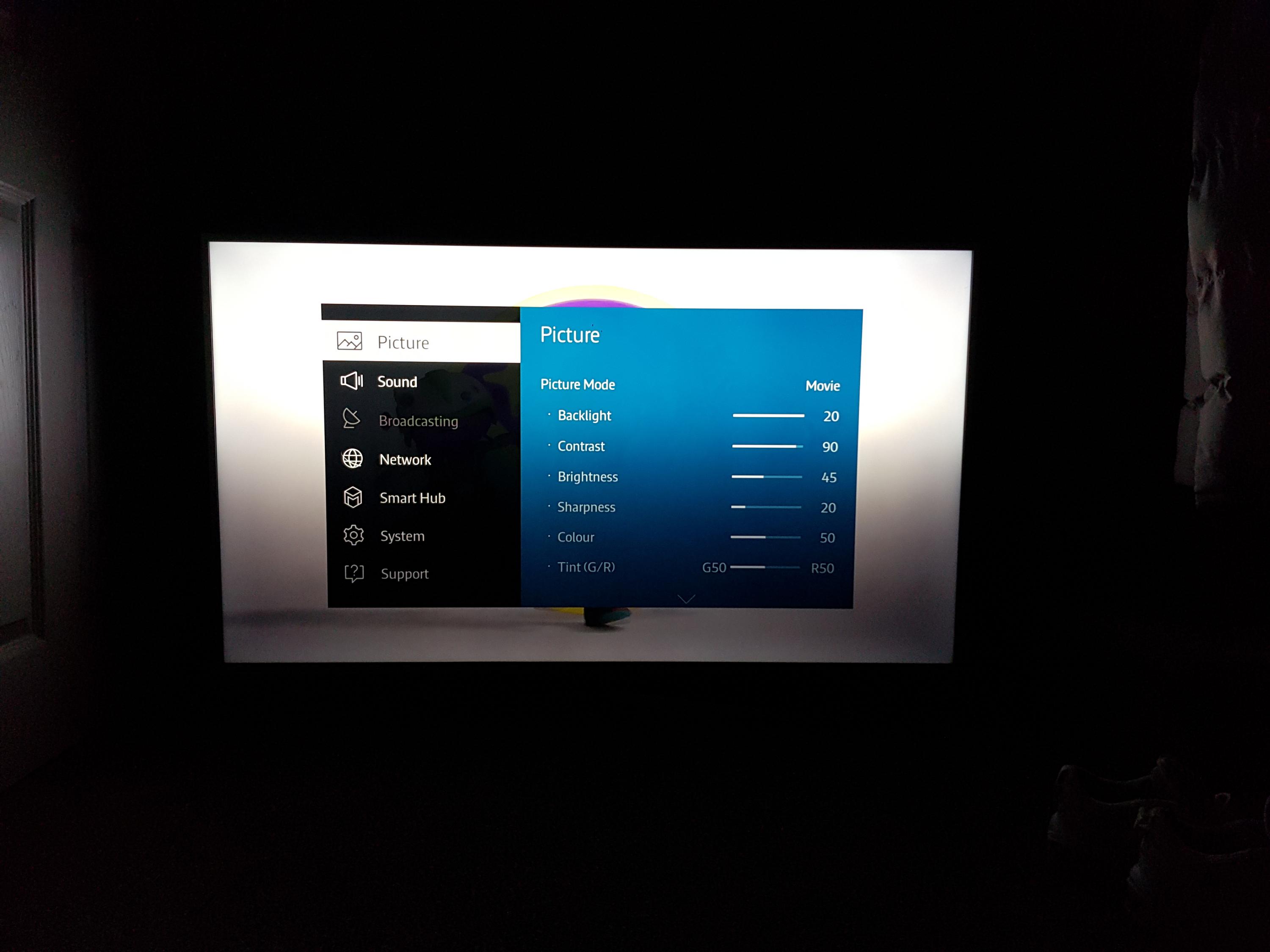

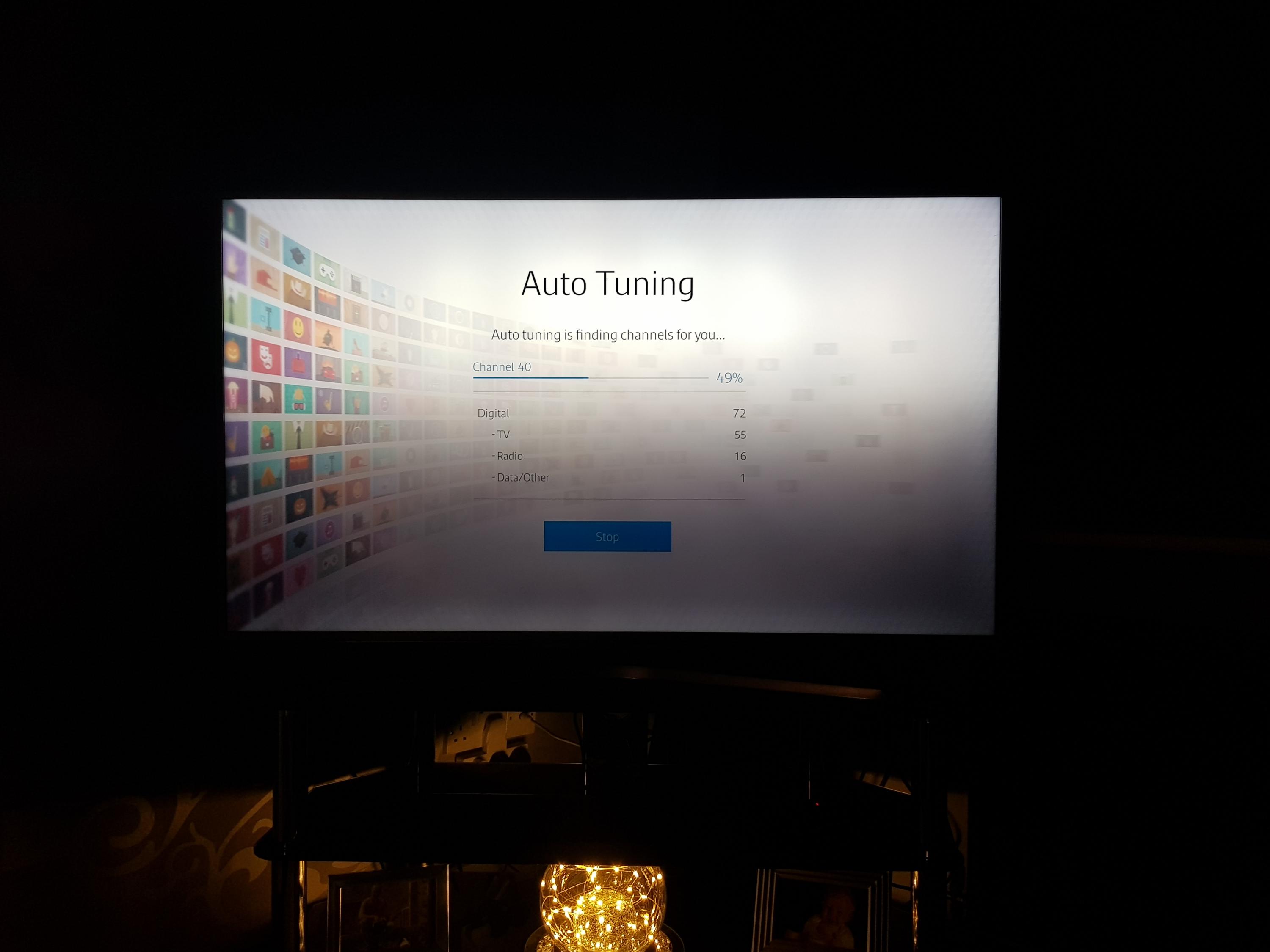

    Have a Samsung UE55JU6800kxxu that is darker on lower half of the screen, more noticible on solid black, or solid white images.
    Quick google search showed reviews on these TVs, that were far from glowing lol.
    Seems a common thing with them, my question is, am I looking as gradual Panel failure?? Or perhaps just dying backlight LEDs??
    Ive attached some pics (including one of the TVs built in picture test thats the first pic of the seaside setting) and have tried to capture best I can, but as the problem isnt really terrible (yet lol) its quite hard.
    Any input, advice, opinions greatly appreciated

    Looks like a couple of LEDs are out.
