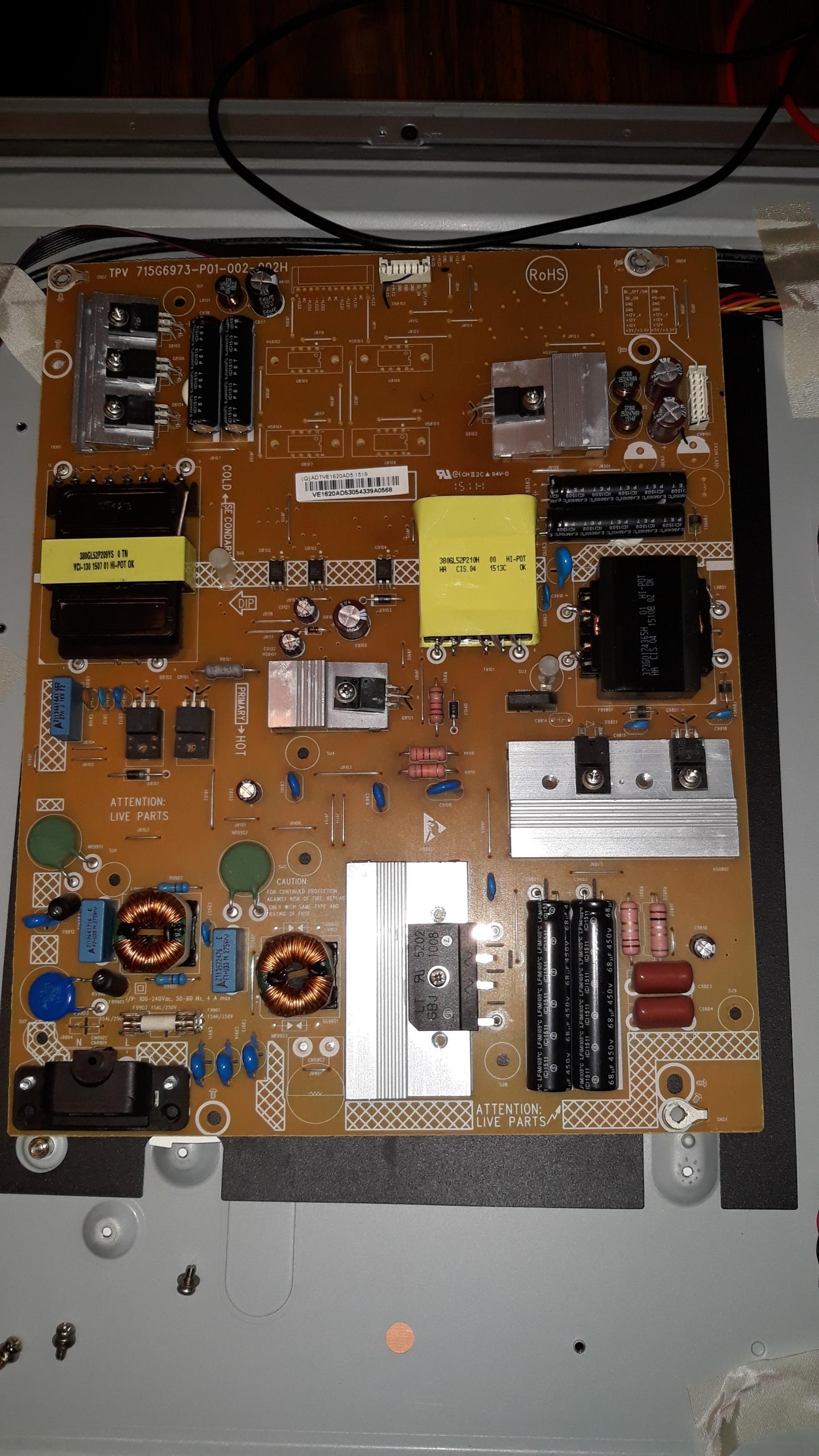

    I measured the voltage at the connector. Getting 19 volts at the 12 pins and with the main board connected I get the standby voltage. I get the 19 volts with the other boards disconnected.
    I hope there is some protection from over voltage on the main board. Don't want to do anything else till I can get the 12 volt pins reading 12 volts.

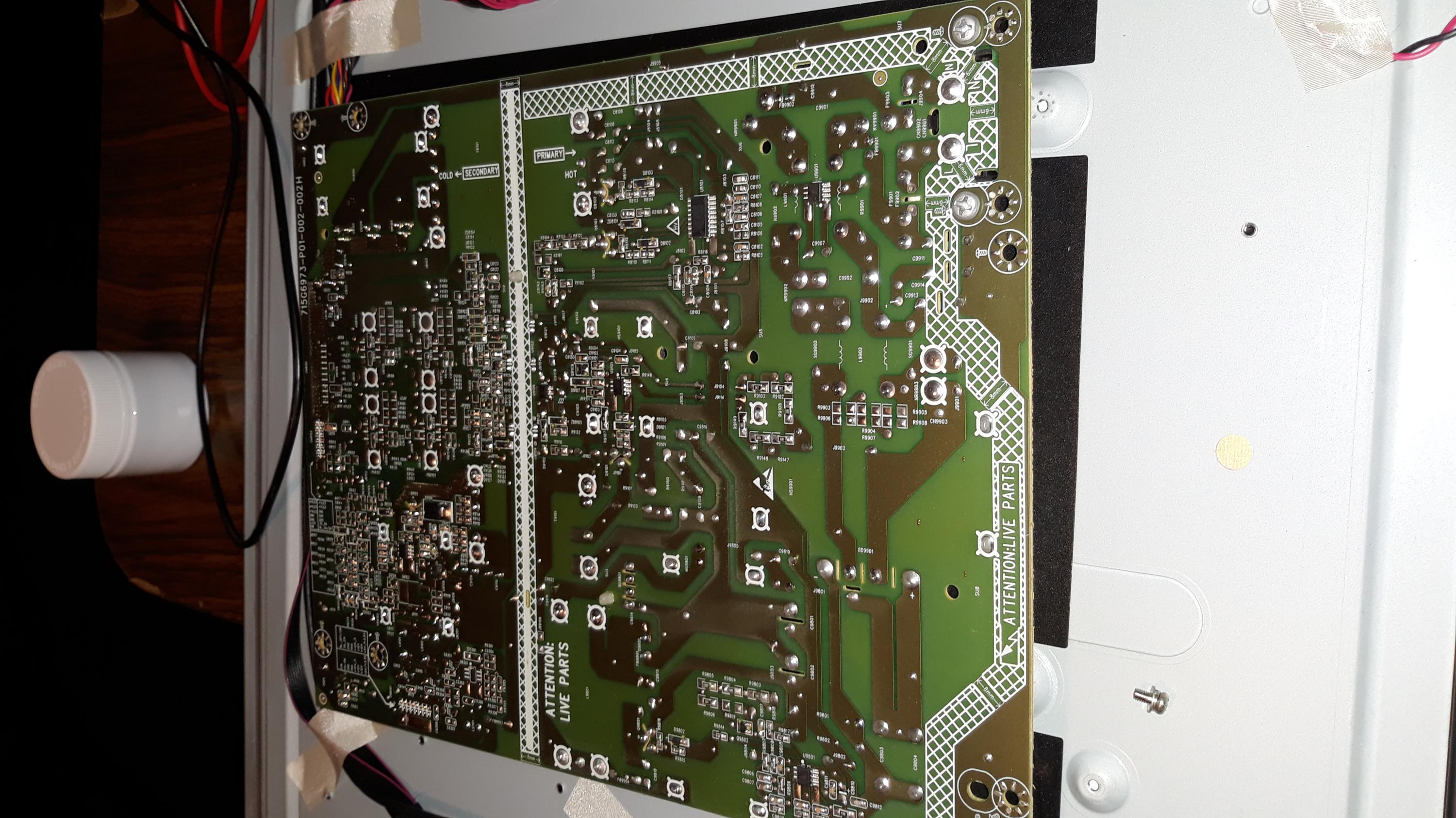

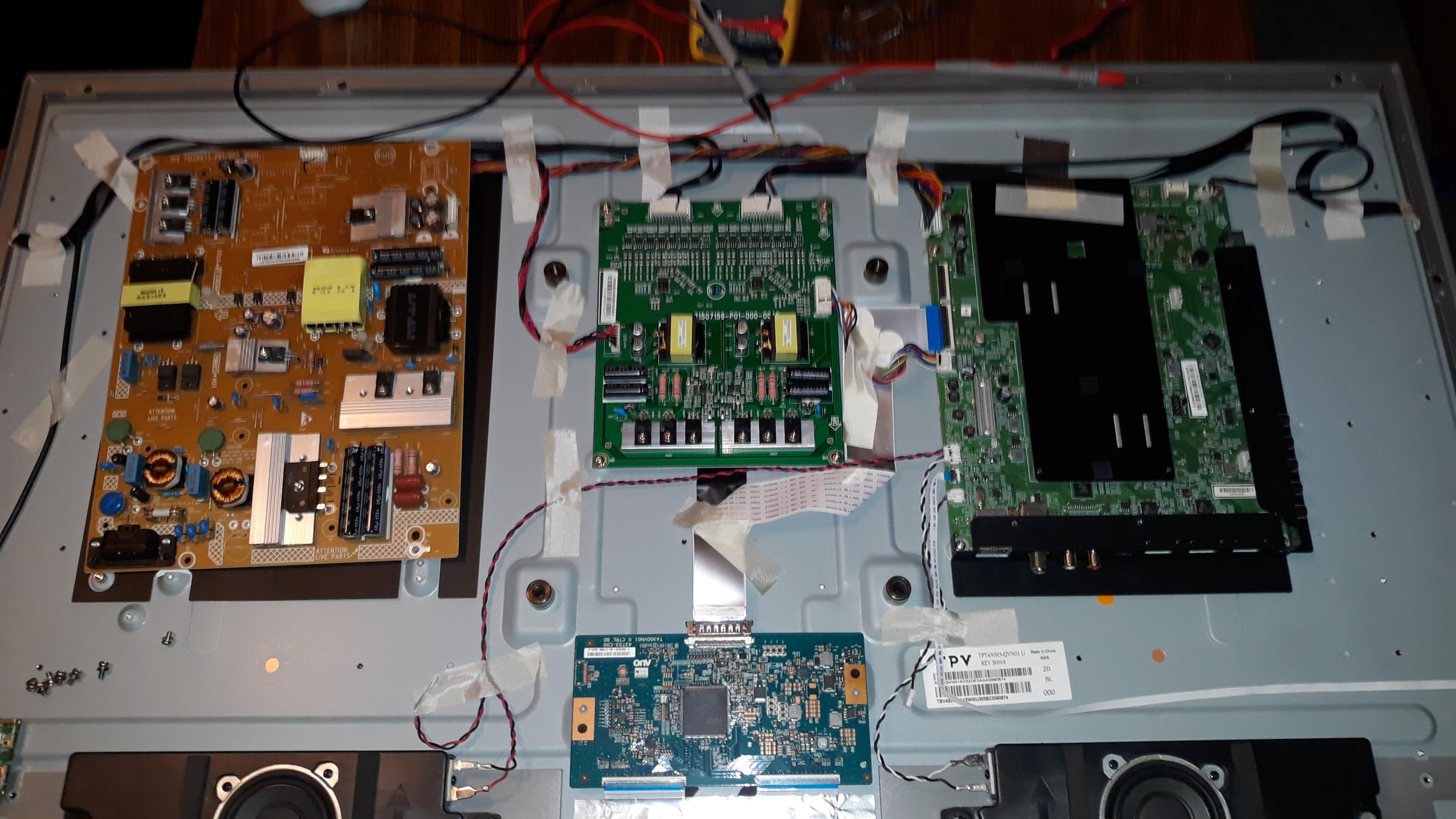

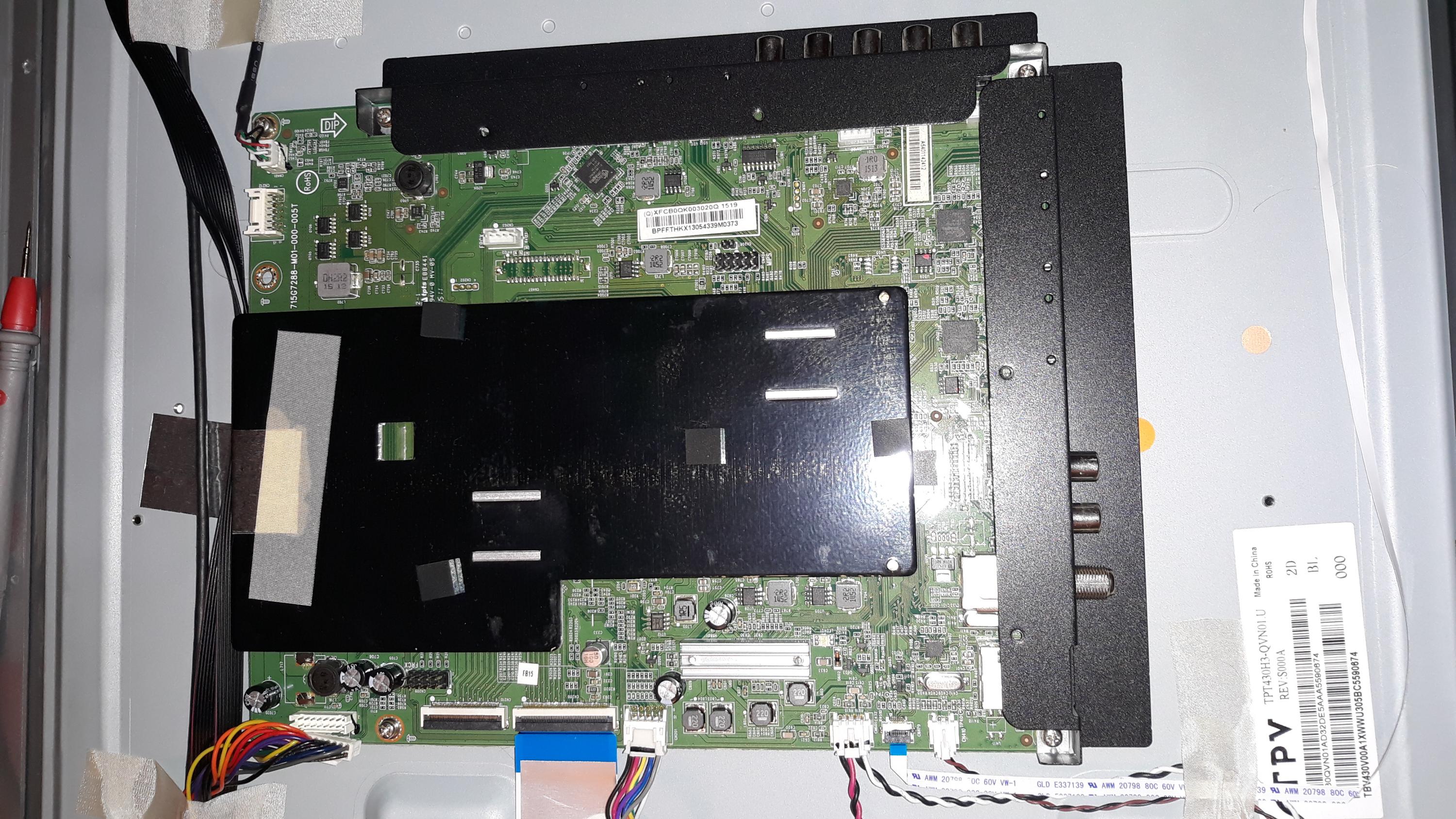

            Finally got around to checking again. Looking at the back of the board, that standby voltage must only come from the main board because there is nothing connected to it. Very short trace that leads to no components at all. So must be either the main board or the backlights. Will pull apart the screen and check them at least to eliminate them.

              "Obviously .107v is not enough to turn on the backlights" yep, that signal comes from the mainboard, good video on testing there: https://www.youtube.com/watch?v=ocqnqmBxiqY

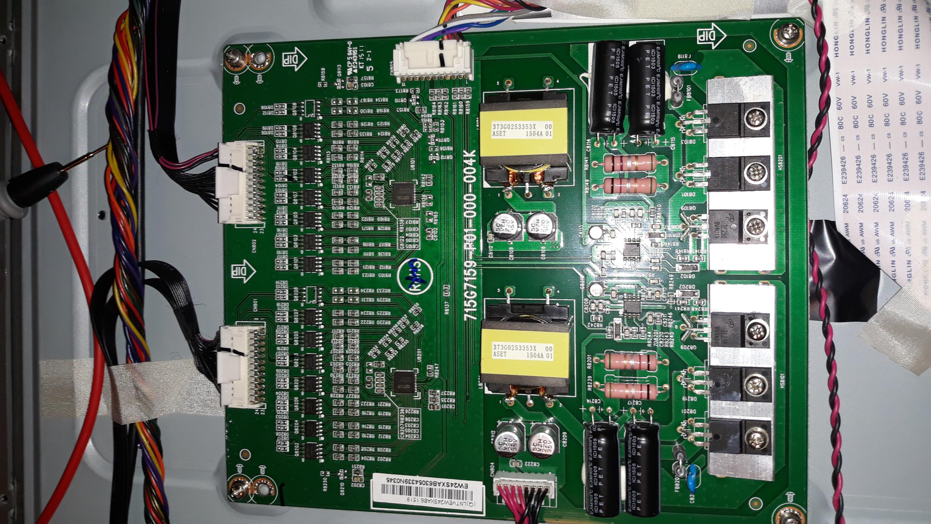

                The BL_ON/OFF and DIM on the power supply are used on this tv, the led driver board is controlled directly from the main board via CN805. It is not a simple ON/OFF signal, there are data signals that control the 14 led drivers. Check that you have DC (18V?) voltage on CN804 of the driver board.

                    This version of power supply board assembly does not have Backlights circuit, you can see that backlight section of the power supply board is not stuffed with parts, so this power supply board only supplies the running Voltage to the LED driver board, that is why the BL-ON/DIM control are not used on this power supply board, the main board controls the LED driver board directly.
