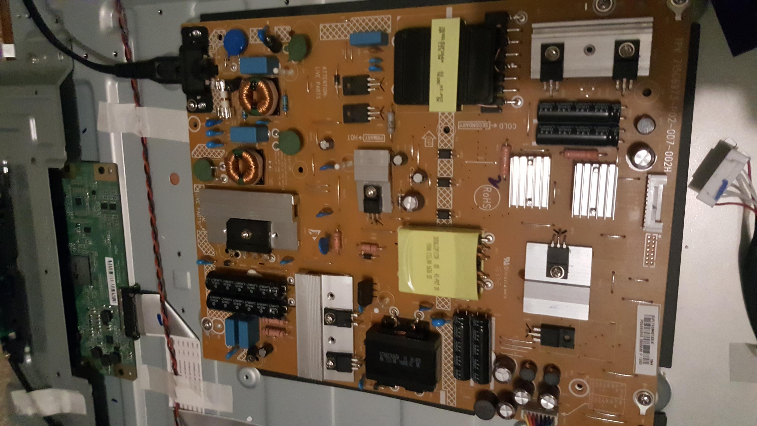

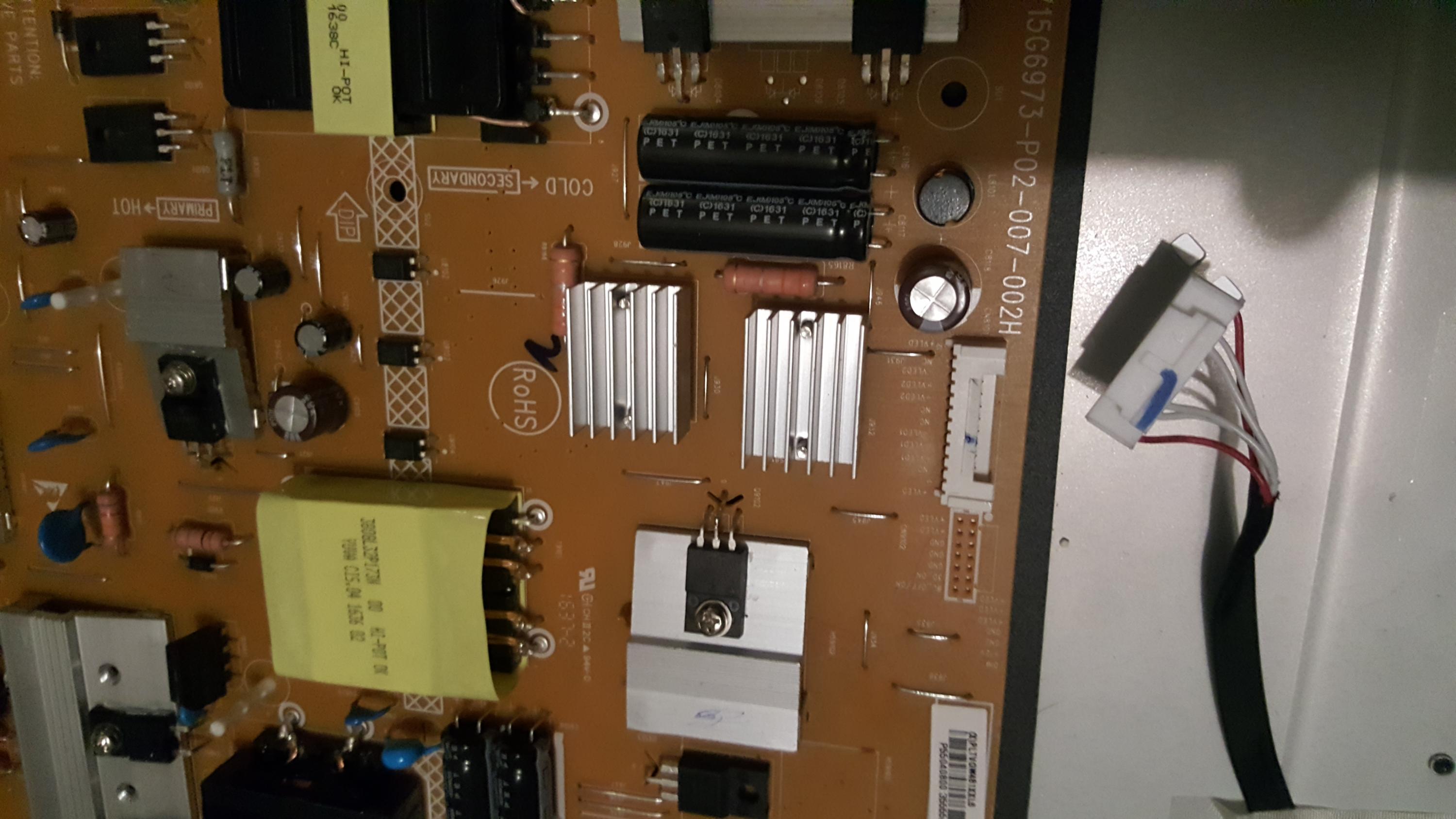

      Re: Philips 55PUT6201/12 no backlight
      Is this ok

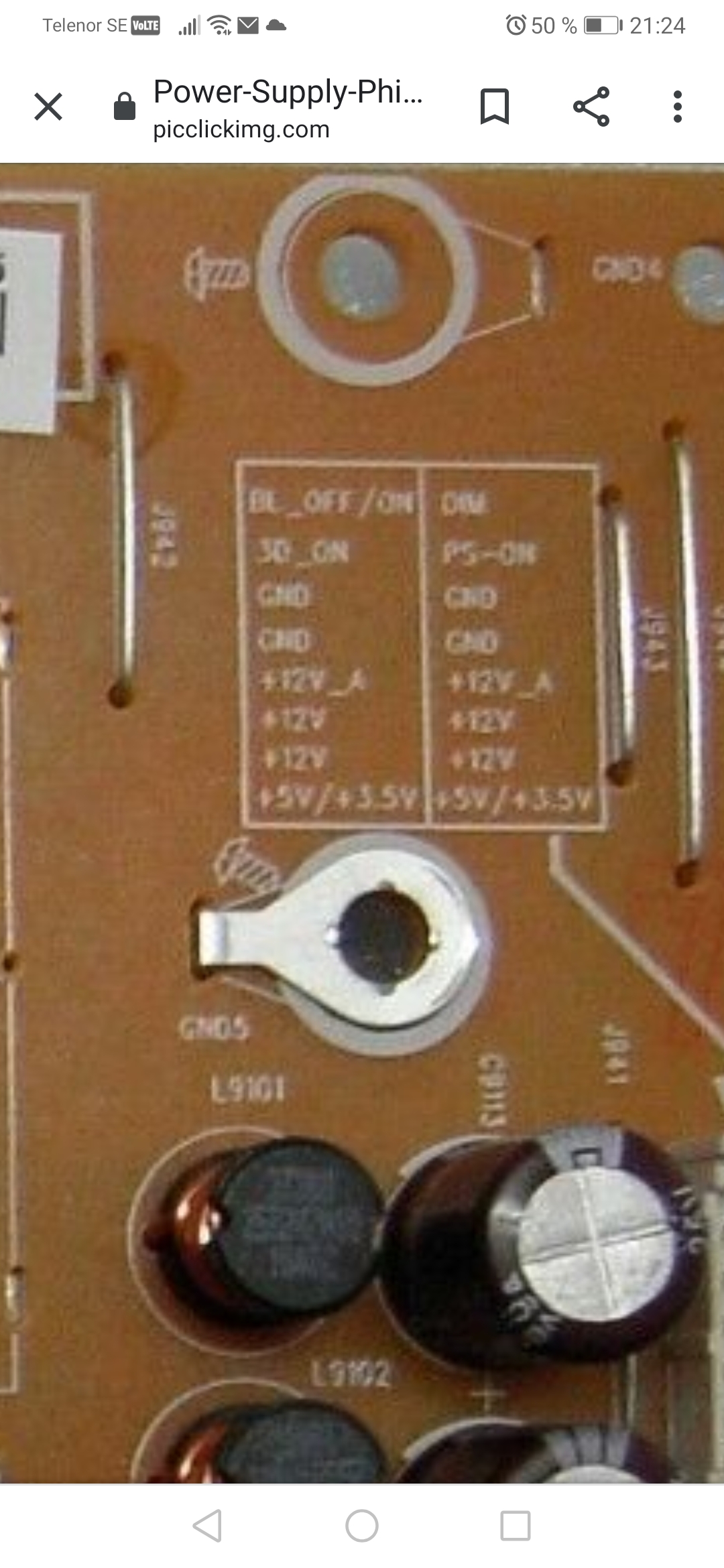

        Pictures are too blur for me to read anything on the board.
        We need hi-res straight shot of the whole top and bottom side of that power supply board.
        • Dennis74
          • Oct 2019
          • 9
          • Sweden

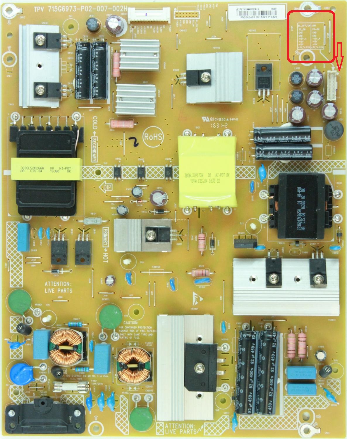

          Sorry find this online
          Is this ok
          • dick_barton
            • Aug 2015
            • 6643
            • Wales
            Can you give the names as shown in the red box and the voltage you read at the corresponding connector pin. Picture still too blurred to read the print.
