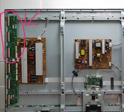

    Hello, i have a plasma tv lg50pa5500 that has sound but no picture. I have checked vs and va voltages and they are correct. If i check vy and vsc i obtain correct values only if i disconnect one buffer board. I've search for fault on it and i've found some short circuit. If i test the tv without that buffer board i don't have any half image on the panel. Can i proceed to order a new buffer board or i have to do other controls before i order it?

    If you found shorts on the buffer board ( was it the upper board) and with it removed you have all the correct voltages then I believe it would be safe to replace it to have your set up and running again.

      Yes but i don't understand why if i power up the tv after i have removed the buffer board i'm not having half image on the screen like is written in various similar posts on this forum

        If the lower buffer board is removed then you often have a top half picture. Signals are sent via the upper buffer to the lower buffer so if the upper buffer board is removed then no lower half picture.

          This is the buffer board that i've removed. Is this the upper buffer board?

            Yes if it lines up with the uppper half of the picture.

                Just a heads up, this model is known for the ribbon cable that goes from the buffer to the panel cutting and shorting out the buffer board. Search other post for other people which have the same issue. You should be able to remove the front trim to inspect the ribbon cables.

                    Remove the top buffer and it's the top cable (from buffer to panel) that rubs on part of the chassis.
