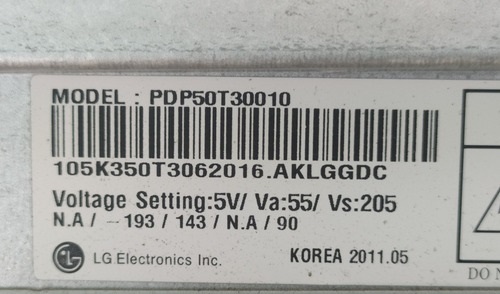

                  Re: LG Plasma (PDP50R10101) No picture No sound
                  they are listed but not labeled
                  For example on this photo:
                  -193 is -VY
                  143 is VSC
                  90 is Z-Bias
                  • SluggerB
                    • Aug 2020
                    • 747
                    • US
                    -193 is -VY
                    143 is VSC
                    90 is Z-Bias
                    Where would the test points for those voltages be?

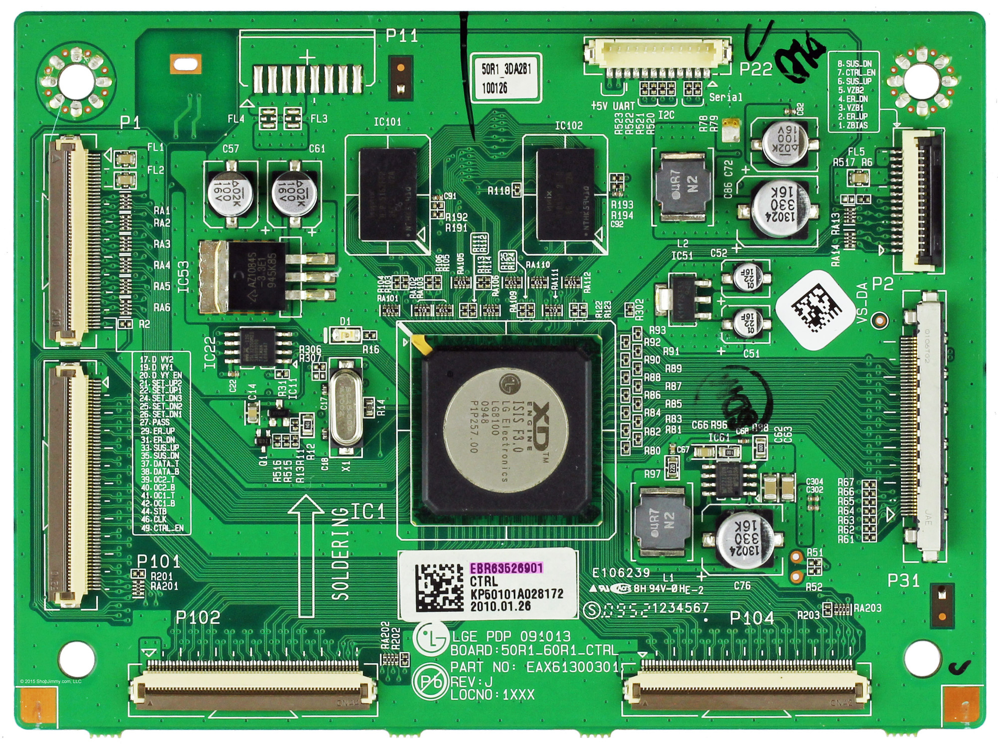

                                  • R_J
                                    • Jun 2012
                                    • 9535
                                    Here is a control board, the part number is on the white sticker EBRxxxxxxxx
                                    The voltages are listed in the training manual, I believe you should have 17 volts on FL1 or FL2, I think this voltage originates from the Y-sus board and not the power supply but I can't remember exactly
                                    The EAXxxxxxxxx number is the bare board number only

                                      • SluggerB
                                        • Aug 2020
                                        • 747
                                        • US
                                        Checked voltages, and there were present, but the board failed the Diode check, the manual said the diode readings should be 1.3 on the top 4 pins, and all 4 measurements were different and none were near 1.3
                                        Pulled the board and and found one on eBay for 19.99 and free shipping, so I ordered it. Lets see if it works!
