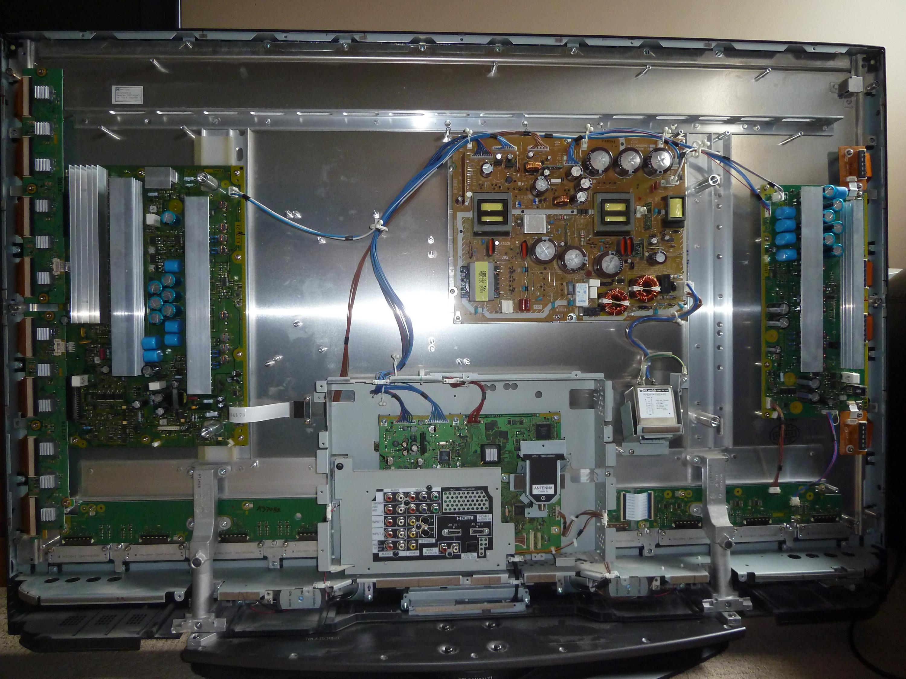

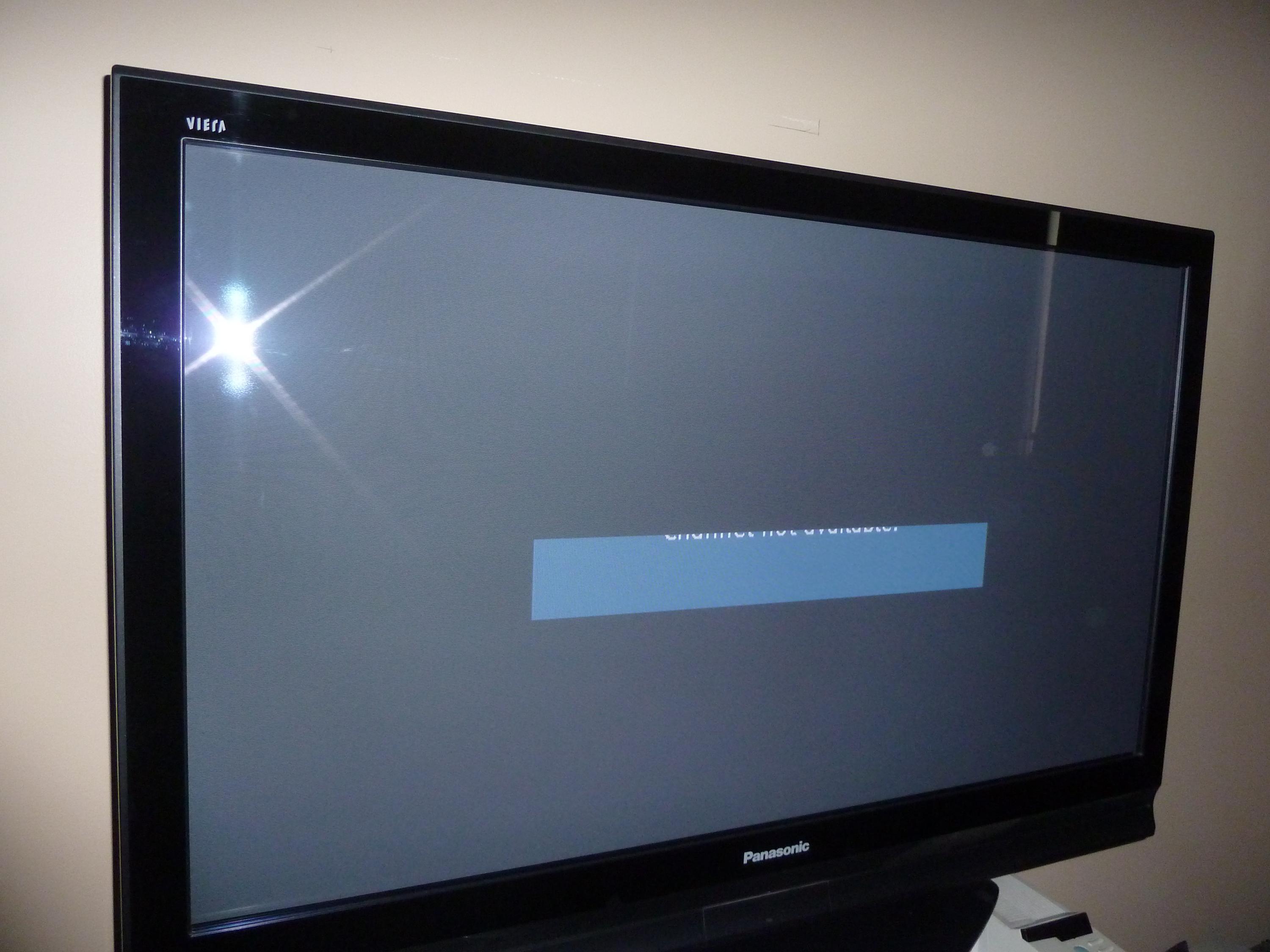

    Hey guys, I was given a Panasonic plasma because the top half of the screen was black but the bottom half was still working normally. Sometimes the top half would flicker on and off. I tried reseating all the ribbons and cables thinking it was a loose connection but it made no difference. After I fooled around with it for a while it was working most of the time with only the odd flickering on the top half. There was no real correlation between my tests and it starting to work. I set it up and started using it and it was perfectly fine 98% of the time. I used it like this for a couple months with no real issue. However, the TV has been left off for 4 months and now when I turn it on the top half it always black. Percussive maintenance has no effect.
    I found this thread where the solution ended up being a replacement upper buffer board: https://www.badcaps.net/forum/showthread.php?t=27128 However, in that thread it was stated that it is very easy to get a bad replacement board due to parts being pulled from cracked TV's. For this reason I would rather repair my board than chance buying a bad replacement. This should also be cheaper than buying a whole board.
    I recently repaired a Hitachi plasma with help from you guys where the issue was a shorted buffer ic on the upper buffer board: https://www.badcaps.net/forum/showthread.php?t=75627 I did the same diode mode test on this board as I did on the Hitachi and found no shorted buffers. I suppose this makes sense as it is not bringing down the whole display like on the Hitachi.
    So my question is, what else could the fault be? The only components on the buffer board are the buffers themselves and a few resistors/diodes/capacitors. Can the buffers just stop working even though they test fine in diode mode? I also can't see the part number of the buffers as they have a heatsink glued on top which I would rather not pry off if the chip is in fact fine.
    Any ideas on what to look for next are appreciated.

            The buffer ic's should be AN16076A-VT, most of the drive data lines and voltages are common to both the SU & SD boards, it is very likely it is just the SU board, there are a number of resistors that you could check IE: R6902,2,4 (22Ω) or R6925,6 (0Ω)
            When you checked the buffer board with your meter you were checking the buffer outputs, The whole top half is black so it is likely the buffer inputs have the problem, a shorted clock or data line on one ic would kill the signal to all of the upper ic's

              Well I spent some time probing the input signals to the SU and SD boards to no real result. On the connector going from the SC to SU board I get a clock on CLK and some data on OC1 and OC2. It looks to be the same on both the SU and SD boards. However, the SI pin which appears to be serial in and is then daisy chained through all the buffer chips, has what appears to be random pulses on it. The strange thing is there is no signal at all on the SI pin for SD which is the board that is actually working. I also have no idea what OC1 and OC2 actually stand for.

                  I did some diode mode tests on the SU and SD board data connectors. All values were basically the same except for one pin. I then traced the problem on that data line down to a bad 0 ohm link R6925 on the SU board. Replaced the link and the top half of the TV is working again.
