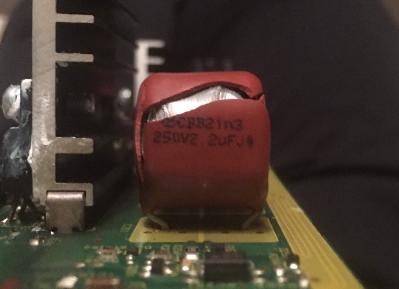

    Panasonic TX-P50UT50B 8 Blinks SS Board faulty
    Hi All. I have done the repair on this TV and only need to Identify and replace the following capacitor. I don't have any on any old scrap boards to salvage the part from so looking for some help in finding a replacement. I'm also unsure if the Cap is a Polypropylene or a Polyester type Cap. I started the thread below in another section >>
    https://www.badcaps.net/forum/showthread.php?t=79098
    Thanks in Advance,

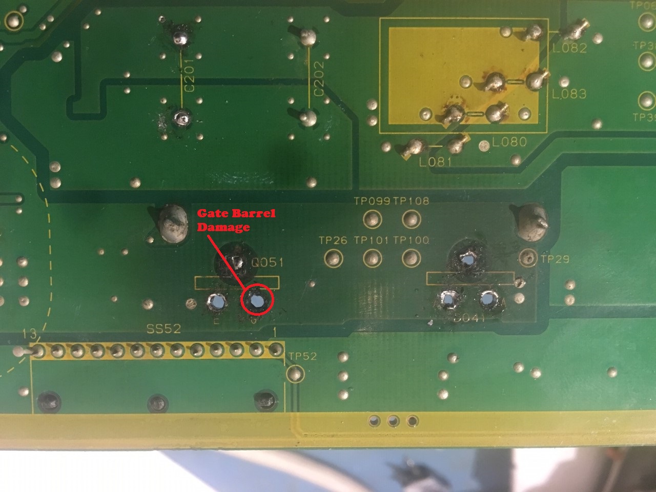

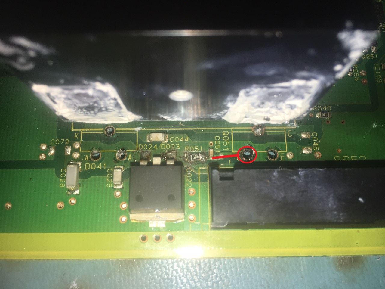

    Re: Panasonic TX-P50UT50B 8 Blinks SS Board faulty
    Morning All.

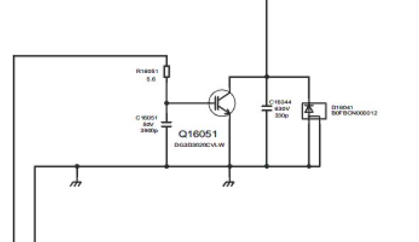

    I'm looking for advice on this repair please. The board has been repaired twice possible 3 times in the past 4/5 years and upon removal off Transistor Q051 (DG302), the Gate barrell came away from the PCB. Looking at the board it looks double sided and not multi layered, the question is can I take a solid 'Wire Add' to the test point next to C051 and onto the bottom of C051?
    As shown in the attached pictures.
    I cant see anything on the underside of the PCB that the Gate would connect to but someone might be able to point this out from the Schematics if possible.
    Thanks in Advance for any advice on this,
    S.
      Next to C051 there is a spot you can solder to, nothing on the bottom.
