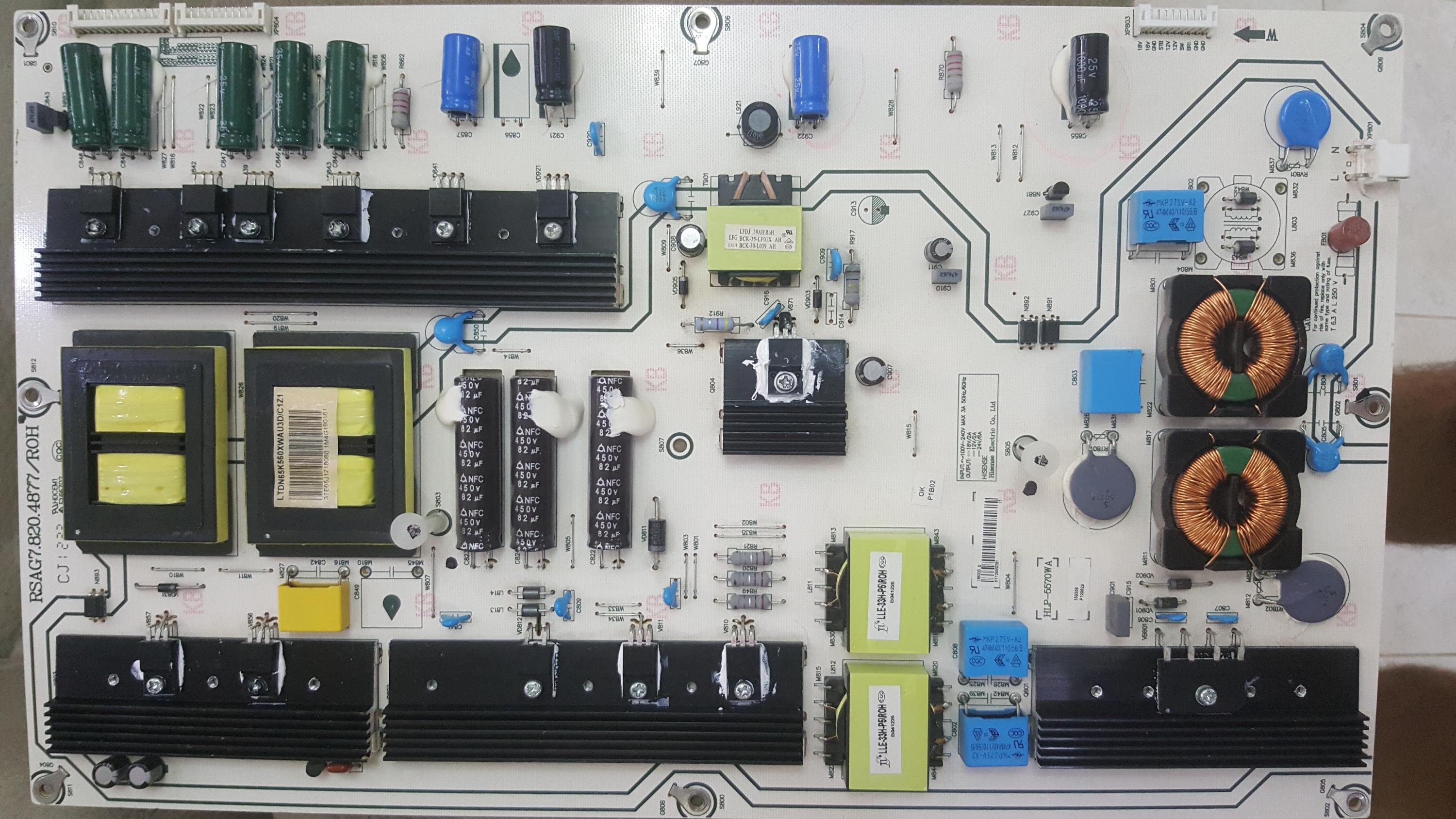

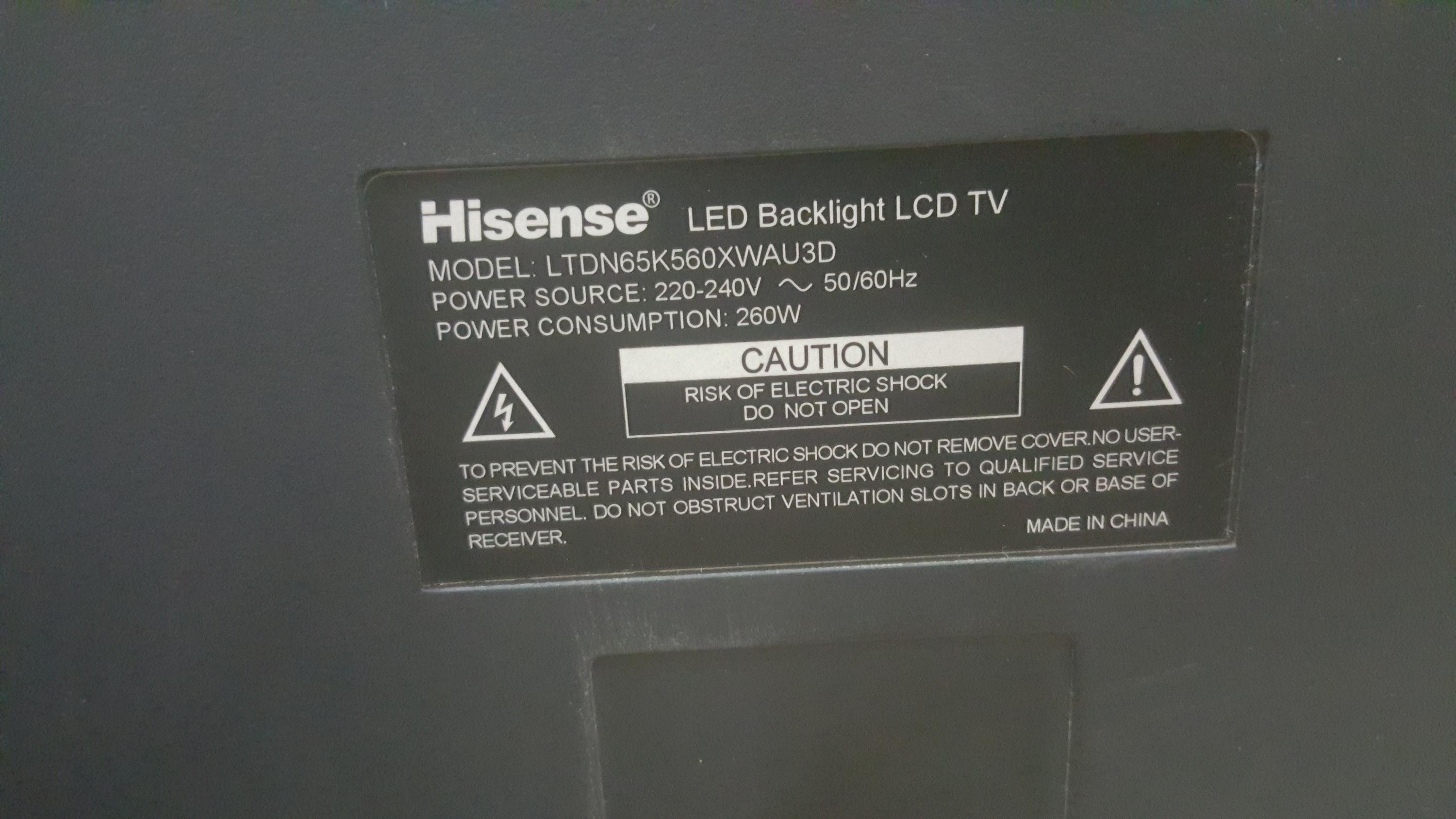

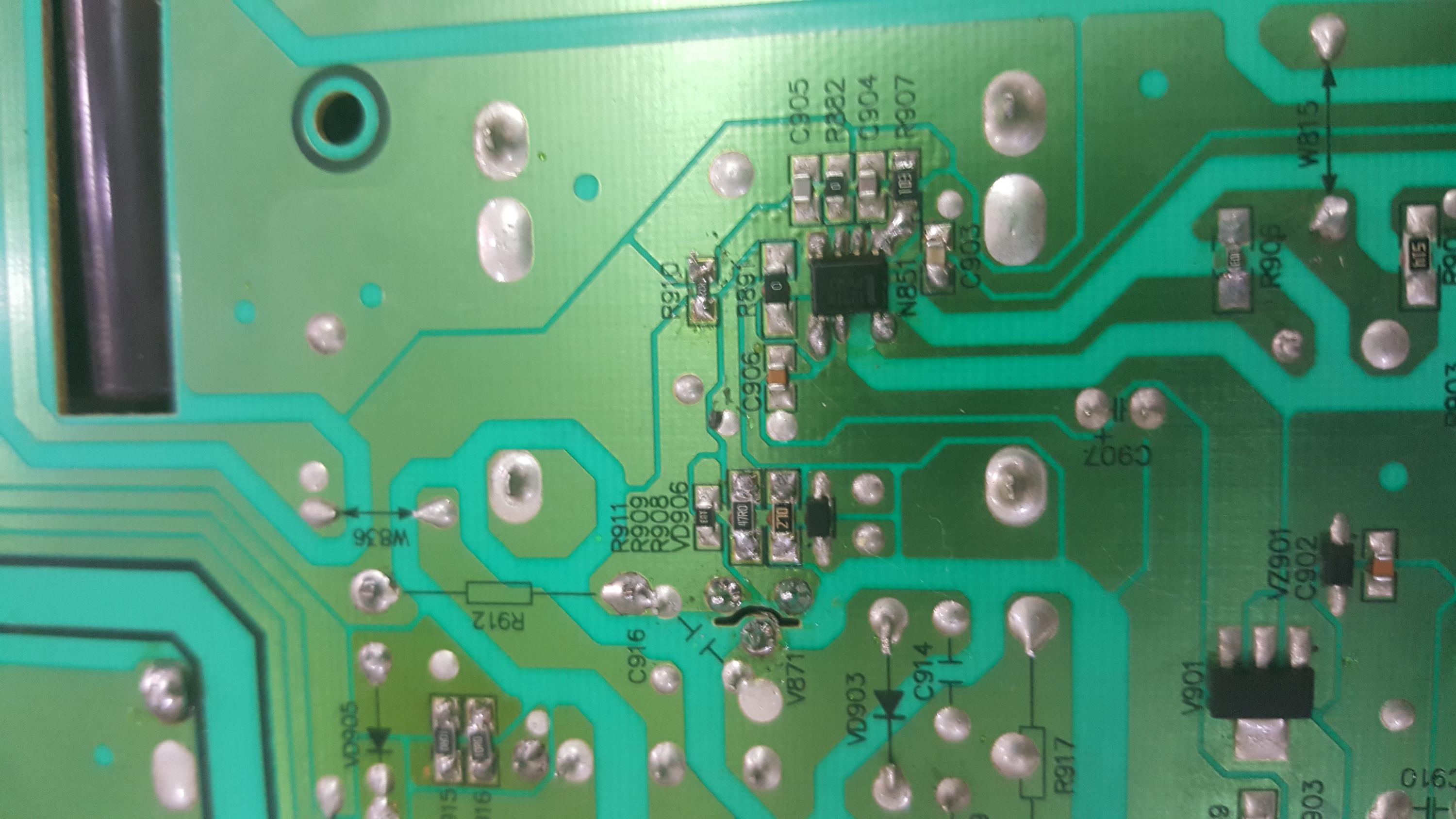

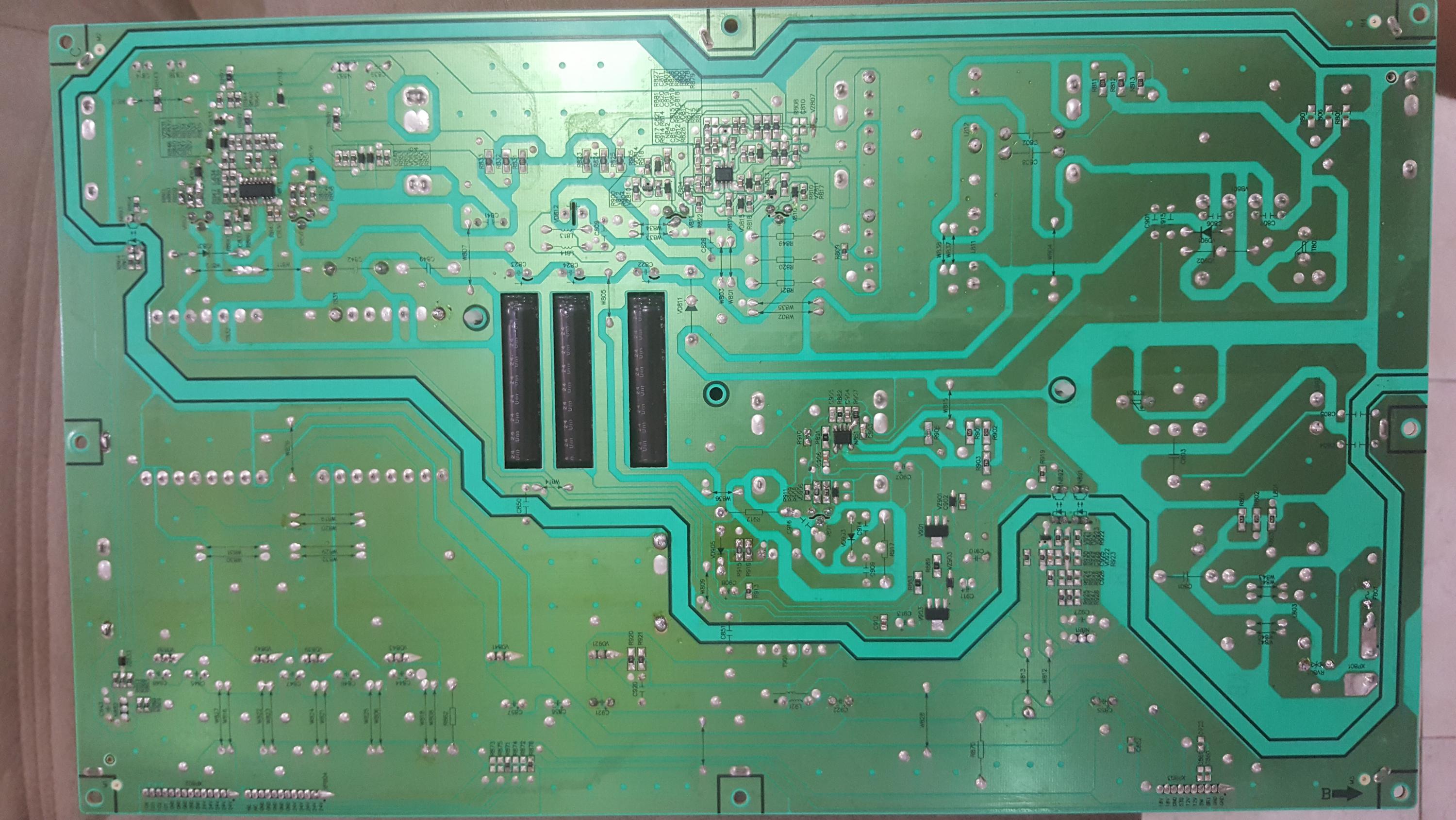

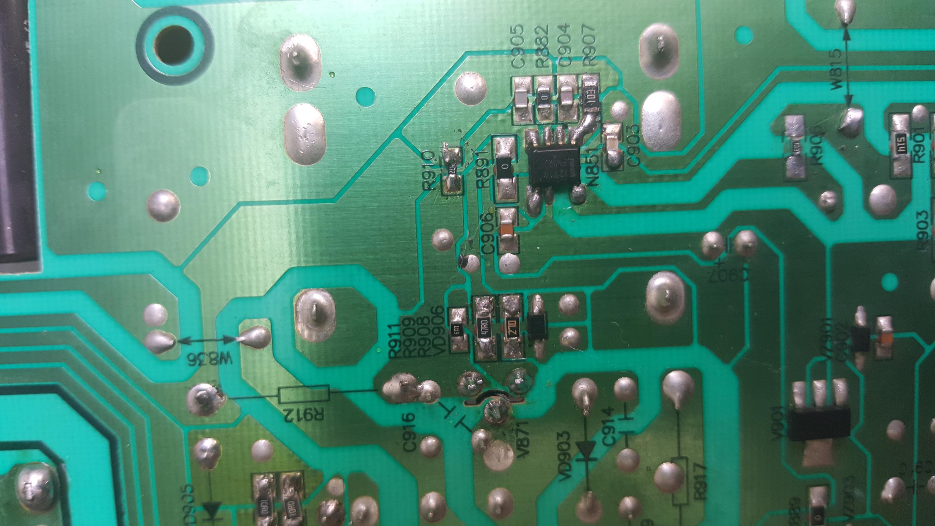

    Hi guys,
    I just fixed a totally not working tv.
    Tv model is LTDN65K560XWAU3D.
    After I connected it to the wall I have noticed that is blinking slightly.
    What is usually the cause for a blinking tv except caps?
    Thanks in advance.
    I will attach a close footage of the area where I replaced parts.

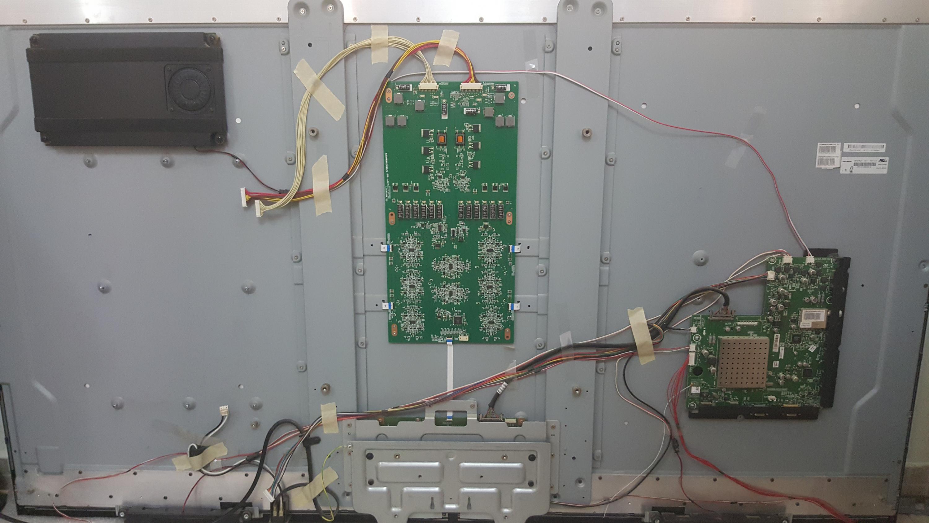

                            Turned the backlights to minimum and it helped.
                            It mean that some of my leds are burnt?
                            I want to fix it completely before I reassemble the TV.
                            • diif
                              • Feb 2014
                              • 6978
                              • England
                              Re: Hisense 65" led is blinking
                              Yes, as suspected a failing LED. You'll need to strip the panel out to get to the strips.
