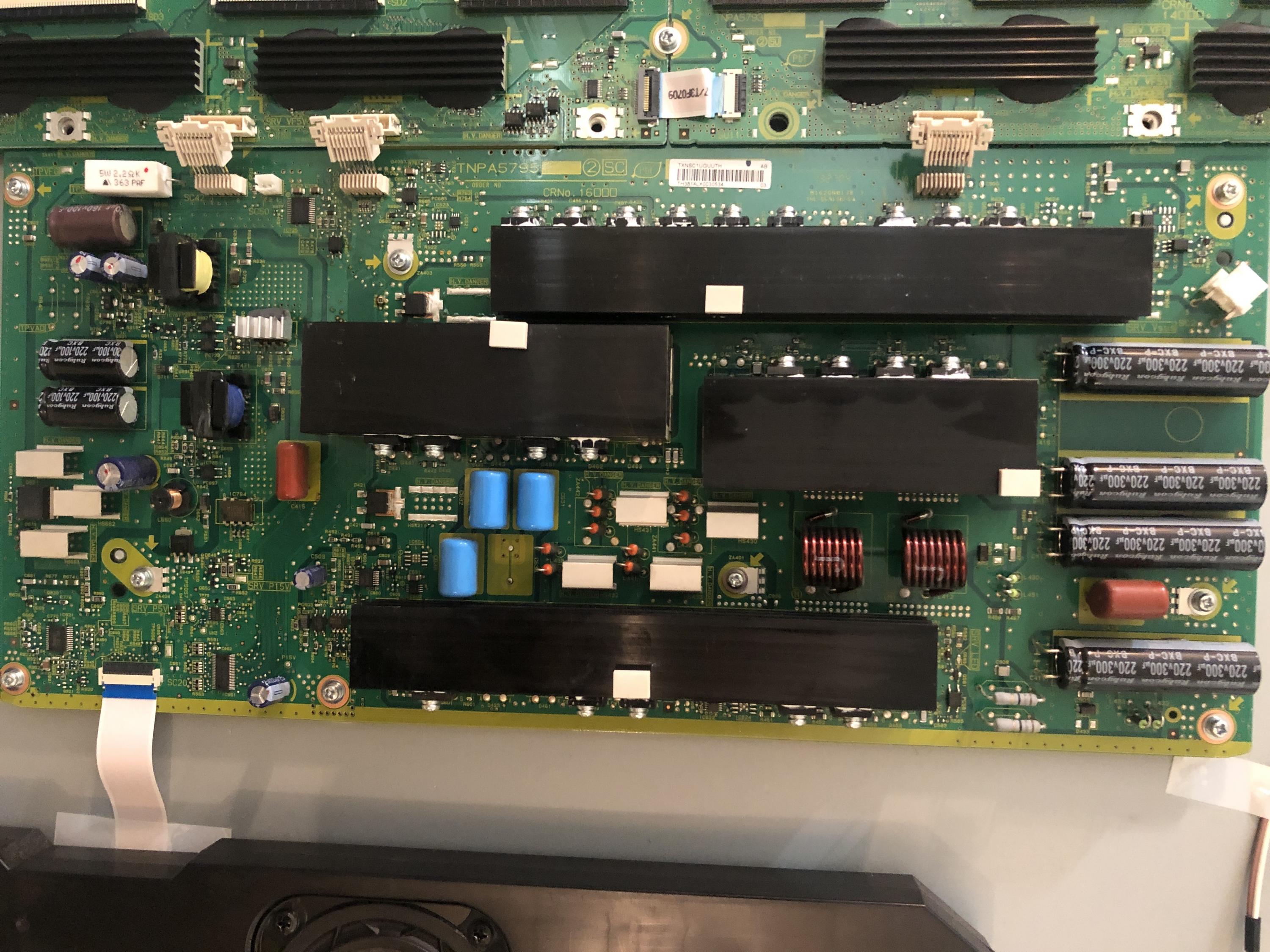

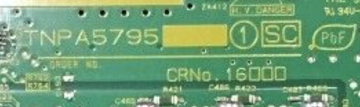

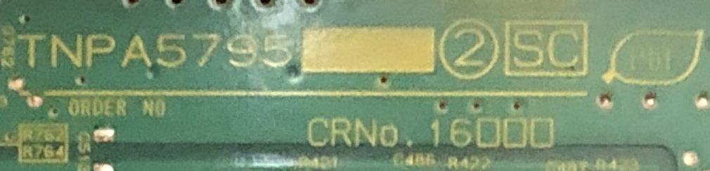

    Can anyone confirm what the numbers on these two Panasonic P60ST60 SC boards mean?
    I'm ordering a replacement SC board but on my TV the board says TPNA5795 SC and the number 2 in a circle. On many of the replacements I'm looking at it says TPNA5795 SC and the number 1 in a circle. Part numbers match exactly.
    Does anyone know what the 1 and 2 in a circle mean? Anything I need to be aware of before ordering the replacement or no worries?

    Post a picture of your board. Shopjimmy has that number with the AB suffix. You must get the exact one for your tv.

      That is blank PCB P/N, you need to match the PCB assembly number as printed on the bar code sticker since blank PCB can be stuffed to make many difference PCB assemblies.

        The one with the 2 on it is my exact board. Attached is an image of it without zoom.

        Yes, I've matched the models exactly from the sticker. TPNA5795AB TXNSC1UGUUTH. But like I said, many of the boards have a 1 in a circle instead of 2.
        So the yellow rectangle is the area for a blank PCB P/N and the 1 and 2 in circles don't mean anything then?

          That may be the blank board revision.
