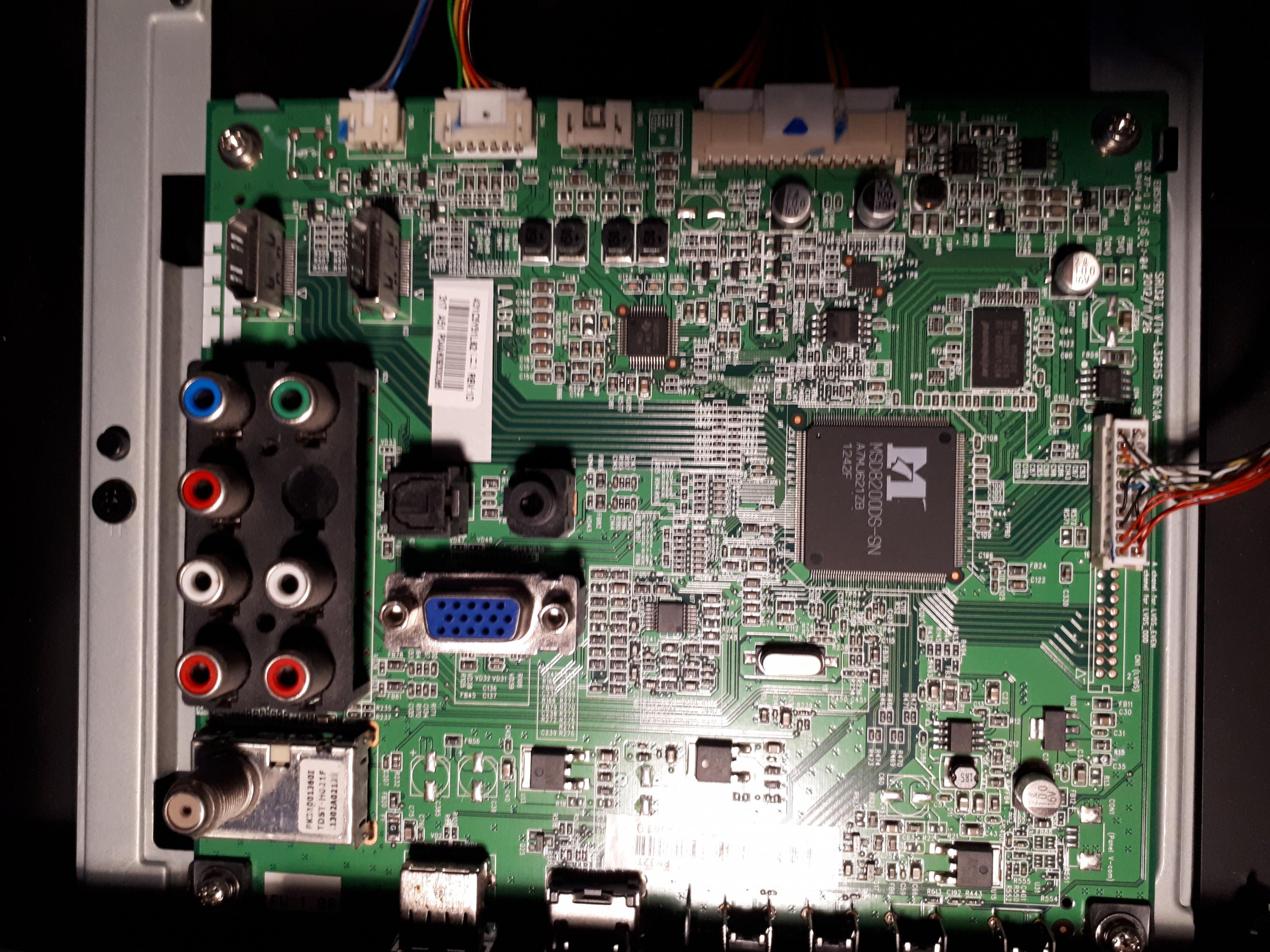

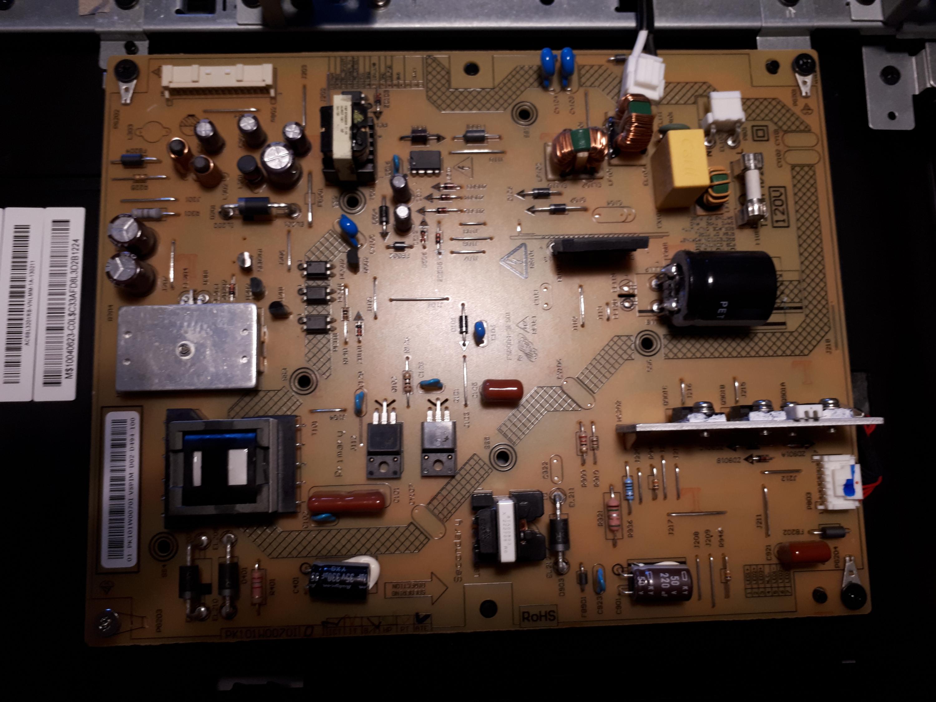

    Hi All.
    Does anyone have a service manual for this TV?
    It is dead, but there is voltage from PS to main board.
    Why is Toshiba such a hard find for service manual? Everything else is out there.
    Thanks in advance,
    Tim

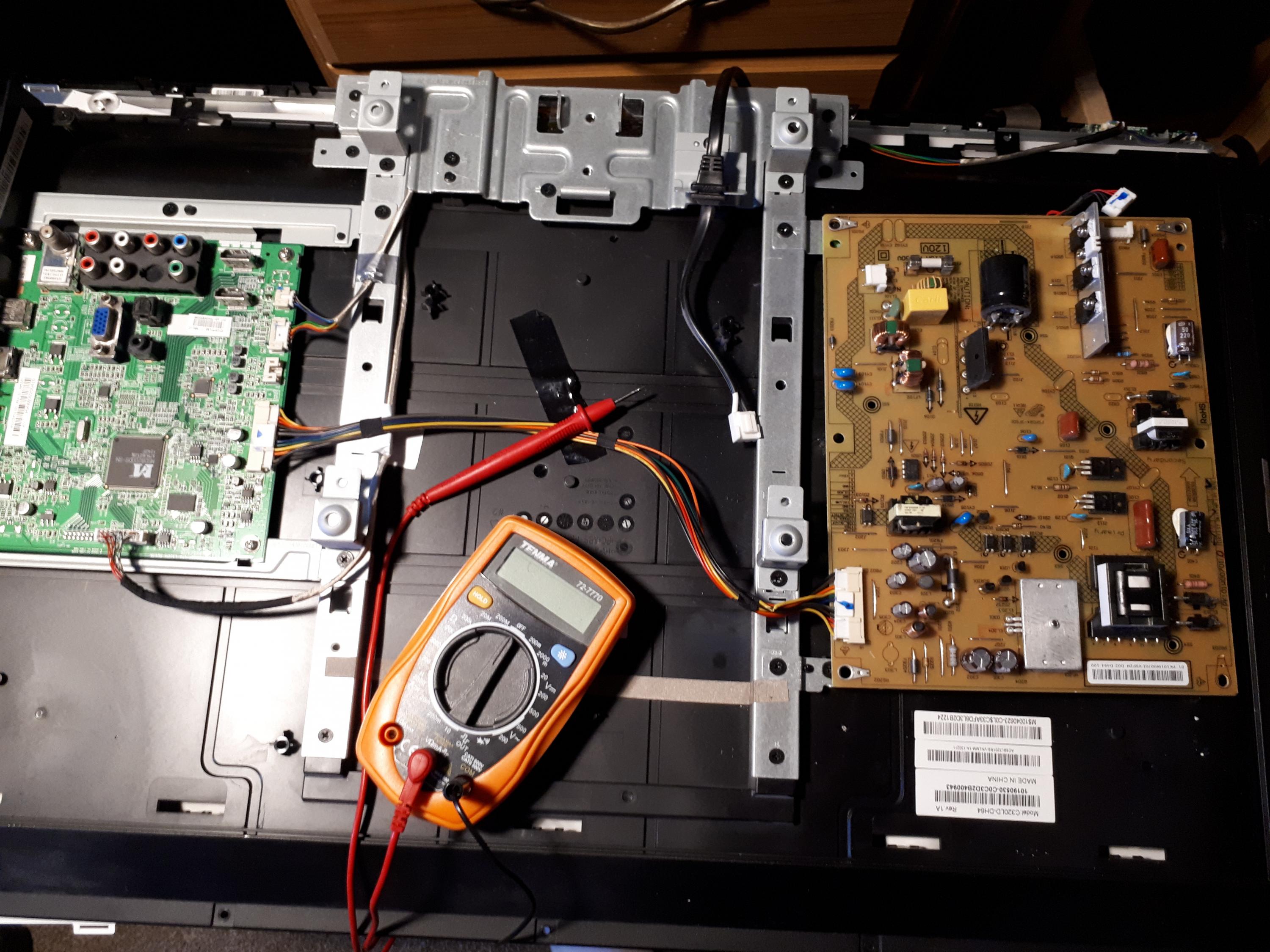

      There are many Voltages and Control Voltages on the power supply connector, you need to show pictures and the Voltage readings of each pins of the power supply connector that goes to the main board, right now we have no idea as to what we are dealing with without seeing the pictures.

          After reporting those voltages. With tv unplugged from power, unhook cable from powerboard to mainboard, plug tv into power, see if backlight comes on and stays on.
          Meter
          pin 1 - 12Vcc - 12.67Vcc
          pin 2 - 12Vcc - 12.67Vcc
          pin 3 - 12Vcc - 12.67Vcc
          pin 4 - GND - 0
          pin 5 - GND - 0
          pin 6 - 12_AUD - 12.67Vcc
          pin 7 - GND - 0
          pin 8 - 12V_LNB - 0
          pin 9 - GND - 0
          pin10 - 5V1 - 5.17
          pin11 - AC_DETECT - 3.53
          pin12 - POWER_TV - 3.32
          pin13 - BL_On/off - 0
          pin14 - 5V1 - 5.18
          pin15 - PWM - 0.11
          I did a tear down and tested the LEDs (3 strips) with a dc power supply and doing a continuity test. All three strips are dead.
              pin15 - PWM - 0.11
              It looks like you do not have Backlights on command or the PWM (Dimming) command from the Main board.

                    With tv unplugged from power, unhook cable from powerboard to mainboard, plug tv into power, see if backlight comes on and stays on. Post #4, did you do this, it's a process, directions need to be followed or it just takes longer to get to the issue.

                      There is no BL-ON/OFF and PWM signals from the Main Bd. The BGA Chip could need some heating to fix this issue.
                        Sorry. Yes I did. Nothing.
                          Re: Toshiba 32L1350UD
                          Originally posted by timbit
                          So...ps or main is having the issue?
                          Tim
                          Main board issue.
                            So I have ordered a new main board. I will post a reply after it arrives. Thanks for all the help to all of you.

                                      I took OP's list and updated with my values:
                                      Meter
                                      pin 1 - 12Vcc - 11.31Vcc
                                      pin 2 - 12Vcc - 11.31Vcc
                                      pin 3 - 12Vcc - 11.31Vcc
                                      pin 4 - GND - 0
                                      pin 5 - GND - 0
                                      pin 6 - 12_AUD - 11.31Vcc
                                      pin 7 - GND - 0
                                      pin 8 - 12V_LNB - 0
                                      pin 9 - GND - 0
                                      pin10 - 5V1 - 4.86Vcc
                                      pin11 - AC_DETECT - 3.13Vcc
                                      pin12 - POWER_TV - 3.13Vcc
                                      pin14 - 5V1 - 4.86Vcc
                                      pin15 - PWM - 0.1Vcc
                                      This is from the cold side obviously, but the way the power board is made, the hot side is still very close and accessible.

                                        "pin13 - BL_On/off - 0" Sure looks like you have the same issue, no bl_on signal coming from the mainboard, replacement mainboard should do the trick.
