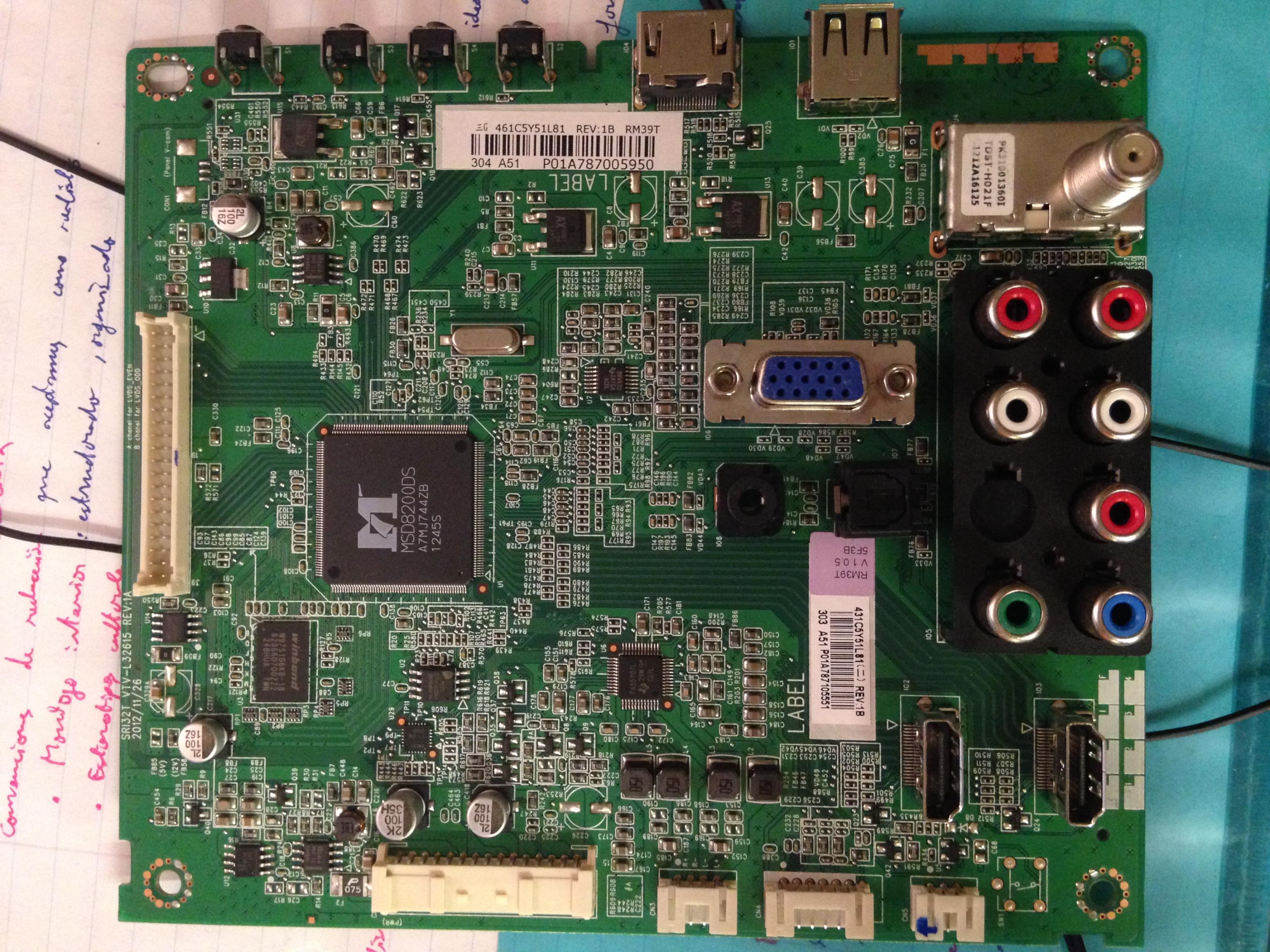

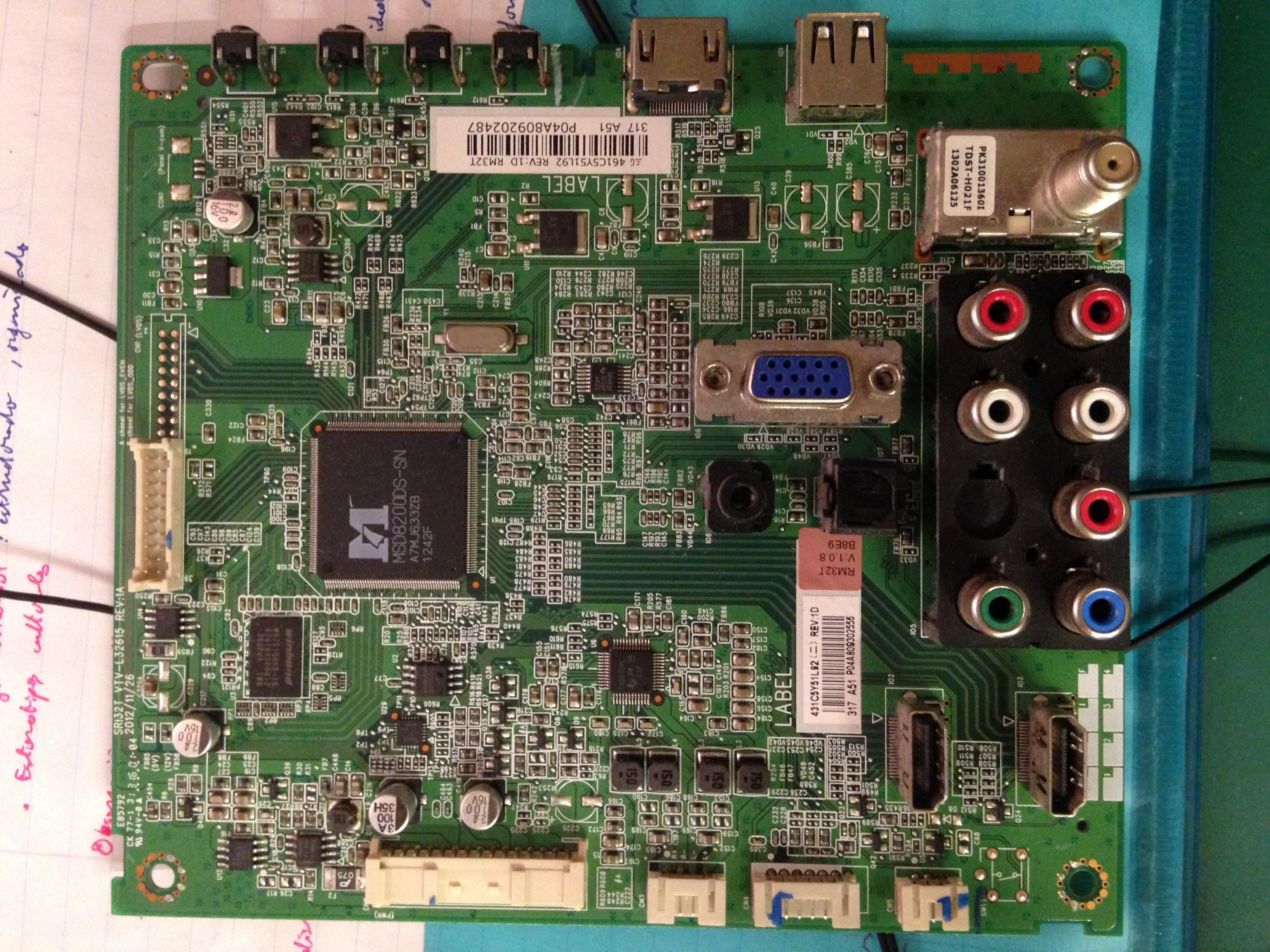

                Re: Toshiba 32L1350UD
                Sure:
                Original board:
                Replacement board:
                  • nomoresonys
                    • Jan 2013
                    • 12276
                    • U.S.
                    #29
                    I don't know if you have a mismatch mainboard or not, you could try a firmware update/pair, the closest I see is this BUT I don't know if it will work on your tv. Could try contacting them and ask or maybe someone here has tried it on their tv and can advise:
                        An update: turns out the board was mismatched. My mistake as I didn't pay attention to get the exact same number.
                        New board appears to bw working fine, now waiting for the remote control to come in, since most functions cannot be accessed without it.
