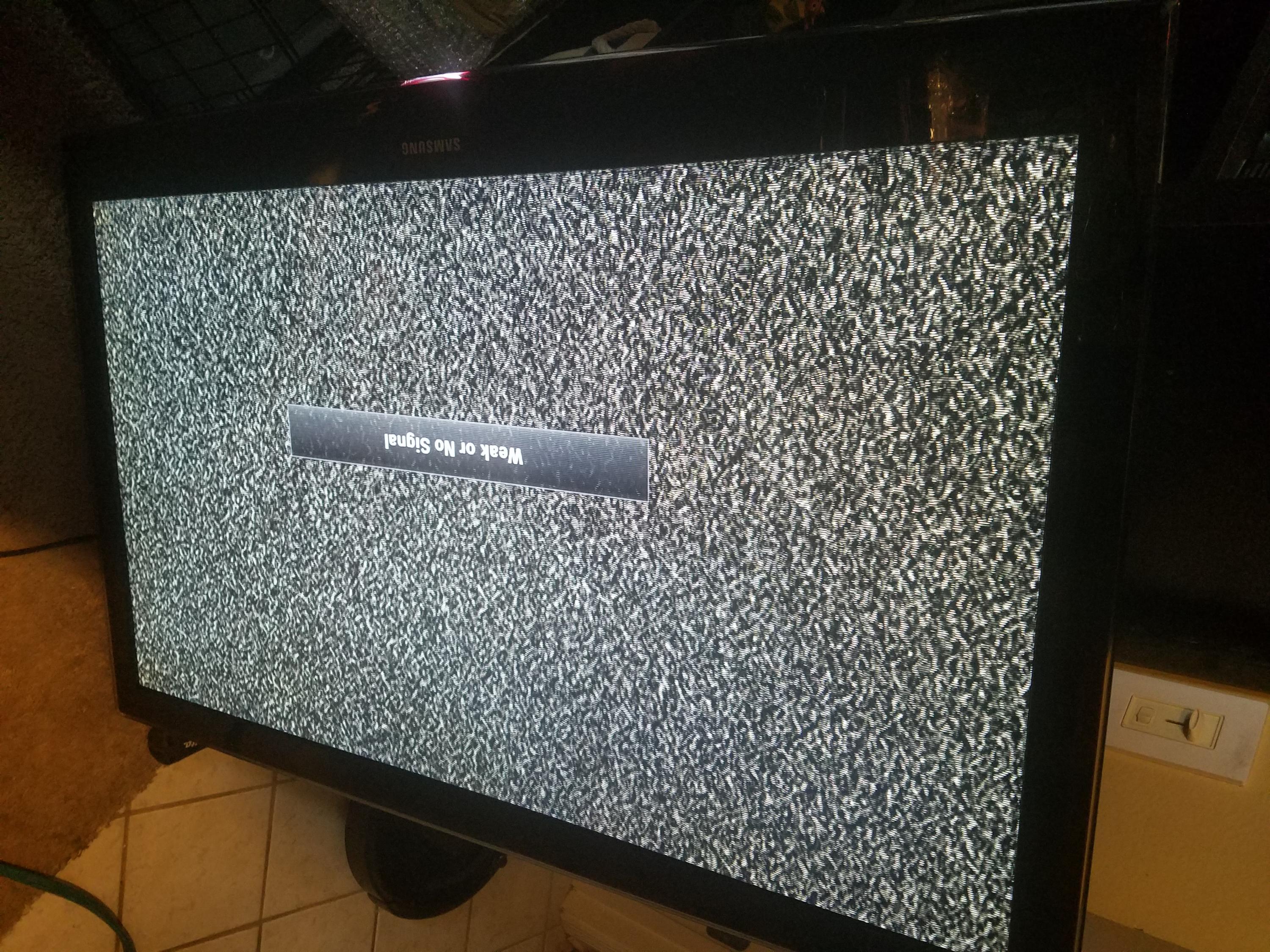

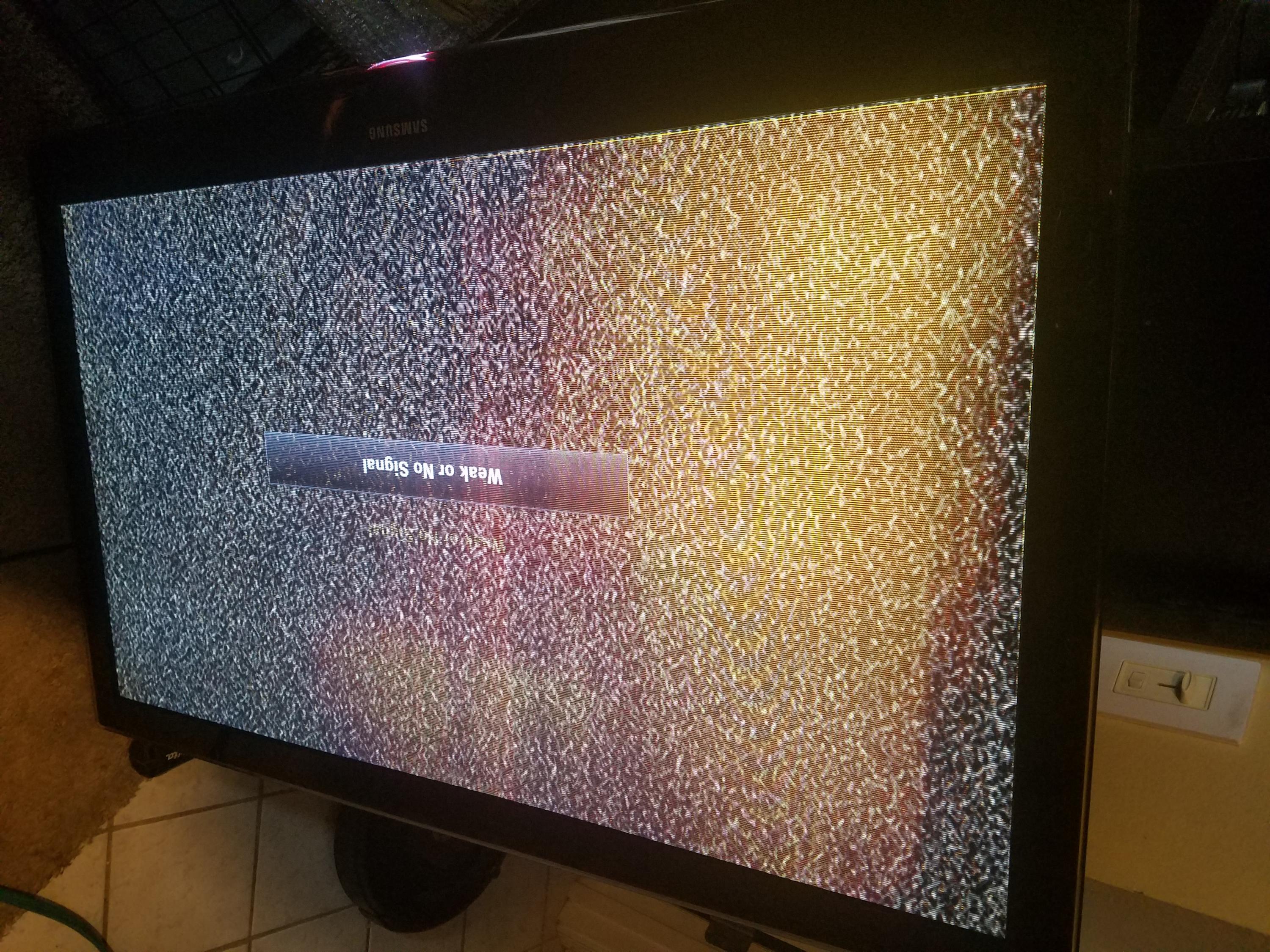

Samsung un46B6000 picture issue after TCON change
  • Brucetafer
    • Jun 2018
    • 133
    the TCON board was bad in this unit and was super white and faded out badly, So i changed it with another "known working" on eBay, and it works perfect for a couple seconds then fades out, and then resets itself as you can see in the pictures.. all the voltages on the power supply are pefect, LEDS are drawing the correct current and all the menu, sound, inputs work fine.

    Re: Samsung un46B6000 picture issue after TCON change
    reset samy as hard rest from service menu (not from setting menu )... so all driver will register the new quest hardware you added

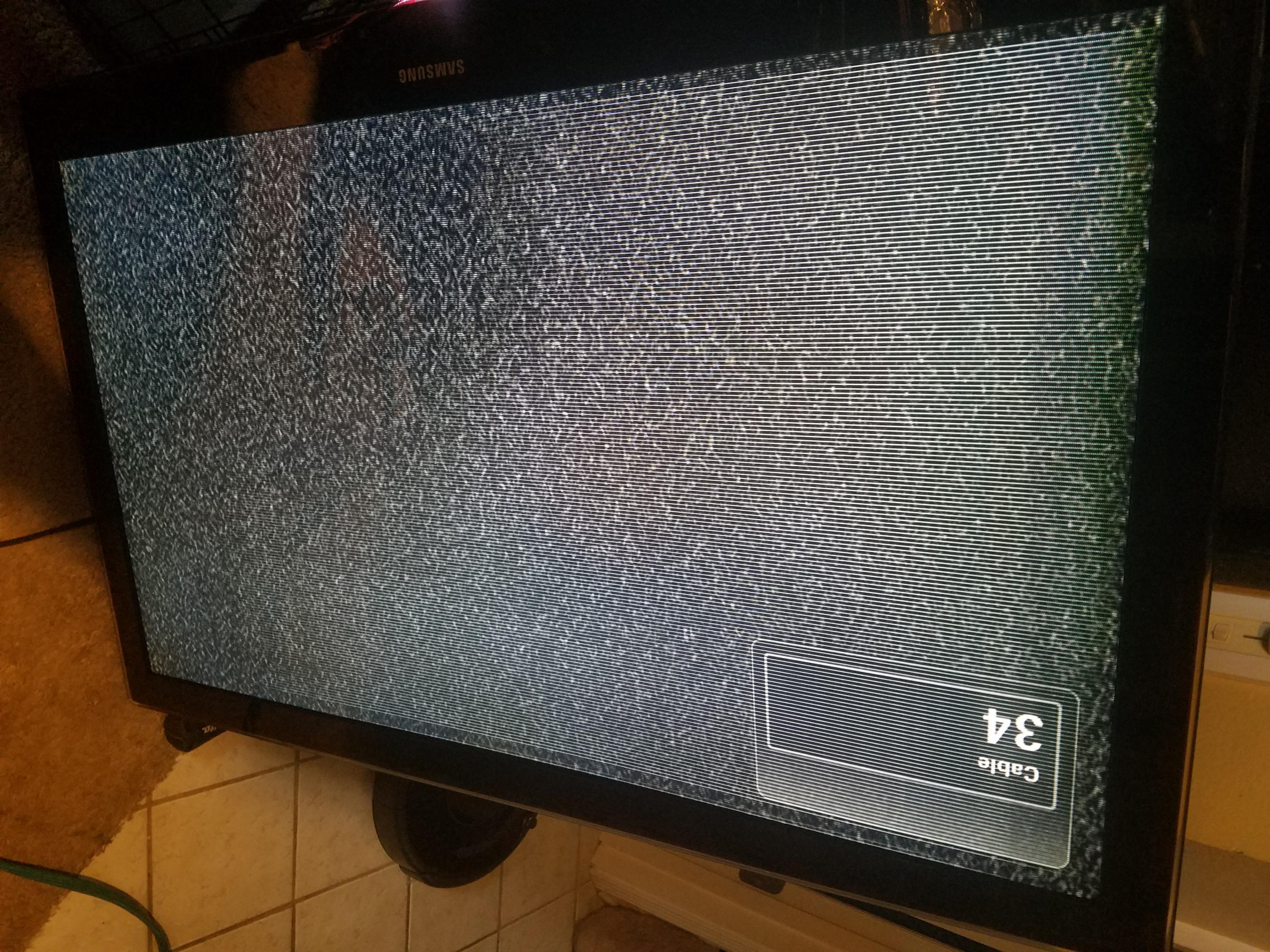

      It refreshed again, then worked solid for 10 minutes, then did this.. ugh! I just want a tv for my bathroom!!! this one is only 1 inch thick...
        Check your little caps on tcon, check them for low ohms or shorts, tv unplugged of course.

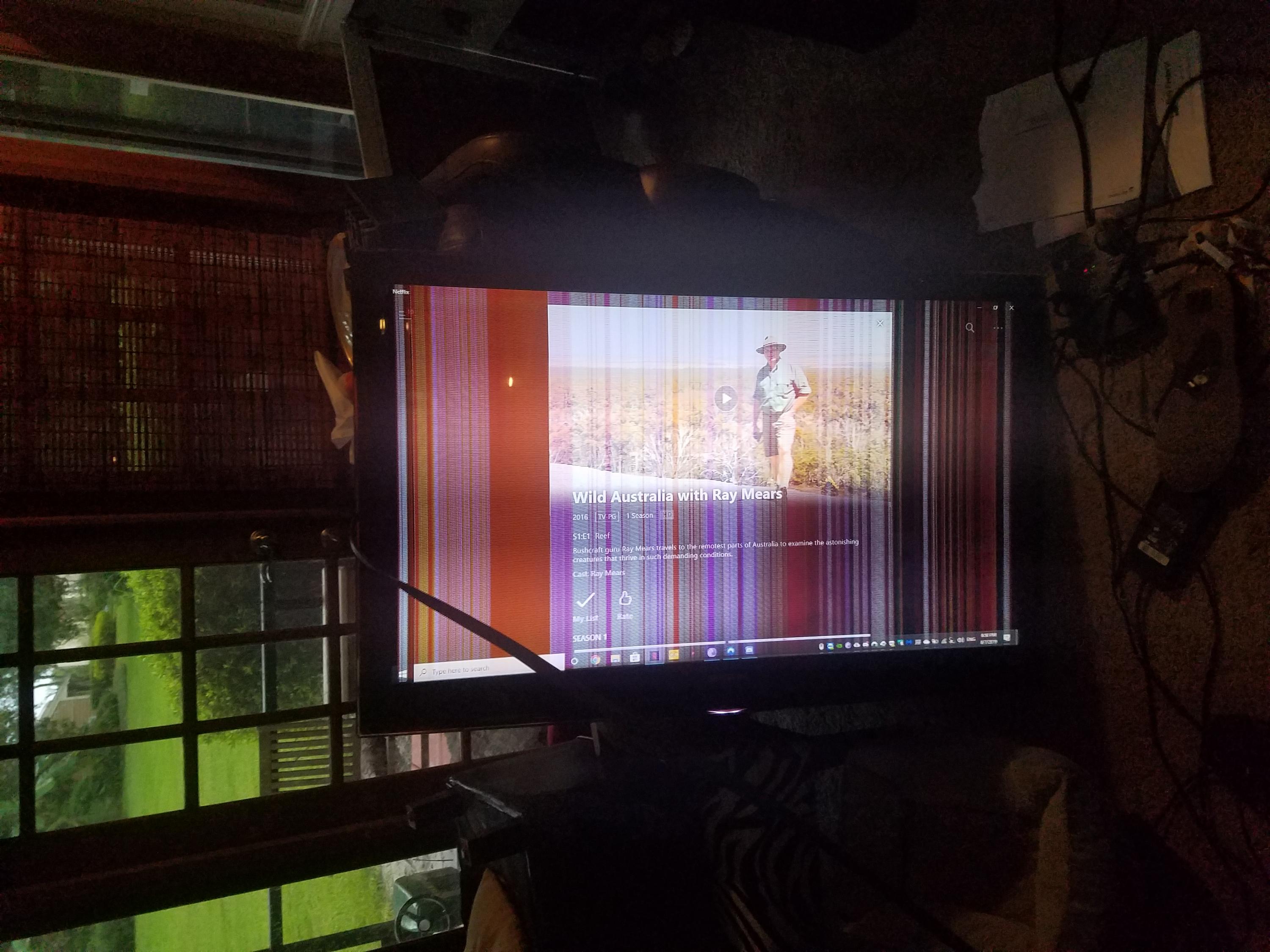

          Original T-con:
          First replacement T-con:
