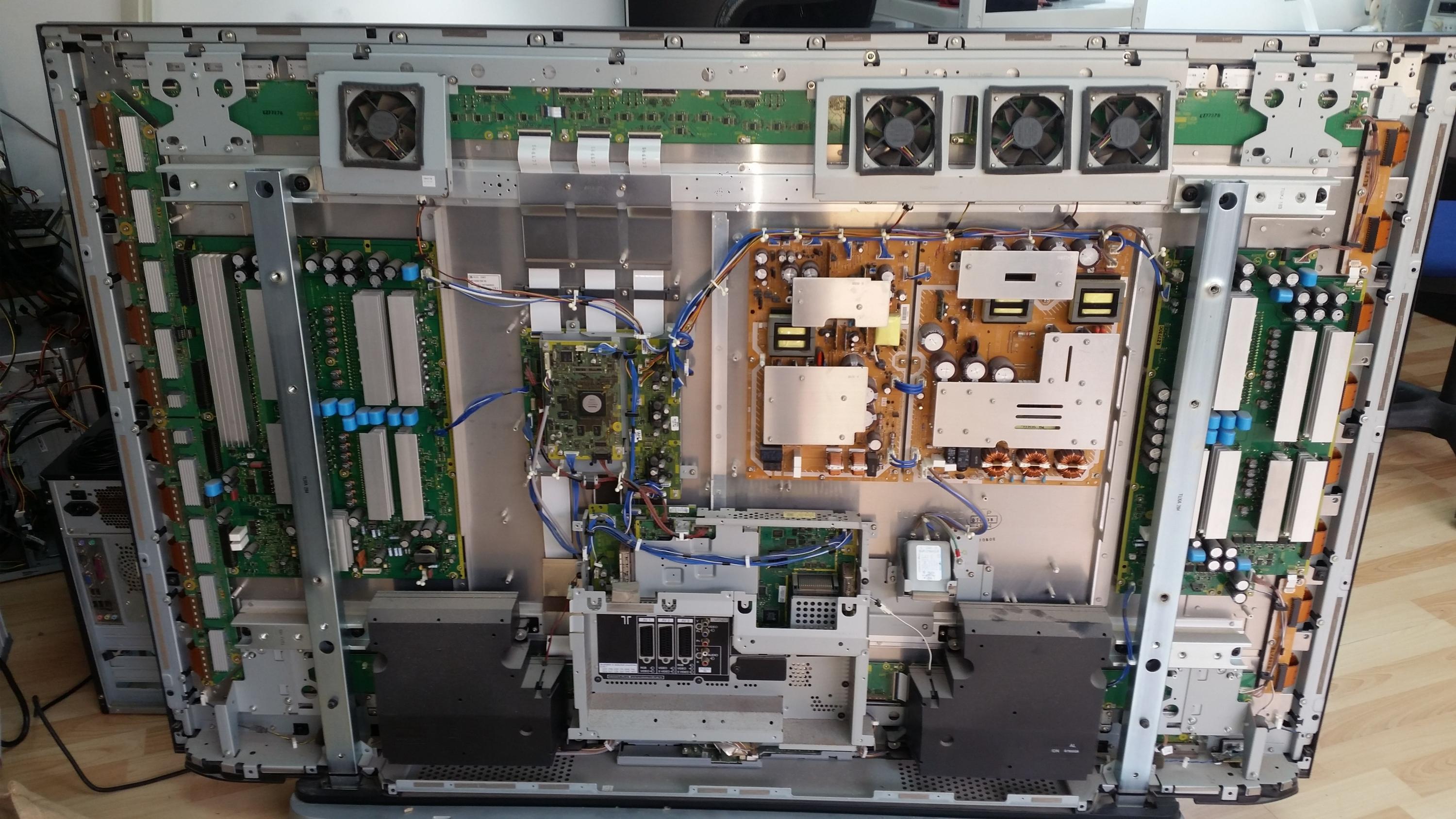

    Hi guys
    I have this beast of a TV in my workshop, it's soooo bloody heavy I can't lift it onto a workbench
    When switched on it runs for about 40 minutes then shuts down with a Red flashing LED on the front
    You can press the power button and it will flash green and power up again for a several seconds or maybe up to a minute, then shut down again.

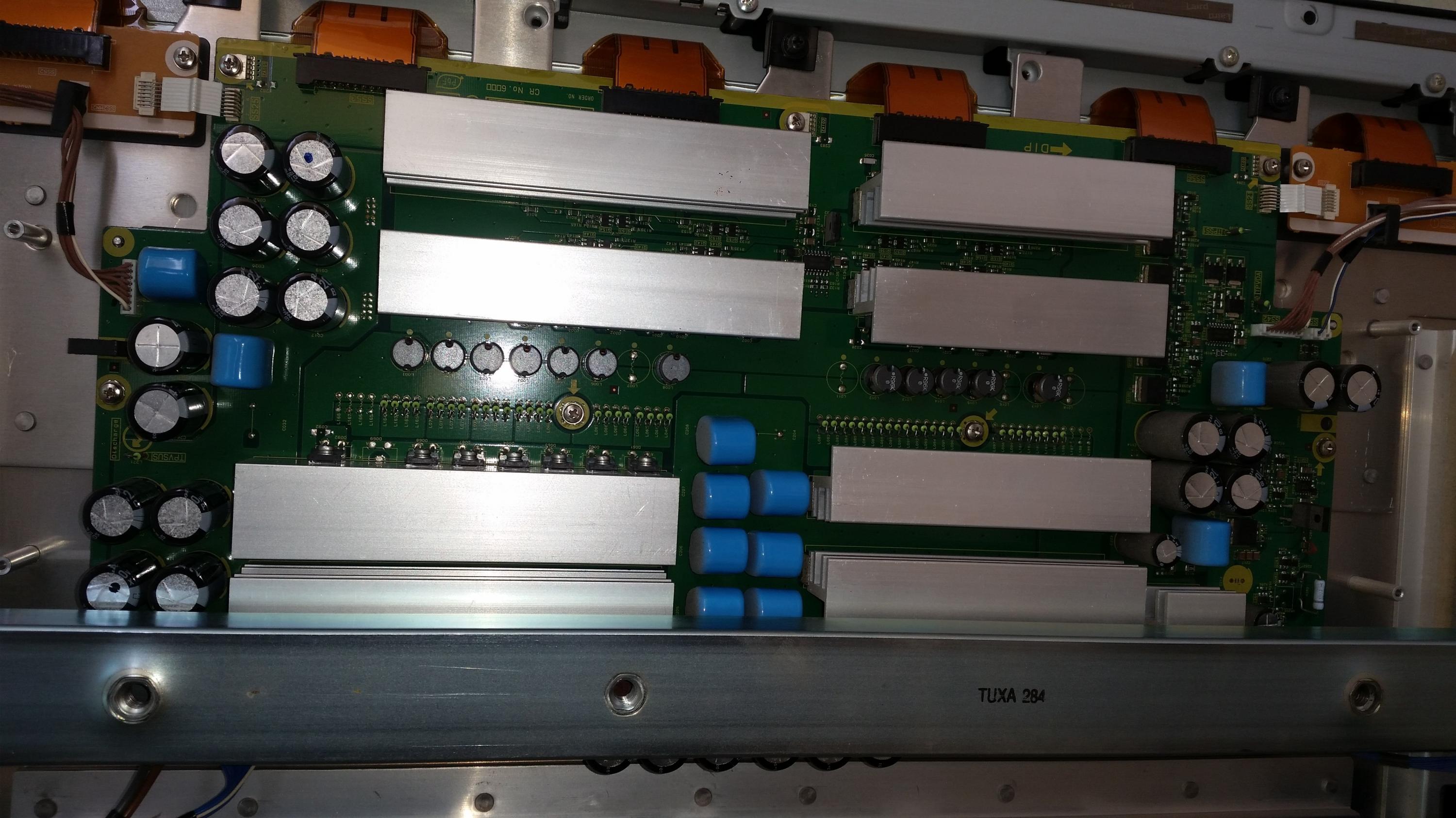

    Cooling down the two PCBs near the centre, which both appear to be PSUs, didn't seem to make any difference.

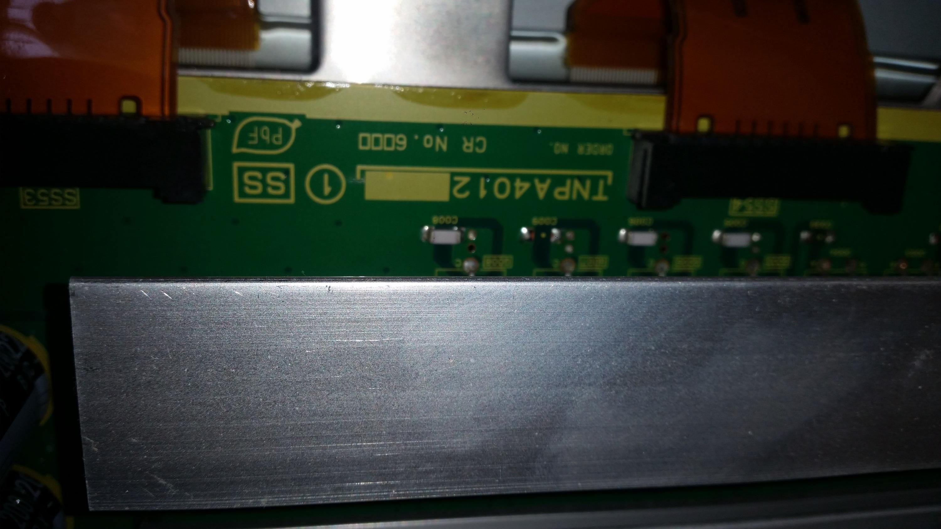

    I cooled down the PCB on the right (looking from the rear) and then the TV ran for 5-6 minutes before it shut down. That PCB is marked TNPA4012, one of the Sustain Boards.
    Assuming I determined the faulty PCB, Are there any common causes of this fault, otherwise i can get a replacement board inc postage for about 50 euros if the customer wants it fixing.
    Pics of the behemoth........

    Re: Panasonic Viera TH-65PZ700E shuts down when warm
    Additional info
    It originally ran for about 40 mins with the back on. This is what the owner reports.
    The four cooling fans are spinning.

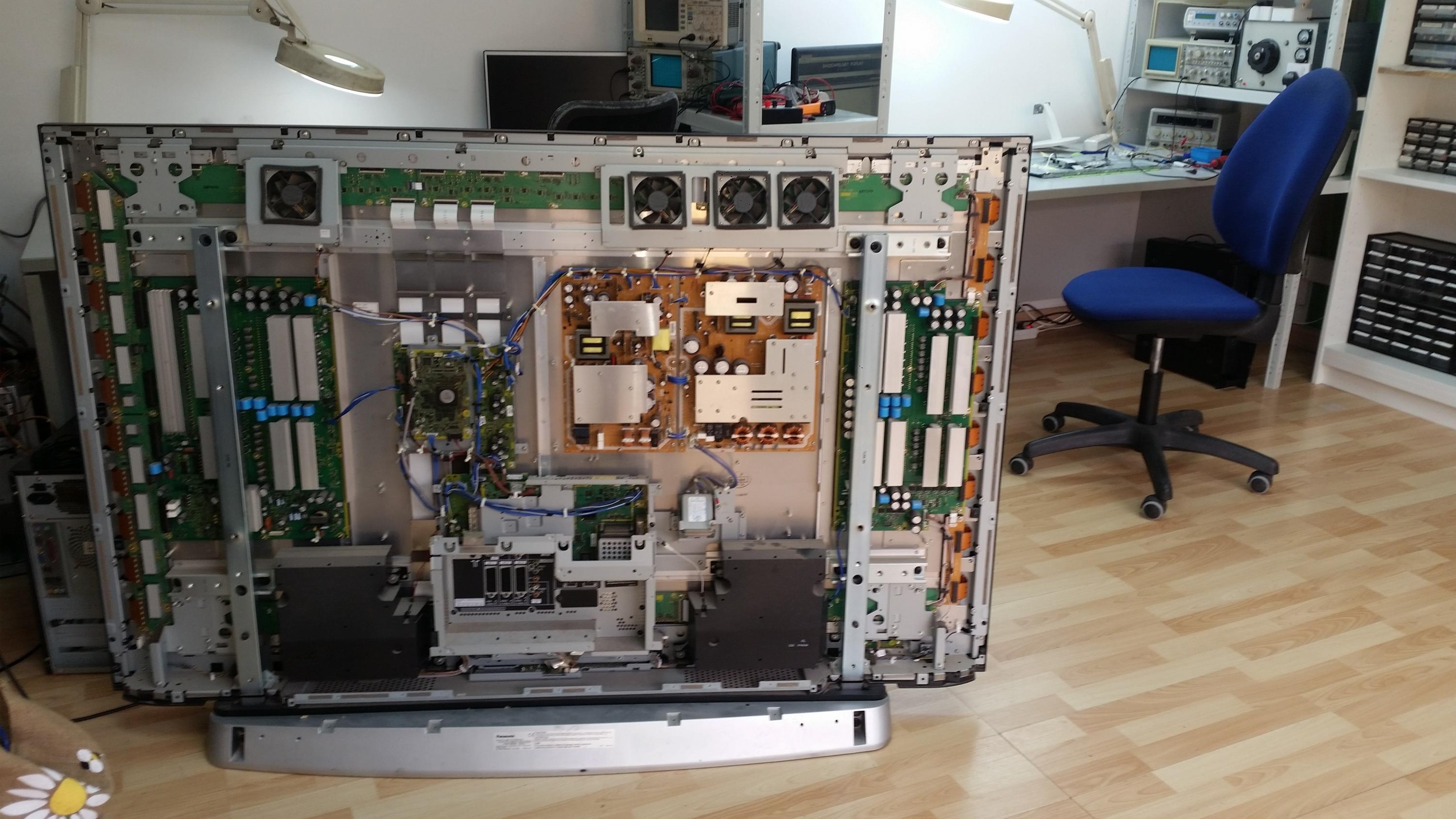

      check all Fans , if one spinning slow it will go to protecting mode. clean them and oil the shift of them.
        Good call - definitely the single left hand fan had a problem.
        I noticed it was lazy when spinning up then it went up to speed so I didn't think any more of it. I cleaned it and it ran for about 20 mins then shut down.
        Now I can see when I power up the TV the other three spin up but that one is just twitching. It's not the bearing, the fan spins freely if you give it a push. I replaced it with a PC fan and it's running now. I'll leave the TV on and see what happens
        Cheers
        Rich
