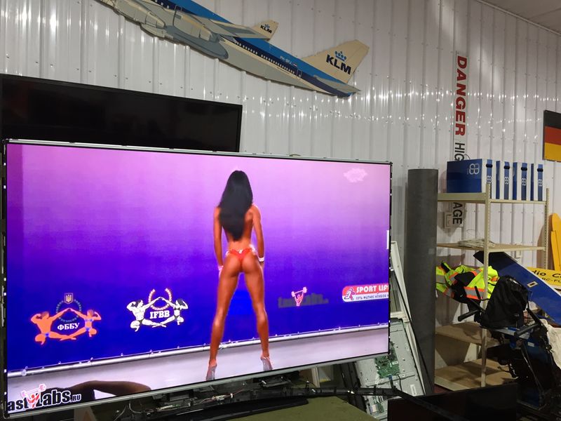

    I got a freebee that a guy wanted gone out back of his pickup today.I thought it was total write off as it was face up in box of truck and it was raining all morning.I dried it out for couple days and now the problem is showing itself.Screen is dark on one side and video like in slow motion.Seems i have to remove tabs on one side or both?

    well you can't remove tabs on BOTH sides unless you just want to watch a blank screen, as you need tabs on at least one side.
    From the pictures, I would say there is some cabling disconnected... have you looked at the back of the set?

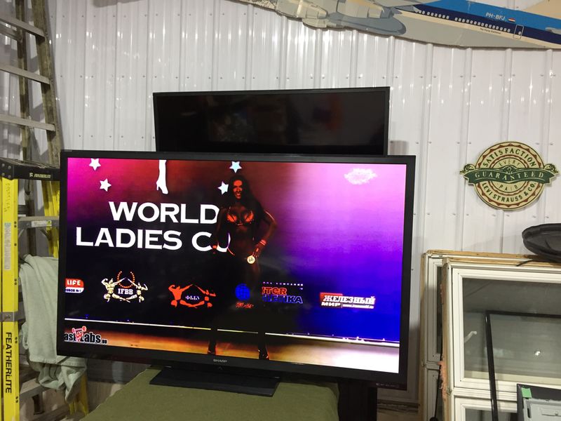

        I had a spare t-con board so i installed it to no avail set would not power up.I reinstalled original t-con and re seated sides and set worked perfect.I came back after running and errand and its distorted again back square 1.

          Went out and powered down set for while and screen came back normal waited awhile and screen started to distort and go dark.I had hunch so i replaced the tcon board again and screen came on this time.gonna run it all night and see what happens.The chips on sides all looked ok and felt cool to touch.

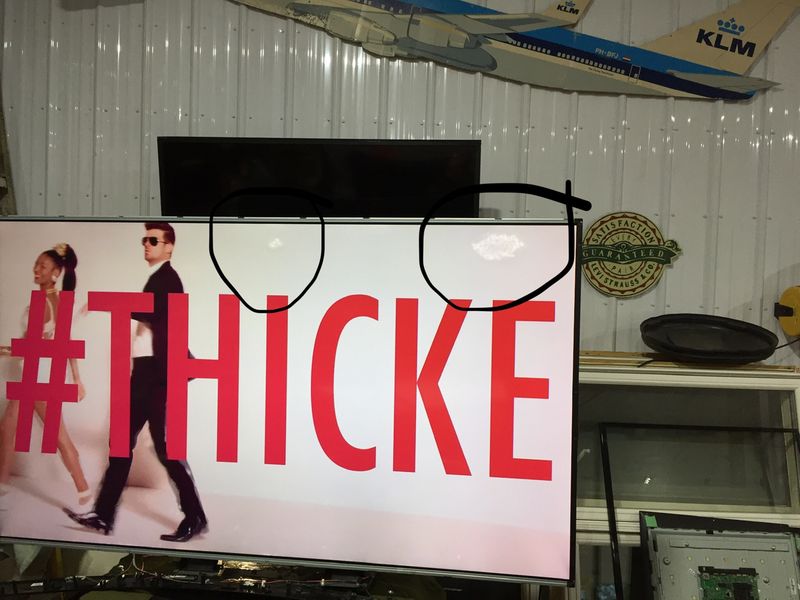

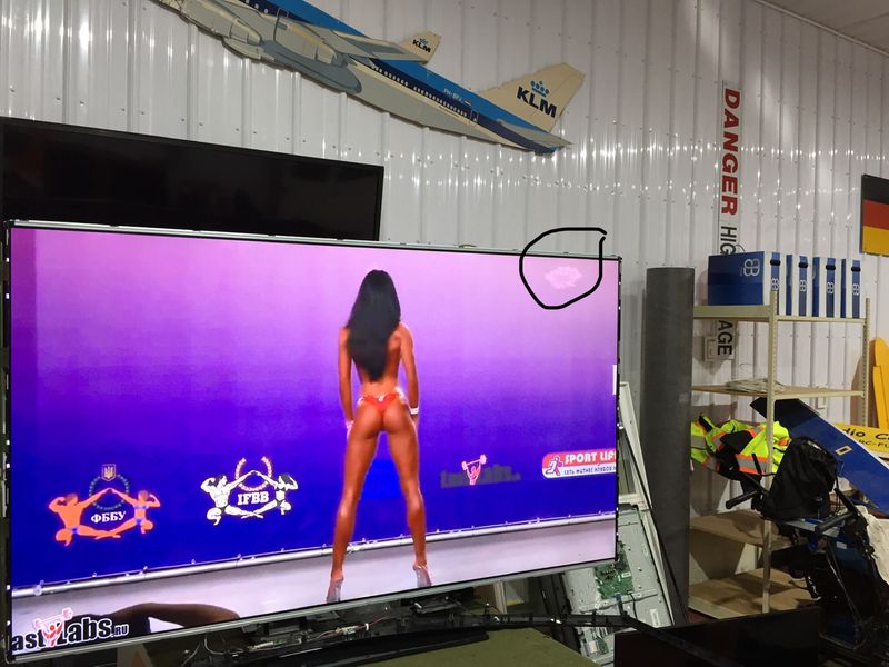

                Thanks charlie for tips.I checked it this morning and unit is running perfectly.The only issue is there is a spot in right top corner and in couple of other places very hard notice in other places.I have suspicion it may be residue left by water as it was left outside in rain.I'm glad i never jumped the gun and cut those side tabs.Looks so far as t-con was issue.

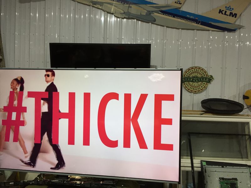

                  Here is another pic of smaller spot but that seemed to have disappeared this morning.

                    Re: Sharp Aquos LC -70LE640U
                    TV under rain for days.. the wet going over all either the sheets behind the LCD. via working it will dry.. but it may left fleck. as this point need to take it screen apart and clean them. other wise i would leave it so for my weakness eyes.
                      Thanks Diah yes one spot has pretty well gone and other seems to be fading.I have let it sit in dry area for another while with set on.

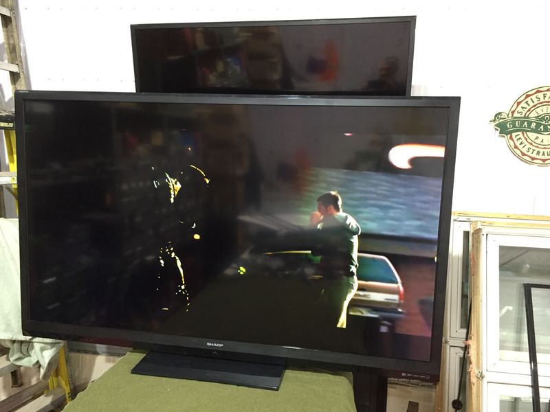

                        Diah the board only lasted a week back to same picture.I guess i will have cut ribbons on one side after all.
                          I wouldn't do any "cutting" just yet. disconnect the small cable in the bottom corner... there is one on each side. Check what the result is on the picture when one is disconnected. If your spots don't go away, it is likely that cutting any side tabs is going to help the situation as the problem is more likely associated with the tabs along the bottom.
                              Yes removed one side got this now. Don't know if I pull the bottom what it will do.
