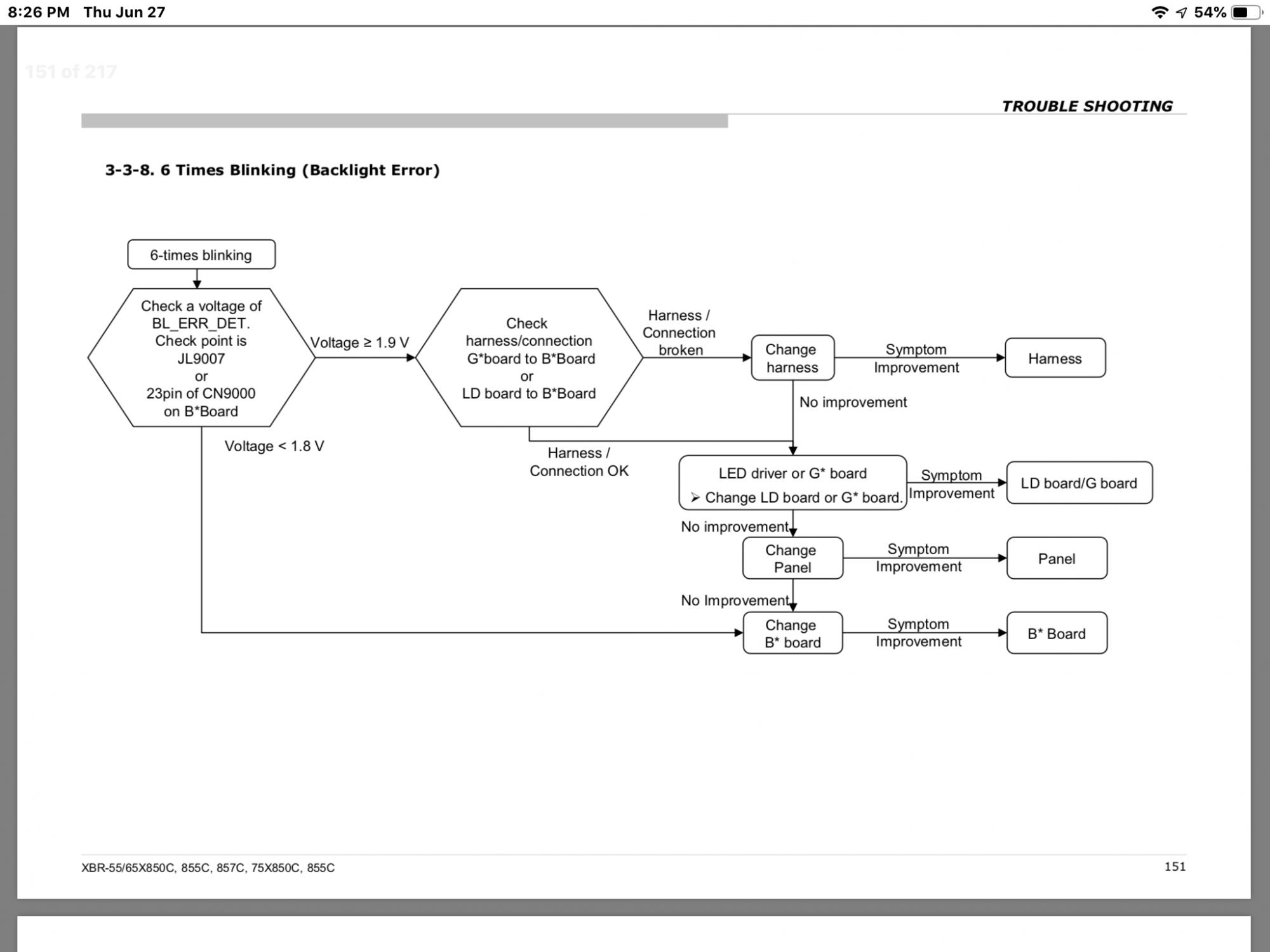

    I am currently trying to repair a Sony Model XBR75X850C.
    The set has the dreaded 6 blinking error lights flashing. The set tries to startup with the screen illuminating but shuts down immediately
    I have replaced the main board but no change.
    So voltages from the G4 board are within range except one anomaly.
    I keep getting a 1.9 voltage reading from pin out location CN 6402 pin 4 BL_ERR. I don’t see where I should be getting any voltage reading from this pin?
    Anyone have any suggestions/recommendations?

    Re: Sony XBR75X850C
    The LED flashing 6 times is a back-light error I believe.

      Re: Sony XBR75X850C
      You are correct on the error code.
      I’m just wondering if I don’t have an issue with the ps board as well.

        Re: Sony XBR75X850C
        It's possible, it could also be the LED driver board.

          Re: Sony XBR75X850C
          I found a flow chart and it points to the LD or the G board.

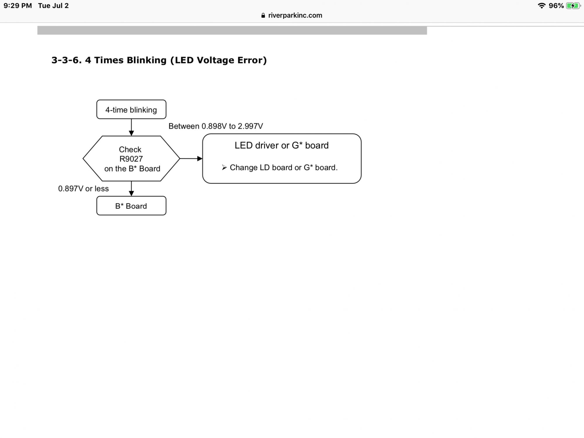

          • tibimakai
            • Jan 2012
            • 3680
            Re: Sony XBR75X850C
            Anybody knows, what is a 4 blink code could be? It is for a 65X900C

              Re: Sony XBR75X850C
              one here, also suggests doing a self diagnostic might clear up some issues.
              Four blinks
              - No vertical Deflection (V STOP), Screen goes to a single horizontal line then the video signal muted. Check IC1509, Q1505

                      4 red blinking error maybe LED driver or G board

                            Re: Sony XBR75X850C
                            The six flash error code is a backlight issue. Most probably, it is a dead LED. I have the 65" version of this TV and all it took was a $0.05 LED to fix. But you really "earn" the fix, because you have to dig all the way to the heart of the set to fix it.

                              Re: Sony XBR75X850C
                              You are exactly right.
                              It's a big job for such a small item to repair
