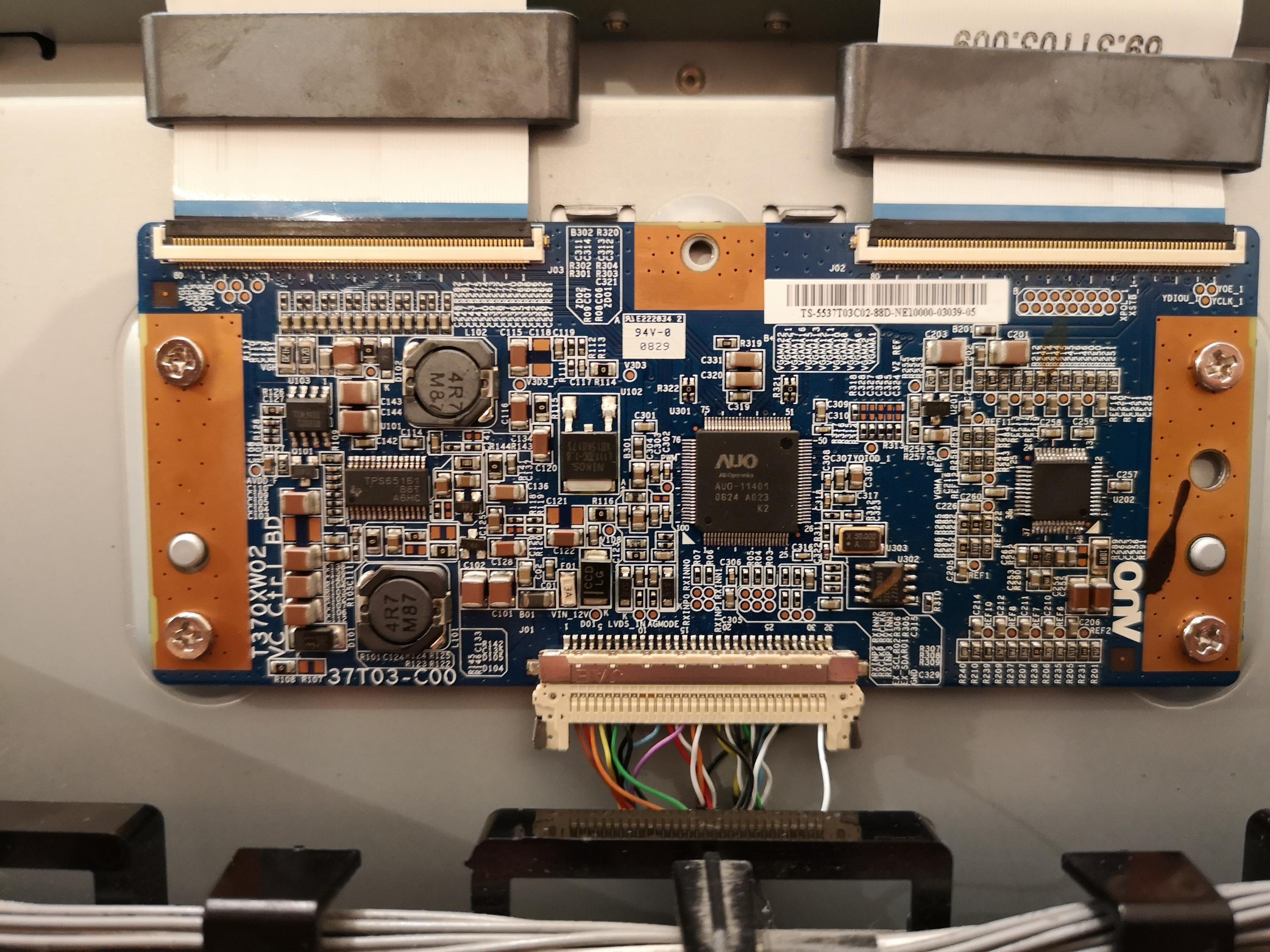

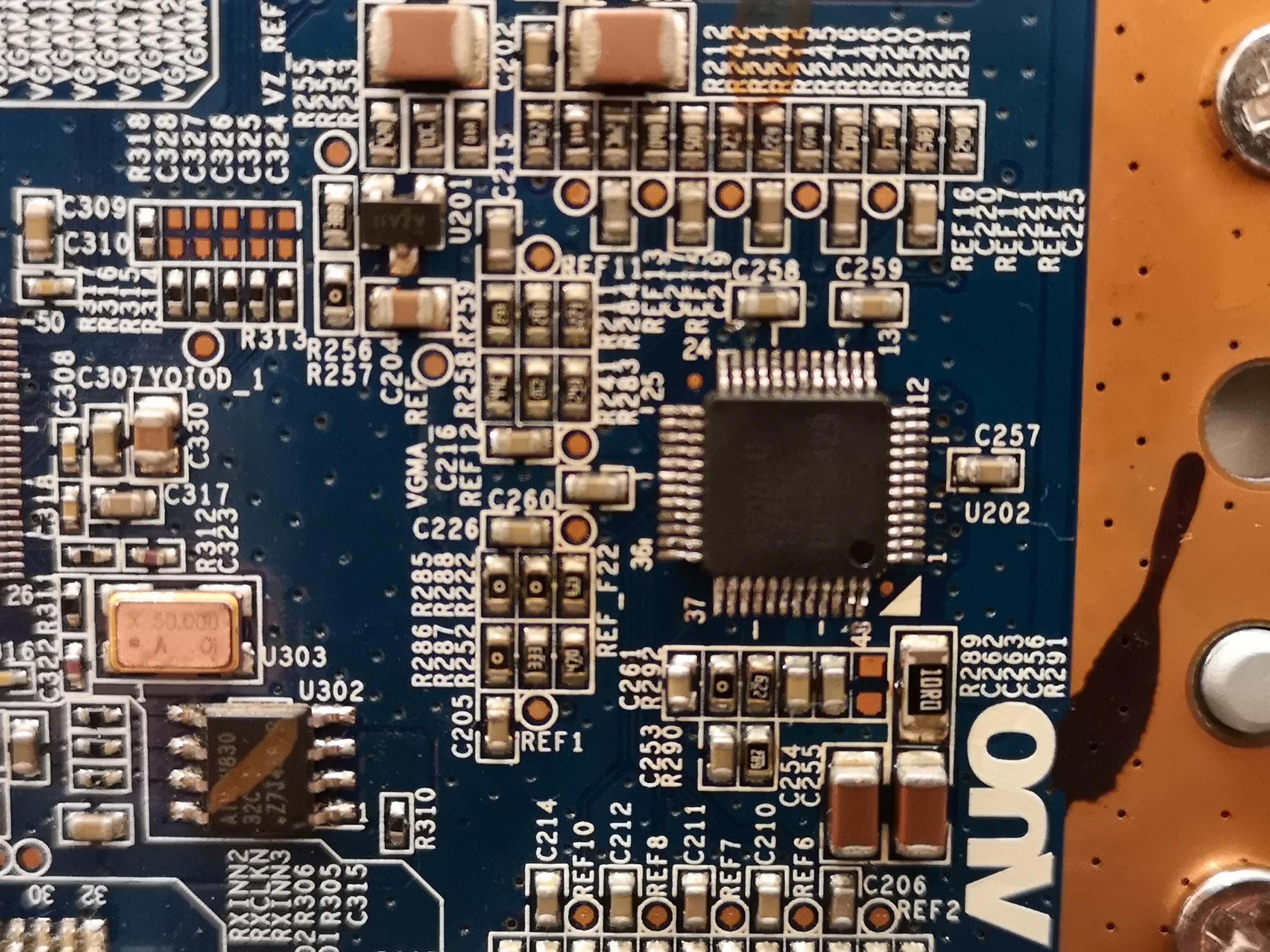

    So, after research I ordered replacement IC AS15-U and proceed to replace the chip in the TCON board.
    I measured the gamma outputs on the original chip (which should be ascending or descending if good) and they were all over the place, so I was pretty confident it was a faulty IC, AS15-U.
    Having swapped the IC (I didn't add extra solder to legs on the new one) and remeasured the Gamma outputs they were smooth ascending., I turned on the 37" to a perfect picture!!! Hooray.
    But then where I had tightened up the screws (I normally work on motor bikes.) and flexed the TCON board, the chip litterally popped off. (Obviously wasn't on there great.)
    In my efforts to reattach the chip I damaged the TCON board - solder pad...
    So, I gave it go - success with ultimate failure.
    Not the end of the world.
    At least I knew that a new TCON board would definitely fix the TV... Thats a win.

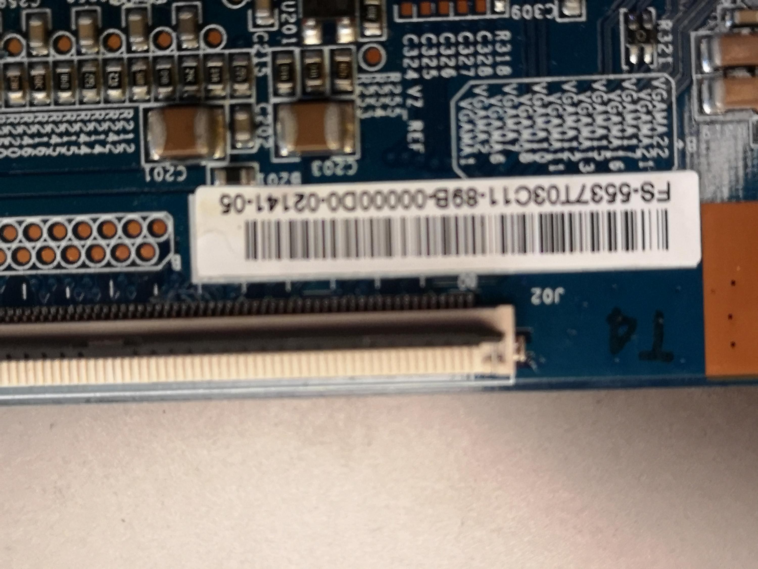

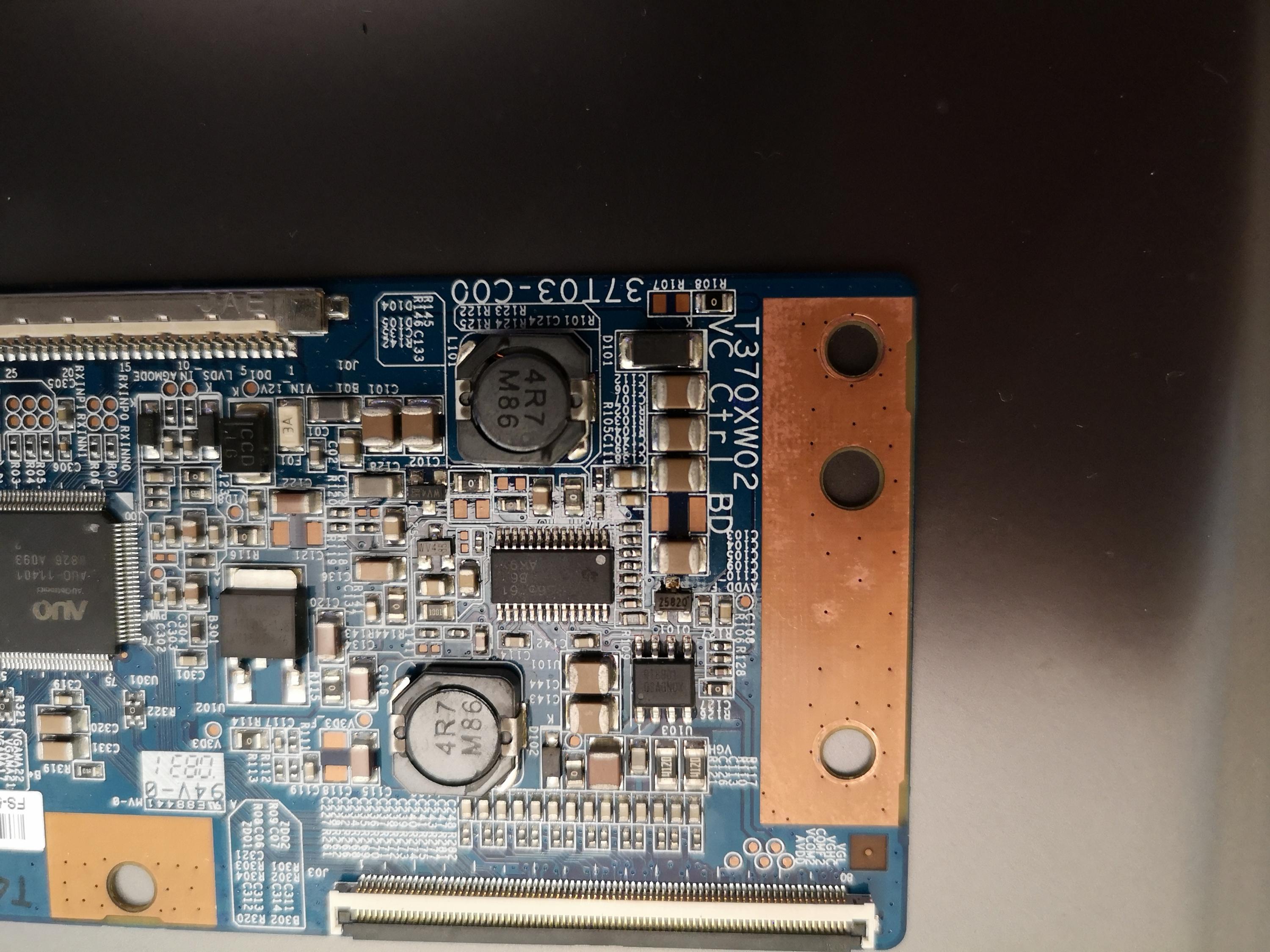

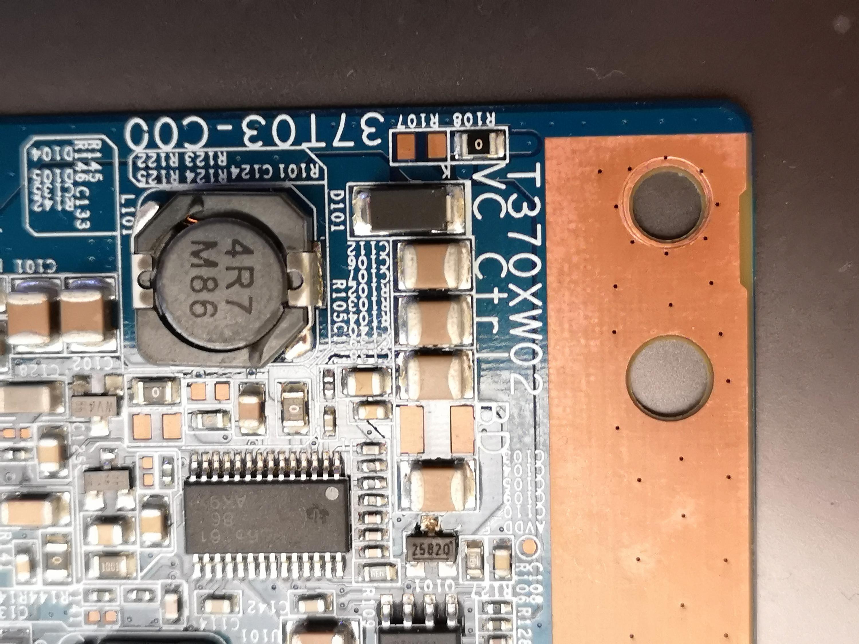

    The original board no is T370XW02 37T03-C00. Sticker says FS-5537T03C11.
    I checked with some guys in china, who sell new, and they assured me that the FS.....C11 sticker was not important, and that their new board would be compatible.

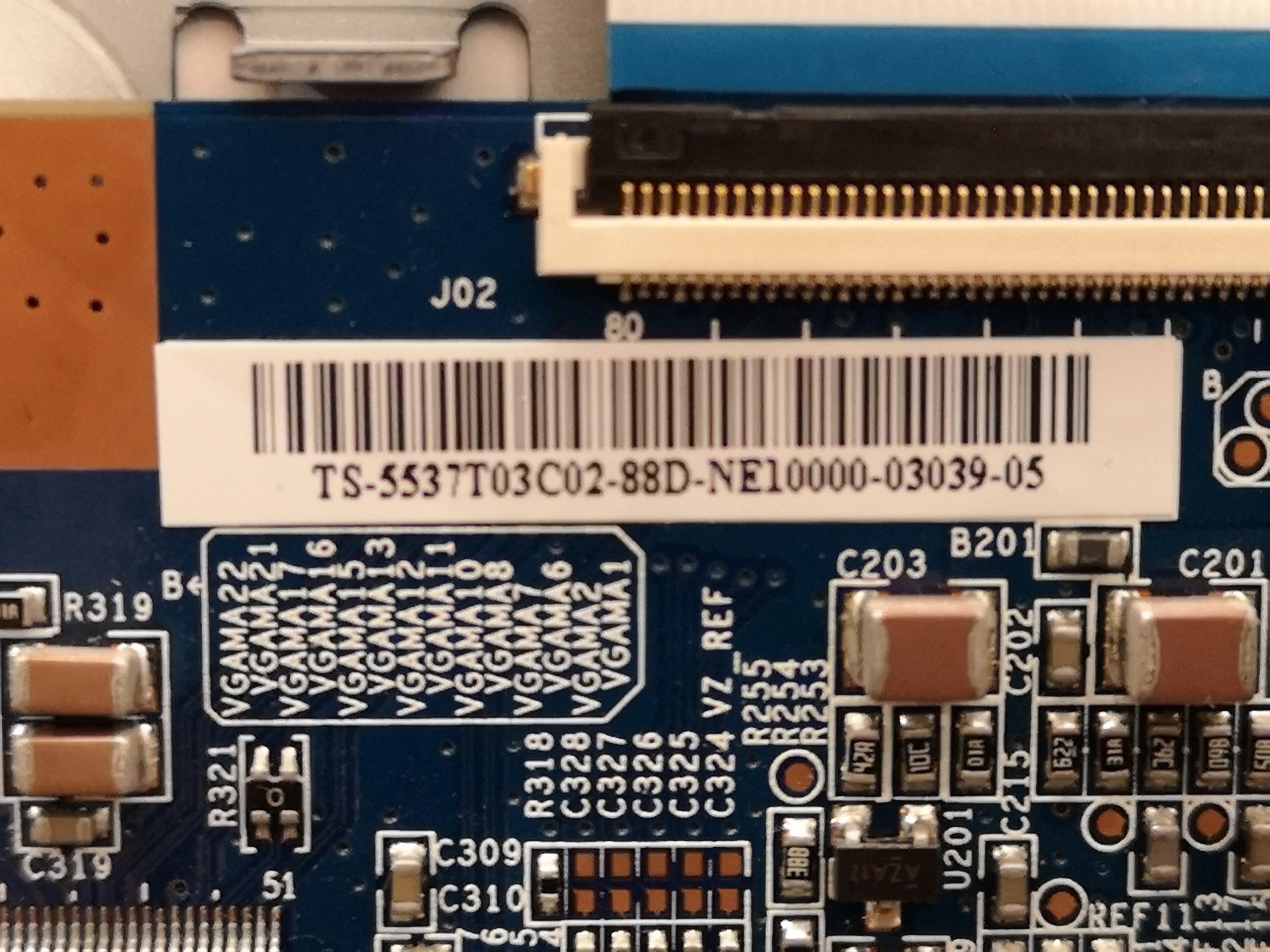

    So, I bought a second hand board in the UK, because it's quicker. The board no is same T370XW02 37T03-C00, but sticker says TS-5537T03C02.
    Now, I know this replacement board he sent me was faulty. Because when I got it, I installed it and measured the gamma voltages....and as already mentioned they have to be ascending or descending.
    These were f*cked. All over the place. Same as my original TCON before I replaced the AS15-U IC.
    So...
    I still had a brand new AS15-U IC. If I swapped this faulty one on purchased card, maybe that would do the job.
    I did it much better this time, with successful replacement.
    I measured the gamma readings with the replaced IC in situ, and they were all gradually ascending...good job.
    However, the picture is still faulty to some degree...
    Bear in mind, when I did the replacement originally on the original board, the picture was good. - Before the chip made a break for it!
    So.
    Either, the Chinese are wrong, and the FS / Cxx designation/revision number is important. Or the geezer who supplied this TCON replacement, has sold me a faulty card (which I know is the case because of the intial gamma readings) and there is more wrong with it than just the AS15-U IC.

    T370XW02 37T03-C00 is the blank PCB P/N which can be stuffed to make many PCBA for various LCD panels as needed.
    The PCBA P/N printed on the bar code sticker is the one you want to match.
    'If you look at shojimmy web site, you will see that they are not listed as substitute with each other.
    SONY may hace change the panel during the production run so same TV may not have the same exact LCD panel.
    I always match the PCBA number and I also use shopjimmy web site for verifiaction to see if there are any sub available or not.
    FS AUO 55.37T03.C11: https://www.shopjimmy.com/auo-55-37t...-con-board.htm
    TS AUO 55.37T03.C02: https://www.shopjimmy.com/auo-55-37t...-con-board.htm

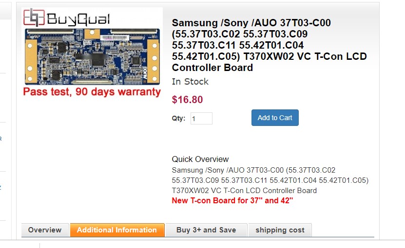

      These guys reckon their board will work....
      https://www.buyqual.com/samsung-sony...ler-board.html
