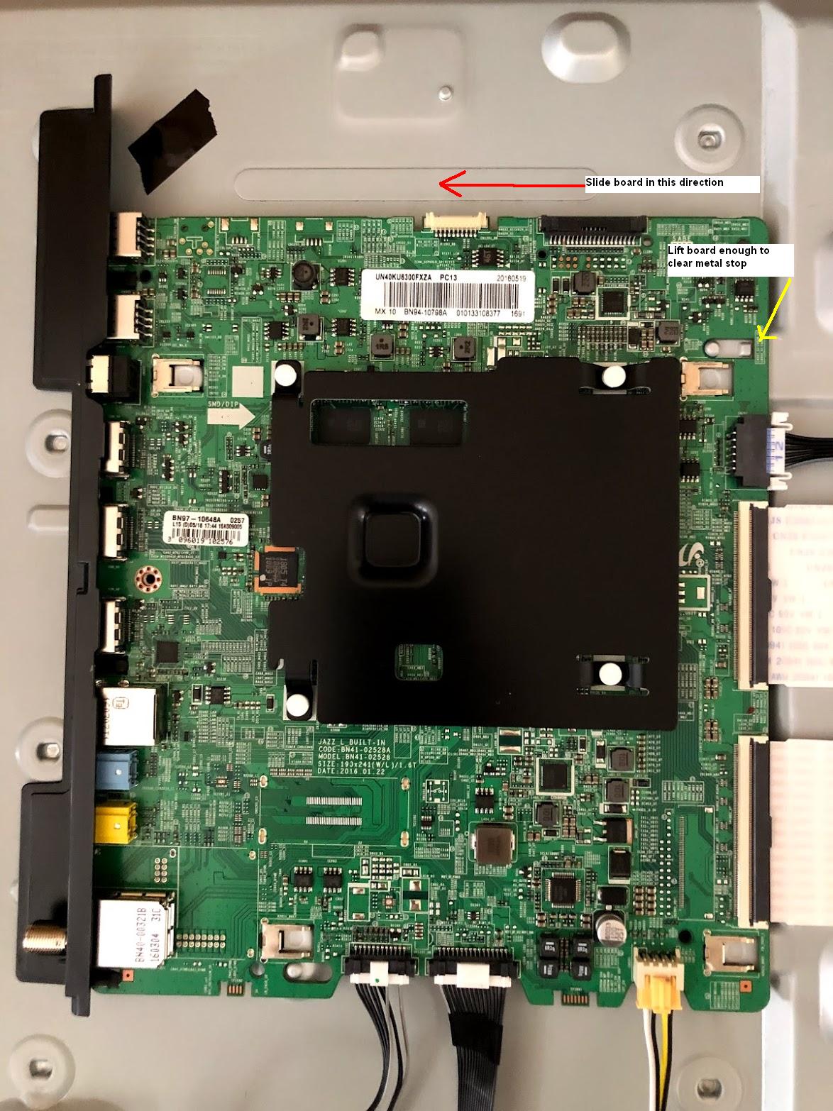

Samsung UN40KU6300FXZA ver FA01 main board replacement
  • k9rulz
    • Jun 2019
    • 4

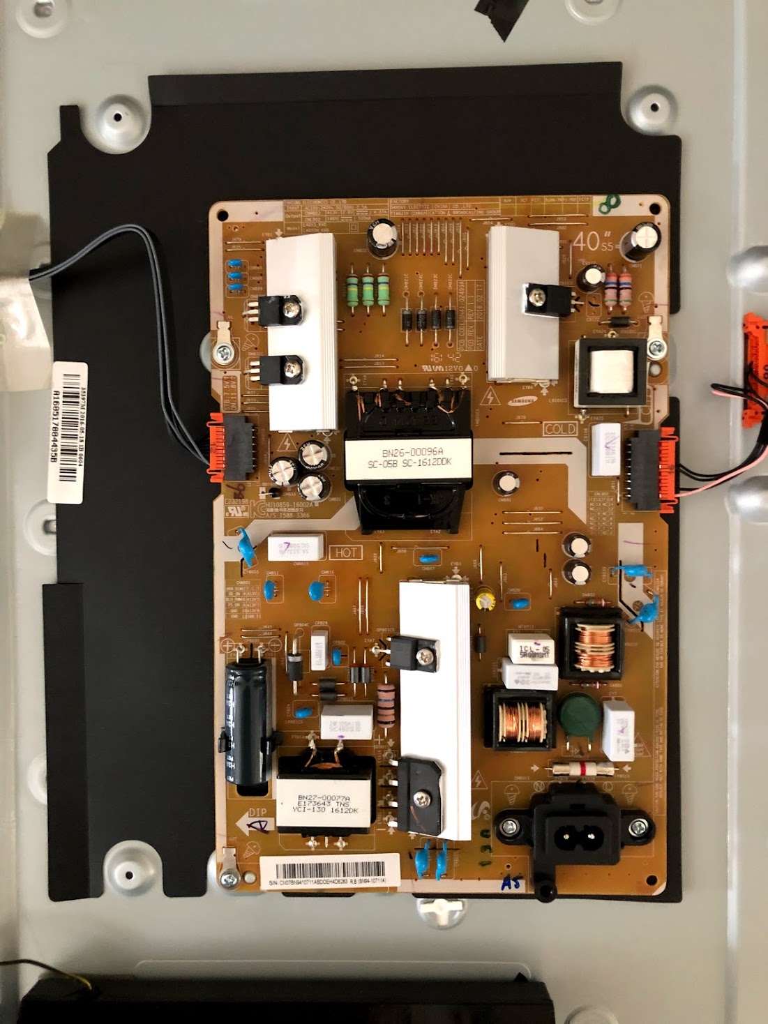

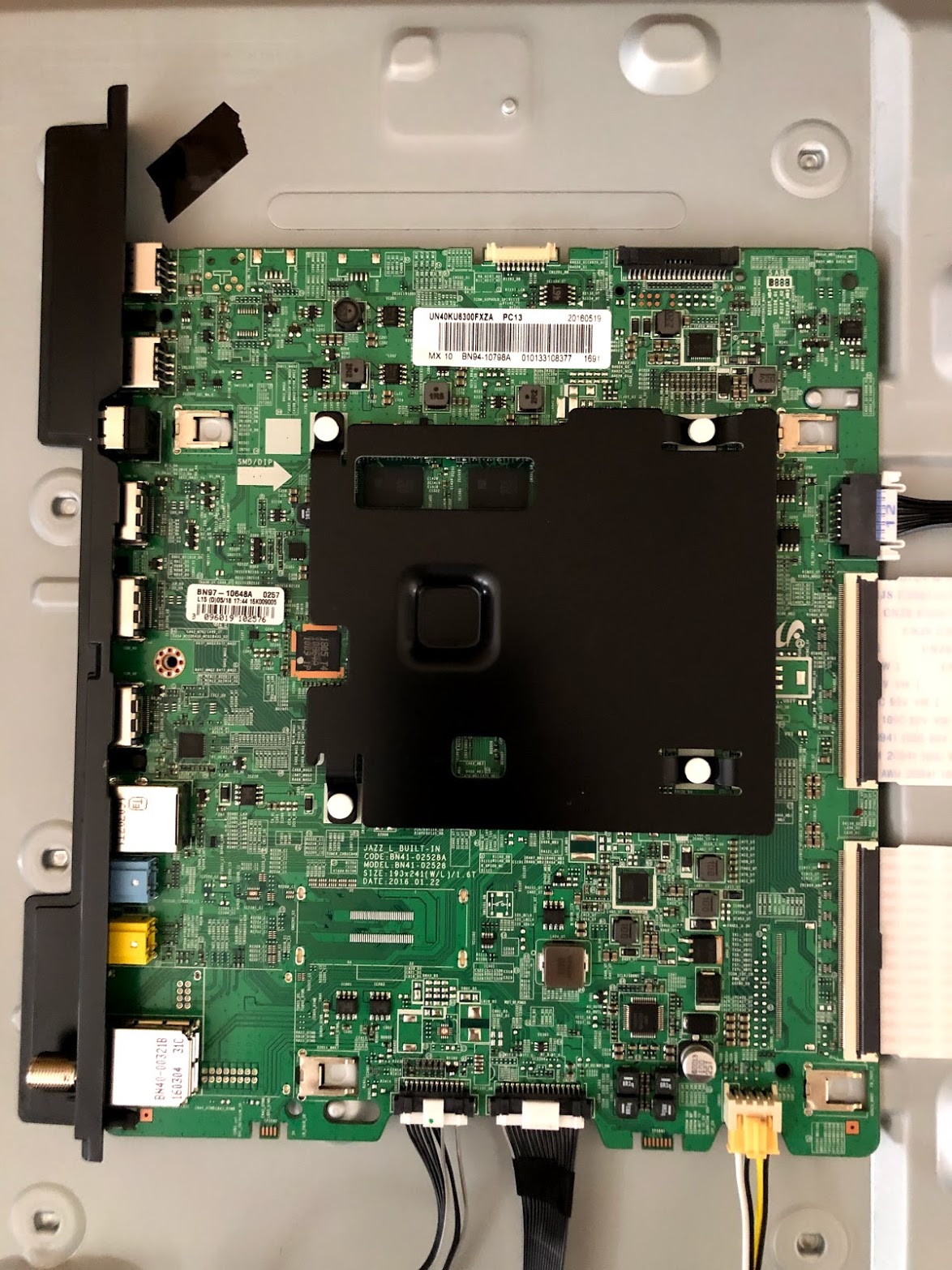

    I'm looking to replace the main board on this TV. I've ordered the parts. However, when I look at the main board there are no screws for removing it, unlike other TVs (or on the power board). It looks like there are tabs? where the screws should be? do they just need to be pushed in to unlock it from the frame?
    any thoughts would help! thanks!
    sorry! pics now attached

      Re: Samsung UN40KU6300FXZA ver FA01 main board replacement
      attached pics. thanks!
        If you lift the board slightly to clear the metal stop, the board should slide to be removed. The silver metal clips remain with the board.
          thanks! i just didnt want to force anything and break off something I'd need for the new board.
