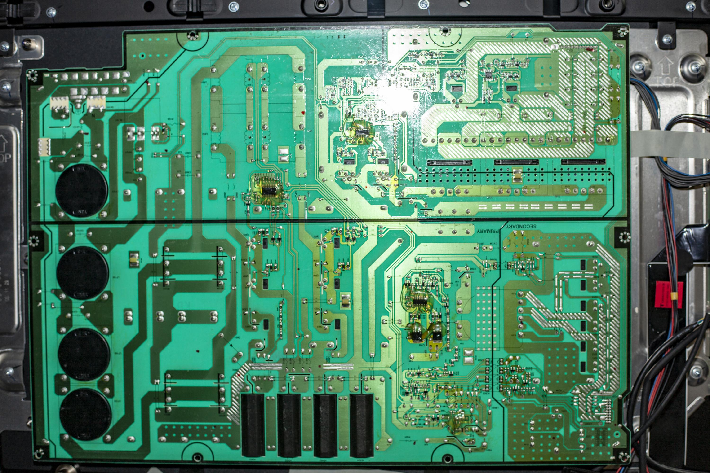

    Hi folks, I am having a problem with a LG 55EC930V. I've checked the power supply, and it only delivers 3,5V. When i bridge the PWR_ON with 3.5V, i ain't got any power at the 12V ans 24V outputs. When i bridged the DRV_ON to start the 24V panel output, i also get no voltage. The power supply is the EAY63348801 B12D198801, but i have no idea where to start fixing the power supply.
    Re: LG 55EC930V power supply problem
    1) So when you bridge (force on) the connection, did you disconnect the cable between the power supply board and the main board first?
    2) We need pictures of the whole backside of the TV showing all the boards, and pictures of the the whole board of the power supply board.

      Pictures will be uploaded soon...

                Pictures are following...
                • Teletoby
                  • Jun 2019
                  • 24
                  Here are the pictures. In the zip file are the HiRes pictures.
                    check C564 , replace it with same or good esr type

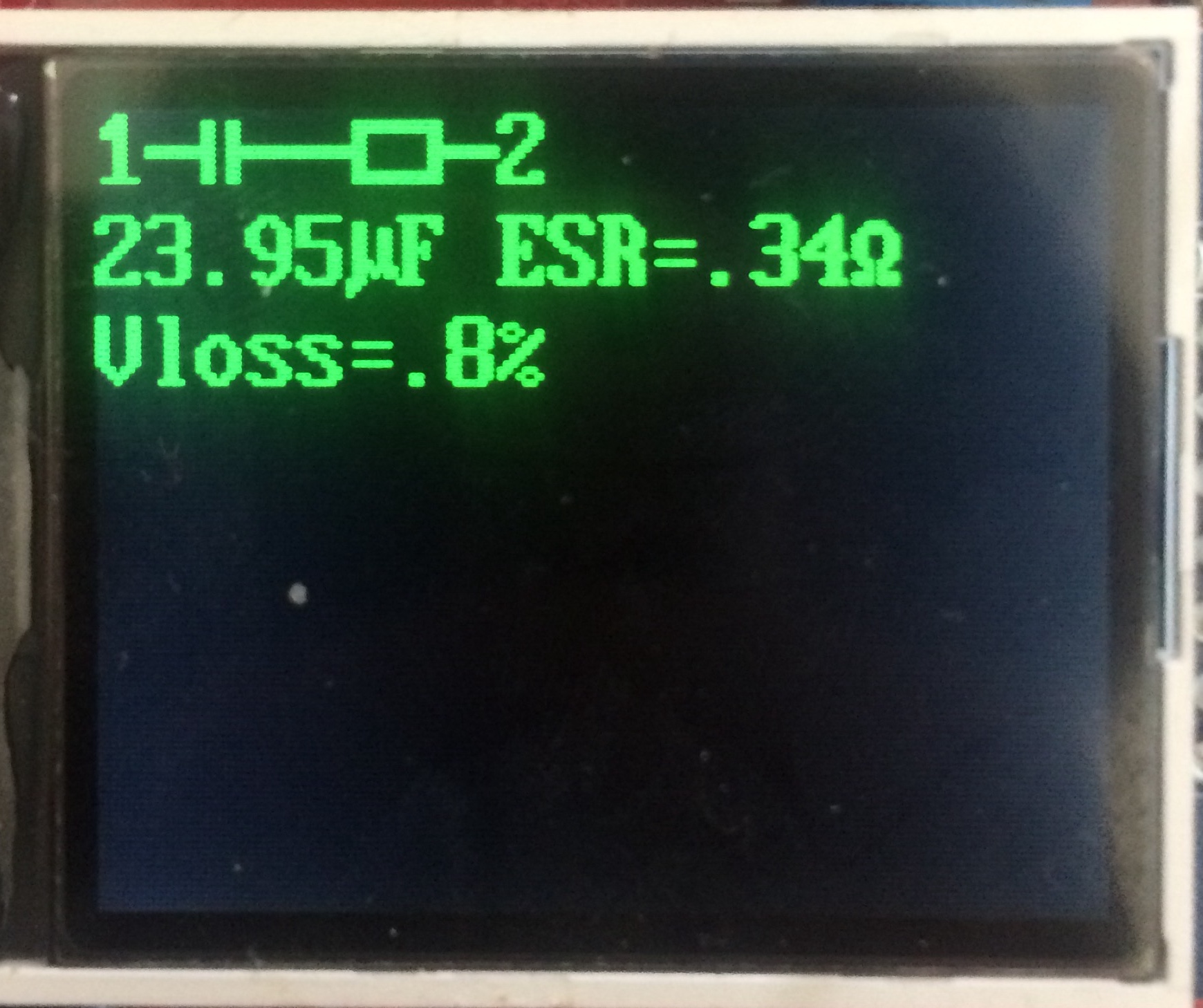

                                • Teletoby
                                  • Jun 2019
                                  • 24
                                  Originally posted by Diah
                                  sorry C504 not 564
                                  This is the Value of the C504 it seems to be ok!
                                  • Diah
                                    • Feb 2013
                                    • 6563
                                    did you check it out of board?
                                    • Teletoby
                                      • Jun 2019
                                      • 24
                                      Of course
                                      • Diah
                                        • Feb 2013
                                        • 6563
                                        take new one and compare the Vlose % & ESR... replace it. if the PWB still no 12 24V replace the PWB. the issue at same section with some SMT component. such Q , the problem we cant find replacement parts.
