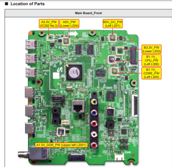

            I do think the Tcon is probably faulty as well as one of the blue LEDs does not turn on when tested outside the circuit/tcon board. There are 3 blue LEDs, 2 are fine.
            However, my Tcon board is not getting power from the MB at all and that is where my focus is. The Tcon board is suppose to get 13Vdc from the MB on LVDS pins 47...51, either LVDS connected or not, no 13V. Thanks

                    Re: Samsung UN48H6350AF Black Screen w/ sound
                    Originally posted by diif
                    Yes, that does look suspect, it's where I would focus my attention. Can you take a photo of that area ?
                    Actually your readings are all correct which means your MB voltages are correct and most likely your MB is ok.
                    The service manual shared in #15 is wrong on L204 & L2001 readings. They are reversed. L204 should be 1.5V and L2001 is 5V. I verified these readings from a working MB which I fixed in my TV, same model number and same MB. For reference, I am attaching the MB voltage test points.
                    • mlemon
                      • Feb 2021
                      • 34
                      #50
                      Added MB voltages
