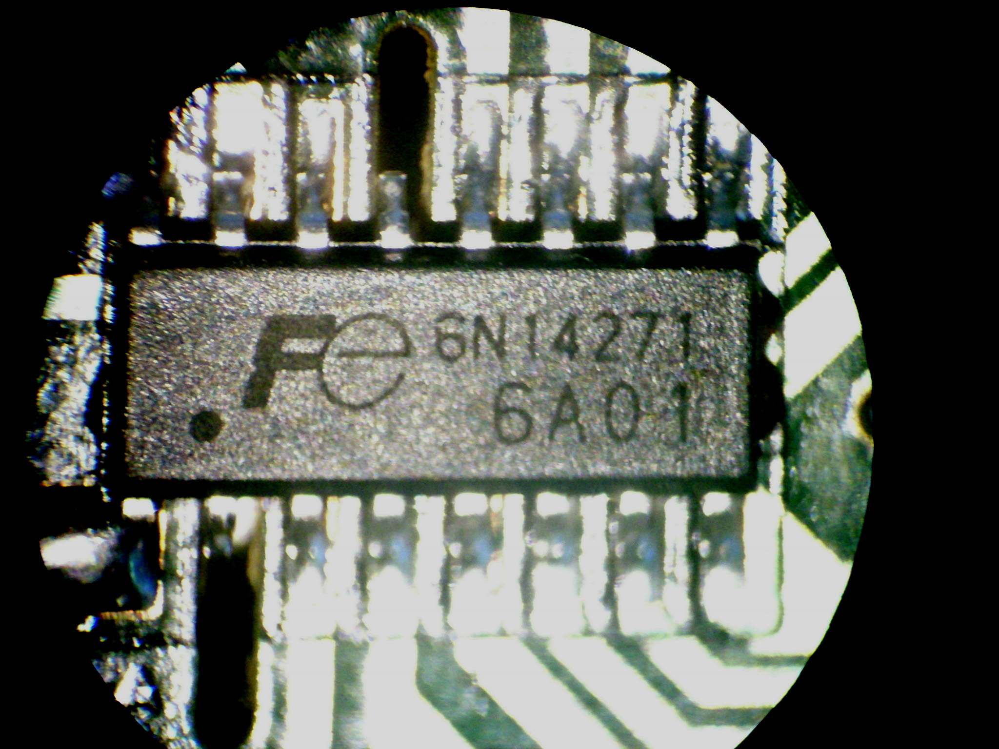

    I have a Samsung 60" with a bad power supply (there is no boost). The power supply part number is BA44-00716A.. The diodes and the MOSFETS all check out good. The PFC IC (SPC7011) is not getting any VCC (S/B ~12V). There is another IC that is in the circuit that I can find no information about. Here is a picture of the device.
    I'm not sure which number is the part number and which one is the date code and the FUJI ELECTRIC site has nothing on either.
    Can anyone identify this part?
    Does anyone have a datasheet?
    Does anyone have a schematic for the PS?
    All help will be appreciated.

    Re: Samsung UN60H7150AF Power Supply
    I wonder if it's a FA1A60N/Fa6B20N ?
      It is Fuji Current Resonant Control IC.
      FA6A01
      Datasheet:
      http://www.datasheetcafe.com/fa6a01n-datasheet-pdf/

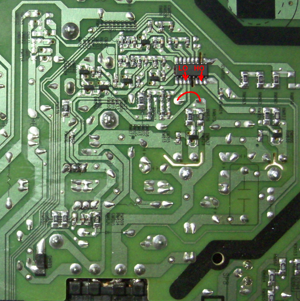

          There is nothing on the output connector. It appears that the Low Side driver is dead on the 6A01. The High Output (HO) is active, the Low Output (LO) is dead - see pic.
          Does anyone have one of these for sale?
          If I can get one quick, I can get this TV back in service. Otherwise, I'll have to take a gamble and order from China (I can't find any US distributors).
            So right now you do not even have STBY 8V (13V when PS-ON is present) at all on jumper JP911?
            Since the board has pulled up resistors for self-test, what happen if you disconnect the main board from power board?
              There is nothing on connector JP911. Because the LOW SIDE driver is dead, nothing is getting through the xformer. Therefore, the whole secondary is dead.
