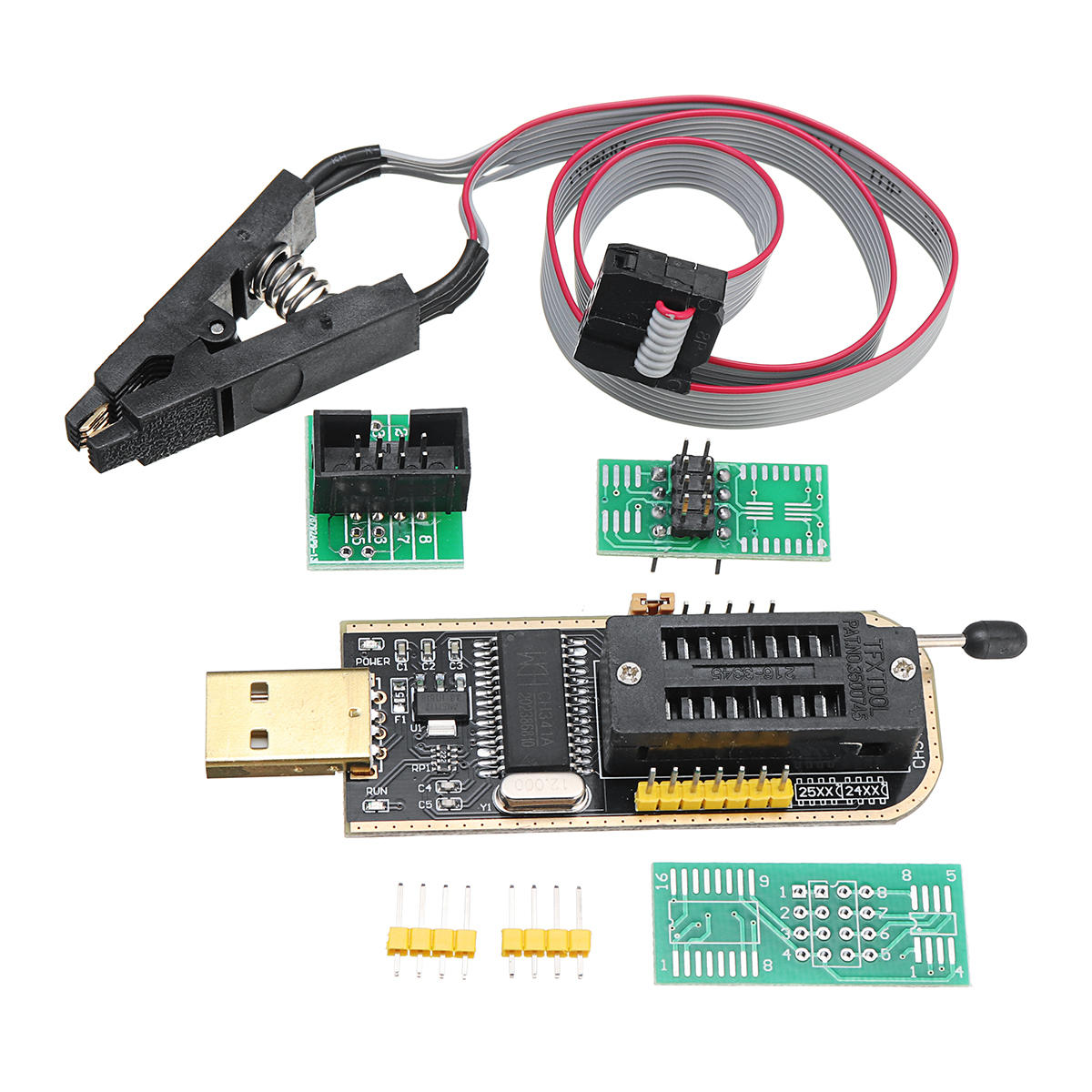

            CH341A is all you need. But the motherboard and panel code is required to look for the right software.

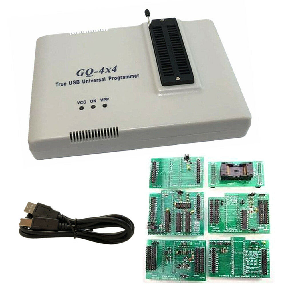

                      I'm using a GQ-4x4 like this one:
                      https://www.ebay.ca/itm/PRG-1117-GQ-...MAAOSwi6dcIWzN
                      It doesn't show it in the pic but there is an external power supply so that the USB power isn't relied on. The trouble with USB power is that it varies from computer to computer, motherboard to motherboard and sometimes the front ports have different rated regulators than the rear ports. It's a real crapshoot as to how much power the port is able to supply.
                      My problem isn't that I can't read the IC, I can and it has readable data, I can see the message texts and text from the menus in the editor page of the programmer software. The problem is that when I ask the programmer to "verify" by re-reading the EEPROM and comparing to the buffer it always fails. Maybe I'll try freeze spray on the board first and then if that doesn't work I'll remove and try freeze spray with the IC in the SOIC adapater. I'd just feel a lot better if I had a "verified" file of the EEPROM.
