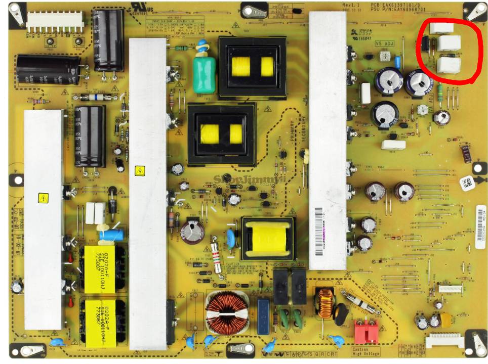

                If this is your power supply, check these 3 fuseable resistors. Should read dead short on continuity setting and around 10 ohms each.(send pictures).
                • tvtimmy
                  • Mar 2015
                  • 1160
                  • usa
                  Re: Zenith Z50PJ240 Not turning on
                  Here is a Shoppjimmy pic.

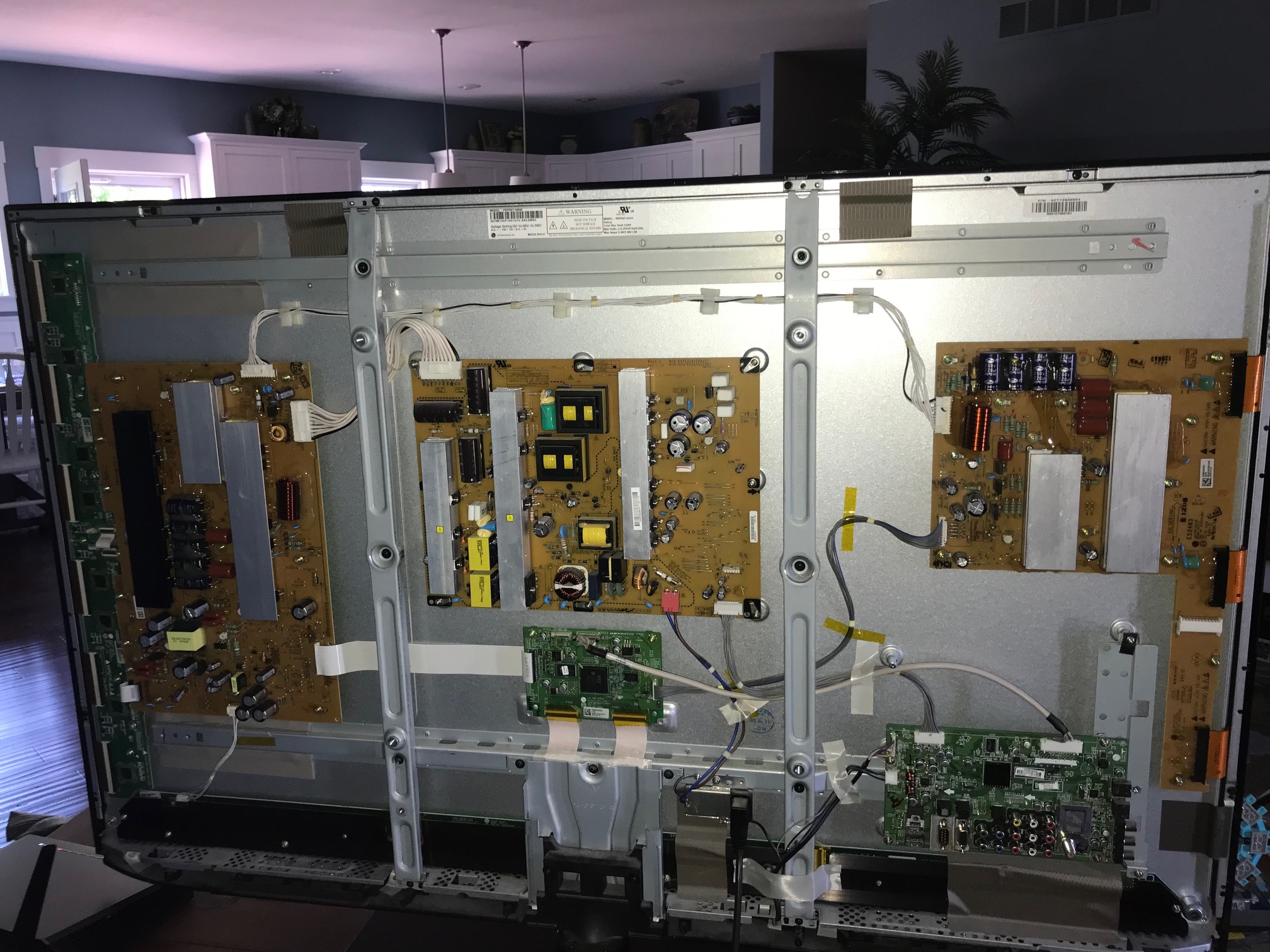

                    Sorry for the delay responding but I have been out of town. Here is what I have done so far. I open the training manual that was provided above and followed the SMPB troubleshooting section. I have the 2 100W bulbs attached and they will power up momentarily twice when the AC cord is plugged in. I have verified voltage at SC101 at 123V. I have followed the steps for P301 with the jumper to ground and the two 100Ohm resistors. I am having a hard time checking voltage on P801 with the board in the tv. tvjimmy, I will check the fusible resistors and report back. Any other help or direction is appreciated.
                    • iaff284
                      • May 2014
                      • 29
                      Here is a pic of the boards

                        tvtimmy, I checked the fusible resistors and the top one is reading around 200Ohms resistance and OL on continuity. I am going to replace it and report back. Anything else that I should check while I am at it?

                          I found a resistor through Mouser but I am not sure it is the right one. The part number is 603-SQM500JB-10R can anyone confirm this is the right one?

                              Ok, I replaced the resistor and powered everything back up and the it turned on and stayed on!! The image was real light and a little pixely. I plugged in an hdmi cable and there was a pop and a tiny puff of smoke from the top of the xsus board and everything shutoff. It then returned to power cycling again. I checked the main power board and everything looked fine. I unplugged the ysus which feeds the xsus and the tv turned on and stayed on. I plugged the ysus back in with the xsus unplugged and it power cycled again. So my assumption at this point is that there is an issue with the ysus (turns on and stays on with it unplugged and faint pixely image) and possibly the xsus (slight puff of smoke and faint pixely image). Any helped is welcomed.
                                Pull the xsus and check for shorted igbts. I think you will find some. I would check the ysus also.
