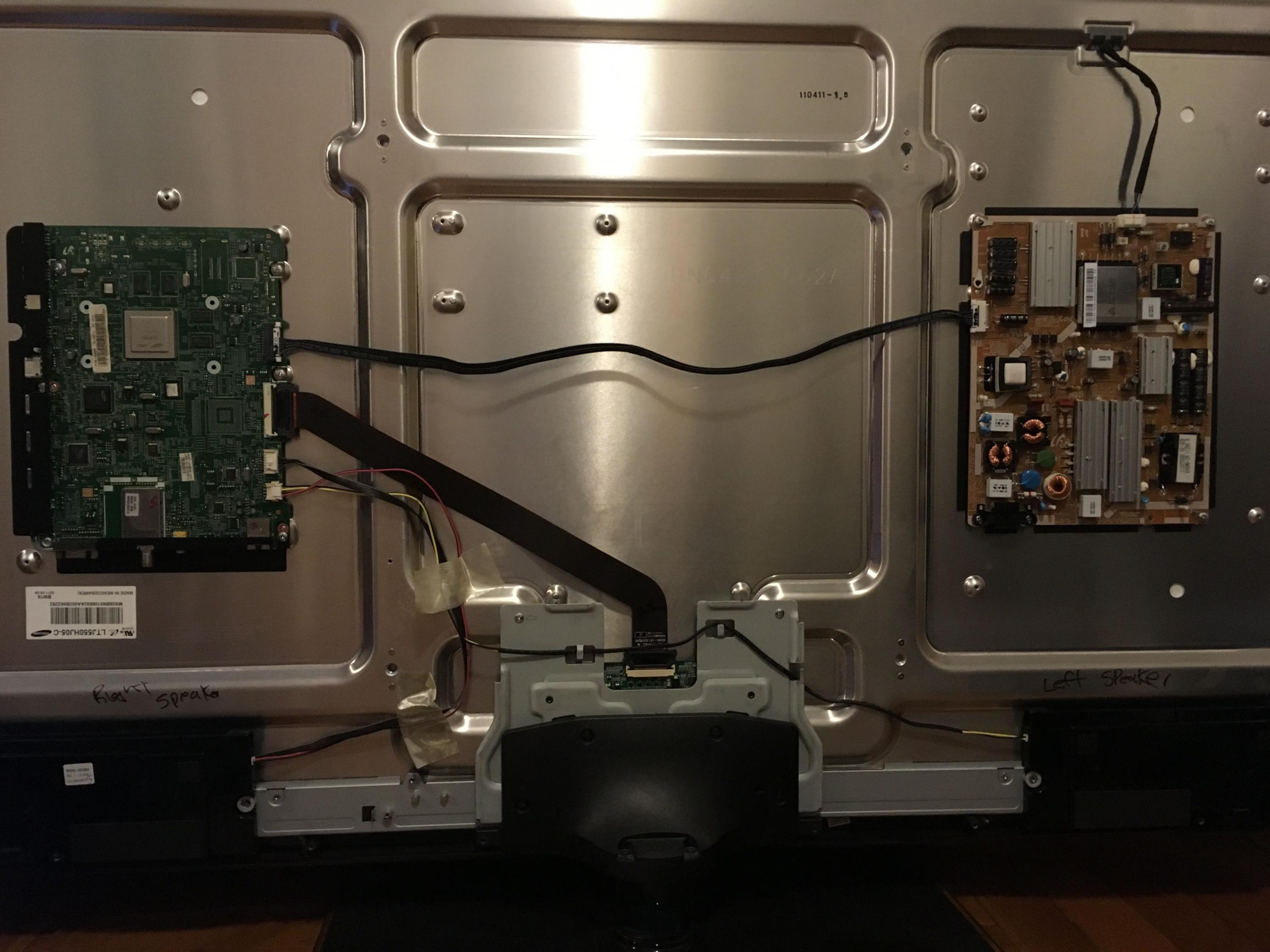

        Can we see good clear pictures of what we are dealing with, I.E. the whole backside of the TV showing all the boards, straight shot pictures of the whole power supply board, etc.?

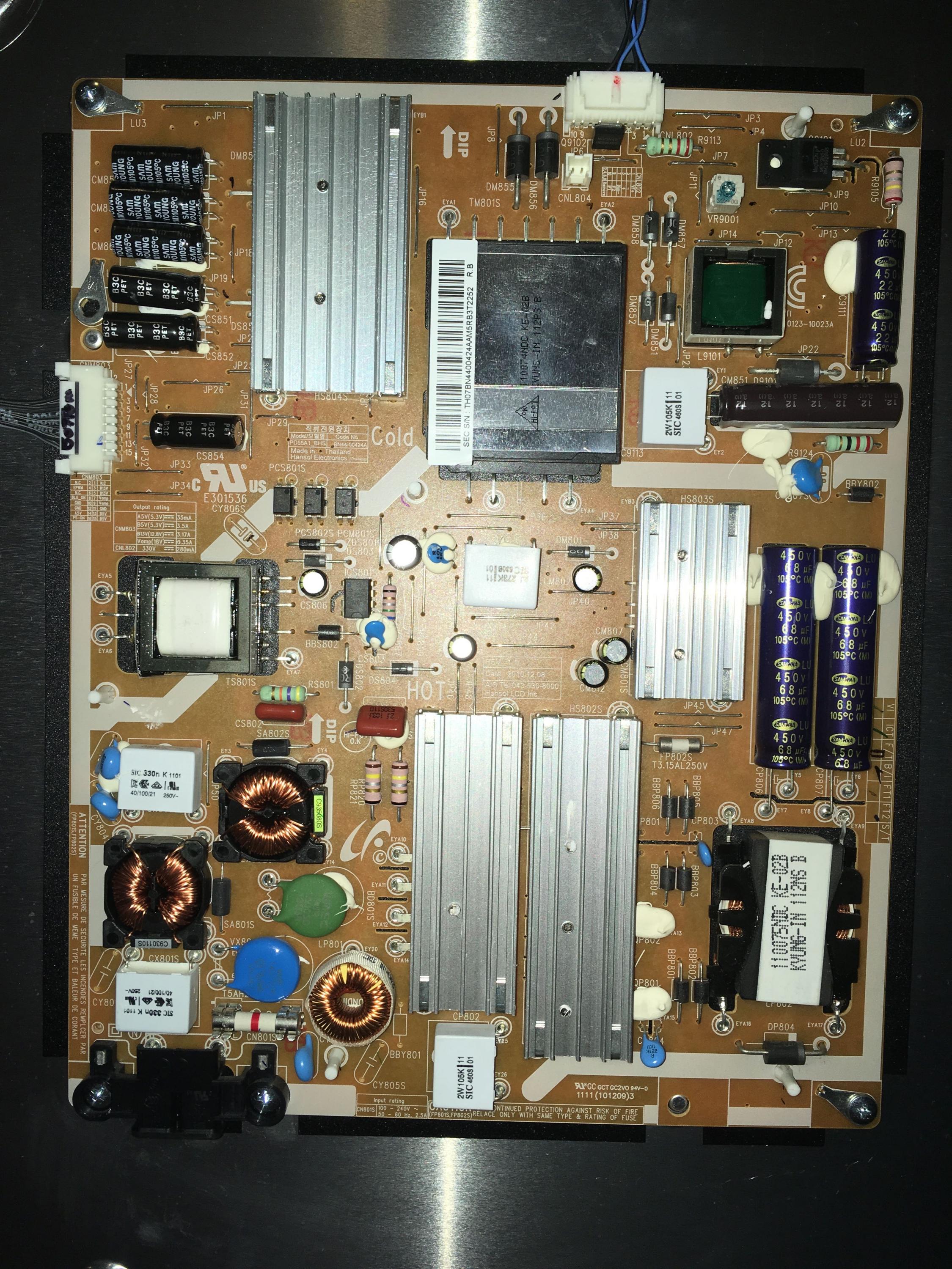

              Re: Samsung Samsung UN55D6050TF-Power Supply Pulsing, I think.
              So is this your power supply board, BN44-00424A?
              https://www.shopjimmy.com/samsung-bn...pply-board.htm

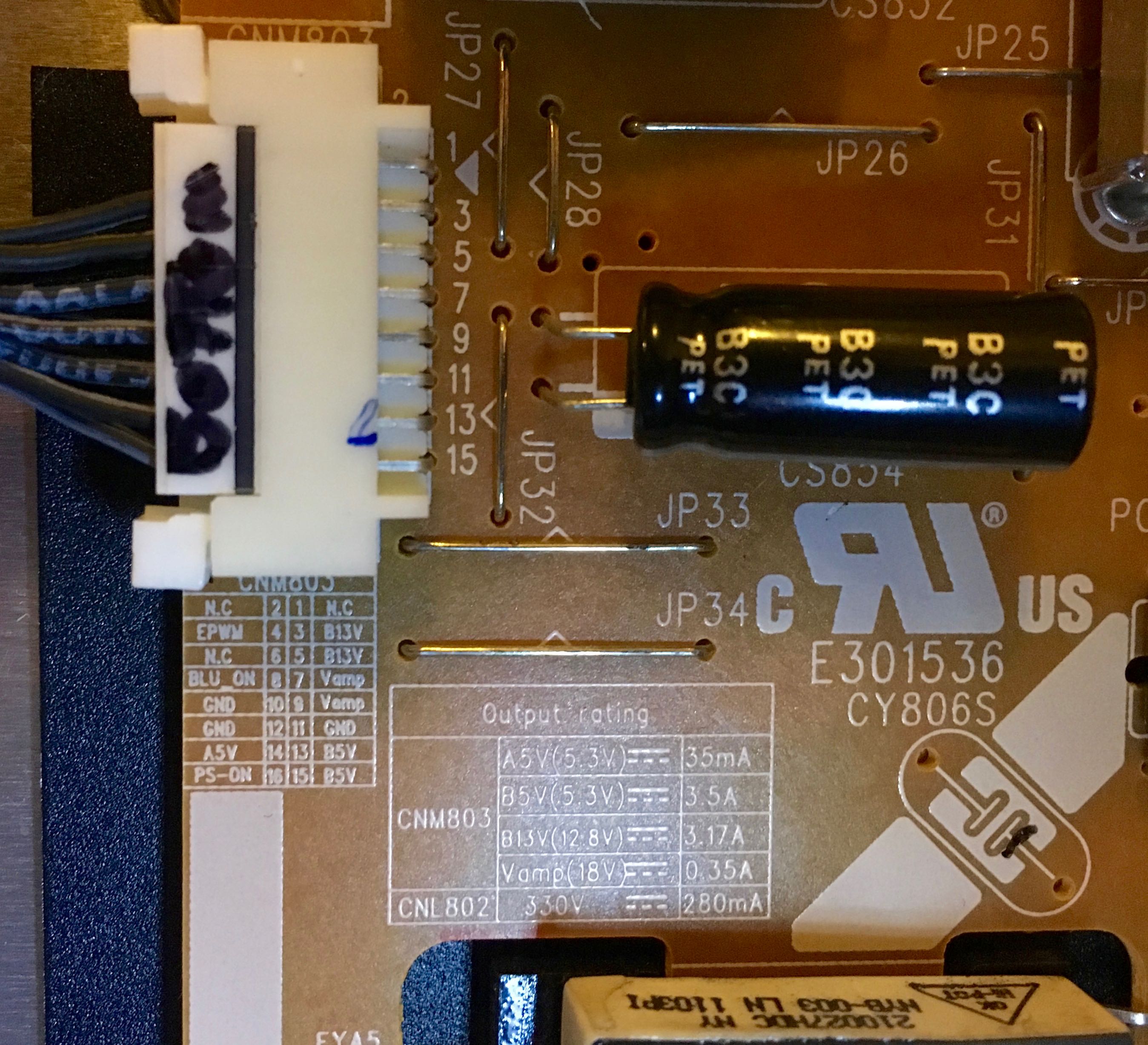

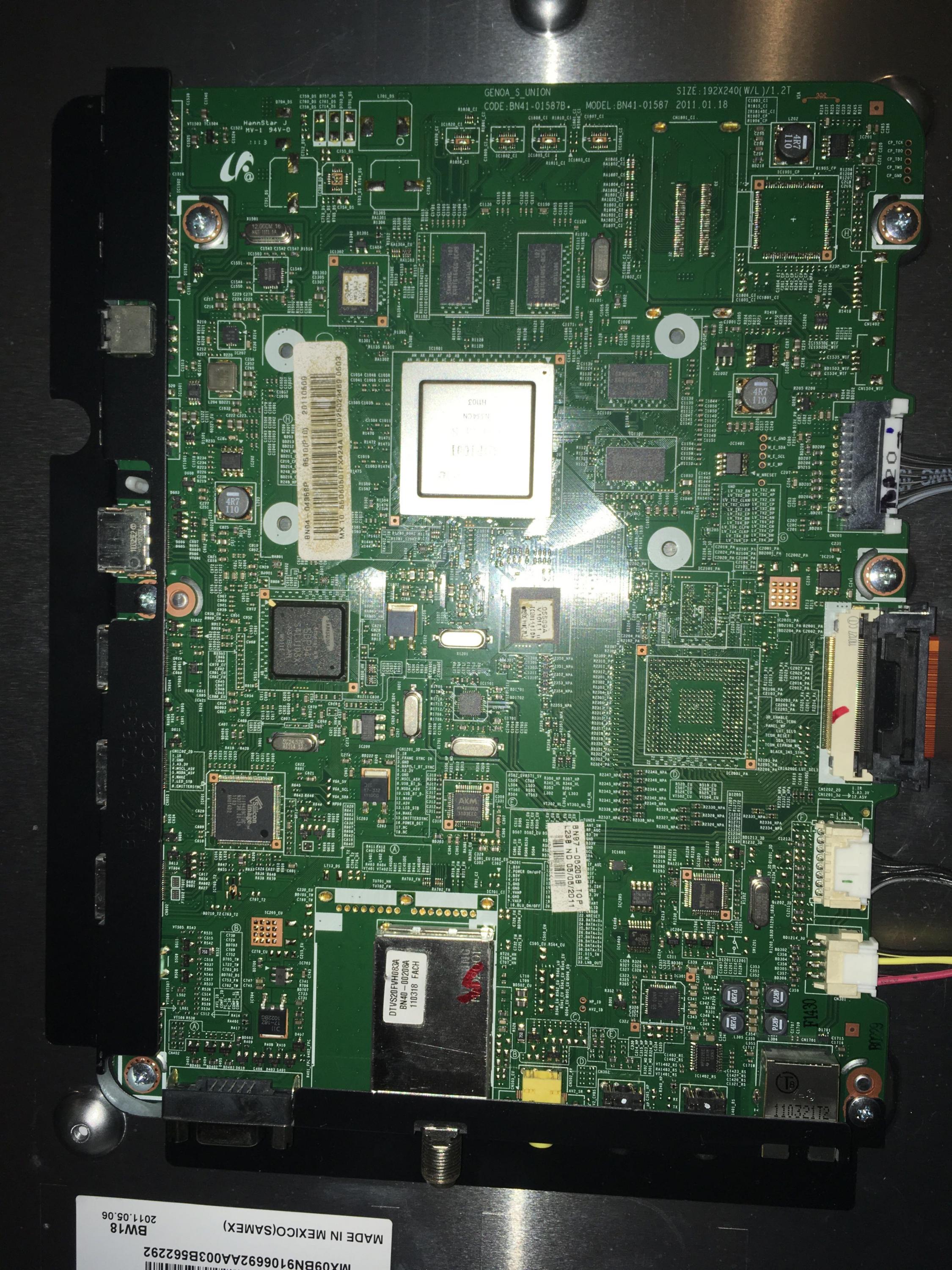

                      IS this your main baord?
                      https://www.shopjimmy.com/samsung-bn...d6050tfxza.htm
                      I do not see pin 1 is labeled as 5V.
                      The CNM803 pin 1 of the power supply board is NC, the connector between power supply board and the Main board CN201 are not pin to pin.
                      "One can see the switchers pointed out on the trouble shooting PDF on the picture on page 4" may be you should upload the manual.
                      CN201: The exposed pins you see on the top side of the board are ODD number pin, as you can see pin1 on one end, pin 19 on another end, same for the CNM803.
                      That is why your reading are way off, you should measure them on the power supply side instead since they are labeled.
                      For example you measured 13V on pin 1 of CN201, that pin should go to CNM803 B13V (switched 13V) pins of the power supply board.
                        Here are the Pictures.
                          Okay got some measurements CN803, yet I only got the odd pins which contained 5v and 13v circuits. The voltages were stable, and looks like they are okay, yet the 13v side is a little low.
                          My Measurements:
                          1=N/C
                          3=12.73v
                          5=12.73v
                          7=19.05v
                          9=19.05v
                          11=GND
                          13=5.37v
                          15=5.37v
                          Martin
                            So how about the Voltages for the EVEN number pins? Since the Switched 13V and 19v are steady that means the PS-ON is steady, so we need to know the control Voltages for the backlights circuit which are on the even number pins, you can probe from the wire entrance side of the connector.
                            So far it does not look like the main power supplies are pulsing, may be the LED power supply section is the one that is pulsing or the control lines are pulsing.
                                Even side of voltages... look at the picture on post 13
                                2 = N/C-Empty slot-no wire
                                4= 68mV
                                6= 12.68v which should be N/C
                                8= 4.95v Fluctuates like every 5 to 10 sec from 0v to 4.95v
                                10= 0v from using pin 11 ground
                                12=0v from using pin 11 ground
                                14= 5.38v = Stable
                                16= 2.06v fluctuates like every 10 seconds. Seems slower in fluctuation than pin 8
                                The connector 802 going to the LED illumination on both pairs I get like 5mv, so obviously they are not on, and I tested right when I power up the set, yet like every 15 seconds the voltage fluctuates to a few 100mV for a few seconds then back down to 5mv to 3mV.
                                Looks like it is time to follow pin 8 and pin16 on the power supply board, and see what is faulty.
                                Martin
                                        4= 68mV
                                        BL-ON: 8= 4.95v Fluctuates like every 5 to 10 sec from 0v to 4.95v
                                        14= 5.38v = Stable
                                        PS-ON: 16= 2.06v fluctuates like every 10 seconds. Seems slower in fluctuation than pin 8
                                        Martin
                                        How much of the fluctuation of the Control Voltage on pin 16 (PS-ON)? I doubt that you have problem with this PS-ON control line from main board because the switched B13v and B5V are steady.
                                        BL-ON pin 8 is the Backlights on control signal from the main board, since it is pulsing which is not right so the backlights circuit are being turning on and off.
