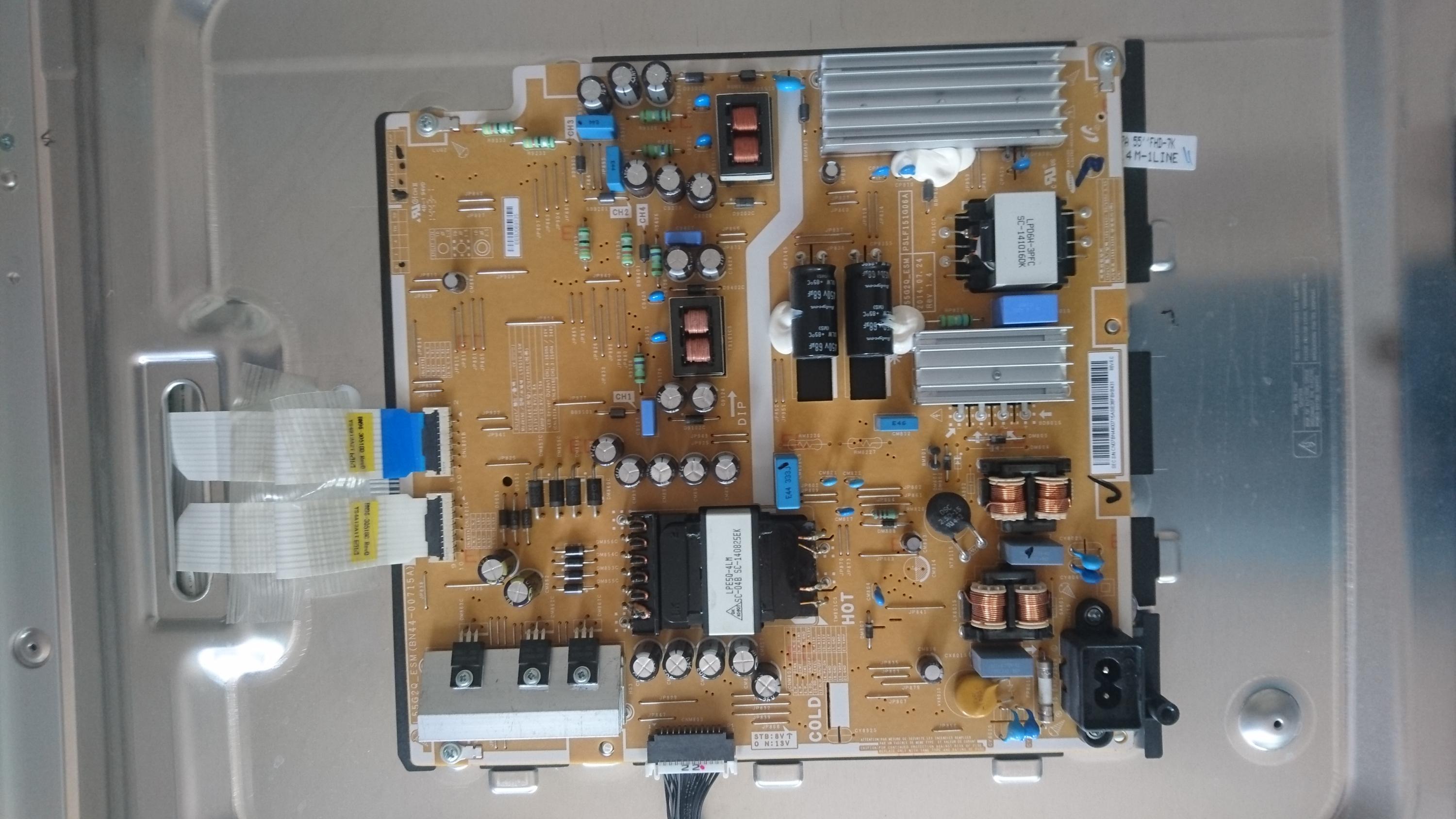

    some days ago my Samsung UE55H7080 broke. When I switched on the TV, the screen stayed black (2 hours ago I was still watching TV). The sound is still working, I can hear how I can switch channels, go into the menu and so on. I've already tried to plug the TV off for the whole night and plug it back on the next day and it didn't help.
    I decided to open the TV because I thought it might be a problem with the power supply for the backlight. Attached you can find some pictures of the inside of the TV.
    What I've already checked:
    - The fuse on the supply board is ok
    - I can't see any broken wires, bulged capacitors or similar.
    - I've checked the voltages of the LED supply; they are as follows
    CNL801A:
    Pin 1 (N.C.) 0V
    Pin 2 (N.C.) 0V
    Pin 3 (L4+) 16.8V
    Pin 4 (L4-) 0V
    Pin 5 (L3+) 54.7V
    Pin 6 (L3-) 0V
    Pin 7 (L2+) 54.7V
    Pin 8 (L2-) 0V
    Pin 9 (L1+) 16.9V
    Pin10 (L1-) 0V
    CNL801B:
    Pin 1 (N.C.) 0V
    Pin 2 (R1+) 39.8V
    Pin 3 (R1-) 16.9V
    Pin 4 (R2+) 127.4V
    Pin 5 (R2-) 54.7V
    Pin 6 (R3+) 127.4V
    Pin 7 (R3-) 54.7V
    Pin 8 (R4+) 39.8V
    Pin 9 (R4-) 16.8V
    Pin 10 (N.C) 0V
    What makes me wonder a little bit when looking at those voltage levels is, that they are not the same for left and right but I sadly haven't found a circuit diagram of the BN44-00715A in http://www.toms-service-manuals.com/ or elsewhere.
    I also can't see any light coming through the tiny holes in the back of the tv when I plug it in and switch it on. I haven't tried that in the very dark yet though.
    Do you have any suggestions what to check further? Mainly it would be interesting for me, where the failure is. If it is "only" the backlight or the screen.
    Thanks in advance.

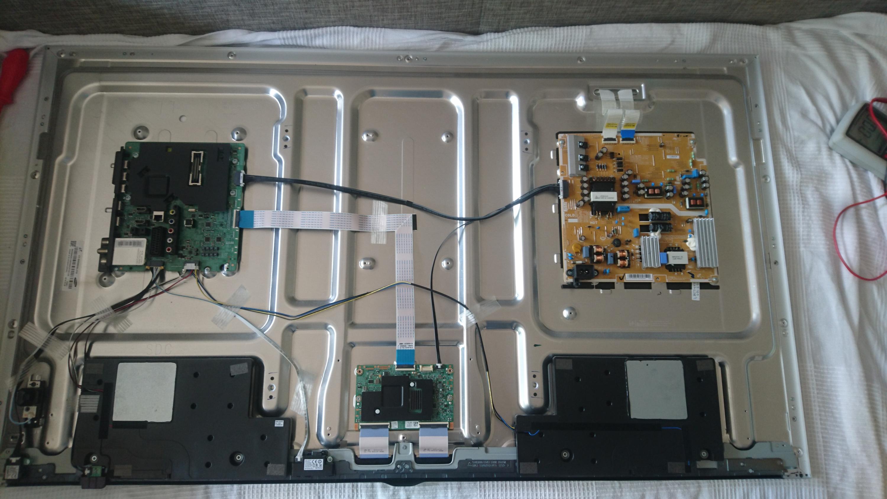

    Disconnect the connector between the motherboard and the source. The backlight must light up. If not most likely you have broken LEDs. With a stronger light, you can also see if it is an image.
    • Steradiant
      • May 2019
      • 29
      • Austria
      Re: Samsung UE55H7080 black screen (sound is working)
      Thanks for the advice but could you please tell me which board you mean with "motherboard". The one at the bottom I suppose?
      • tvtimmy
        • Mar 2015
        • 1160
        • usa
        Unplug this connector to see if backlights turn on.
        • Steradiant
          • May 2019
          • 29
          • Austria
          Thanks for the explanation. Yes, the backlight turned on after unplugging this connector. What does this tell us?

                          What makes me suspicious is, that the BLU_ON bin shows 3.2V when the connector is disconnected (hence, the LEDs are on; as explained above) and the 4.6V when the plug is connected and the TV is switched on.
                          Should the integrated driver be a IC on the power supply board?
                          So to follow the path I would have to remove the power supply board from the TV and follow the paths on the bottom. Or have you thought of any other way?

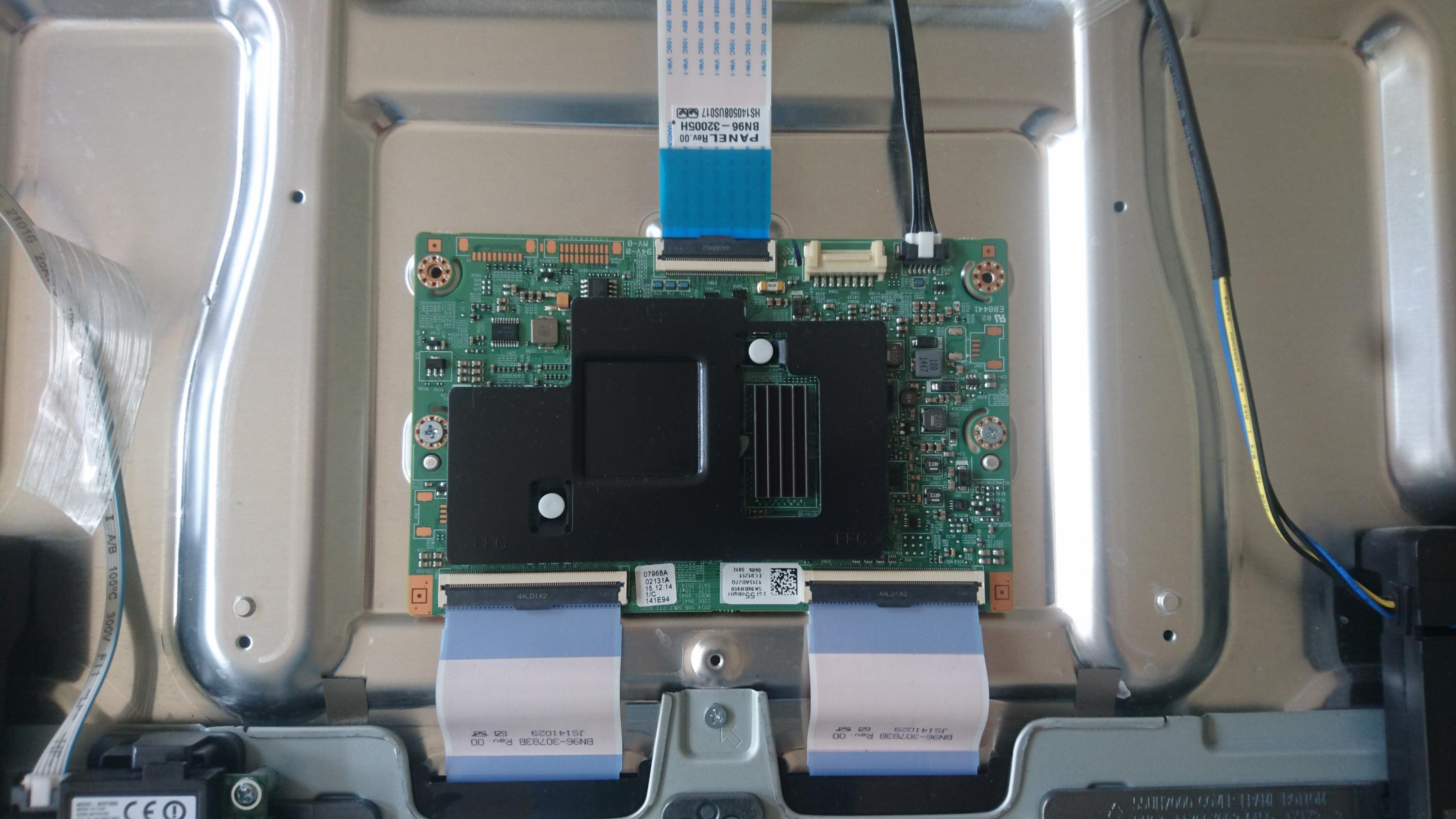

                              Just for fun check the tcon fuse, make sure it isn't blown and see if you have voltage on each side, negative probe on ground positive on each side.

                                I have to note that I don't have an oscilloscope at home right now, so I only can check the voltages with a simple multimeter. What makes me wonder is, that the P_DIMx Signals are 0V. But if they are actually PWM signals I might have problems measuring them with the simple multimeter?
                                I've checked the fuse at the T-con board (at least I think that this is the fuse; attachment) and this one is okay. The two LEDs on the T-con board light up blue after switching on the TV.

                                  disconnect, one at a time, the cables going from the tcon to the panel see what the result is (note: cable changes with POWER OFF).
                                  • Steradiant
                                    • May 2019
                                    • 29
                                    • Austria
                                    When I disconnect one of the top cables (see red areas in attachment) of the tcon board, the backlight turns on as I switch on the TV. The backlight also turns on if both cables are disconnected. By disconnecting the bottom cables, nothing (obvious) changes.
                                    If you need any information about voltage levels, just let me know in which ones you're interested in.
