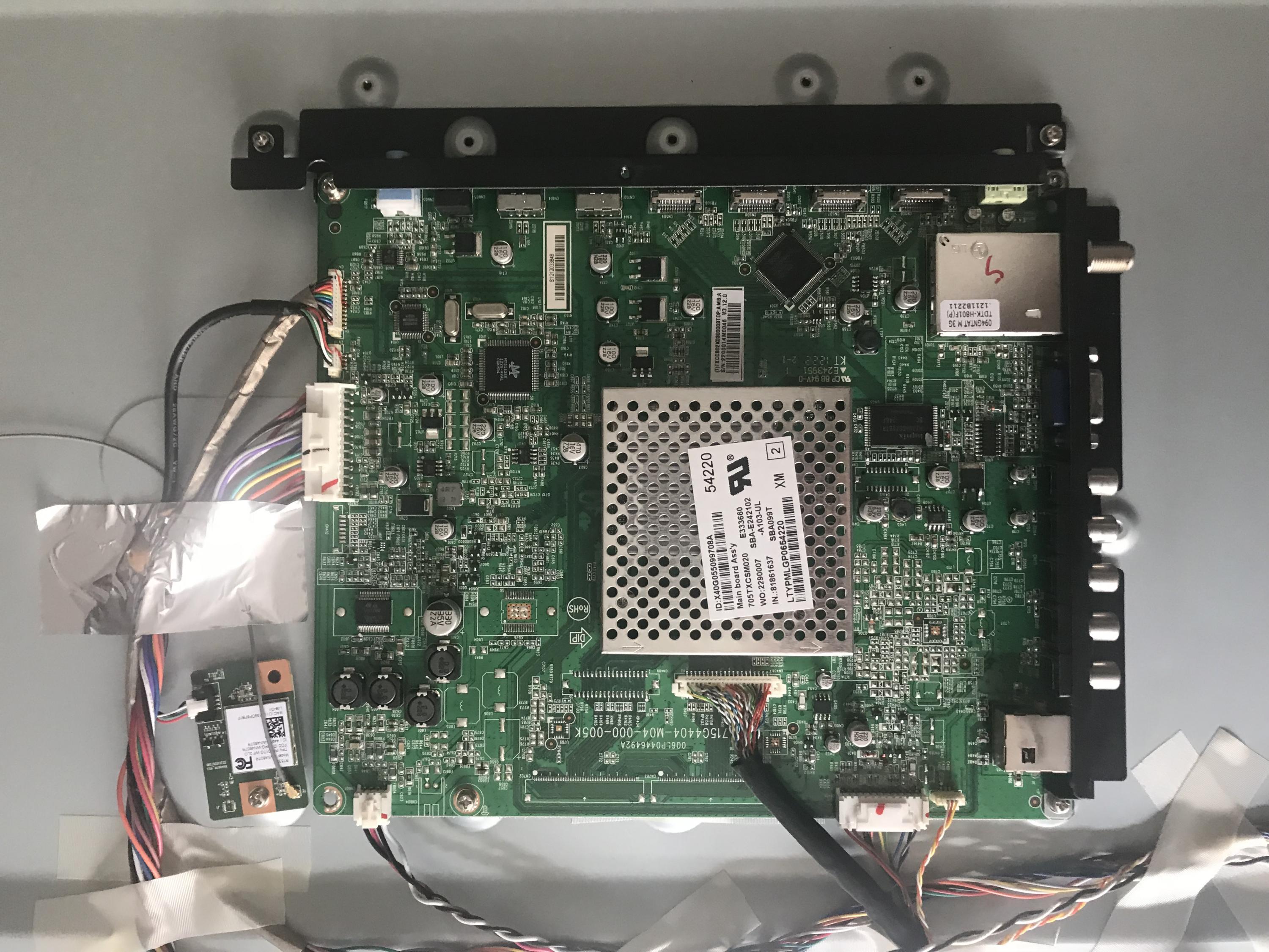

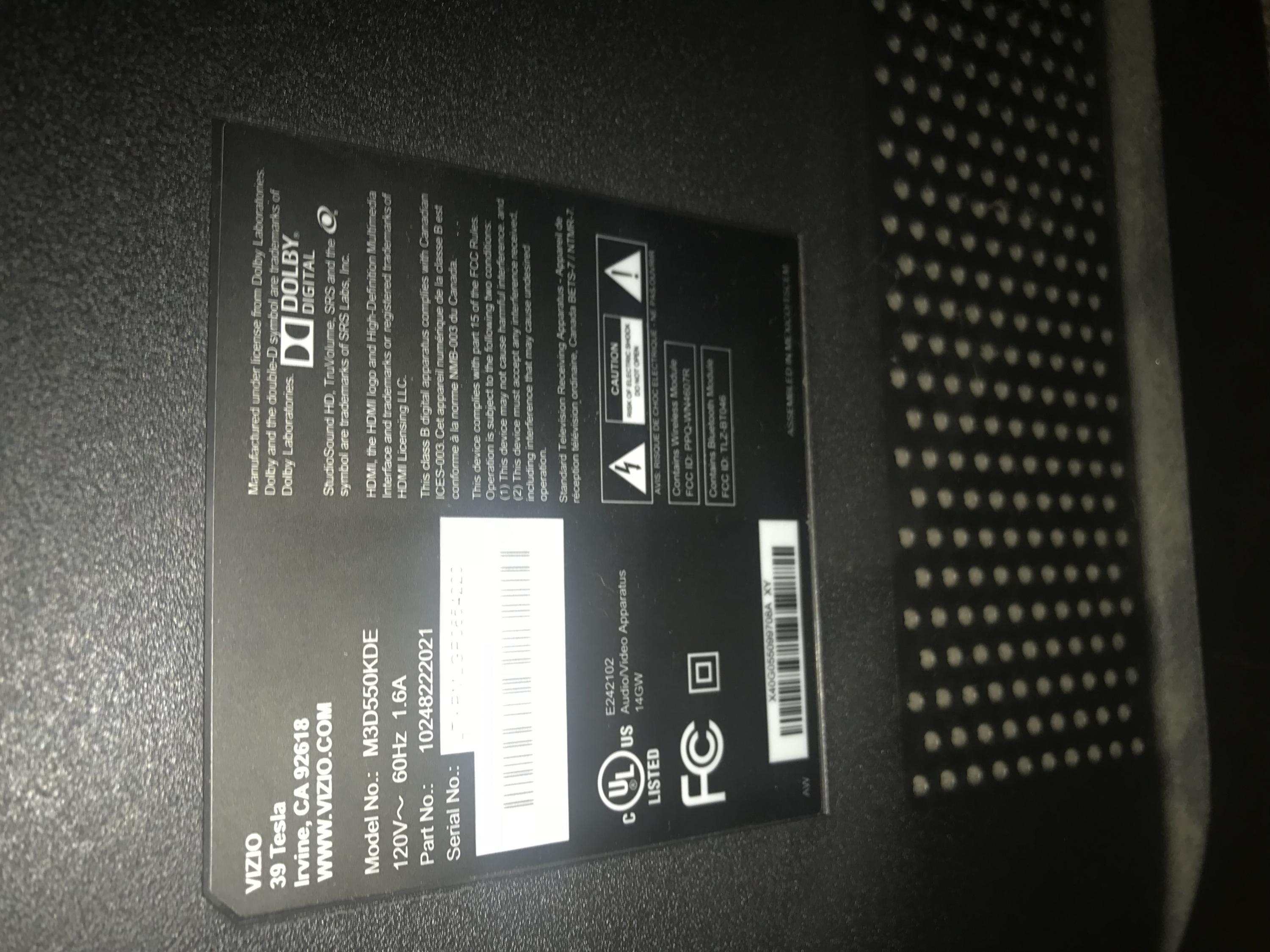

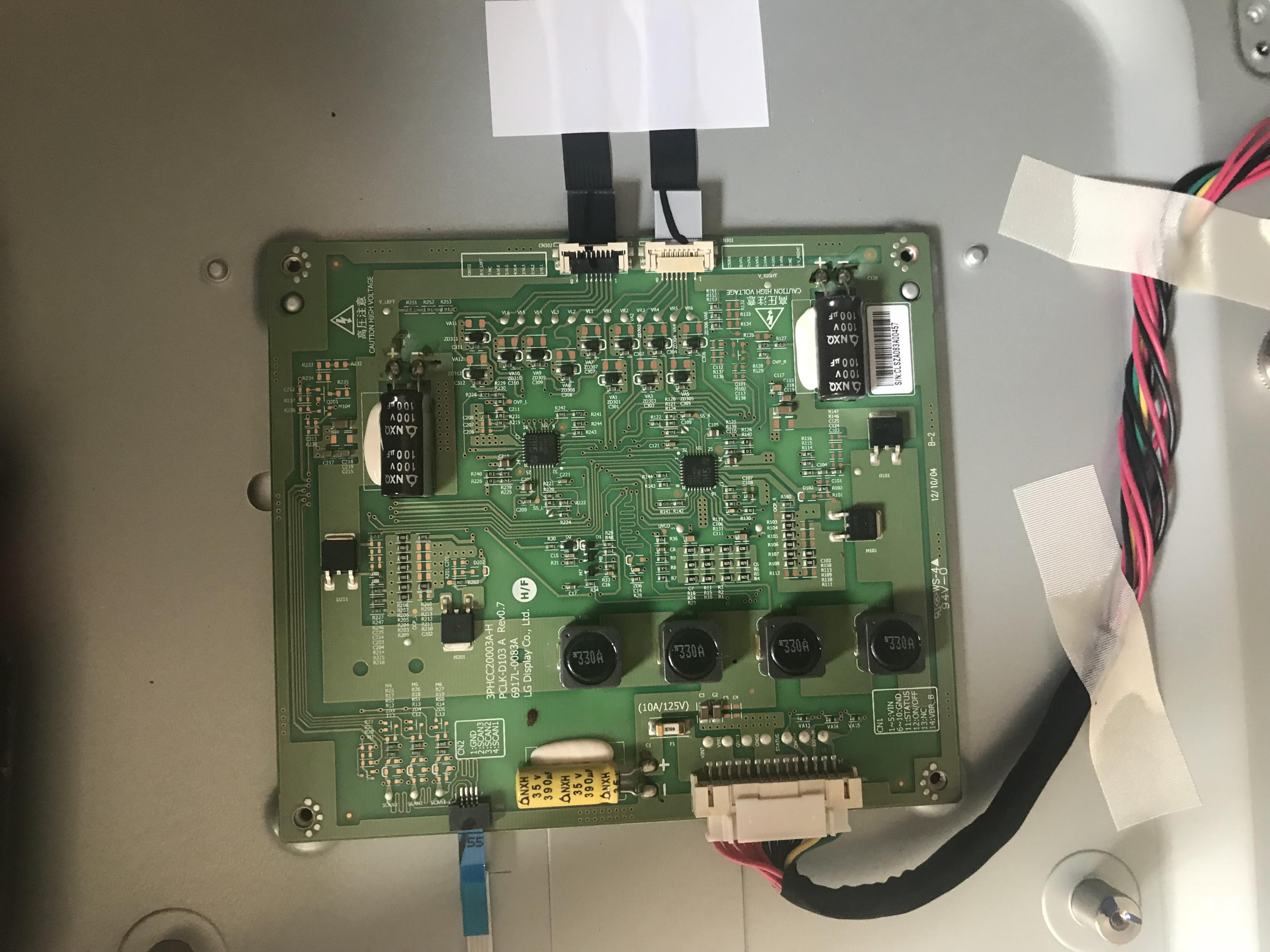

    So I have a Vizio M3d550kde around 2011 per date on a sub board. The tv works well except that the input on HDMI inputs 1-4 are all displayed in black and white - (other inputs not tested and unknown if they are good or not.) -where the menu selection and initiation screen show full fine color. I was thinking ok fine Main board replacement, but then I thought wait a minute, the menu display comes from the Main board. Any thoughts or suggestion for repair?
    I did a factory reset just to make sure someone didn't change a setting that would allow this weird behavior from the tv.
    The tv is a salvage to be given away, but more importantly it saves it from the land fill. The TV has never been opened until now. Looks great inside..

    Try a different input as all the hdmi seem to go through the same processor ic, There may be a setting somewhere in the service menu , maybe there is a selection for the type of ic used on this board, the menu will be generated by the main microprocessor, the hdmi has its own processor. Try component in or tuner

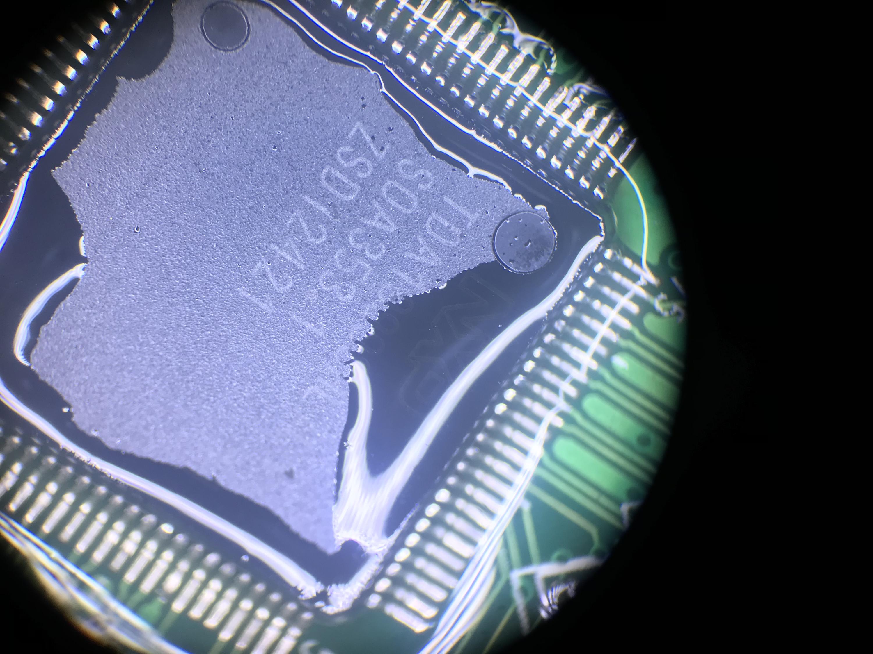

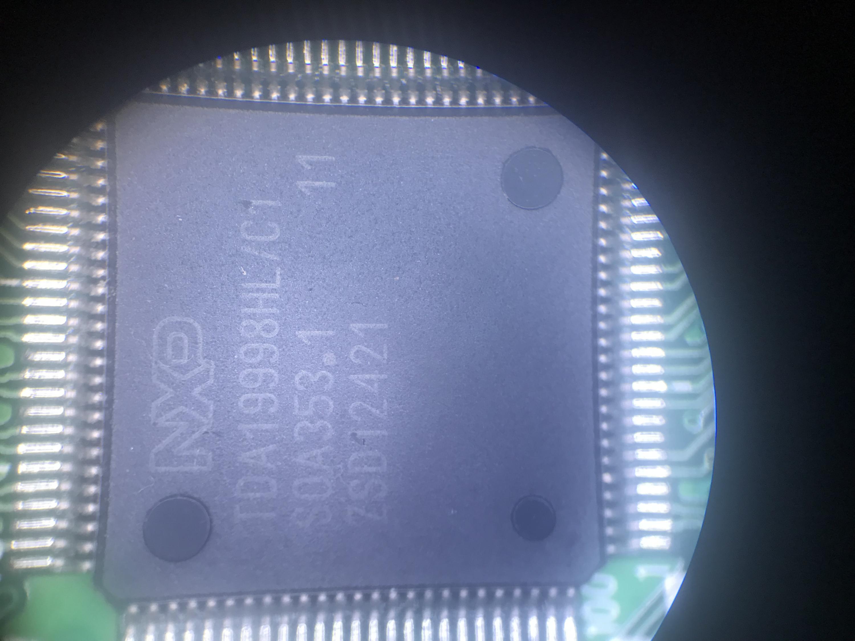

            read the number off the chip and post it well see if we find it it will be a bear to change it Im confused on just how its doing this... but I have seen some strange crap lately ! LOL

              I suspect it is not the TDA19998HL hdmi chip, I suspect it is something in the service menu that is causing the issue, something wrong with how the data is interpreted, orrrr
              Try a different hdmi source, that may be the issue and not the tv. i've seen this before with some sources

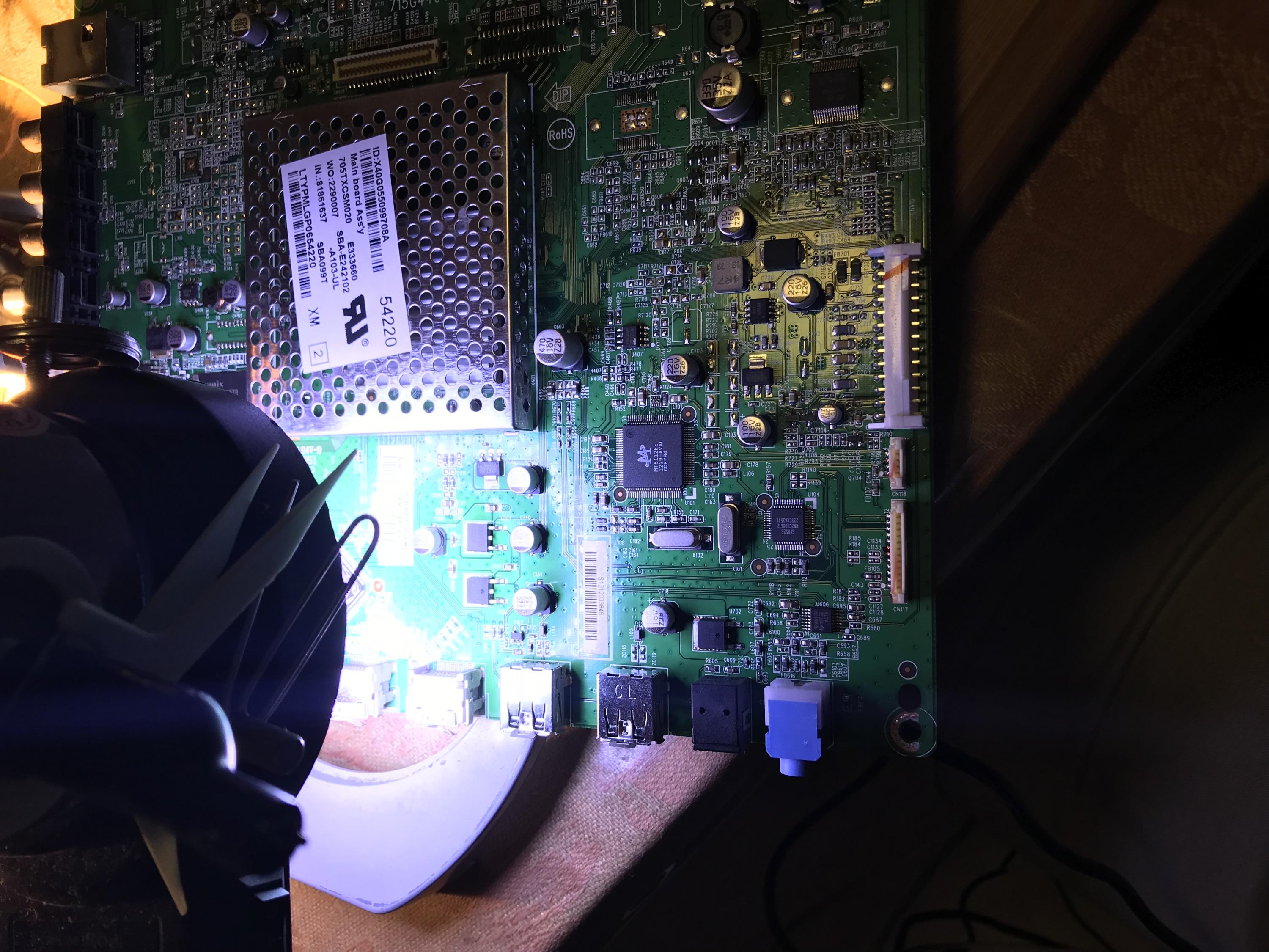

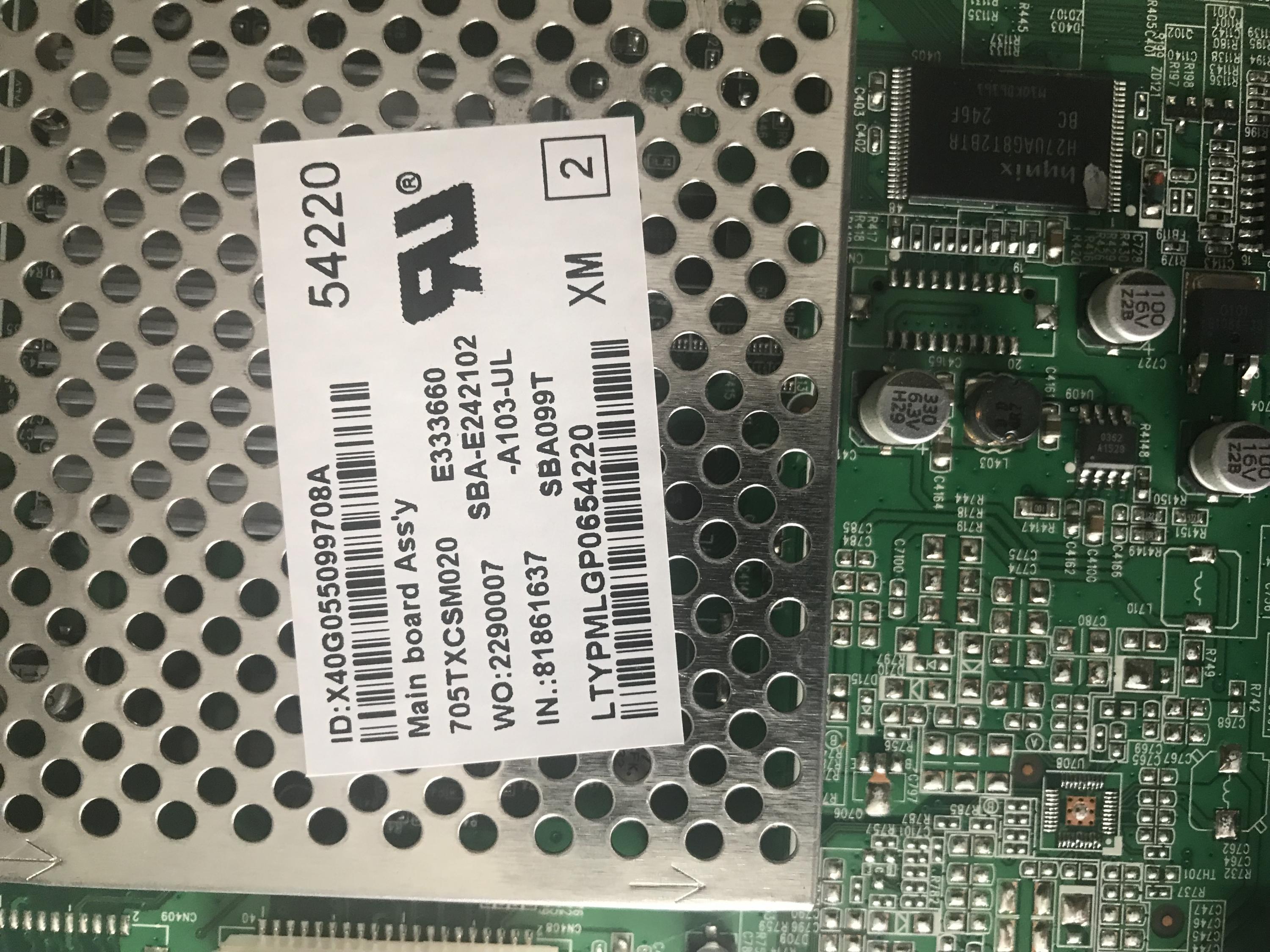

                Re: Vizio M3d550kde Black and White screen menu has color
                Yup that's the one in all her glory.. see pict also this is an modest replacement as I have the right tools for this job. I'm going to reflow it either way.. but I just tested all the pins and they are good so I don't think a reflow will work but either way it will prep the silver off the board and dilute it with some good ol' lead.

                            ok so two sources and two hdmi were tested and all tested for color on the m3d failed to produce color. The same two sources and two hdmi were tested on a m552 and all four devices worked. I just finished the reflow of the chip
                            Success... the reflow worked color on all hdmi points.. go figure

                              Thats good to here you have it fixed, it may have just been a poor solder connection on the ic, I usually check to see if any of the pins are loose by using a needle and seeing if any of the ic's pins move when pushed
                              likely one of the common clock or data pins had an issue
