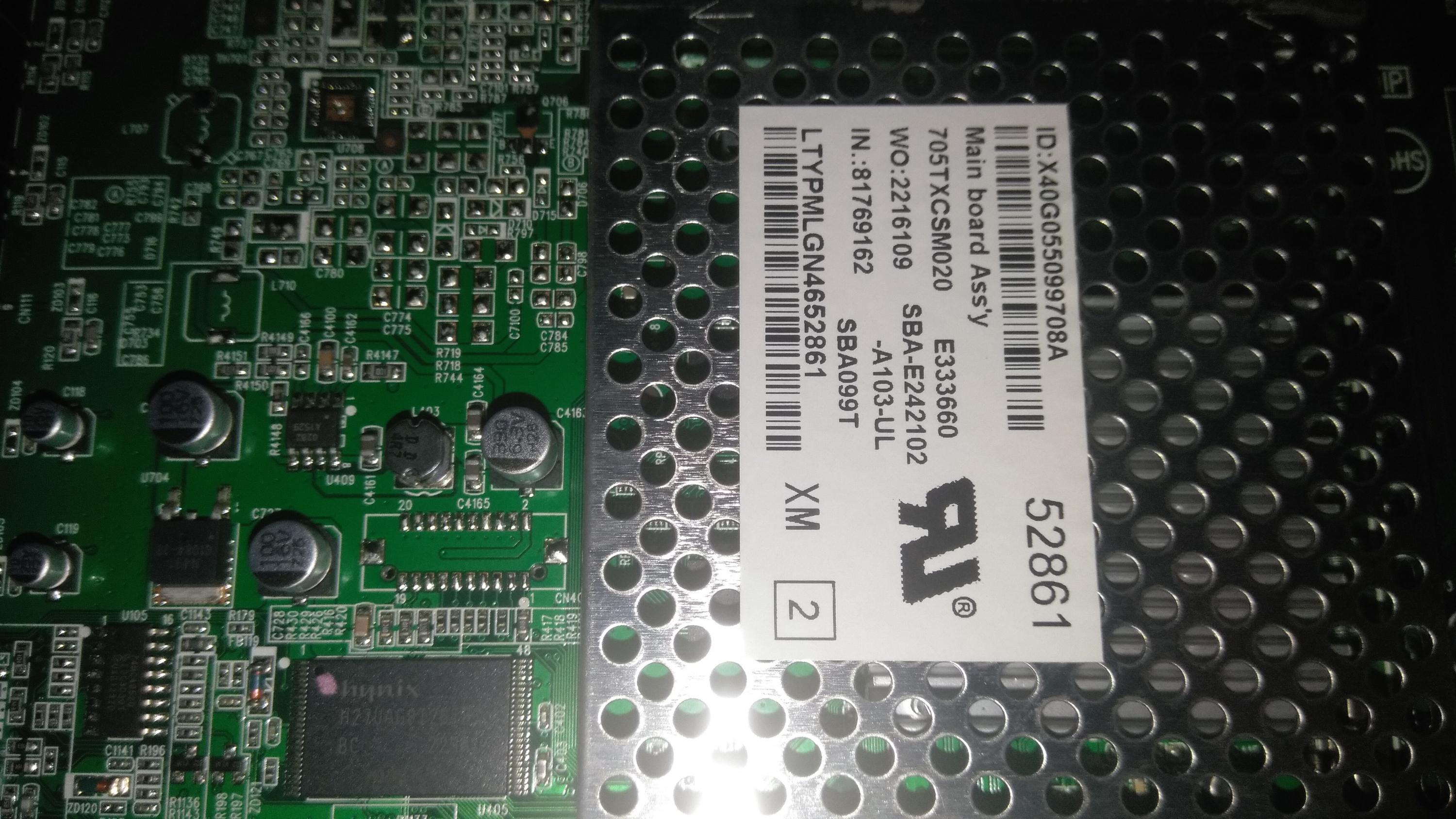

    Can't say for positive but a new mainboard should do the trick.
    • Mr.Nientiendo
      • Jun 2019
      • 32
      Re: Vizio M3d550kde Black and White screen menu has color
      Theres no lock out procedure checking like to see it has to be the same model as the old board in tv to be compatible I hear rumor ifts not just gets stuck on the logo screen as it turns on
      • nomoresonys
        • Jan 2013
        • 12331
        • U.S.

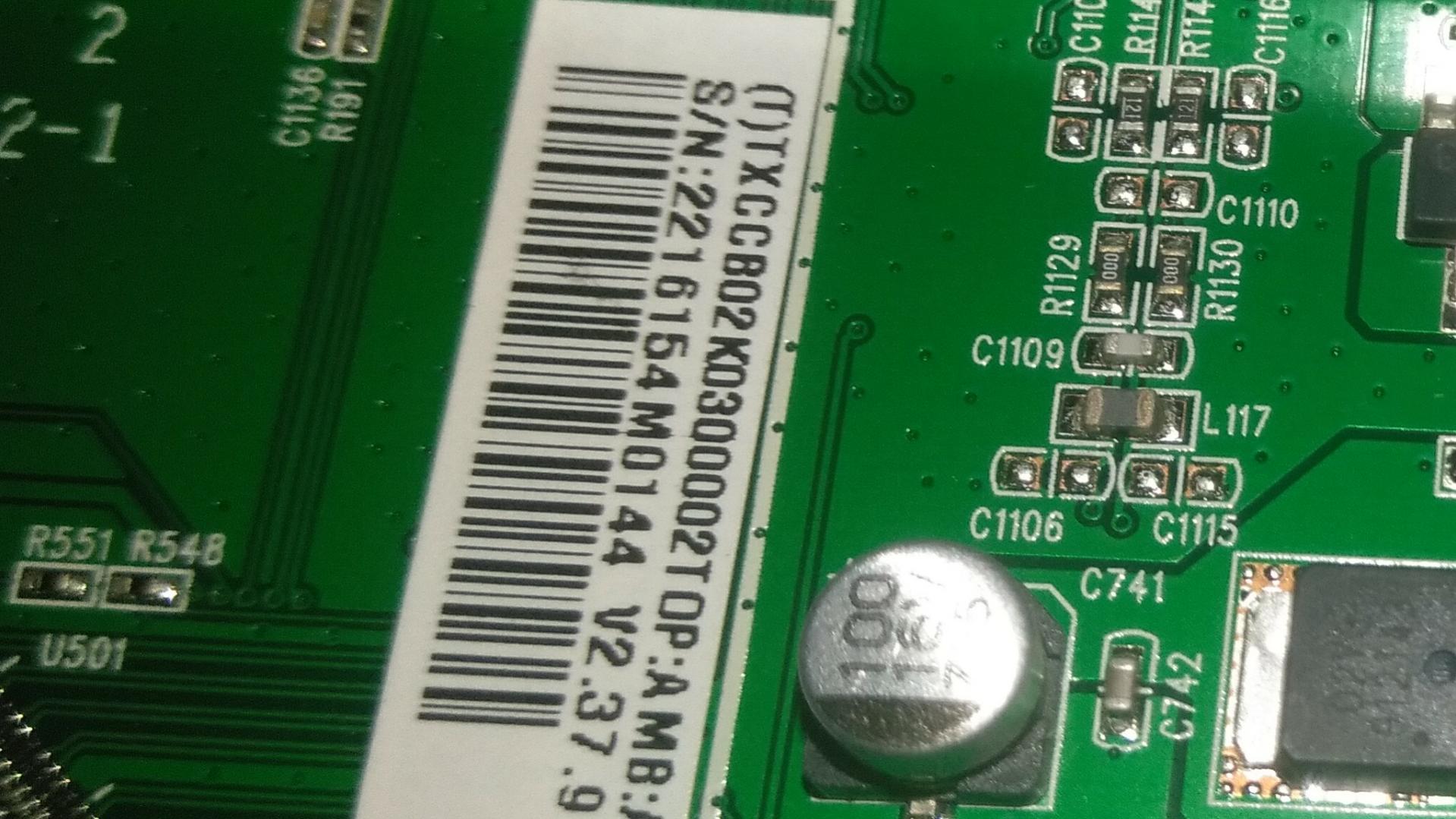

        You want to match up the numbers of the white sticker on the mainboard, the one starting with TXCC.

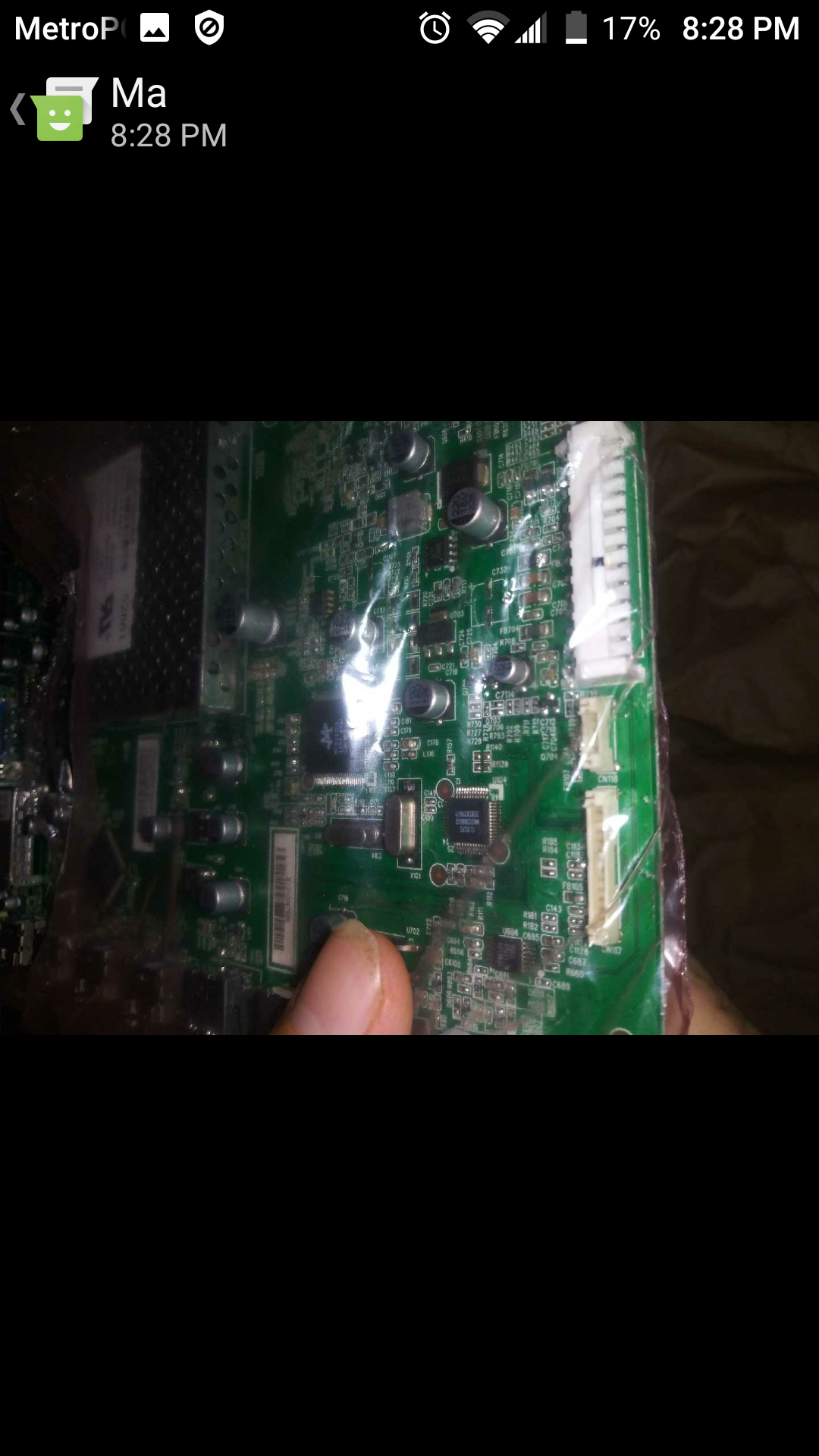

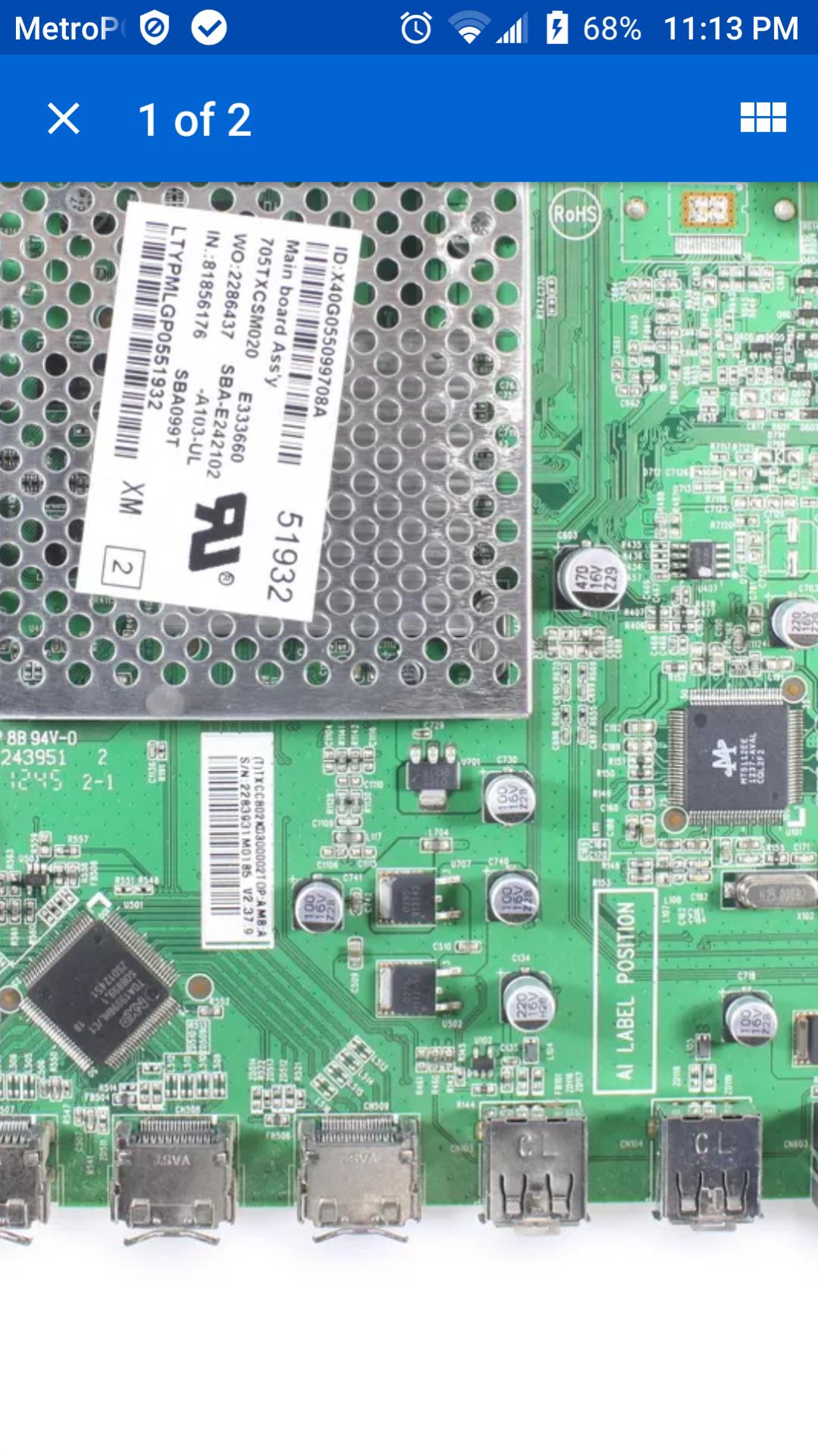

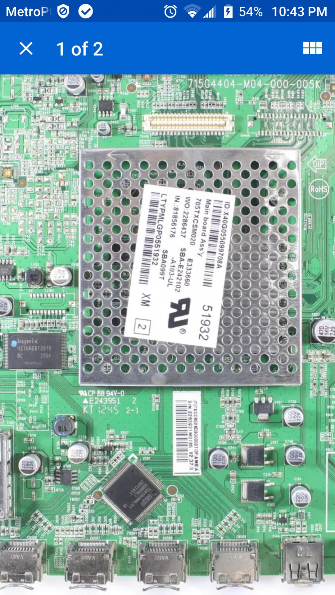

          Hello and thank u guys for replying I have decided to find the board on eBay now I match the tx number thts on board cost me $100 now I'm stuck with board cause the guy said this not the one for my tv y is tht I'm confused does it have to do with firmware perhaps this boards are hard to find by the way ok so this is picture of my board of tv and the one I bought the one with blue line on top is the board from ebay
          • nomoresonys
            • Jan 2013
            • 12331
            • U.S.
            Who said it wasn't a match? Those 2 boards sure look like a match, just like this one: https://www.shopjimmy.com/vizio-cbpf...-m3d550kde.htm
            • nomoresonys
              • Jan 2013
              • 12331
              • U.S.
              What's your panel sticker number?

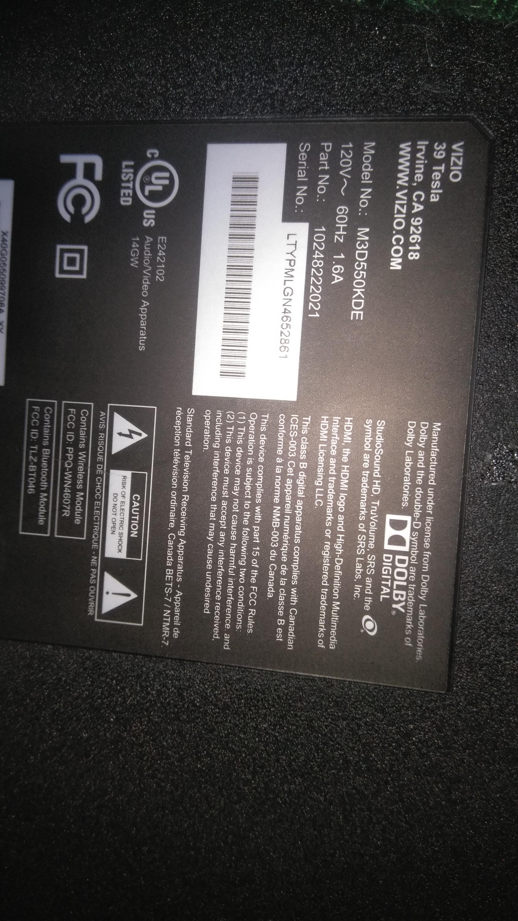

                Hi friends thnks for replying is this the sticker you're talking about ? 🤔 And the guy who sold me the board says tht they don't have the board I'm looking for my T.V
                  The model number of the LCD panel is on the sticker on the back of the LCD panel.

                      #30
                      NO, you need to take the back cover OFF, then look on the metal chassis, it will be on a sticker sticking to the chassis, sometimes it will be under some type of shield that may also need removed but not usually.

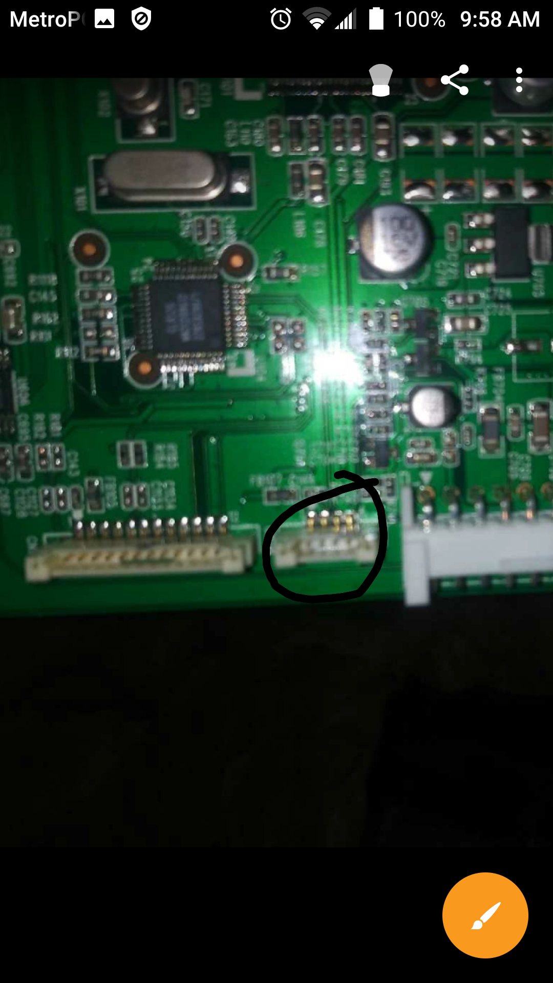

                                      Sry to bother guys question the smallest lil clip on right side wht is for? Or wht does it do cause on my new board it's missing how ever the pings lil metal contacts pins are there and I manage to connected to the pins do i require this clip to be on my board as well or?
                                      • nomoresonys
                                        • Jan 2013
                                        • 12331
                                        • U.S.
                                        #39
                                        Not sure what "clip" you mean, try it without hooking it up, if there's no problems you might not need it.

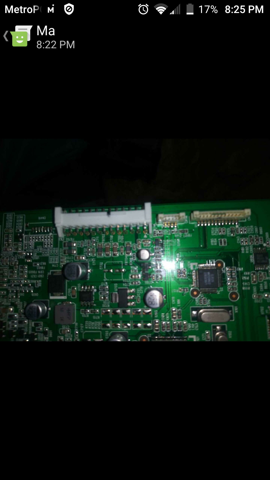

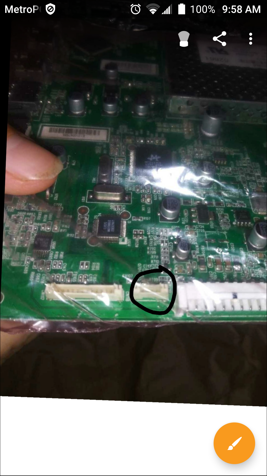

                                        • Mr.Nientiendo
                                          • Jun 2019
                                          • 32
                                          #40
                                          This one were it's circled sry I Ben having problems uploading pics and videos any way my main question wht is this plug for? And and is it required it has tht clip cause my new board is missing it but I managed to connect the connection to the little metal prongs were it's suppostly connects
