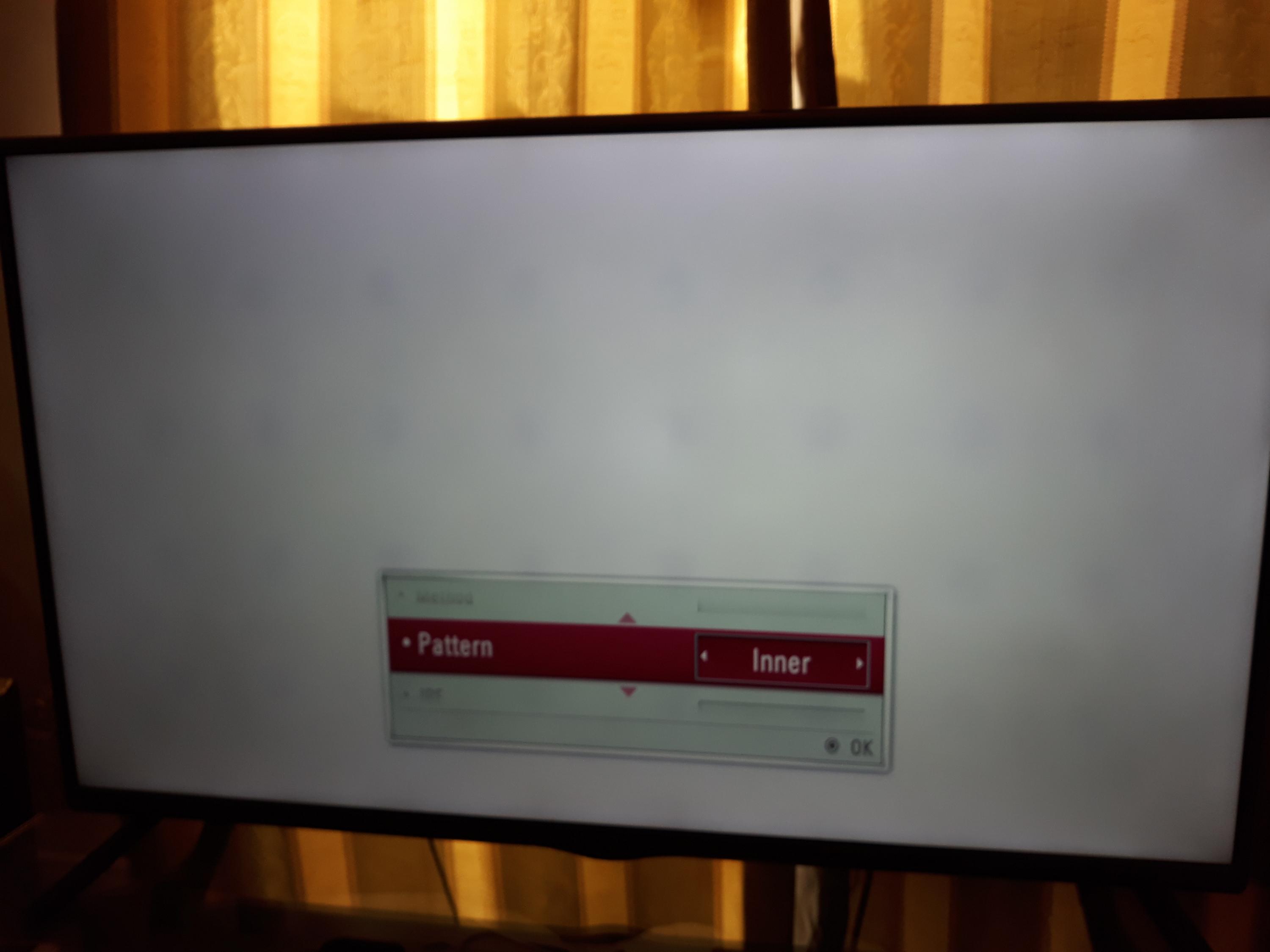

    Hi all i changed all the strips on an lg 42lb5500 led tv and now i can see a very slighter row of darker circles that match up to the position of the led lens covers,is there any way to remove this?.Im pretty sure that these tvs had this problem when they were new?.The tv works fine and i cant really do anything about this.Maybe it was the quality of the strips i bought on ebay?.Any thoughts?,thanks for your opinions and advice in advance.

    Wonder if you got a mismatch on your replacement strips or faulty ones, does it help to turn down the backlights if possible?

      Hi no turning down the backlights does not help at all i'll attach an image the strips i ordered are the same type as the ones in the tv originally as you can see the leds leave a very slighter darker spot where each led lens is.Thanks for your help by the way nice of you to reply.

        I suspect diffuser layer fault , eg wrong order

          I put them all back in the same order they came out (i think,lol),im pretty careful with that sort of thing normally to be honest but thats a good point there is a slim chance of that but i think its a bad batch of led strips with the incorrect lens angle fitted to the lg originals..

            Because they are all noticable i doubt that all the strips were faulty manufacture
            Have replaced many of this tv with new one and never had any issues
            I stand by my first evaluation that the diffuser panels somehow got messed up
            When i do these TV i tape the diffusers together and remove together , they can be slippery buggers and you can easily ether get the sequence mixed up or one of the diffusers reversed

              Thank you i think i will tape them together myself as you do in future to assure i don't make the same mistake again i have took this tv apart a couple of times now in the past so its likely that the sheets did get mixed up or one the wrong way round etc,thanks everybody for your input,very kind of you all to help.

                This type of circles can appear as a result of the diffuser panels not sitting the correct distance from the LED lenses on the LED strips.
                I have seen many TVs lately where the delicate plastic spacer clips that hold the diffuser panels away from the backlight LEDs are bent or damaged and the diffuser panels can warp and sit however they want... This means some areas are closer to the LEDs and some areas are further away... Areas that are closer will not have adequate spacing to diffuse the light from the LEDs and will appear as spots.
                Check those delicate plastic clips, or ensure you did not damage them when you removed them, and certainly make sure that you put them back in place (or didn't lose them or damage them)
                Depending upon their install location, you may even have different length clips... It is important to re-install exactly so all areas are held the same distance from backlights.
                It's hard to tell, but the center areas of the screen look worse than the outer areas so your diffuser panels and LCD may be warped toward the middle of screen (ie, unsupported in middle area)
                One other thing to check, is if all your diffusers are installed in the correct order and all your clips are correctly installed.... Maybe your metal backing of the panel is WARPED. Sometimes this can happen if excess weight or pressure is applied to the metal panel when resting face-up on the operating table (try not to lean on it if you are reaching because it is thin gauge material that is prone to bending)

                  Thats a very good point about the metal back might have got a bit warped i never thought of that,ill make sure i don't put too much pressure when operating on the tv metal back and removing and installing the new led strips.Thanks for your input.

                    Also you're correct the shadows were worse in the middle of the screen....
