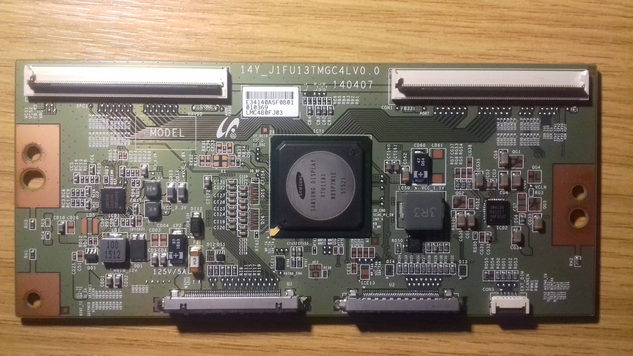

Panasonic TX-48CX400B - No Video
  • nomoresonys
    replied
    Re: Panasonic TX-48CX400B - No Video
    Looks like HVIN is way too low.
    Leave a comment:
  • tmcw
    replied
    Re: Panasonic TX-48CX400B - No Video
    Here are the voltages off the various test points, before and after panel ribbon cables connected...
    VIN_12V ... 11.78 ... 11.82
    HVIN_12V ... 0.06 ... 0.06
    VCC_3.3V ... 3.32 ... 3.32
    VCC_1.8V ... 1.80 ... 1.80
    VCC_1.2V ... 0.94 ... 0.95
    VCC_1.1V ... 1.15 ... 1.15
    VCLN ... 0.10 ... 0.01
    Is the VIN_12V of 11.78 / 11.82 good enough?
    Also, is the drop on VCLN from 0.10 to 0.01 significant?
    Leave a comment:
  • tmcw
    replied
    Re: Panasonic TX-48CX400B - No Video
    Thanks for that list, I'll test them out.
    I don't think there are any on the other side, I'll upload an image of it, if you wouldn't mind double-checking for me.
    Leave a comment:
    replied
    Re: Panasonic TX-48CX400B - No Video
    There are many Voltage test points on that T-CON board: Test those Volatges with and without ribbon cables between LCD panel and the T-CON board.
    HVIN_12V
    VCC_3.3V
    VCC_1.8V
    VCC_1.2V
    VCC_1.1V
    VCLN.
    I cannot see VGH, VGL, AVDD.
    Does it have test points on the bottom side of the board?
    Leave a comment:
  • nomoresonys
    replied
    Re: Panasonic TX-48CX400B - No Video
    Hmm, maybe throw a tcon at it, see if that's a match: https://www.ebay.ie/itm/PANASONIC-VE...8AAOSwDZ9bsfy6
    Leave a comment:
  • tmcw
    replied
    Re: Panasonic TX-48CX400B - No Video
    I came back to this set, and have seen the above new posts...
    No graphics on screen whatsoever, no menus, volume bar, etc., but the buttons do work, as I can hear the sources switching, and the volume goes up and down when the appropriate buttons are pressed.
    I also tried unplugging both sides of ribbon cables on the t-con board (one at a time) but it made no difference to the display, still no picture, graphics, etc., but the backlight is still coming on as reported before.
    I had a look at the t-con board, and could see a couple of places where voltage is marked, I was getting 11.78V at the place marked 12V (on the U1 connector), and up from that in the middle of the board (as per the attached photo), I am getting 3.3V at the place marked 3.3V.
    Are there any other tests I can make on this board?
    Leave a comment:
  • nomoresonys
    replied
    Re: Panasonic TX-48CX400B - No Video
    Faulty tcon? try with power unplugged, remove one side of tcon ribbon connector, plug in tv, power it on, see what display you get if any then do the same for other ribbon connector.
    Last edited by nomoresonys; 09-18-2019, 04:19 PM.
    Leave a comment:
  • Trevtron
    replied
    Re: Panasonic TX-48CX400B - No Video
    Do you get any graphics? I.e. menus, volume bar etc.?
    Leave a comment:
  • tmcw
    replied
    Re: Panasonic TX-48CX400B - No Video
    Originally posted by tmcw
    Yes, I tried all HDMI inputs, and they give the same result, audio, but no video.
    I will try the VGA, and component too, I think I have a media player that will output component.
    Same results with VGA and component, no video.
    Leave a comment:
  • tmcw
    replied
    Re: Panasonic TX-48CX400B - No Video
    check all the different inputs as well.
    Yes, I tried all HDMI inputs, and they give the same result, audio, but no video.
    I will try the VGA, and component too, I think I have a media player that will output component.
    Leave a comment:
  • tmcw
    replied
    Re: Panasonic TX-48CX400B - No Video
    Originally posted by diif
    Check the fuse on the tcon.
    Yes, the fuse is ok, and I'm getting 11.83V either side of it.
    Leave a comment:
  • CapLeaker
    replied
    Re: Panasonic TX-48CX400B - No Video
    check all the different inputs as well.
    Leave a comment:
  • diif
    replied
    Re: Panasonic TX-48CX400B - No Video
    Check the fuse on the tcon.
    Leave a comment:
  • tmcw
    started a topic Panasonic TX-48CX400B - No Video
    Panasonic TX-48CX400B - No Video
    Hi, looking at this TV set, I can hear the audio, LEDs/backlights are on, but there is no video, here are some details...
    Panasonic TX-48CX400B
    17IPS20 power board and 17MB100 mainboard.
    With HDMI source, I can hear the audio fine, but I can't see any video.
    But the LEDs seem to be on, I can see the light coming through the holes on the metal plate at the back, that the circuit boards are attached to, and I can see an even layer of light on the LCD panel at the front.
    The TV was on this afternoon for a few hours, audio continued to play, while the LEDs stayed on. When the TV is left on without a video source for maybe 5 minutes, the backlight/LEDs switch off.
    I've attached a photo of the back showing the light getting through the metal plate, I'm thinking I'm not having a problem with the LEDs, but elsewhere.
    I have read other threads with similar/same power board, but those problems were saying that they could see images on the LCD panel with the aid of a torch; I don't think I'm getting video to the panel.
    What should I test first? It might be worth a bit of time if the panel is ok.
    Thanks.
    HP EliteDesk 800 G3 + GoPro HERO6 Black 4K Ultra HD Video Camera EliteDesk 800 i7-7700 Specification for Upgrade or Repair
    This specification for the HP EliteDesk 800 G3 + GoPro HERO6 Black 4K Ultra HD Video Camera can be useful for upgrading or repairing a desktop PC that is not working. As a community we are working through our specifications to add valuable data like the EliteDesk 800 G3 + GoPro HERO6 Black 4K Ultra HD Video Camera boardview and EliteDesk 800 G3 + GoPro HERO6 Black 4K Ultra HD Video Camera schematic. Our users have donated over 1 million documents which are being added to the site. This page will be updated soon with additional information. Alternatively you can request additional help from our...
    09-12-2024, 02:00 PM
  • signal.quest
    Panasonic LED TV TC-40A420U - Replaced Backlight LEDs but now no image/display or garbled
    by signal.quest
    I have a Panasonic LED TV TC-40A420U. The TV was given to me as an attempt to fix or throw out. I replaced the Backlight LEDs and now the screen lights up, but there is no image/display. If I play with the up/down buttons I can get the display to change from black to garbled. I can't get sound from HDMI but not sure of what input is selected. I have no remote control. When I connect a laptop to the HDMI ports it recognizes a Panasonic TV for display and sound output but I can't see or hear anything through the TV. This makes me think the mainboard is OK, but not sure if mainboard can...
    03-17-2024, 10:14 AM
  • ItepK
    Panasonic TX-P42G30E green light blinking, no video, no audio
    by ItepK
    Hey everyone!
    I've gotten this TV for free, neither have it seen a TV repair man, neither have it been opened before.
    This post describes my entire troubleshooting process of this TV.
    When I turn it on using the ON/OFF switch at the side of the TV, the light rapidly flashes green, then it stays on, but it does not react to any of the remote buttons, side buttons, and doesn't play audio.
    I've taken the unit apart, and I've started to check some voltages:
    • On the P11 connector, there is 15V DC only for a brief moment, then it goes
    12-22-2023, 05:06 AM
    GeForce RTX2080 Super Aero video gaming card issues help need
    by sam_sam_sam
    This is from my son’s gaming computer that at first had minor overheating issues when playing a very intense game with it causing the computer to crash or reboot
    Then bough a new motherboard and a new computer case that a cooling system in it already installed also brought the cooling system for this video card but now the issue with it is that it randomly rebooted screen goes blank randomly and suddenly video freezing or started with video being there then blank screen and then the video comes back or it just stays blank for a while and then maybe it will come back but it...
    05-07-2023, 08:12 AM
  • jaroslav.psenicka
    Lenovo Yoga 13 Panasonic, no video, fan OK, missing voltage rail (?)
    by jaroslav.psenicka
    I have a Lenovo Yoga 13 Panasonic here, when powered
    • both fans spins (the sconds starts with a bit of a delay), no image neither on HDMI nor the display
    • most voltage rails seem OK (see image below, red labels)
    • resistnace to ground mostly seem OK as well (blue labels)
    the only suspicious is the 0.0V rail (2nd from left, top row)
    • the resistance to ground is rather low (1.9ohm)
    • when injecting the voltage (1V), it consumes around 200mA, seems OK to me (?)
    also tried new BIOS, no change
    I can't find a schematics for the board - can some of you gurus look at the voltages?...
    05-02-2024, 05:59 AM
