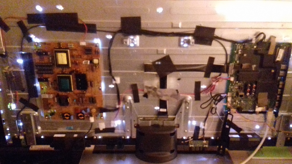

    Hi, looking at this TV set, I can hear the audio, LEDs/backlights are on, but there is no video, here are some details...
    Panasonic TX-48CX400B
    17IPS20 power board and 17MB100 mainboard.
    With HDMI source, I can hear the audio fine, but I can't see any video.
    But the LEDs seem to be on, I can see the light coming through the holes on the metal plate at the back, that the circuit boards are attached to, and I can see an even layer of light on the LCD panel at the front.
    The TV was on this afternoon for a few hours, audio continued to play, while the LEDs stayed on. When the TV is left on without a video source for maybe 5 minutes, the backlight/LEDs switch off.
    I've attached a photo of the back showing the light getting through the metal plate, I'm thinking I'm not having a problem with the LEDs, but elsewhere.
    I have read other threads with similar/same power board, but those problems were saying that they could see images on the LCD panel with the aid of a torch; I don't think I'm getting video to the panel.
    What should I test first? It might be worth a bit of time if the panel is ok.
    Thanks.

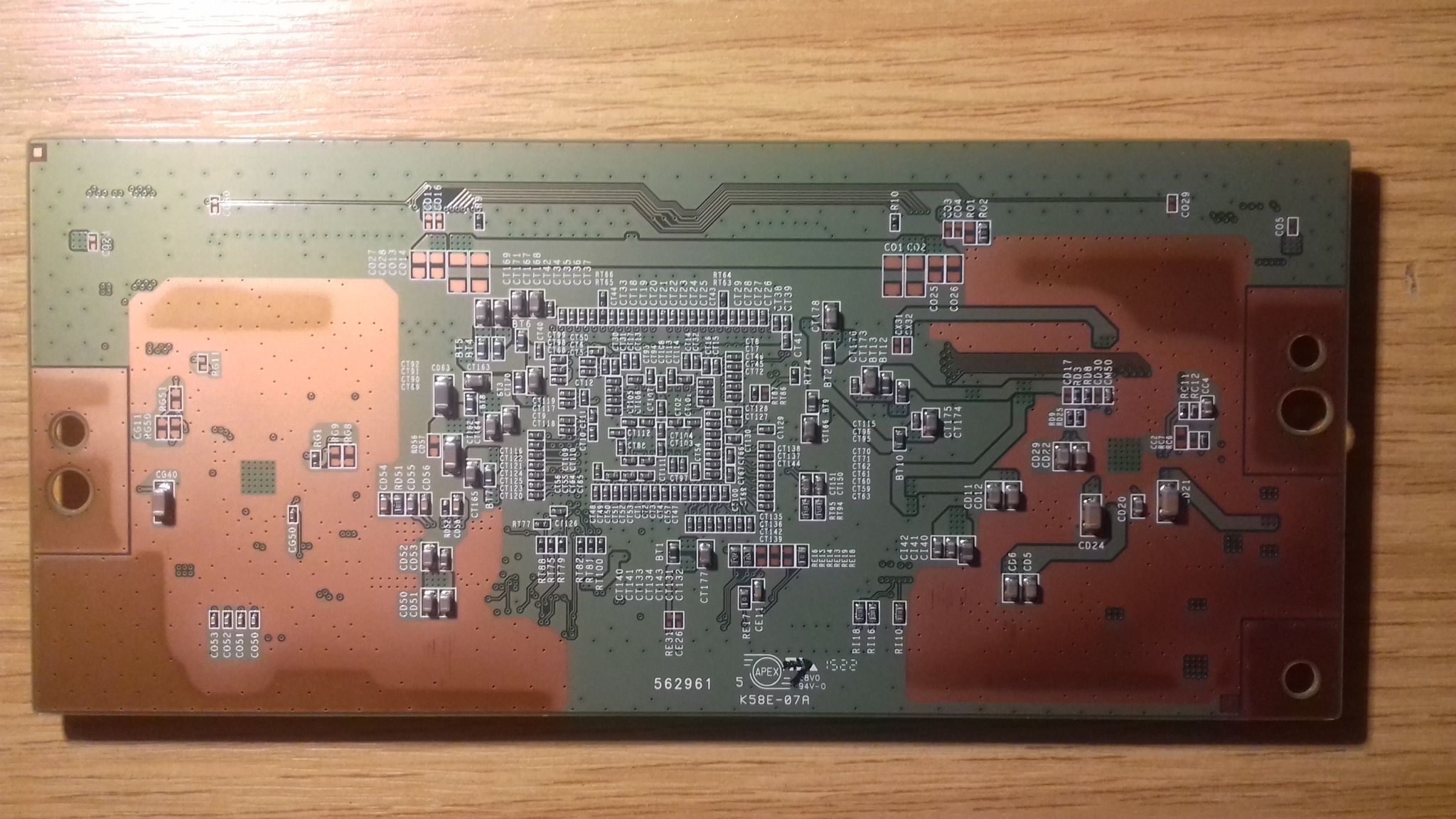

                      There are many Voltage test points on that T-CON board: Test those Volatges with and without ribbon cables between LCD panel and the T-CON board.
                      HVIN_12V
                      VCC_3.3V
                      VCC_1.8V
                      VCC_1.2V
                      VCC_1.1V
                      VCLN.
                      I cannot see VGH, VGL, AVDD.
                      Does it have test points on the bottom side of the board?
                      • tmcw
                        • Oct 2010
                        • 382
                        • Ireland
                        Re: Panasonic TX-48CX400B - No Video
                        Thanks for that list, I'll test them out.
                        I don't think there are any on the other side, I'll upload an image of it, if you wouldn't mind double-checking for me.
                        • tmcw
                          • Oct 2010
                          • 382
                          • Ireland
                          Here are the voltages off the various test points, before and after panel ribbon cables connected...
                          VIN_12V ... 11.78 ... 11.82
                          HVIN_12V ... 0.06 ... 0.06
                          VCC_3.3V ... 3.32 ... 3.32
                          VCC_1.8V ... 1.80 ... 1.80
                          VCC_1.2V ... 0.94 ... 0.95
                          VCC_1.1V ... 1.15 ... 1.15
                          VCLN ... 0.10 ... 0.01
                          Is the VIN_12V of 11.78 / 11.82 good enough?
                          Also, is the drop on VCLN from 0.10 to 0.01 significant?
                          • nomoresonys
                            • Jan 2013
                            • 12206
                            • U.S.
                            Looks like HVIN is way too low.
                            • diif
                              • Feb 2014
                              • 6978
                              • England
                              VIN_12V IS OK BUT you're missing HVIN_12, and the 1.2V looks off also.
                              AVDD is next to the left hand LVDS socket.
                              • tmcw
                                • Oct 2010
                                • 382
                                • Ireland
                                Thanks for pointing out AVDD, I don't know how long I've looked at this board and didn't see it!
                                AVDD is 0.01V with the ribbon cables connected and not connected.

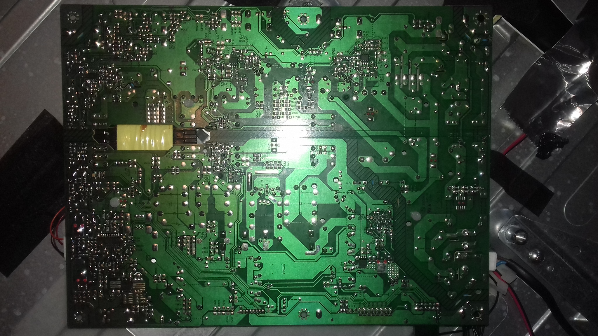

                                        Ok, so I got another t-con board, but I have the same issues as before, sound but no picture.
                                        Testing the voltages on the new t-con board, I'm seeing more or less (+/- 0.03V) the same voltages as noted a few posts above.
                                        I went back to the power board, at the connection (CN4) that goes to the mainboard, and apparently I'm not getting what I think should be the +5V_STBY, this is what I'm getting on the pins (hope I've assigned the voltage to the correct pin)...
                                        1 24.8V
                                        2 0.01V
                                        3. 0V
                                        4. 0V
                                        5. 3.2V
                                        6. 0V
                                        7. 1.6V
                                        8. 0V
                                        9. 0V
                                        10. 11.8V
                                        11. 11.8V
                                        12. 11.8V
                                        I've attached the 071114 R9 schematic, but it doesn't show the CN4 pinout, I got the CN4 pinout from the R6 schematic, so assuming it would be the same.
                                        But the mainboard would not be using 5V standby for generating video, would it, surely it would be using the 12V?
