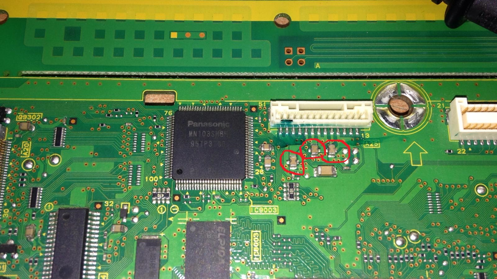

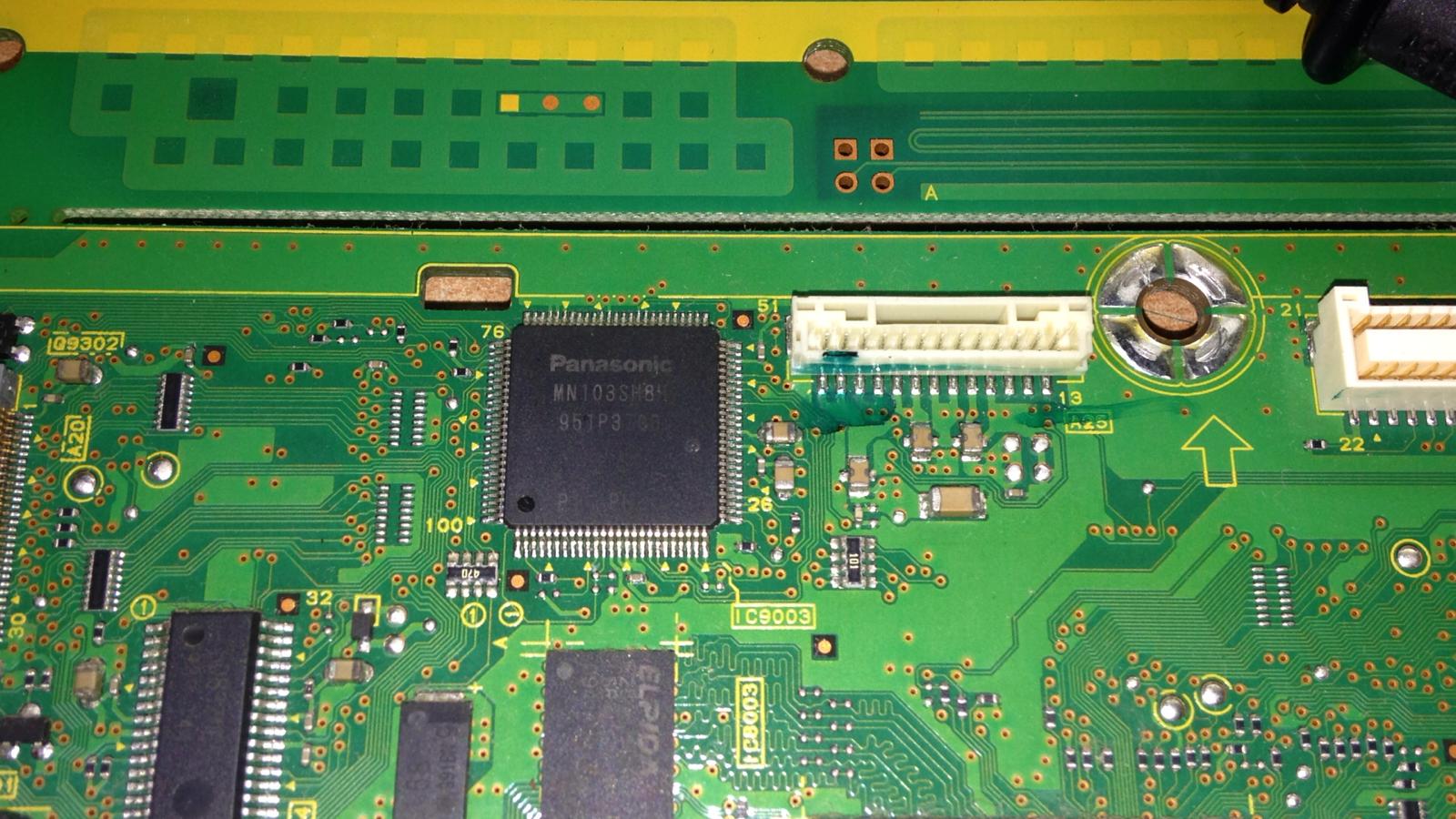

                sorry guys but I discovered I at least hope .. a short circuit on 3 smd capacitors next to the A25 input connector coming from psu ... I attach photos of the three capacitors ... according to you and normal? the whole area around and below does not have short circuit, but only the three leads that I am attaching in the picture ... is it possible that they are the problem?
                • toty79
                  • Mar 2019
                  • 42
                  • Italia

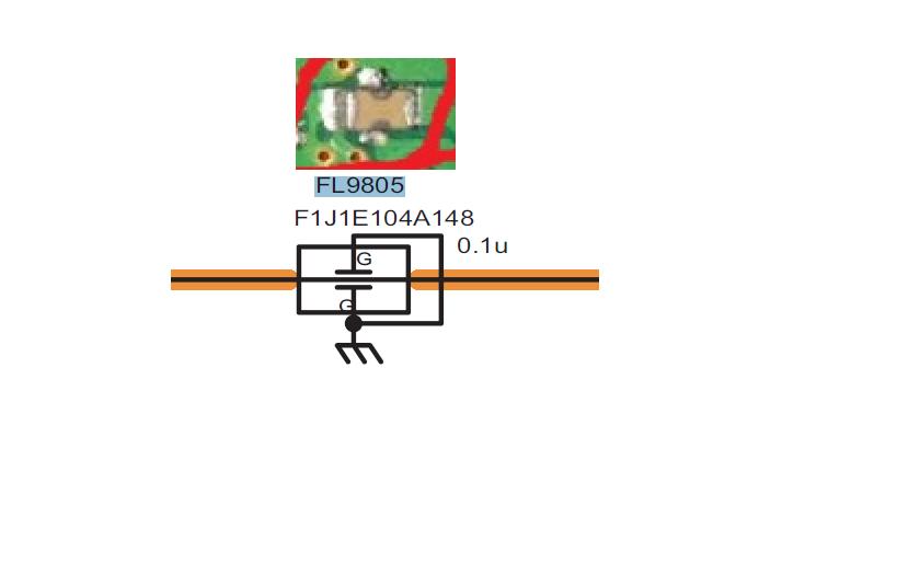

                  Re: Panasonic Plasma TX-P50C10E single blink
                  the layout of the A25 connector and on page 63 of the service manual

                    Those are filters, How are you checking them, they will check shorted end to end, check each end to ground, that should be open.

                      in fact I had strong doubts, they seemed to me fuses being screen-printed FL ... anyway and as you say, I measure short between the two poles of the filter, but then there is no short towards the ground so everything is ok, waiting for the programmer to arrive and reprogram eeprom. .if there are other tips they are well accepted ... thanks
