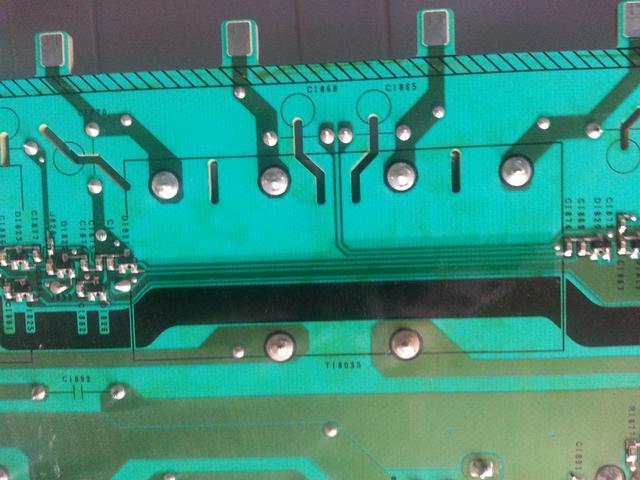

            Ok, thanks for the replies. I brought it home. Plugged it in, only had red standby led. Took the back off. Tapped around the power board. Plugged it in...got blinking red led. it booted. I put a signal to it and the pic appeared for about 5 minutes, went black, no red led. Cycled the power, only have a solid red led now. STBY measures 5.15v and PWR-ON/OFF measures 0.878v. CP815 and CP816 have 370-400v on them. My BN44-00264A board has 4 black transformers. Can't see any signs of burning, arcing or heating. No caps look bulged. I re-soldered the connections for the transformers and the ribbon cable connector anyway. No change.
            Some pics:
            Back of set
            Power/inverter board-top
            Power/inverter board-bottom
            Power/inverter board-Top side-bottom
            Power/inverter board-Top side-top
            Power/inverter board-Bottom side-bottom
            Power/inverter board-Bottom side-top
            Logic board-top
            Transformer-2nd from bottom-top
            Transformer-2nd from bottom-bottom

              ok, it looks like you have the more reliable power supply of the two kinds. You may want to test the high voltage side resistances (on the 4 pin side, between pins 1-2, and 3-4). See if they are all approximately the same as one another. If one measures quite differently it could be bad. Otherwise I have not really seen those inverter transformers go bad.
              By the fact that your TV works, but intermittently, I suspect you have cold-colder connections somewhere. RE-check all of the connector pins and any transistors or diodes that are attached to a heat sing, and any large diodes or fusible resistors that may get hot and re-solder them all...

                  You are right Unspun01. I think I found it. See inside the circle in the pic...zoom in, you can see it. It is actually one end of one of the heat sinks next to the high voltage caps. I was re-soldering all the heavier solder joints on transformers and other components. I felt something click when I picked up the board. I twisted it a bit and tracked the clicking down. I'm glad I felt it. I was in the process of soldering the pads for all the heat sinks and it would have started working but I would not have known why. Working fine...so far...so good.
                    Re: Samsung 40" LCD tv model LN40B610A5FXZA won't turn on
                    Whenever I get one of these types of power supplies, the first thing I do is gently flex the board and listen for the "click ". Then check the fuse, mosfets,diodes............
