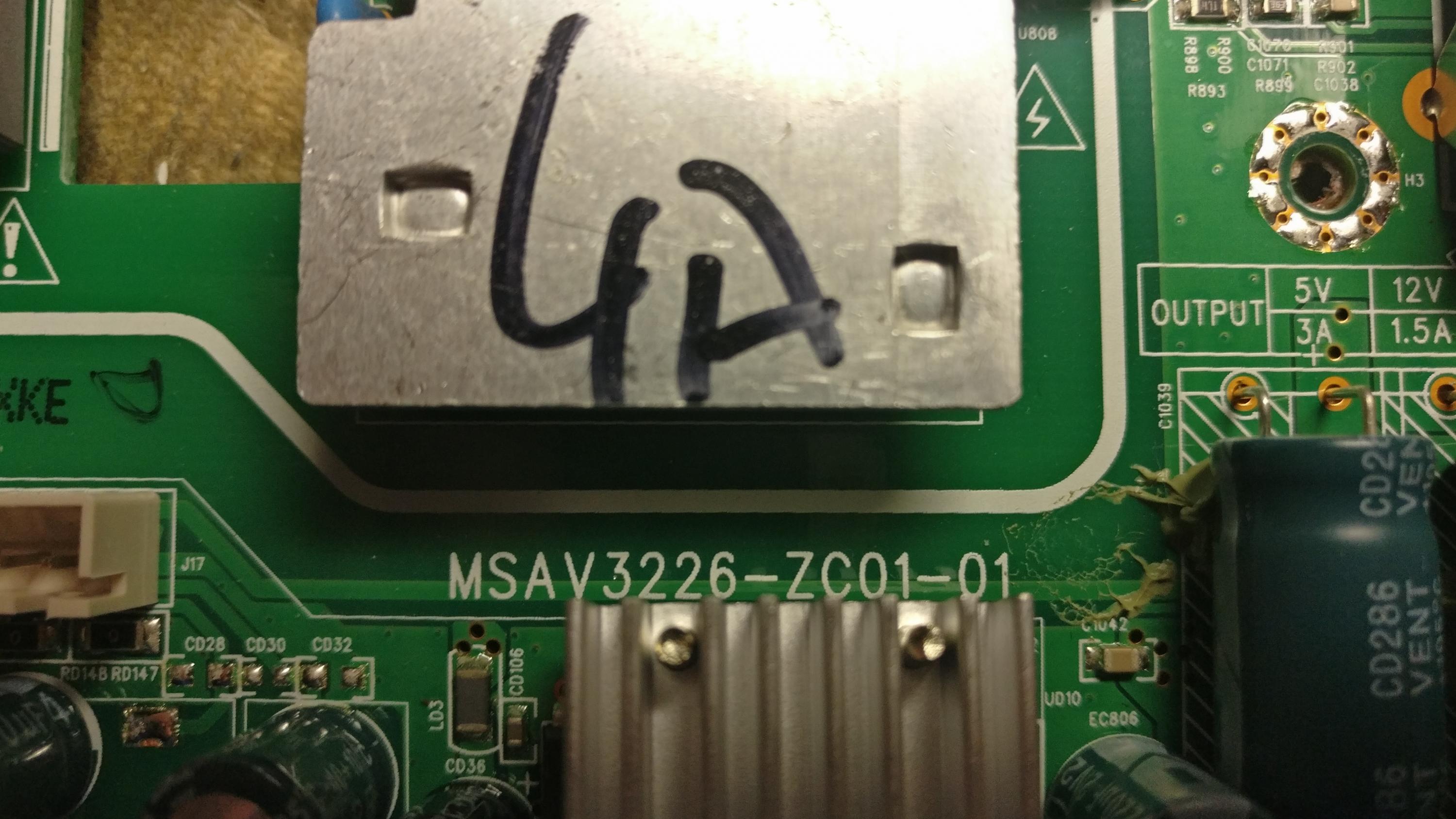

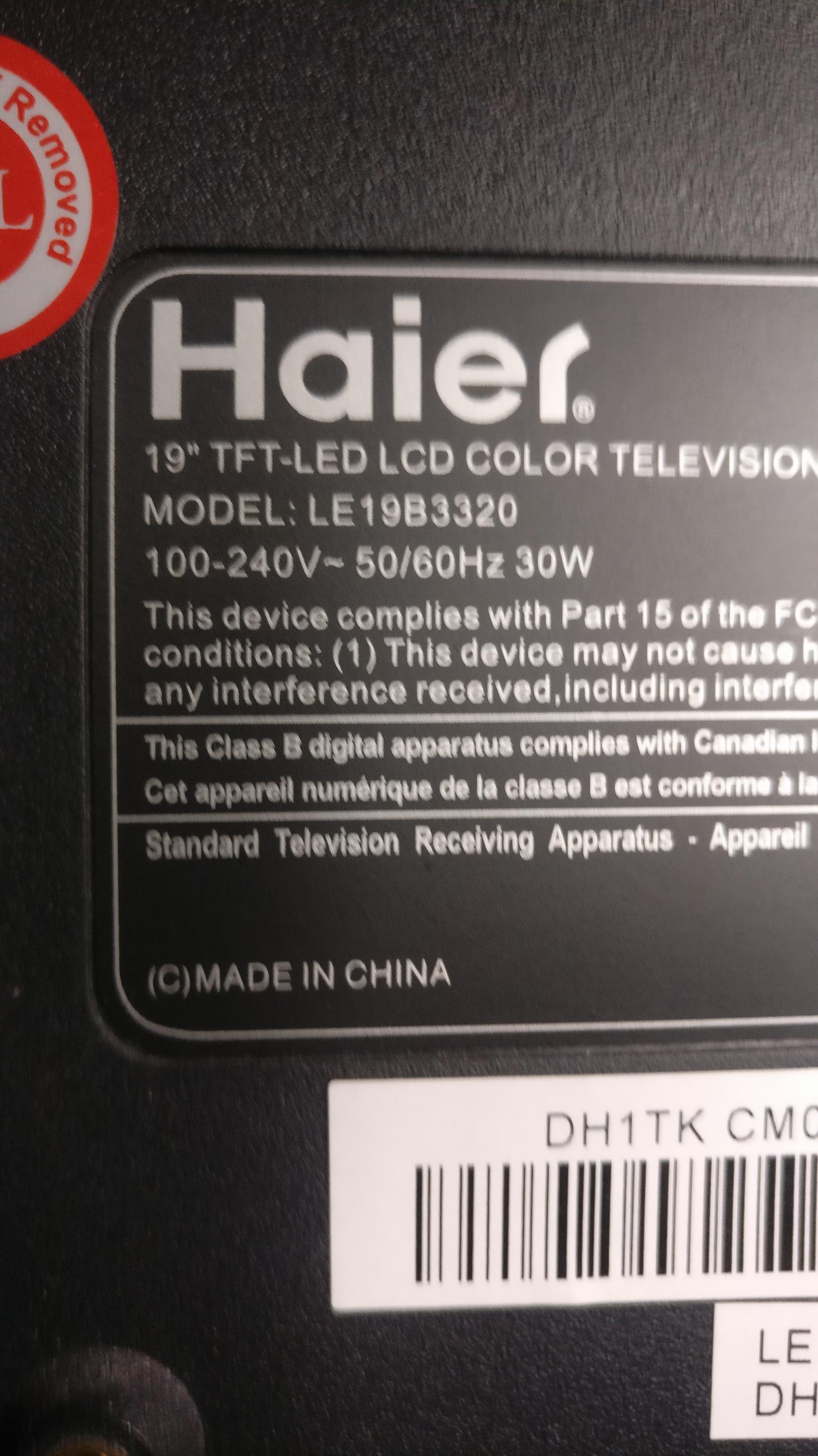

Haier LE19B3320 No Sound No Pic No Backlight No Response
  • mmartell
    • Oct 2013
    • 3189

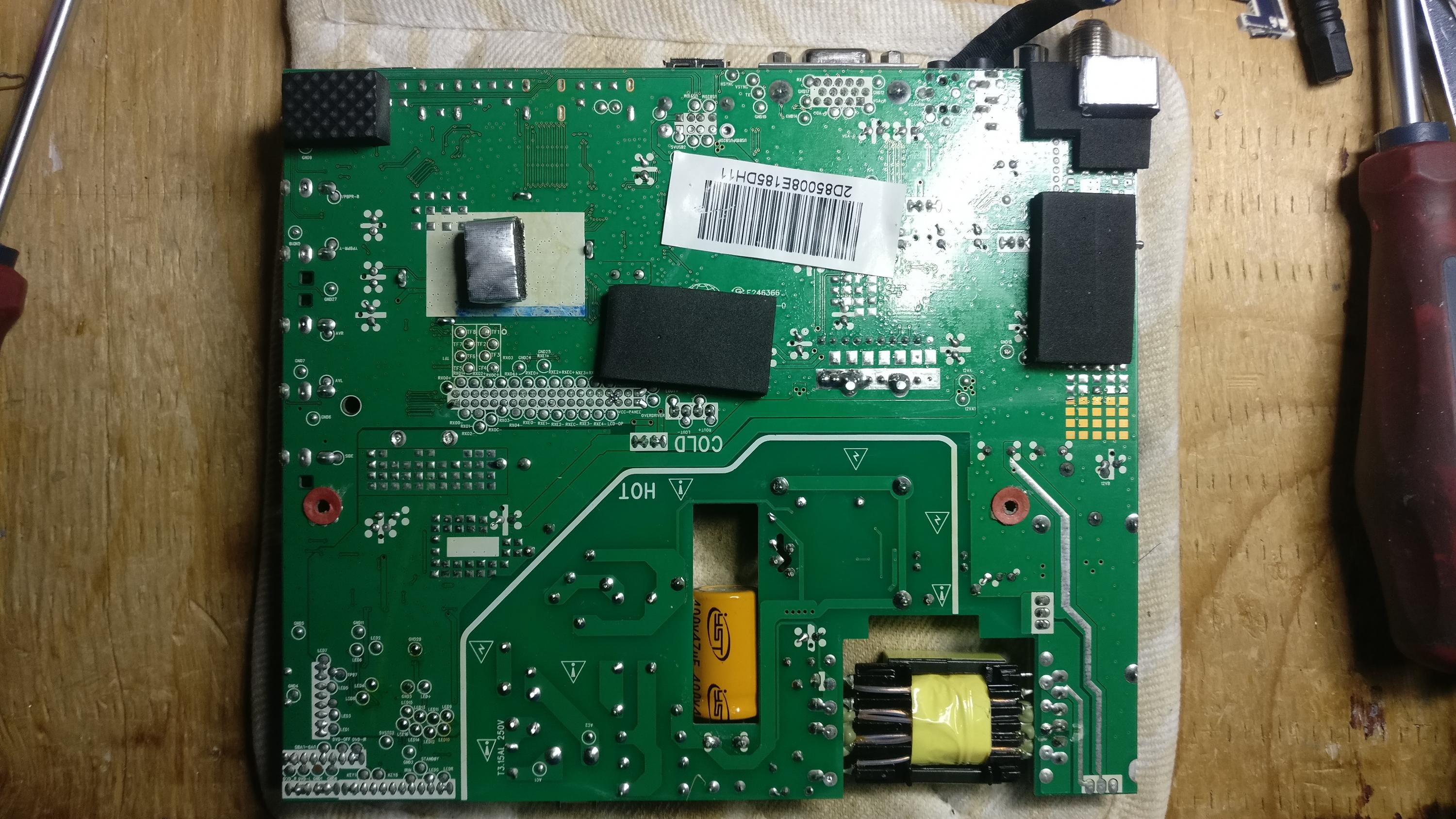

    This has an integrated PS/Main board. At power up the blue light comes on but beyond that there are no outward signs of life. However all voltages are present on the secondary.
    Can't find an eeprom bin to flash to the U18 (25Q64) in case that's the problem but was wondering if this supply has a PFC boosted voltage ?

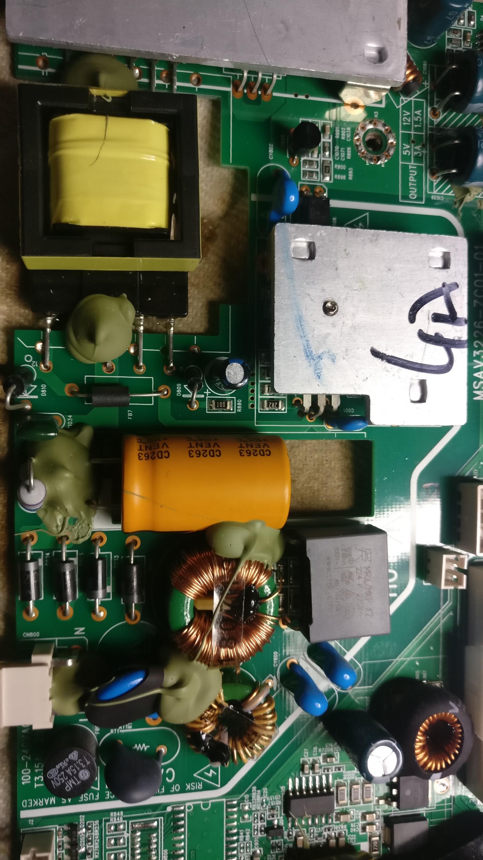

    I only measure 168v at the main cap but I notice the cap is rated at 400v
    Suggestions ?

        At 30 watts, the TV may not use enough power to need PFC so 168V looks ok.

            I does'nt look like there is a pfc circuit, its only universal input 100~240vac. shopjimmy lists an eeprom for a LE32F2220F TB300714806M main board

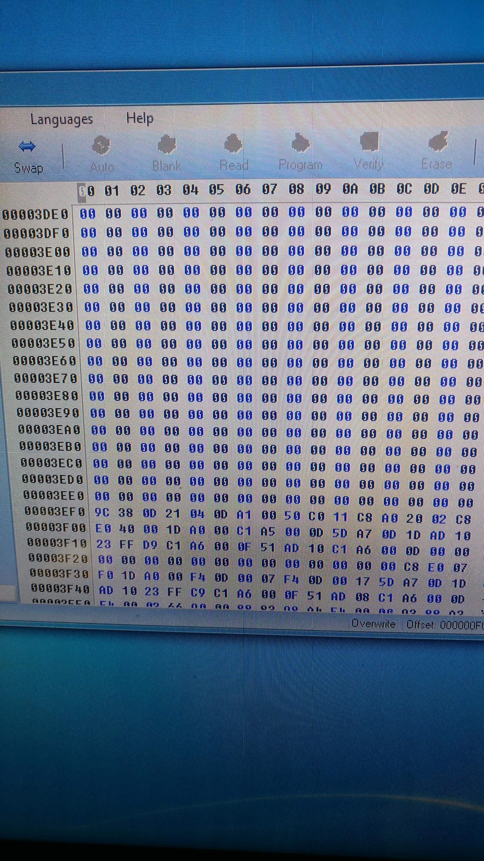

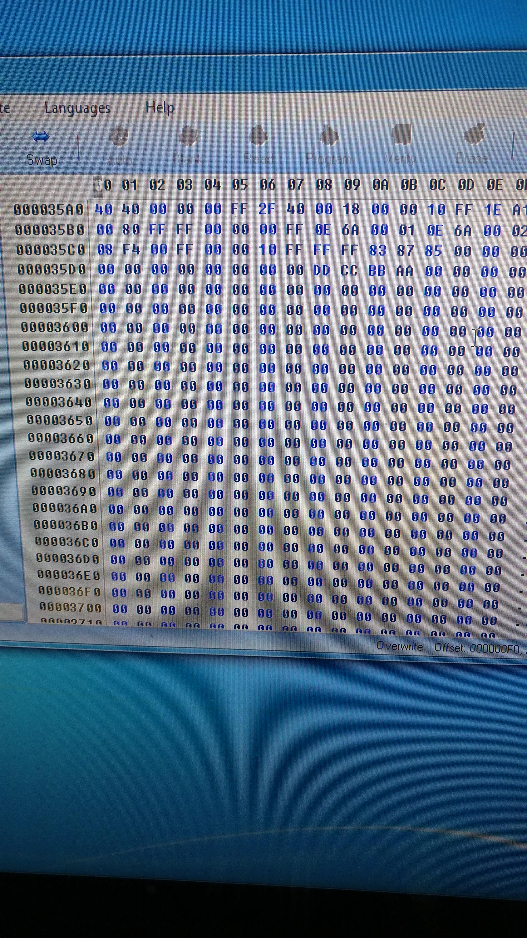

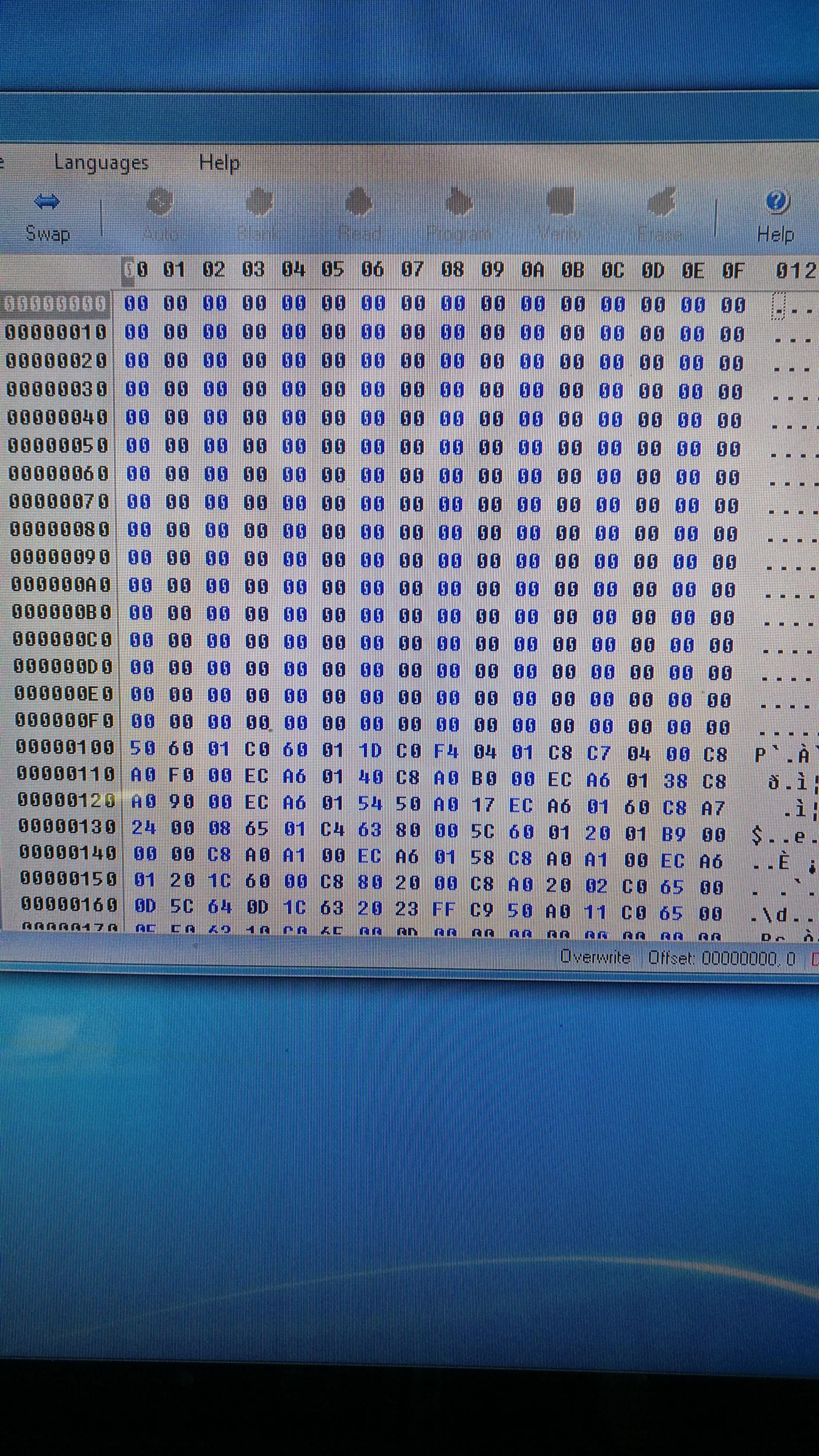

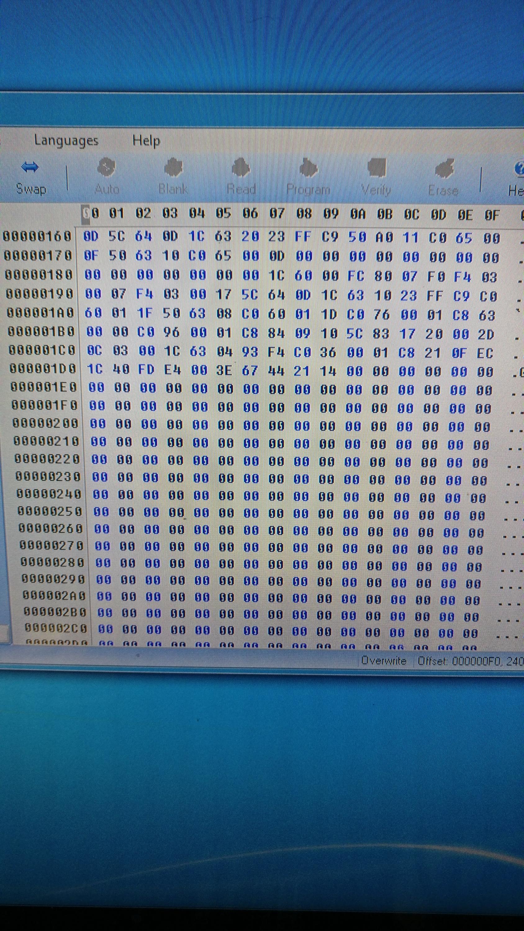

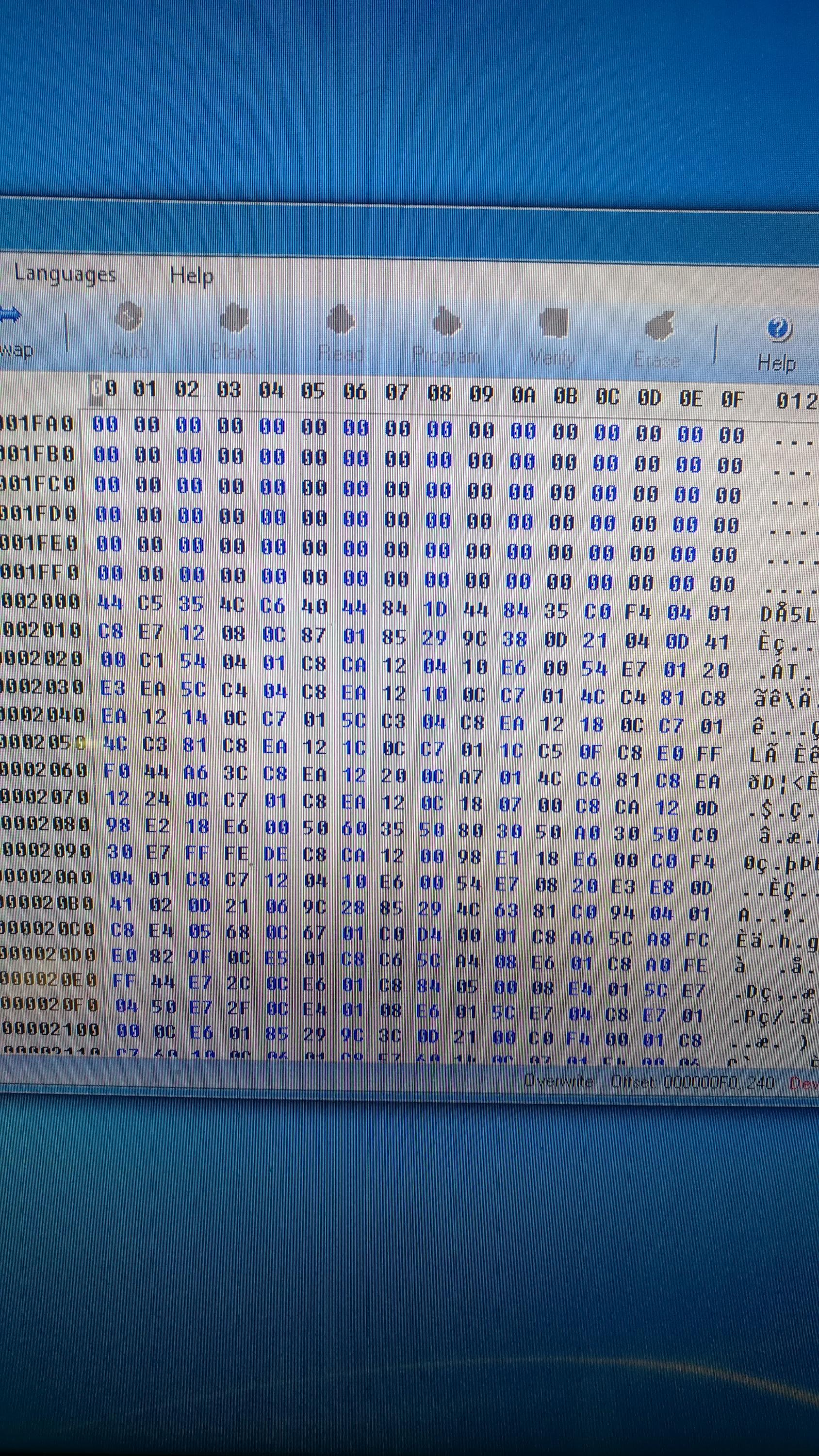

                    I removed and read the eeprom and flashed it to another eeprom and the result is the same.
                    But looking at the bin there are several places with only zero's.
                    The first 0x100 bytes are zero's. Then there is a small bit of non-zero data followed by another stretch of zero's all the way to $2000.
                    Then again zero's at $35D0 to $3EF0. After that the flash is full of non-zero data until roughly three quarters through the entire flash where the rest is filled with #FF.
                    Is this bin bad ?

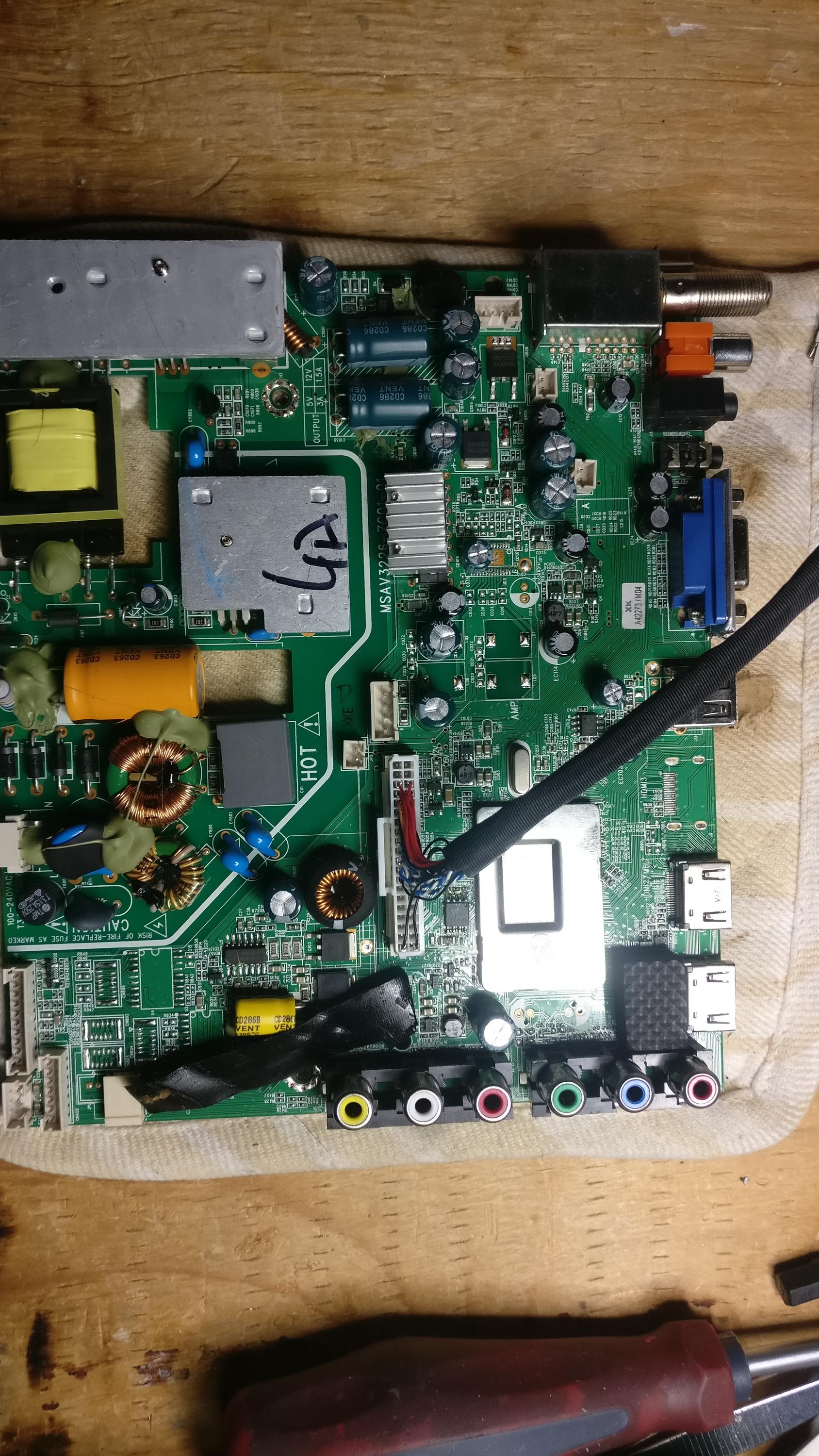

                      Pics...

                        the (( The first 0x100 bytes are zero's )) are normal. and when there are no data later between the sector's normal too as there drivers and setting loaded one by one.
                        the questions .. are you sure the issue with eeprom ???

                            Read the OP again, I said I have ALL voltages present on the secondary (according to troubleshooting section of the SM).
                            No I'm not certain the eeprom is the problem. I did not check for voltage at the flash ic and will do that right now.
                            Thanks for confirming the dump is not out of the ordinary.
