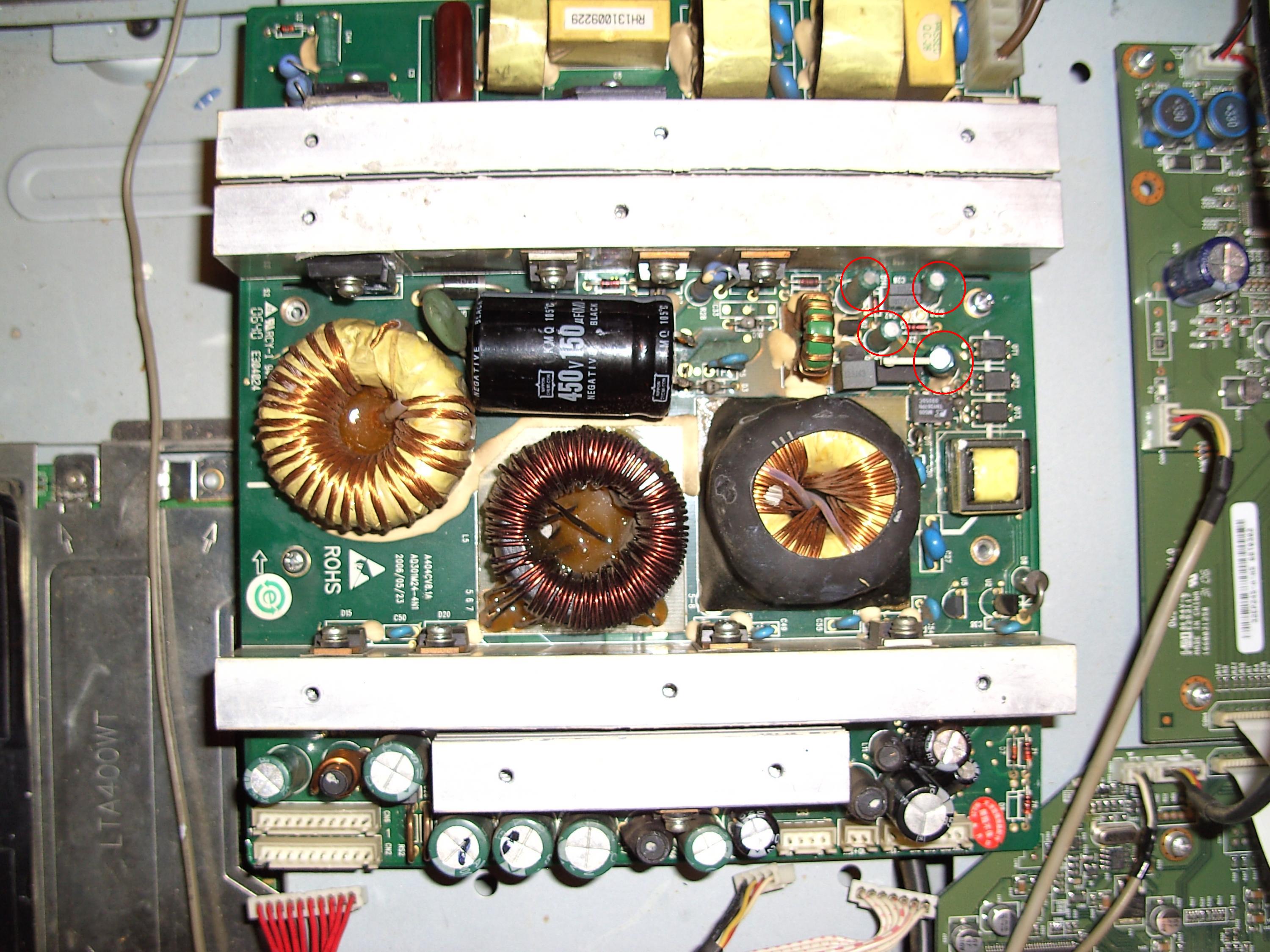

    I have a power supply from a Haier tv that i am having problems with what to check next. The supply is a AD301M24-4N1. The supply turns on but with it connected to the mainboard the outputs are low. The 12v shows 6v, the16v shows 9v and the 24v shows 15v. i disconnected the supply completely and jumpered the ps/on pin to the 5v standby and all the voltages come up to spec.
    If I connect a load to any of the outputs the voltages all drop back to the lower readings. Could some please advise me on this!
    Thank You for your time!
    Jerry

        Re: lcd tv power supply problem
        Here is a picture of the power supply.
          I would start by replacing these 4 caps, they like to dry out and go open.
            Do you mean the four caps on the 24v rail? What would cause the voltage to drop across all the dc outputs except the 5v standby?
              Look closely, they are circled in red.

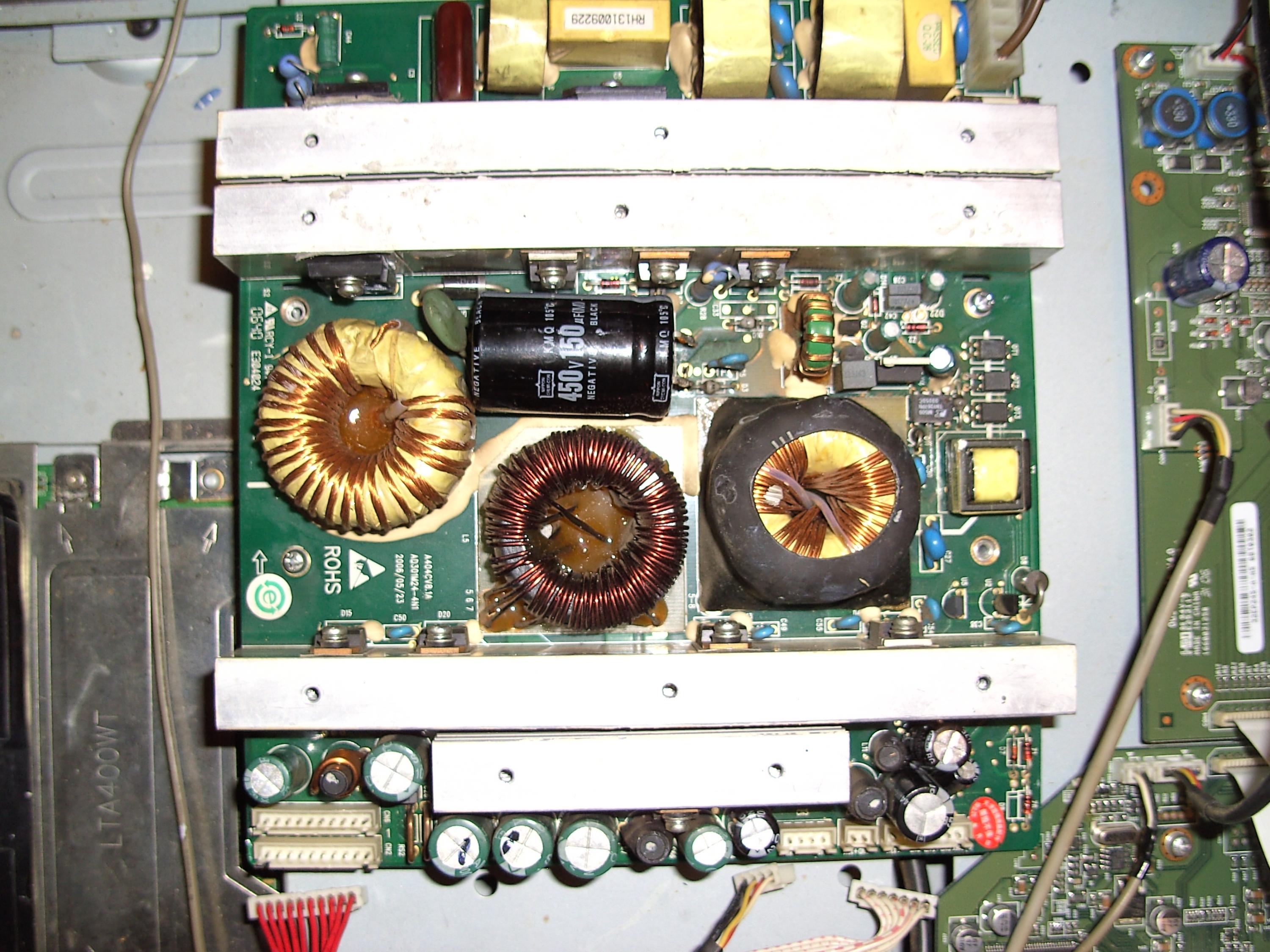

                  I have replaced the four caps shown with new caps. The problem in my first post still exists.
                    What is the voltage across the main capacitor (150µf/450v) If the output voltages are there without load the power supply is working, if they drop when loaded it can be bad feedback to the primary.
                    Some people have found the output caps to be bad also 1000µf/16v and 100µf/25v
                      The voltage across the main cap is 167v dc. When supply is powered on that voltage drops to 150v dc. I have already replaced the other caps.
                        Should be around 400 when powered on.
                          Check all the diodes, sometimes it's a rectifier diode gone bad.
                            That voltage on the main cap should not drop to 150v but should go to around 400v when turned on, The pfc circuit is not working.
                            It is either defective or is not being turned on via the optocoupler.
                            I checked a couple other threads and it should have around 400v on the main cap when turned on.
                            I would need clear pictures on the bottom of the board.
