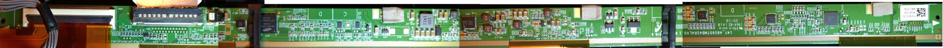

        At this point the switching power supplies on the T-CON are not working, I would inspect all the linear Voltage regulator IC' on that T-CON to see what you have on the inout and on the out, also the resistance with ref to GND for the input and the output of the regulators as well.
        Upload good clear pictures of the T-CON board.

          T-CON board blended in to one pic hopefully it's good enough?

            Oh, it is integrated T-CON.
            BTW, since you have backlights which means the PS-ON, BL-ON and Dim control signals are present, so at this it is something on this T-CON that you need to test.
            You can do resistance testing on those Voltages test points to see if any of them shows low resistance or not with ref. to GND. I suspect it has shorted MLCC similar to this one: SONY KDL-40W590, https://www.badcaps.net/forum/showth...ONY+KDL-40W590

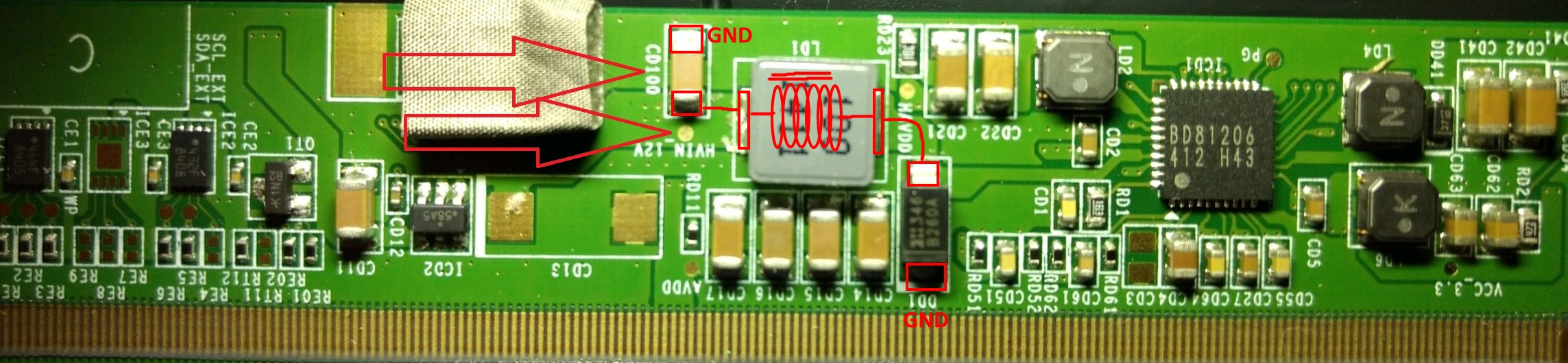

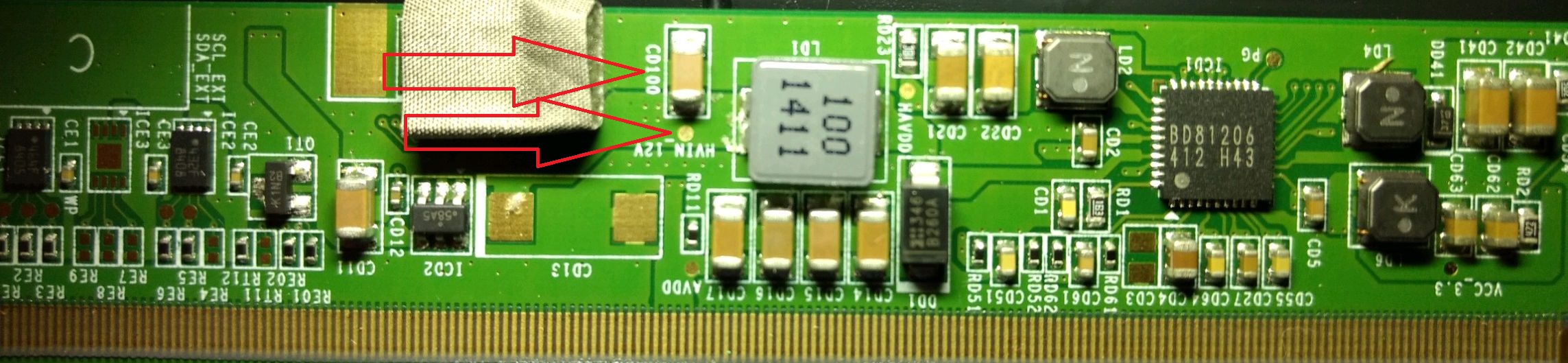

                                    I look at your your pictures and come up with how the cap, inductor, and the diode are connected together so I would expect the diode DD1 will show about the same resistance as cap CD100, unless my assumption is not correct based on the pictures, you need to verify.
                                    See if the place I marked with GND are actually tied together or not.
                                      Must I re-install cap CD100 before testing?

                                        We are doing static Ohm test at this point, since the cap is not tested as shorts off the board then you can put it back in place. the shorts circuit is some where around that location, just a matter of tracing and finding it.
                                          #40
                                          Re: Sony KDL-48W600B software update with no picture
                                          CD100 re-installed. Across DD1 is about 3300ohms. Across CD100 is zero ohms.
                                          UPDATE: From GND to GND in your pictures is the same 3300ohms
