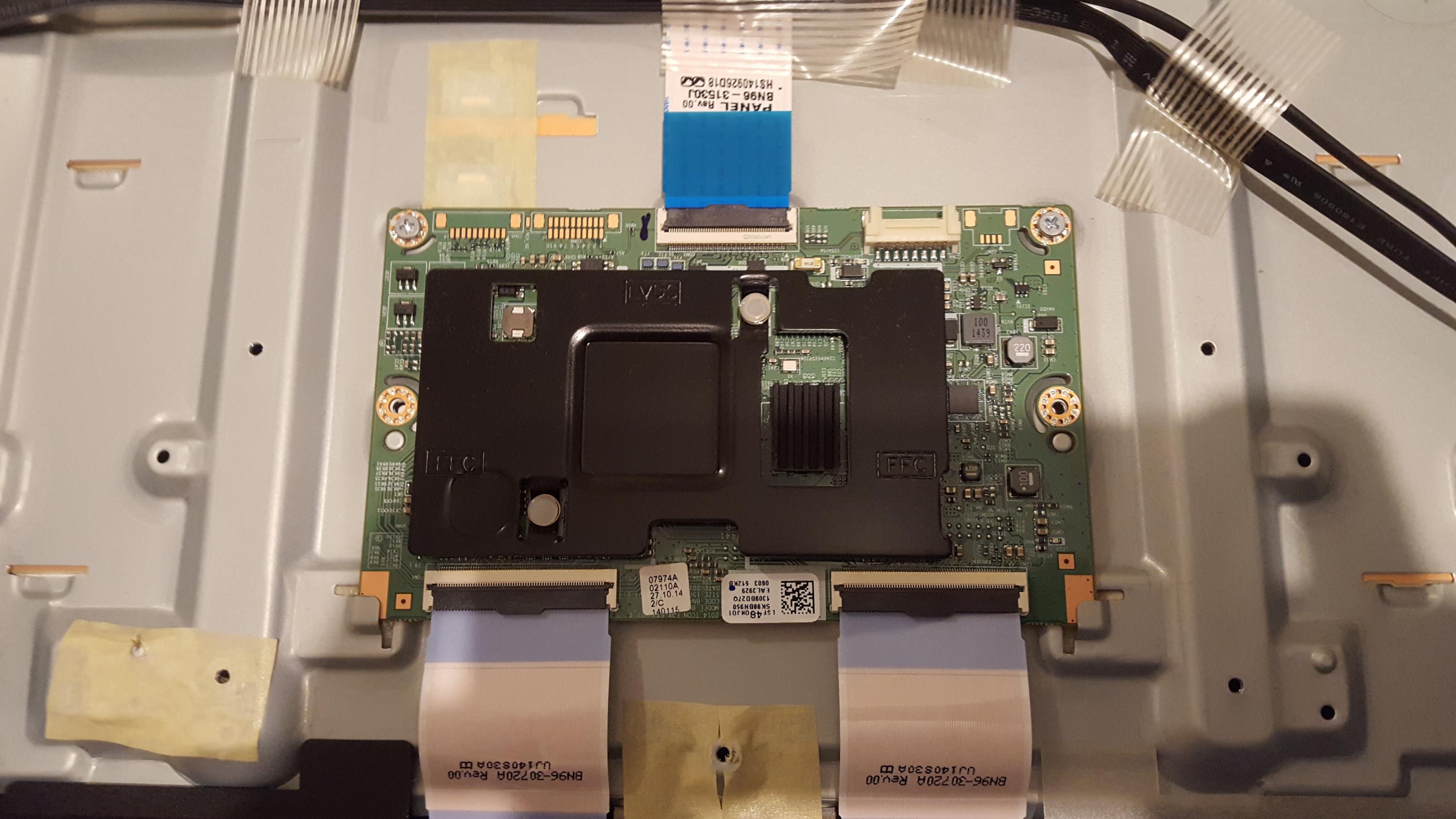

    Morning all, I have a Samsung UE480H6400 which had BL failure, have replaced all faulty BL's, tested and now BL comes on.
    Problem i'm seeing is when you power the TV on with TCON connected there is no picture no BL's but the TV is still powered on, You can hear it working when pressing volume up or down on remote or side Toggle.
    If I disconnect either ribbon going from TCON to Panel the backlights come on Still nothing on the screen though. Could one or more of the ribbons on the panel be damaged or could the drivers in the ribbons be shorted causing this NO PICTURE NO BL fail when all connected up??

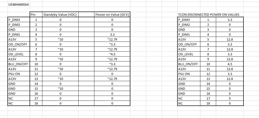

    Test all pins on connector from mainboard to powerbard on powerboard side, all boards connected. Test in standby/plugged in but off, then apply power report both conditions, example: pin 1 bl-on=0 volts standby and 3.3 powered on, report results for every pin. How to video in my signature below.
            Thanks for the reply I will do this tonight when home and report back the findings.
            • StephenU
              • Dec 2013
              • 230
              • United Kingdom
              Re: Samsung UE480H6400AK
              Here are my findings >>
                Not sure, maybe something on tcon or panel, causing the no psu-on voltage?

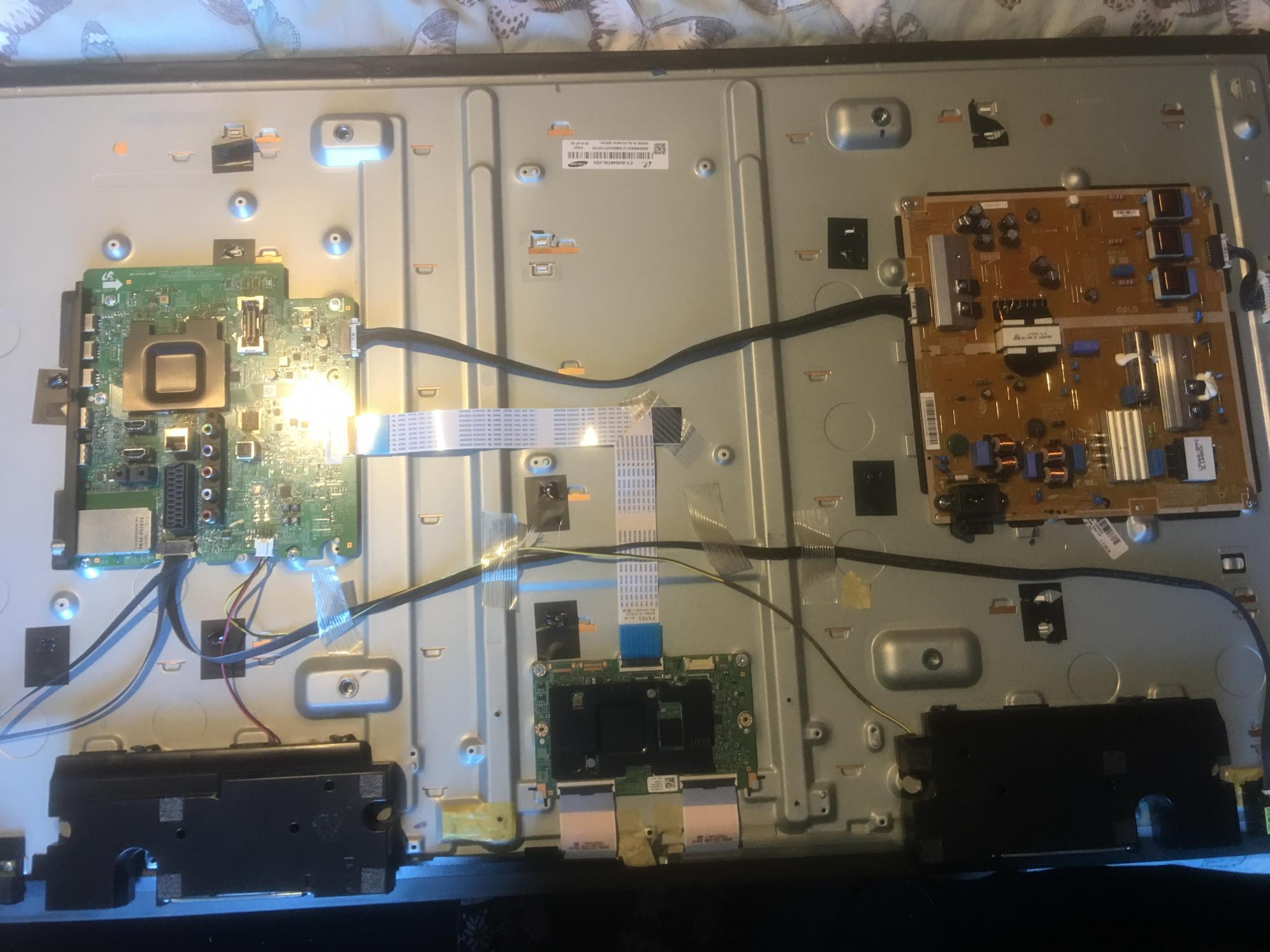

                • dick_barton
                  • Aug 2015
                  • 6642
                  • Wales

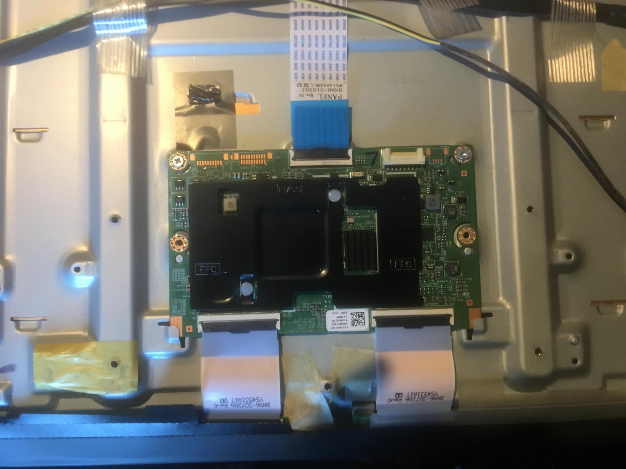

                  Is this a 3D smart tv. Do you have any photo's of the circuit boards and the interconnections between them.
                    We need to see the pictures of what we are dealing with.
                      Yes Dick I do believe this is the 3D smart TV - I will get pictures of all boards and upload tonight.

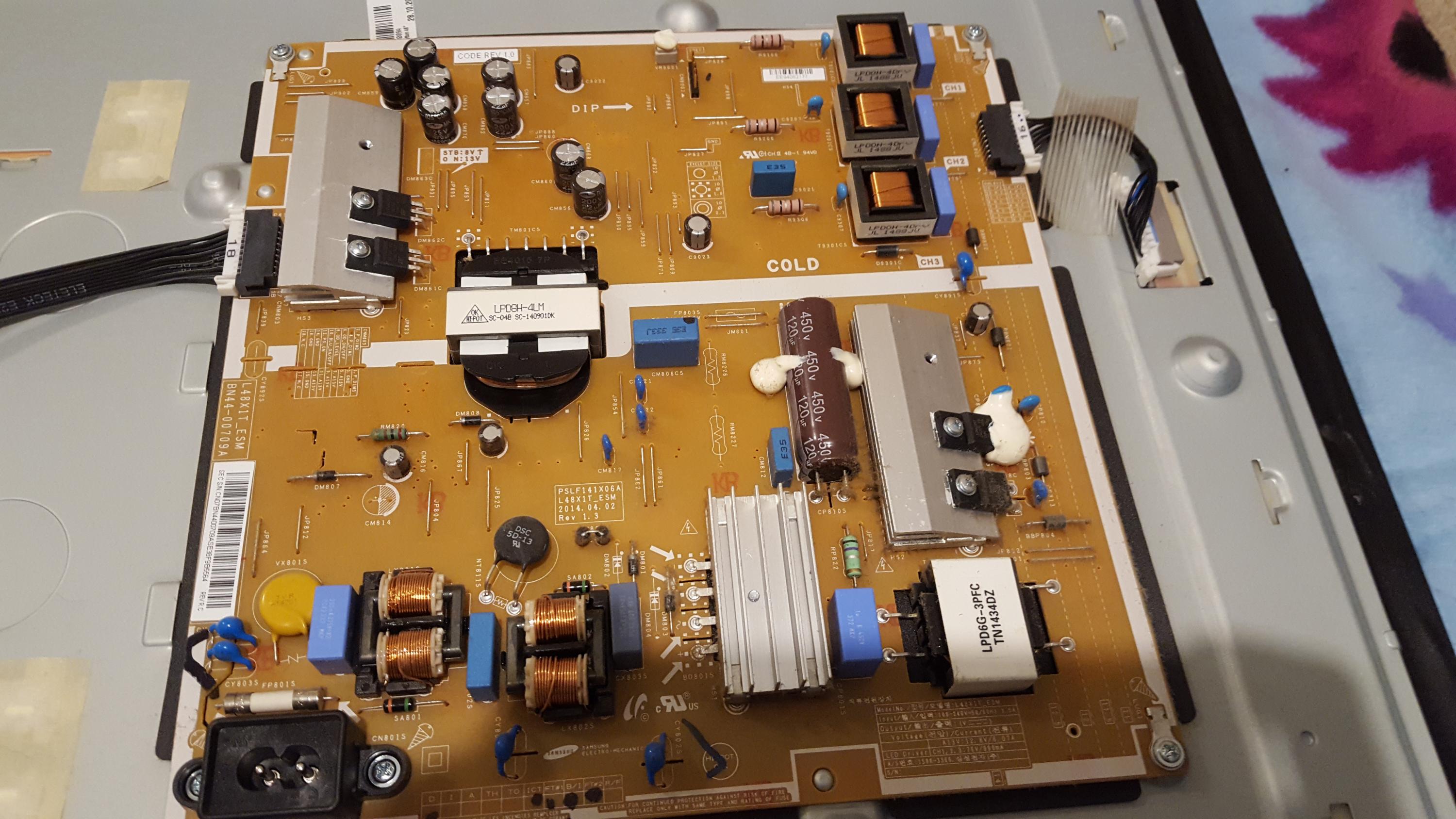

                      The pictures below are of the exact same model if any good until I get home later on tonight.
                      S.

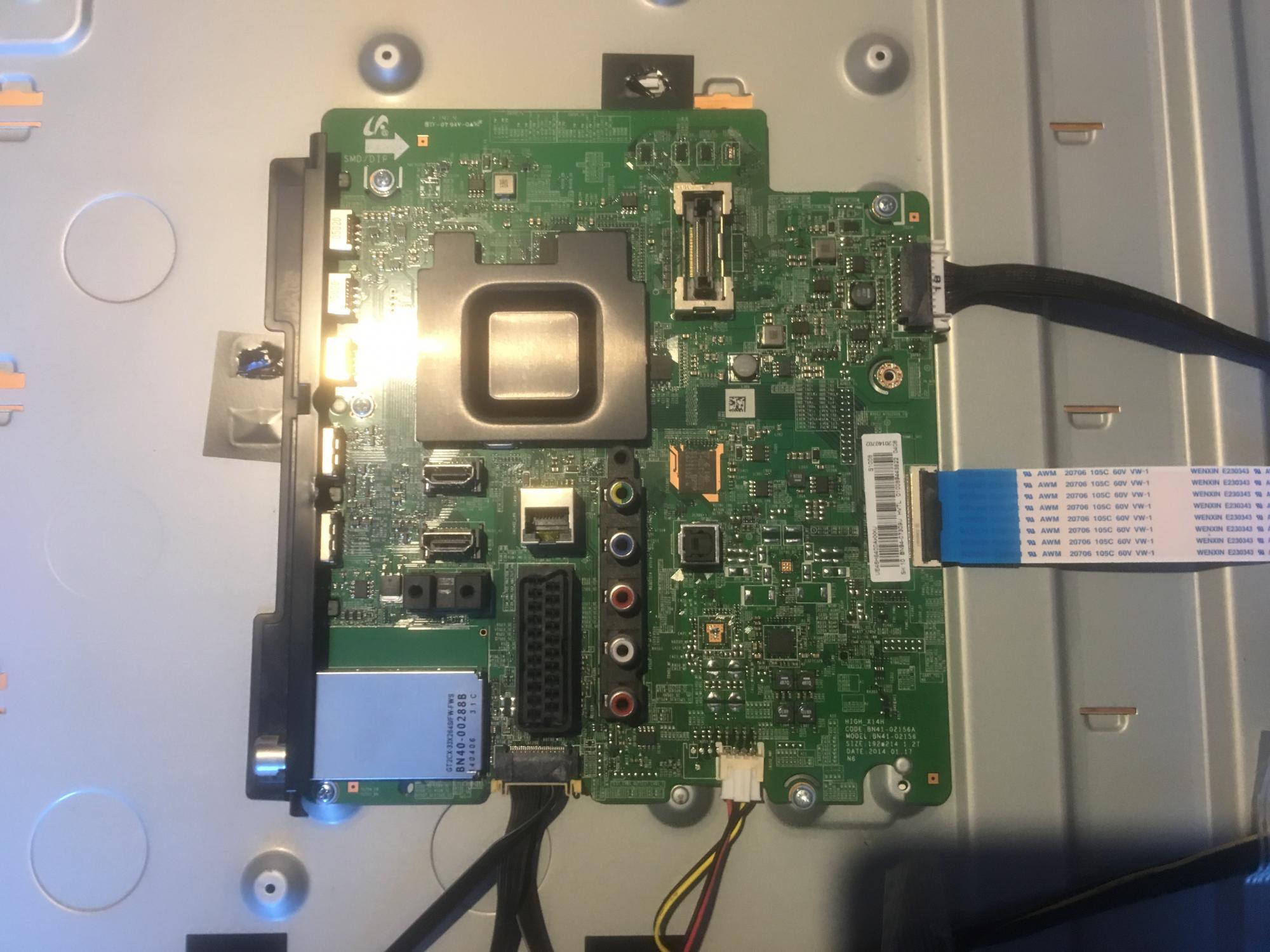

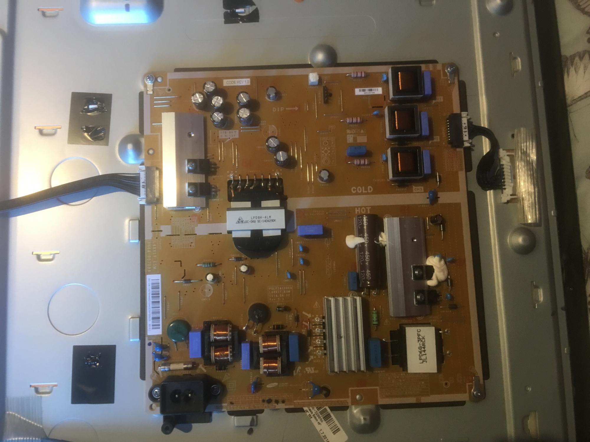

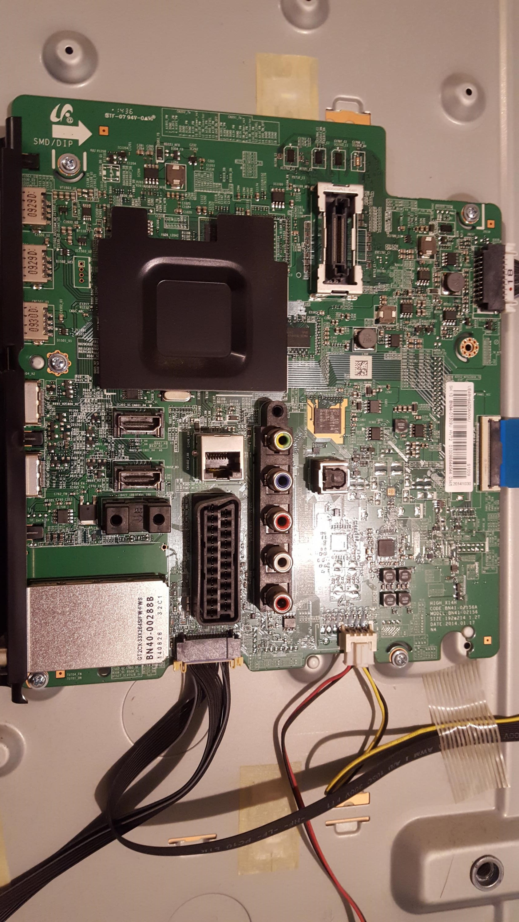

                      • StephenU
                        • Dec 2013
                        • 230
                        • United Kingdom
                        Budm I have attached pics of the exact same boards within my set above, tonight I will upload my own and showing all interconnections etc.
                        TIA
                        S.
                          "If I disconnect either ribbon going from TCON to Panel the backlights come on Still nothing on the screen though. " So if all cables in place, do you get 12V at the T-CON fuse?
                          • StephenU
                            • Dec 2013
                            • 230
                            • United Kingdom
                            Hi budm I get 12v at the fuse both sides with the ribbon connected and disconnected.
                            S.
